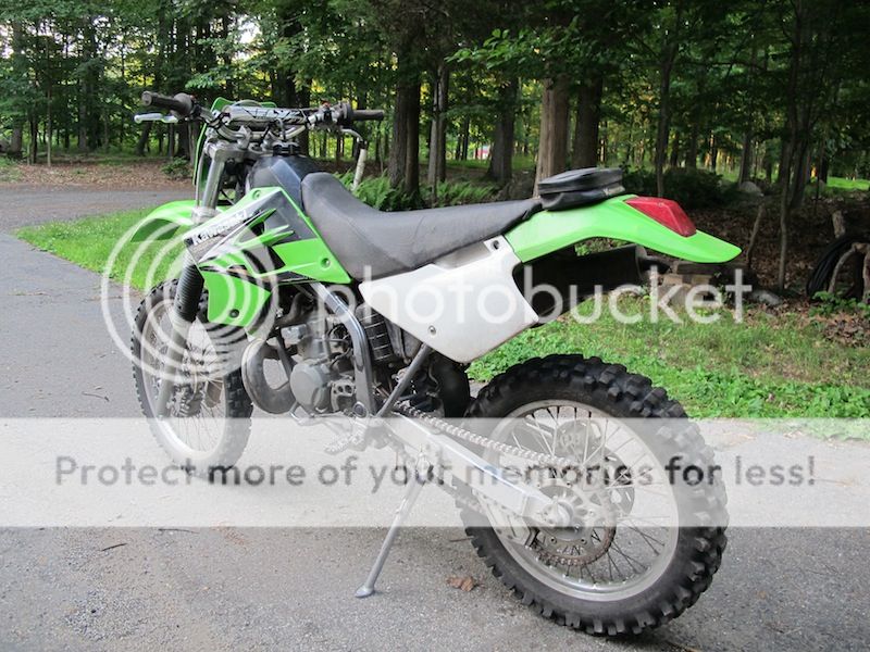

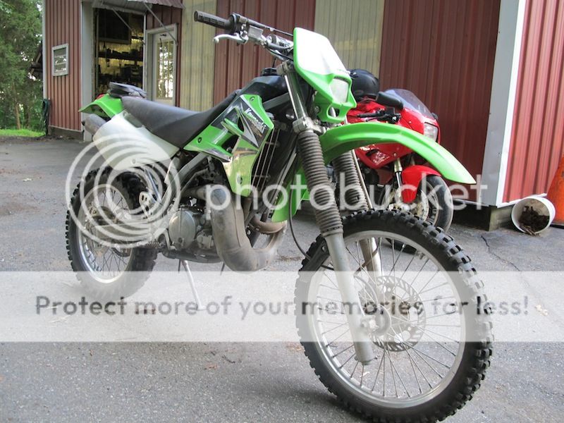

Howdy--I found a decent looking (but dirty, a little dented, and pretty much stock) '04 KDX 220.
Pros:
Quiet / stock pipe
Easily streetable. Comes with street title. and head and tail light
20 miles away.
Cons:
No hand guards,
It has stock handlebars...
I bet is has the original piston in it.
Am I better off buying a pre-modified KDX that already has a Wiseco piston, skidplate, and Gnarly pipe? I found one 500 miles away for $250 more, but I"d have to ship it.
What else should i be looking for?
Thanks!

That looks pretty good, but I have no idea what the asking price is. I tend to prefer an unmolested (mostly stock) bike, and then do any mods/upgrades myself. I will say, it seems most of our members prefer the 200 over the 220, although both are great bikes. They are very different, so depending on your riding areas and style one may suit you much better than the other.
Please don't think I'm bashing the 220, I'm not in any way. Just curious what has you leaning toward the 220...

Understood. That seems like a good price for an 04 220. Not sure if you are aware, but the stock cast piston in the 220 is notorious for skirts breaking. This can cause some real damage, so a forged piston is a must for any 220.
As far as the difference, the bikes are identical as far as frame, wheels, graphics, plastics, etc. The bottom of the engine is also the same. The 220 came fitted with an o-ring chain stock, which is a plus to most people. The 220 has a smaller 33mm carb, as opposed to the 35mm on the 200. This, when combined with the low end porting and larger displacement, makes the 220 an absolute torque monster. It pulls very hard of the bottom, but revs out of the power band very quickly. The 200 would compare more to the KTM 200, with more overrev than the 220, and a bit less grunt down low.
Hope this helps!
