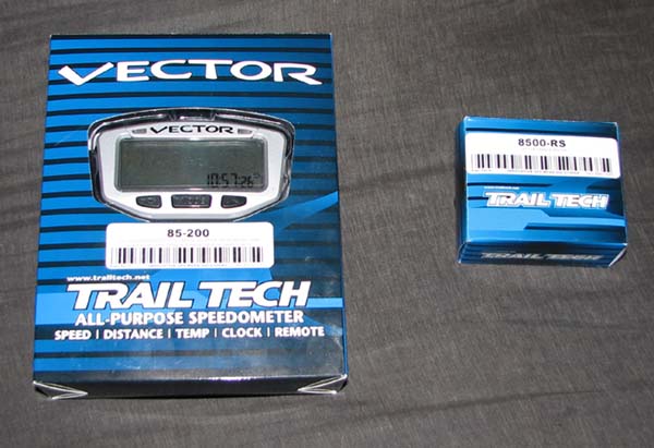

Just a pic of my forks and shock and one of my brand new Trail Tech vector w/switch.
forks and shock.jpg (51.78 KiB) Viewed 3411 times
Vector and switch.jpg (60.57 KiB) Viewed 3411 times
