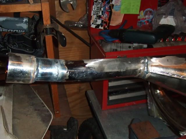

To get the newer PC pipe to fit, I had to make a hefty dent up by the upper mount to clear the KIPS actuator arm. I also had to cut the stinger off the pipe and get it rewelded at a different angle so the stinger wouldn't hit the airbox. I also had to massage the pipe to clear the left side frame downtube--there's hardly any clearance there.
Everything is getting welded up this week, so I'll post pics of how the pipe came out next week. I have no idea whether the mods to the pipe make any difference--I'm hoping not.
In retrospect, I'd go with the newer motor so you have a fighting chance of getting the pipe to fit with no mods.
On my 02 I will need to weld a extension to the header to clear the down tube of the frame.
The procircuit seemed to fit better out of the box: mounting tabs and what not are close to the stock holes on the frame and I didn't seem to have any clearance issue on the radiator and KIPS, BUT I'm missing 1" or so to get the header IN the cylinder, it lines up really well but it's too short.
More or less the same with the FMF, but my pipe was so tweaked that I can't tell for sure until I get it back from piperepaire.com
I'll be using my FMF over the procircuit cuz it has more torque down low (so I've heard)
You need to be ready to do some custom work no matter what...

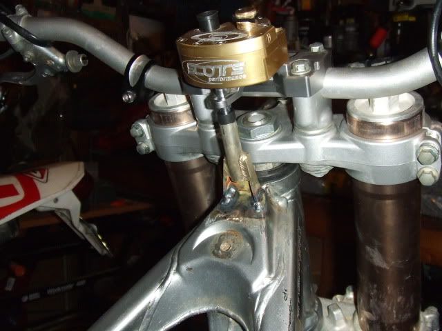

I was torn between using the bolt-on tower versus saving $40 and having it welded on. It took a bit of cutting and grinding to get it to the correct height and to sit flush for the welder, but it looks like it'll work well. If you don't want to spend 45 minutes cutting and grinding on it before welding, then spend the extra and get the bolt-on.

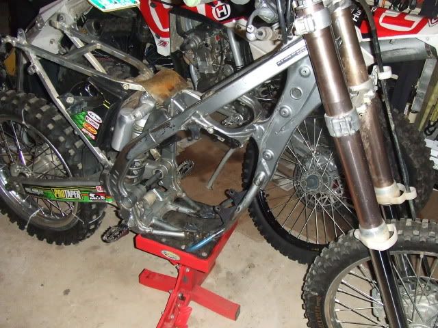

is your bike lowered? Seems your fork tubes are really high in the triple tree...maybe it's just for mock up?

zz3gmc
- Posts: 124
- Joined: 09:02 pm Jun 28 2009
- Location: Pemberton NJ
- scheckaet
- Posts: 3740
- Location: edmond oklahoma
really? I guess I'll have to be careful on my 02 and check it out before I go ride.
