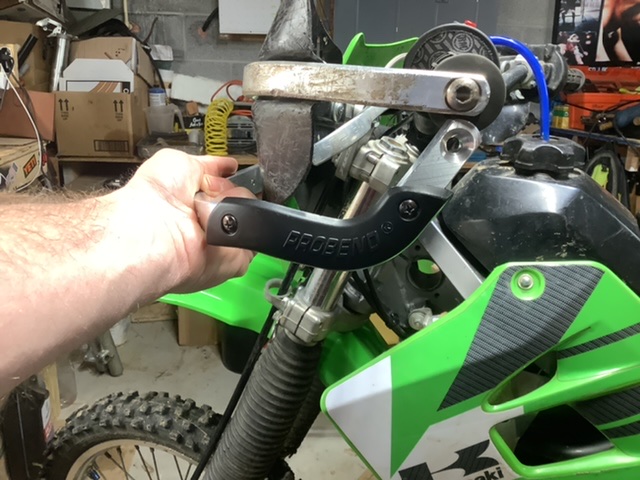

Having heard that standard brush busters can cause a broken wrist and not knowing for sure if mine did, I found a design that is supposed to reduce the likelihood. Motosport had these Cycra Probends so I’ll give them a shot.

I have brush busters like your old set. My son is always warning me about them. He tells me all the GNCC racers use plastic brush busters with no bar because the are safer. I'll have to check out those ProBends.

This has been discussed at length on many forums about the possible dangers of wrap around bark busters. Now, stop for a second and think of how many people use them. Now, think about how many actual injuries were caused by them. It's like seat belts. They can cause harm themselves but generally they are much better to have than not.
For the record, I use wrap arounds and have never had an injury due to them. I have crashed in so many crazy ways including going over the bars a few times (which is supposedly the greatest danger with them) and been fine. Also, I can't count how many times they have saved my hands from taking impacts from trees and rock. The benefits far out way the risk for me. As for the flag style hand guards used by GNCC and some MX'ers, yeah, they protect your hands from whippers and roost but that's it. Clip a small 1" sappling at speed with them and tell my how your fingers fair afterward!
Posted: 09:40 am Dec 06 2021
by MoonStomper
That’s exactly why I’m sticking with wraparounds. That and they protect the levers when you drop her in the rocks.

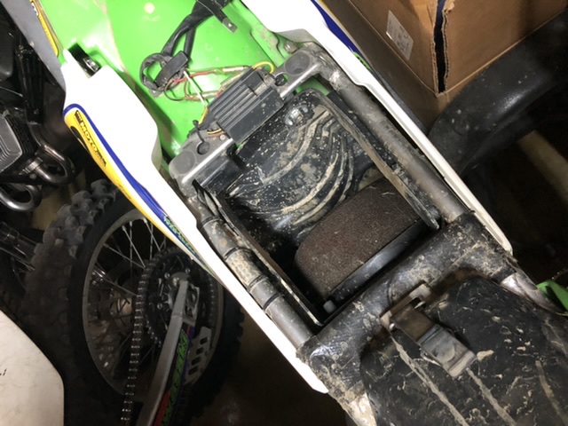

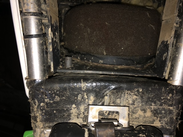

While there I mentioned that I hadn’t done his Airbox Mod yet and would like to see it up close. Fortunately, he had a bike hiding behind a large stack of freshly prepped ice racing tires that he could show me. This bike had just come home from the AMA Museum where it had been sitting since it’s last race - still muddy!

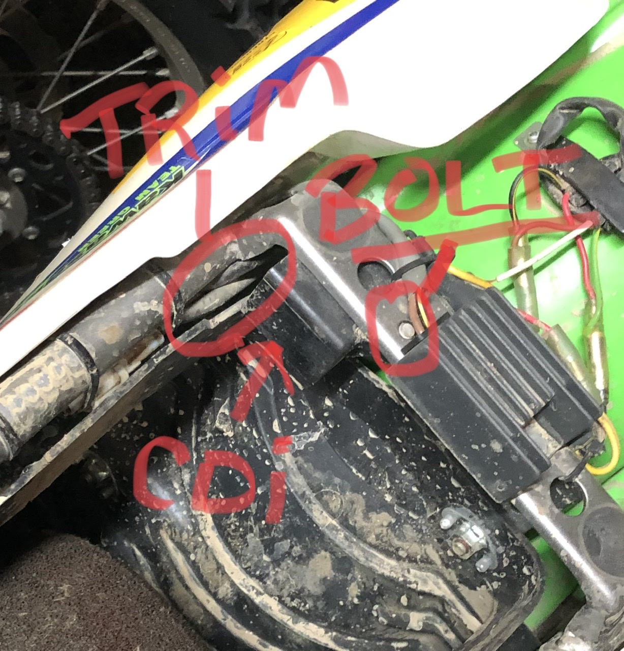

I told him I’d pulled the snorkel, but my lid remained in unmolested condition because I was worried about where I should move the CDI that’s attached. He frowned with concern and stated that this is a bad idea because water and mud will just pour in from the hole directly down onto the air filter and soak it. Simply removing the lid isn’t enough either though, you need to fabricate a special flap using quality duct tape (Gorilla Tape), that is positioned forward of the filter. This flap prevents detritus from being splashed up and over into the box from below and allows what does come up - to flow down around the filter base and out the bottom.
The CDI placement is absurdly easy. Simply trim away about a quarter inch from the top, trailing edge of the airbox on the clutch clutch side. Then unbolt the CDI from the lid, and rebolt with the same bolt using the available threaded hole found beneath the cross brace behind the box on that same side. Voila!
What the finished project should look like… (after winning another ISDE!)
However, as some of you already know, we’re not done. As he has stated on his website the KDX airbox is famous for allowing water to bypass the filter at the boot.

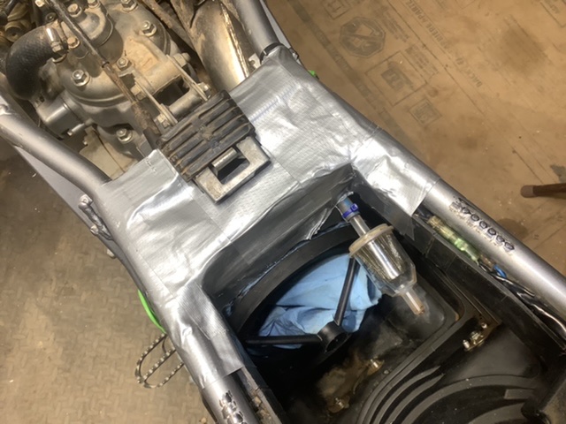

Fredette’s Airbox Mod - Part Two… or Waking up the Beast
Here are some pix of the process of eliminating the lid, installing a muck shield, re-locating the CDI, and sealing up the carburetor boot / airbox interface with a silicone gasket maker type sealant.
When I started, I thought I’d just pull the shrouds and seat, however as I got in there, I realized it was worthwhile to pull the tank, the rear fender, and especially the rear brace that sweetly pivots out of the way after removing the upper bolt. Doing this allows you to easily pull the boot and box for cleaning. Some of these pix show how far I got before finally biting that bullet.
I pulled the boot off the carb first, then stuffed a clean towel into the carb.
After removing the CDI (one bolt), I pulled the lid.

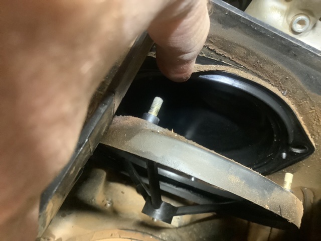

There are four 8mm nuts holding a metal ring at the front of the airbox, they release the soft, pliable carb boot held by the air filter cage. With them removed then you can pull out the cage.
Here you can see how easy it is to peel the boot from inside the airbox and pull it out. My airbox was filthy and just needed to come on out and get scrubbed in the deep sink. After close examination of the box, I couldn’t find where any contamination had snuck through yet, so that was a relief.
Wanting to scrub the filthy airbox I decided to get serious and removed the tank, the rear fender and the brace to ease access to everything else. After pulling the tank I found some other things that needed attention that I would have missed (dry-rotted radiator bushings).
The box and boot soaked in my deep sink with hot water, Simple Green and Dawn. Once every thing was scrubbed and dried I used some Versachem Super Blue 2 to liberally coat the interfaces between the boot and the box. I also applied some on the threads of bolts to act as blue threadlocker on reassembly.
I threaded the nuts back onto the cage and tightened everything back together. After wiping off the excess sealant, I slipped the boot and box assembly back into the frame as one unit. Pulled the rag from the carb, slipped the box boot onto the carb, and began reattaching the box to the frame.
Above you can see the crankcase breather hose with air breather filter (NAPA Part #3011) reinstalled.
Below is the CDI in it’s new home, flipped upside down and tucked beneath the cross brace with the same bolt holding it in the previously unused threaded hole. The upper left corner 1/4” of the airbox has been Dremeled out to accommodate the the CDI. There’s just enough wire harness slack to allow this relocation as if it was originally intended.
Once everything was reassembled I gave her a test run. I’m still healing up my throttle wrist, but can brraapp with very little discomfort. The power ol’ girl is making now from 1/3 open and up is pretty amazing. In 6th gear she continues to accelerate hard where before she just flattened out. She has woken up and feels more like a 250. It’s going to be interesting to see what this #7 slide does at the bottom end.
