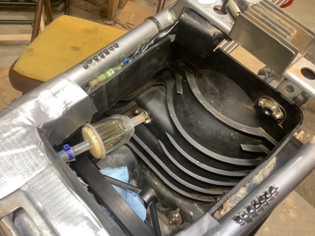

Fredette’s Airbox Mod - Part Two… or Waking up the Beast
Here are some pix of the process of eliminating the lid, installing a muck shield, re-locating the CDI, and sealing up the carburetor boot / airbox interface with a silicone gasket maker type sealant.
When I started, I thought I’d just pull the shrouds and seat, however as I got in there, I realized it was worthwhile to pull the tank, the rear fender, and especially the rear brace that sweetly pivots out of the way after removing the upper bolt. Doing this allows you to easily pull the boot and box for cleaning. Some of these pix show how far I got before finally biting that bullet.
I pulled the boot off the carb first, then stuffed a clean towel into the carb.
After removing the CDI (one bolt), I pulled the lid.

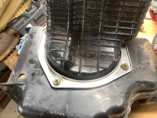

There are four 8mm nuts holding a metal ring at the front of the airbox, they release the soft, pliable carb boot held by the air filter cage. With them removed then you can pull out the cage.
Here you can see how easy it is to peel the boot from inside the airbox and pull it out. My airbox was filthy and just needed to come on out and get scrubbed in the deep sink. After close examination of the box, I couldn’t find where any contamination had snuck through yet, so that was a relief.
Wanting to scrub the filthy airbox I decided to get serious and removed the tank, the rear fender and the brace to ease access to everything else. After pulling the tank I found some other things that needed attention that I would have missed (dry-rotted radiator bushings).
The box and boot soaked in my deep sink with hot water, Simple Green and Dawn. Once every thing was scrubbed and dried I used some Versachem Super Blue 2 to liberally coat the interfaces between the boot and the box. I also applied some on the threads of bolts to act as blue threadlocker on reassembly. I threaded the nuts back onto the cage and tightened everything back together. After wiping off the excess sealant, I slipped the boot and box assembly back into the frame as one unit. Pulled the rag from the carb, slipped the box boot onto the carb, and began reattaching the box to the frame.
Above you can see the crankcase breather hose with air breather filter (NAPA Part #3011) reinstalled.
Below is the CDI in it’s new home, flipped upside down and tucked beneath the cross brace with the same bolt holding it in the previously unused threaded hole. The upper left corner 1/4” of the airbox has been Dremeled out to accommodate the the CDI. There’s just enough wire harness slack to allow this relocation as if it was originally intended.
Once everything was reassembled I gave her a test run. I’m still healing up my throttle wrist, but can brraapp with very little discomfort. The power ol’ girl is making now from 1/3 open and up is pretty amazing. In 6th gear she continues to accelerate hard where before she just flattened out. She has woken up and feels more like a 250. It’s going to be interesting to see what this #7 slide does at the bottom end.
