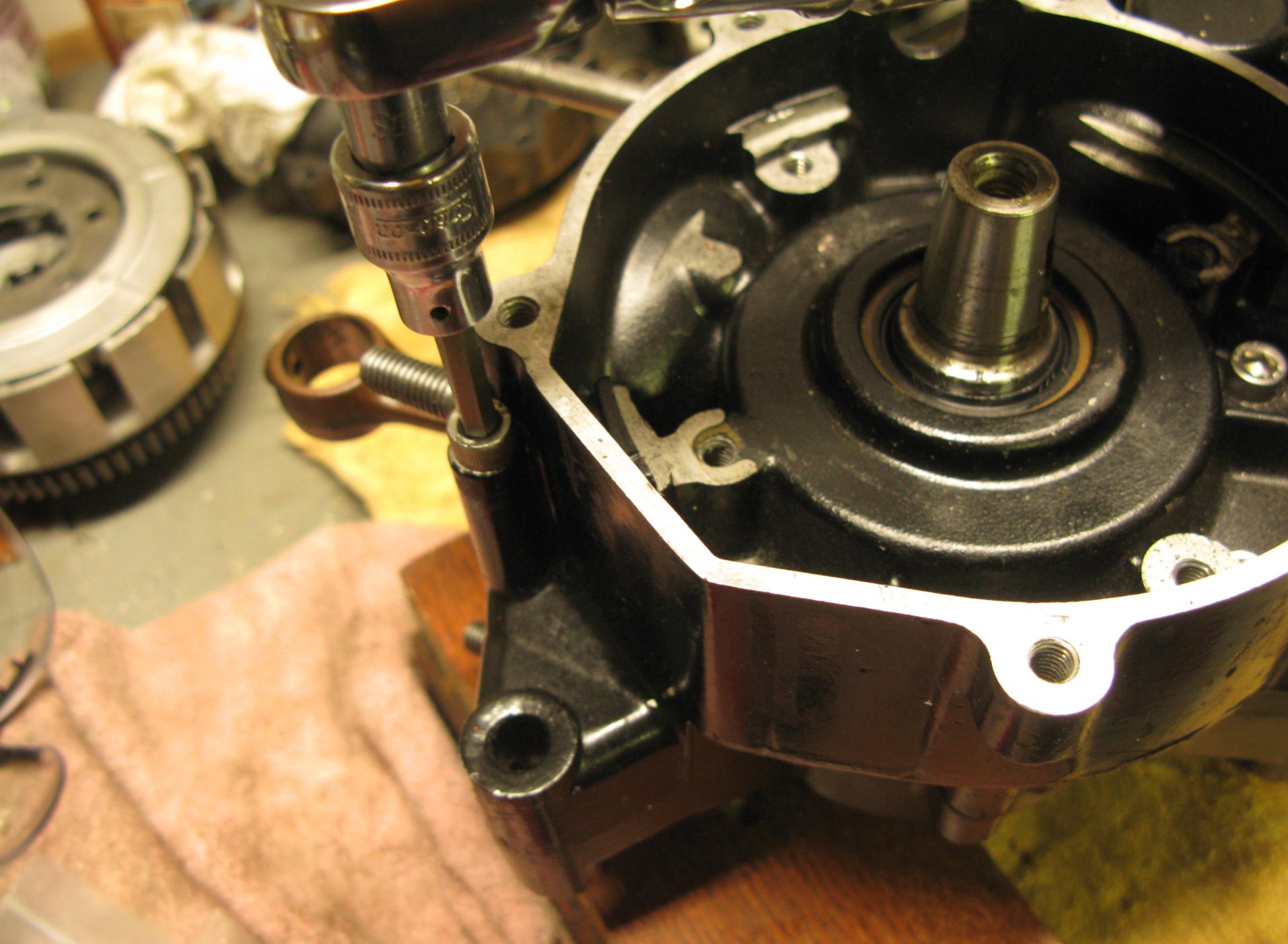

Torqued the cases (new hex head screws make this 10 times more enjoyable :-). Just a bit of red sealer squeezed out - great! The stuff stays gooey when exposed to air, really does not solidify like silicone, but it is always better to avoid too much and leaving blobs on the inside :grin:

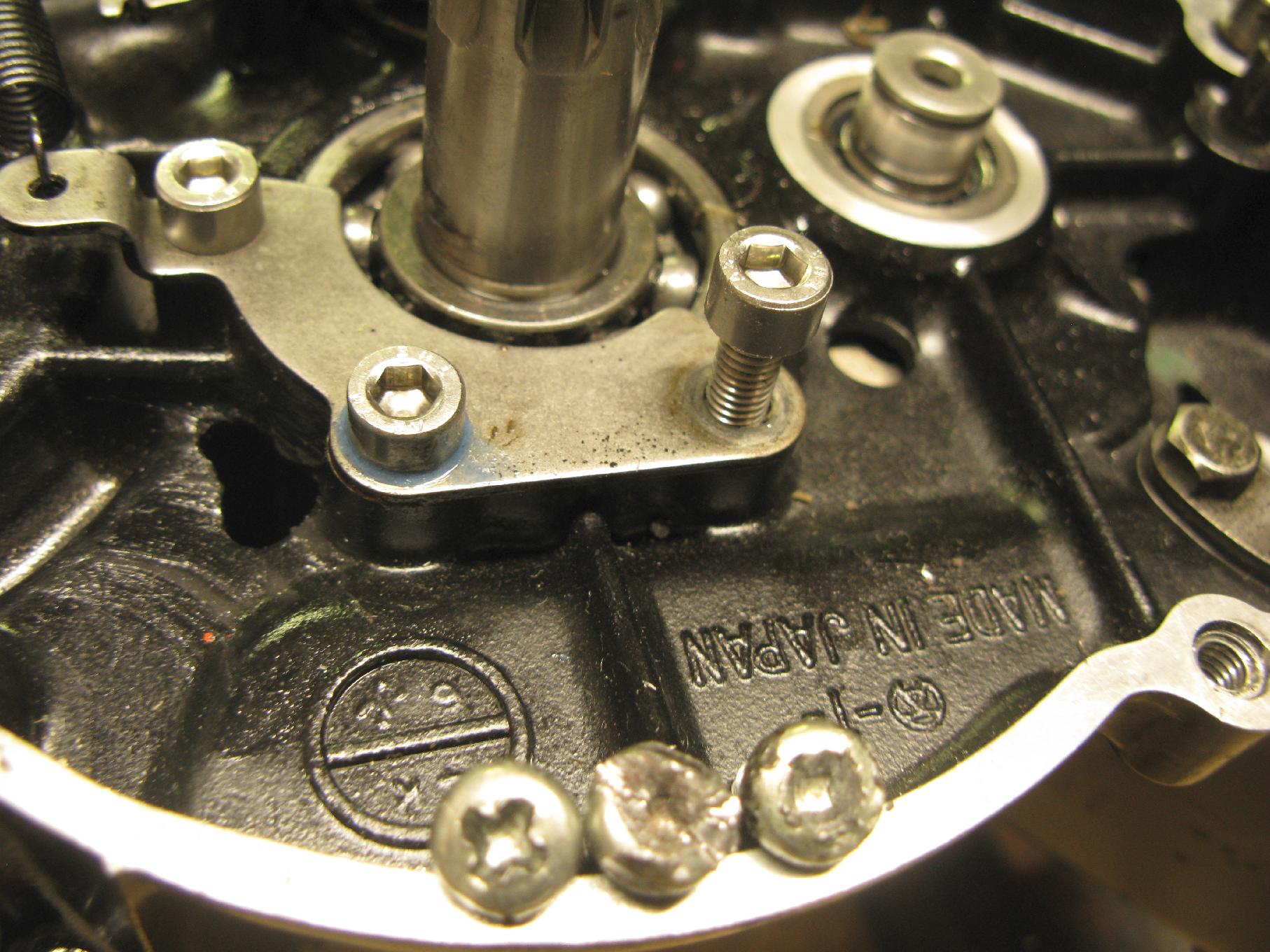

The last few hex-headed screws came in so I did some more engine assembly. Some of the old screws look like they have been in and out one time to many.
New screws!
_click image to zoom_

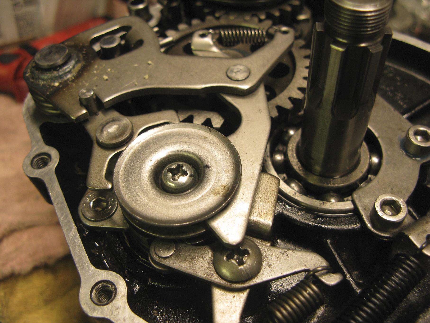

A couple of the screws in the kick-start and shifter components have shoulders that replacements would not have - the originals were in good shape so I re-used them.
Shifter assembly
Using a torque wrench (instead of an impact driver) is really nice :grin:
Screws were torqued to 6.3 lb-ft

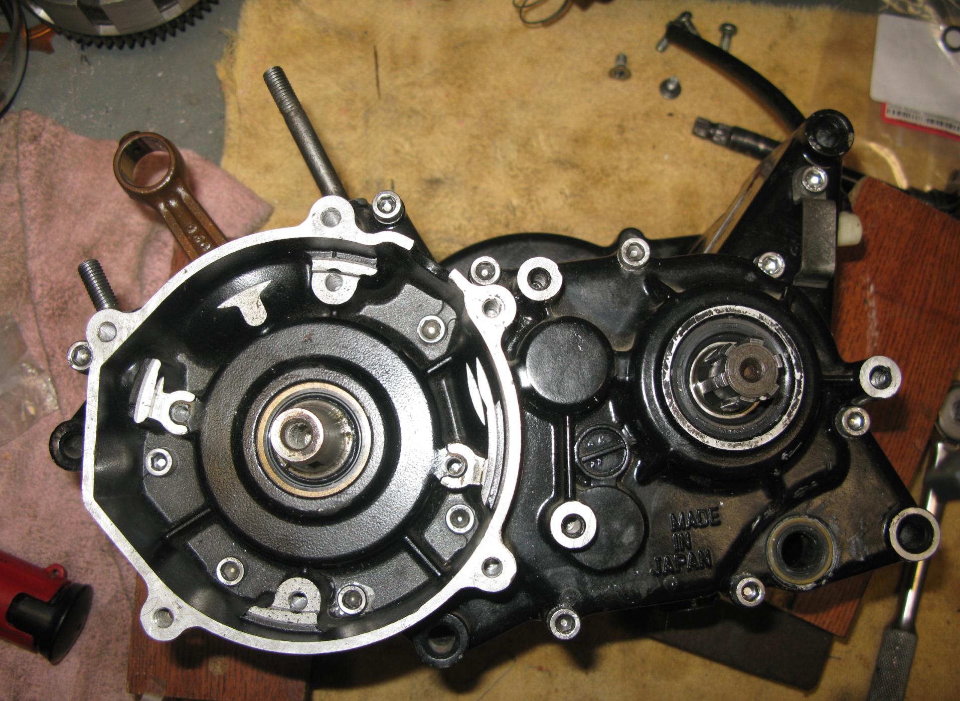

The generator side has a total of 21 screws
Generator side
The clutch side has a total of 15 screws.

I replaced the original engine case screws (Phillips or JIS) with hex head screws where possible for two reasons, 1) some of the old screw had stripped heads, and, 2) the hex head allows the use of a torque wrench. Plus, stainless steel screws just look nice :grin:

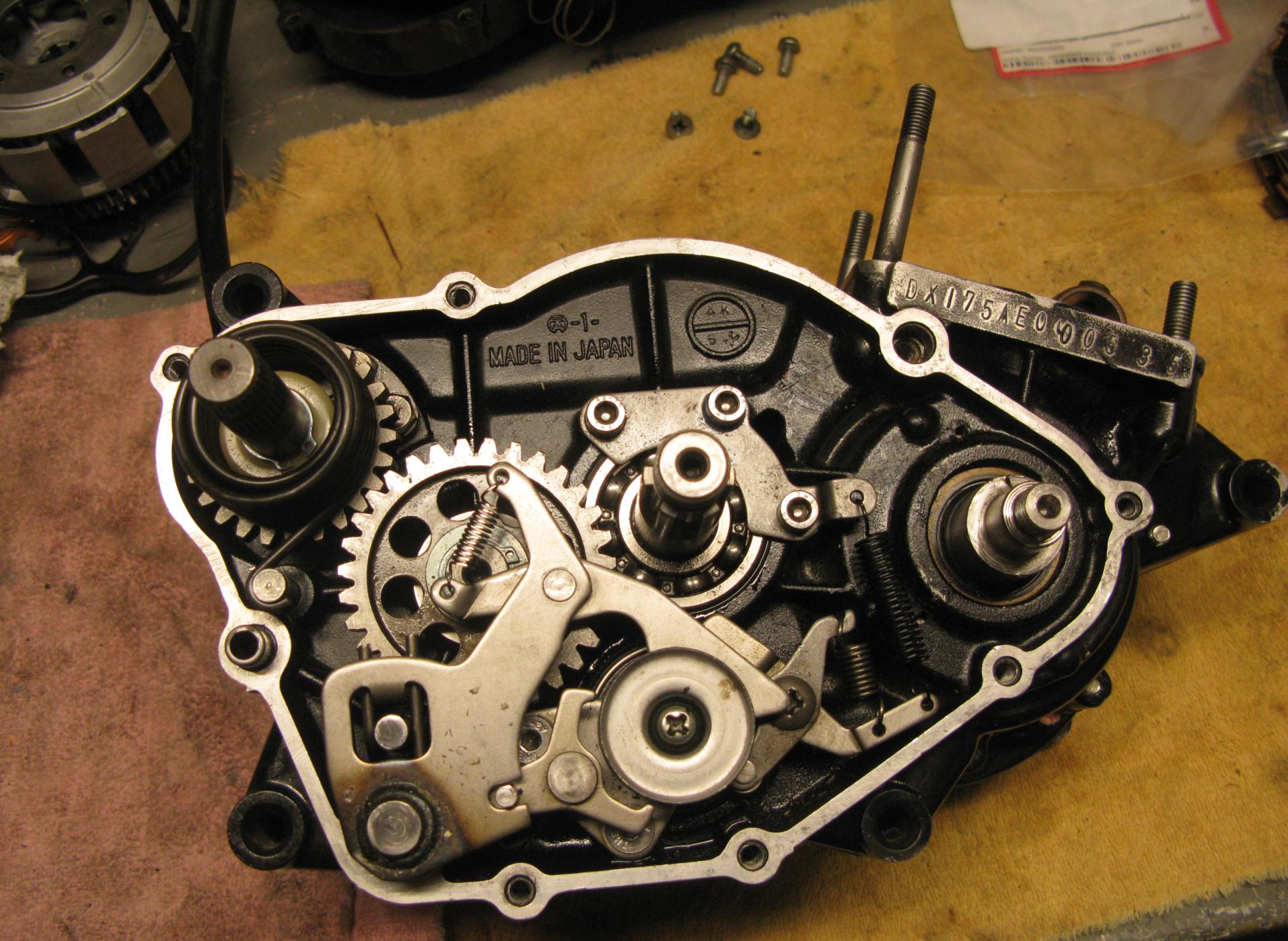

I replaced 13 screws on the clutch side and 21 screws on the generator side for a total of 34 screws. I kept a couple of the original shift pivot screws (shown in the picture) because they looked to have an extra shoulder that new screws would lack and they were in good shape.
All but two screws are socket cap Metric Socket Screws. The Stopper Assembly Change Drum takes two screws ( number 11 on the Partzilla diagram ) that are socket flat head Metric Socket Screws. Note that the length of the flat head screw is the complete length and not just the shank length (see following diagram) - I found this out when the new ones were too short. The flat head screws also have a taper which was plenty close to the original.

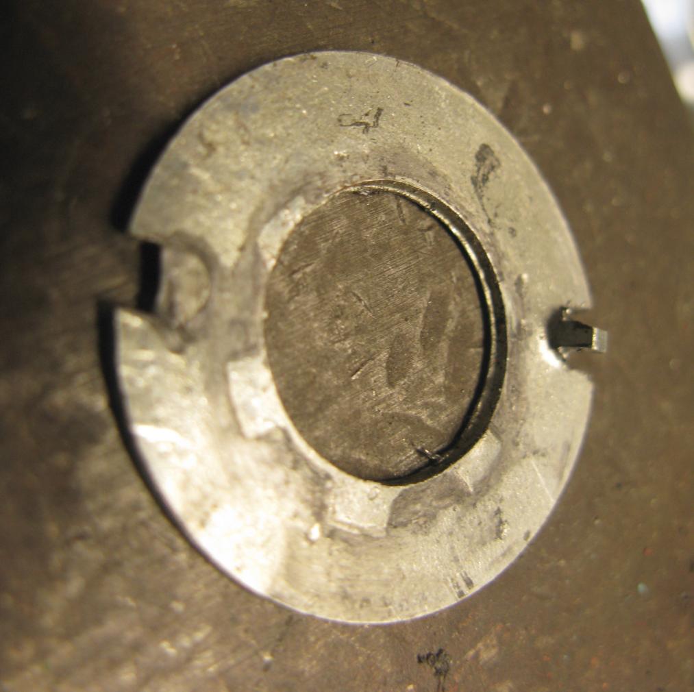

Starting on clutch re-assembly, I noticed a tab was missing on the washer (left side).
Made a new tab

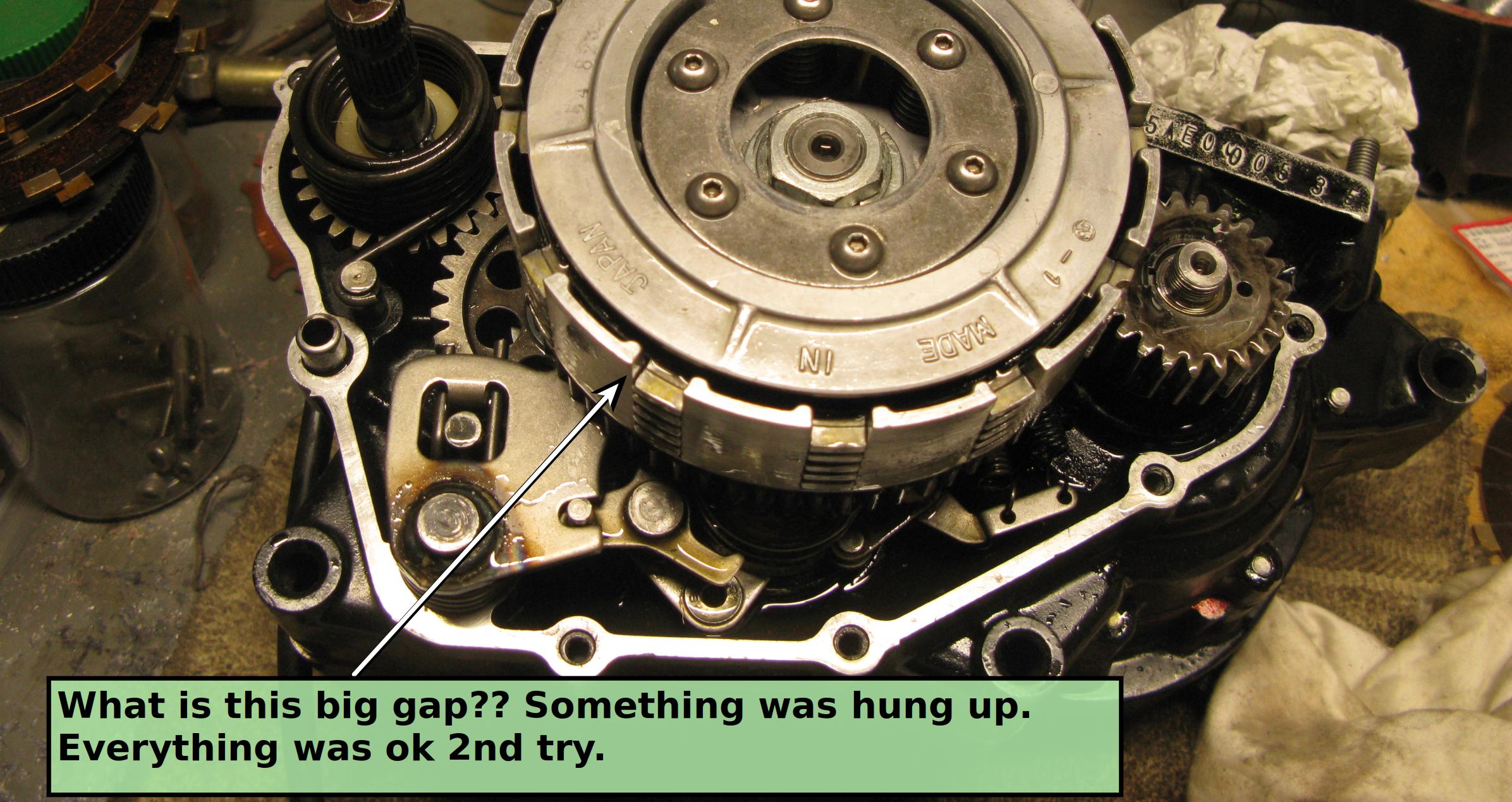

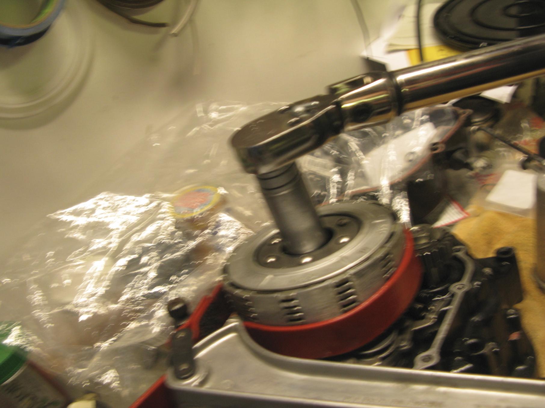

A couple of cuts and a little hammering produced a new tab. All set, time to pack the disks. The outer disks (friction) were binding slightly in the slots until I used the wire wheel to remove some kind of conformal coating (anti-rust?) from the edges of the tabs. Assembly proceeded but, then, while tightening the clutch hub nut to 35 lbs-ft - snap! - and nut and shaft were turning freely :blink:
Torquing the clutch hub nut
I got lucky with this before pic I happened to take - it shows that I did something wrong and there is a big gap between the top friction disks and the top hat.
Clutch disks were not seated
After un-doing everything, I could see that my new tab was sheared off from the washer - that must have been the snap (much relief :-)
I cut a (another) new, slightly larger, tab in the washer and assembly try number two was normal.
In retrospect, is seems like I did two things wrong. 1) I cut the first tab too small (narrow) and it sheared off, and, 2) I failed to notice that something was hanging up and the clutch pack was not fully compressing. There was enough friction to hold but only up to about 10-15 lbs-ft at which point there was nothing to keep the shaft from rotating.
All seems well now and the shifting into each gear feels fine.

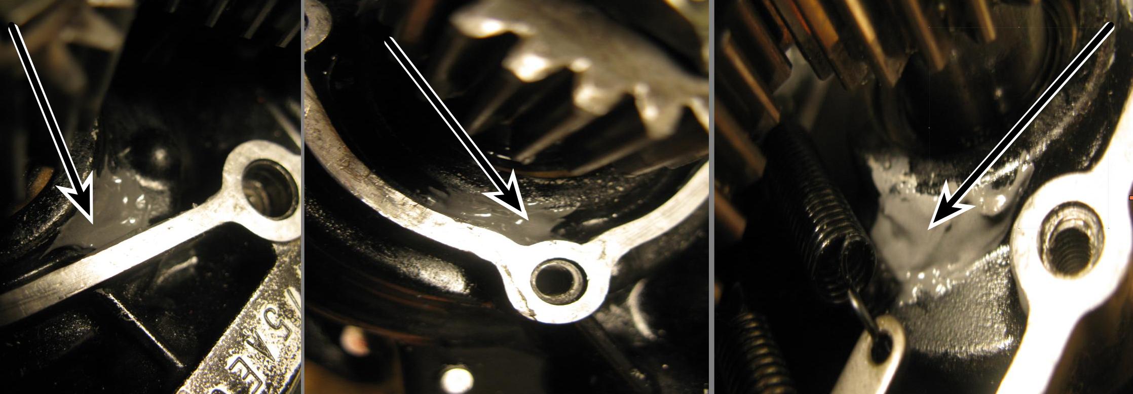

No psi (?) was achievable but I think I see why. I can hear air escaping as fast as I pump it in. Listening around led me to the crank gear - and then I remembered: while cleaning the engine case halves some time back, I noticed three small holes (1/8" or so) under the crank bearing on the clutch side. I scraped out the RTV and forgot about them. This seems to be where the air is coming from. These two pics show the holes:
Mystery holes
Digging through the KDXRider archives (invaluable resource - much appreciated!), it seems similar to this page that KDXGarage referred to in a different thread.
Kawasaki KX oval plugs
I wonder if these holes are ever useful for anything? My inclination is to clean them and then fill with JB Weld.
Posted: 02:07 am May 12 2021
Pretty please tell me some jackass did not drill them and use them to push out the bearing.
Posted: 06:58 am May 12 2021
by Goofaroo
It appears that KDXGarage is correct and someone drilled it to remove the bearing and used RTV to seal it back up.
Ideally it would have been addressed before reassembly but you should be able to get a good seal with your JB Weld strategy.

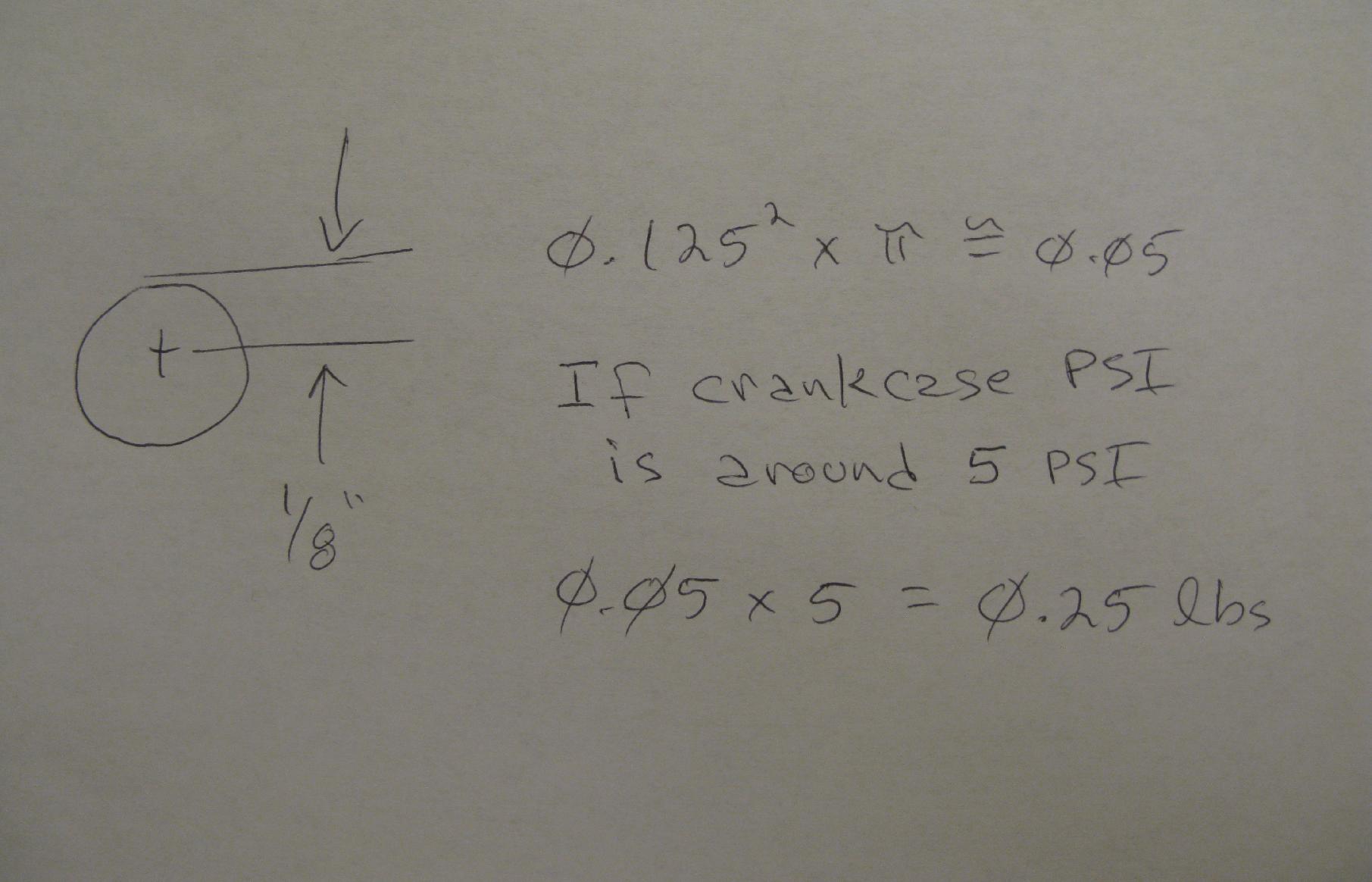

JB Weld applied in three places:
Mystery holes plugged
A quick check indicates that the force on the JB Weld plugs is under 1/4 lb.
Worst case force estimation
I think it will hold!

Don't come up on here doing no math now. :-)
You are welcome on all previous suggestions.
Posted: 12:48 am May 13 2021
by HopFrog175
Heh, I had to do something while waiting for the epoxy to harden :whistle:
