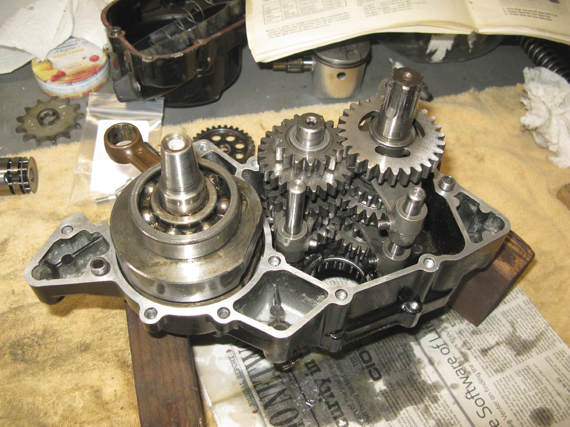

Got everything cleaned up and new seals in: crank, output shaft, kick-start, shifter.
Going back together
_click image to zoom_

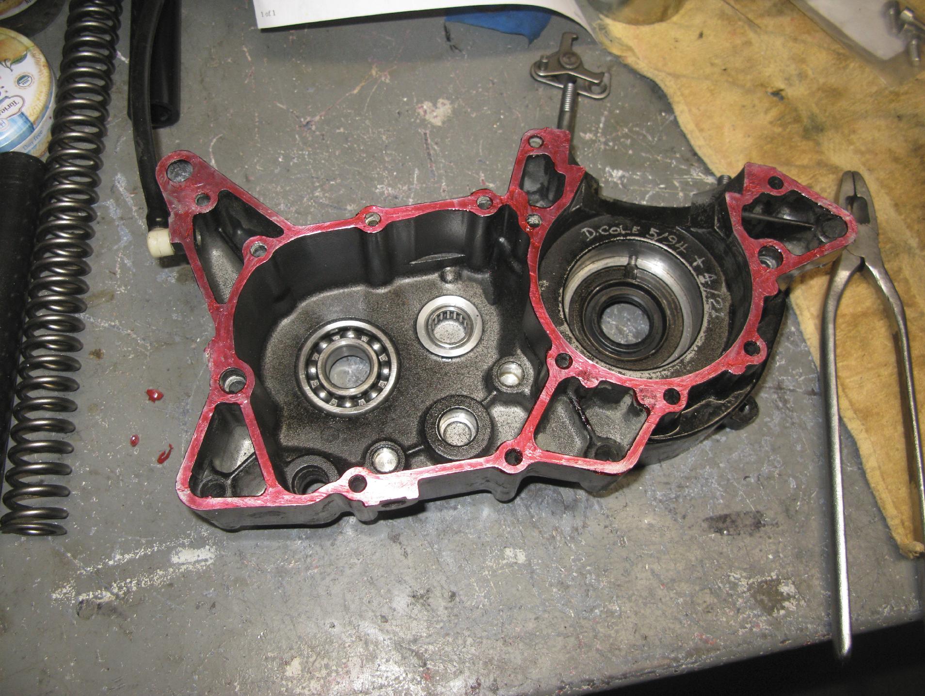

I used the Loctite 518 (see previous post). First step is to spray the clear activator on the mating surfaces and then a thin layer of the red 518 onto one surface.
Red flange sealer

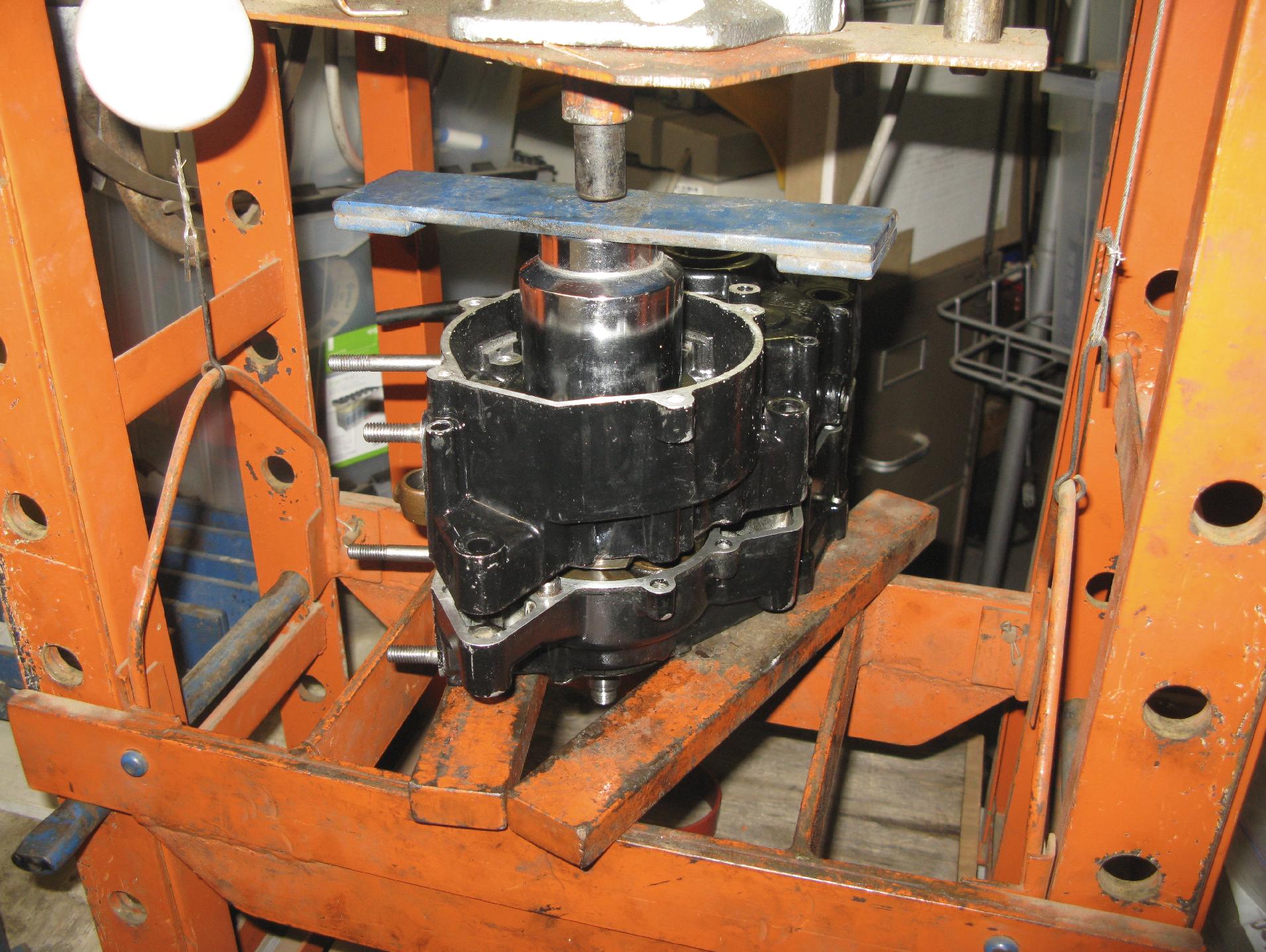

After carefully lining everything up (and wedging the crank opposite the crank pin with a chisel), the pressing went smooth and easy.
Pressing the engine together

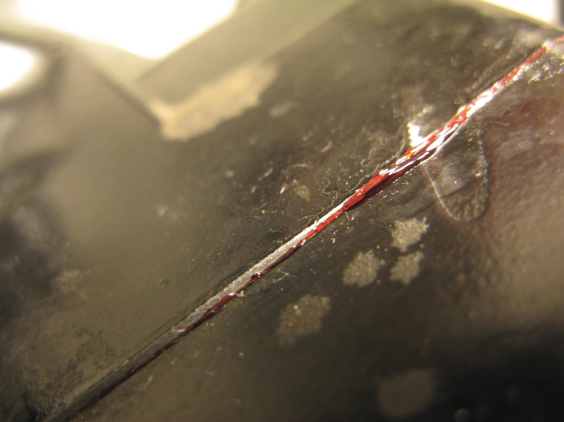

Torqued the cases (new hex head screws make this 10 times more enjoyable :-). Just a bit of red sealer squeezed out - great! The stuff stays gooey when exposed to air, really does not solidify like silicone, but it is always better to avoid too much and leaving blobs on the inside :grin:
Thin layer, not much squeezes out

Any reason you went with that instead of Kawabond 5 or other ThreeBond equivalents (Permatex MotoSeal, etc.)?
Actually, I am not familiar with Kawabond or ThreeBond - I am happy to learn tho :grin: I have used Yamabond years ago and it seemed fine. I have a leaning towards Loctite products and like to use them when possible. This seemed like a good application of 518, I had some on the shelf and couldn't resist. I think it will work well and, if not, I will be investigating Kawabond (hopefully nice and green :-)

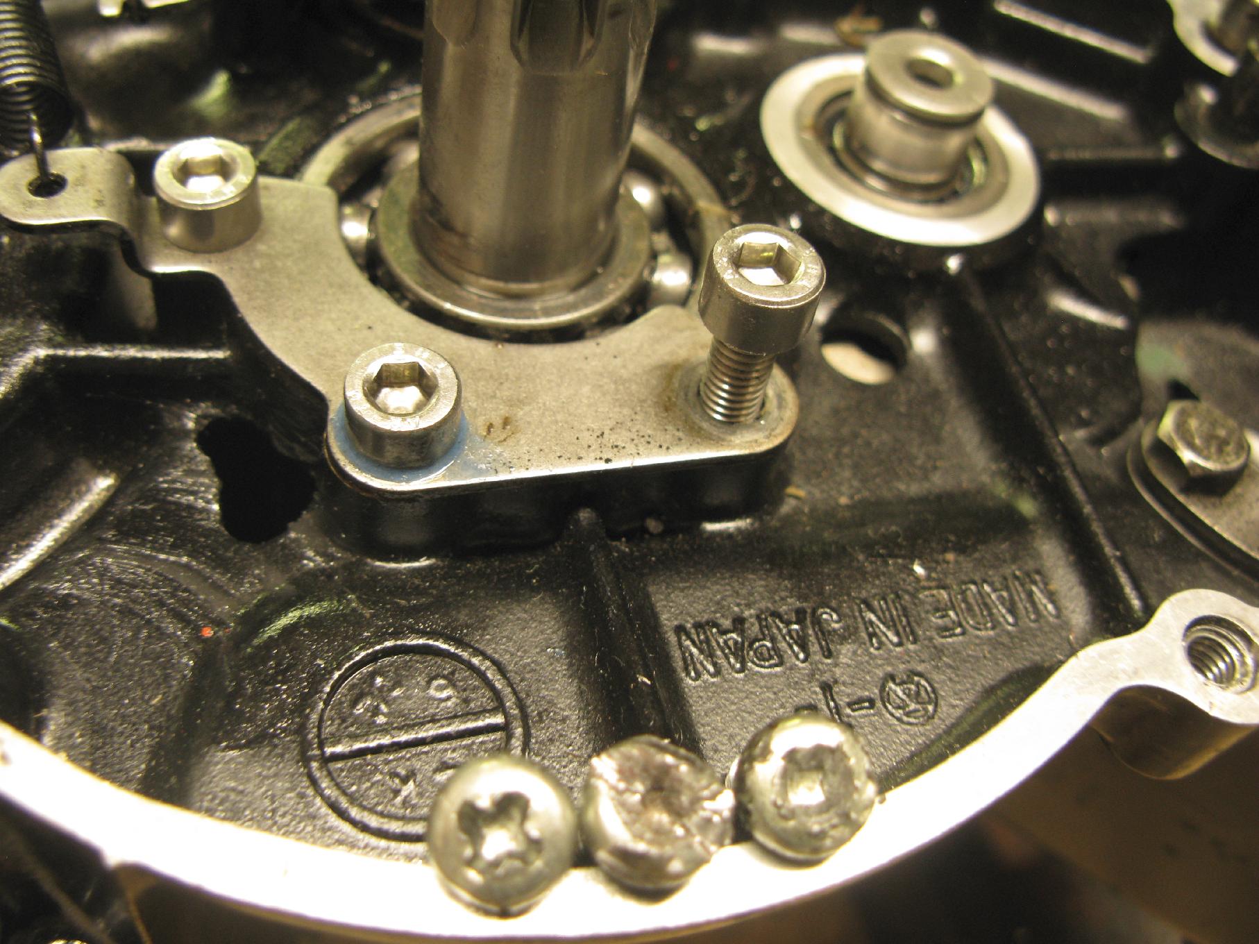

The last few hex-headed screws came in so I did some more engine assembly. Some of the old screws look like they have been in and out one time to many.
New screws!
A couple of the screws in the kick-start and shifter components have shoulders that replacements would not have - the originals were in good shape so I re-used them.
Shifter assembly
Using a torque wrench (instead of an impact driver) is really nice :grin:
Screws were torqued to 6.3 lb-ft

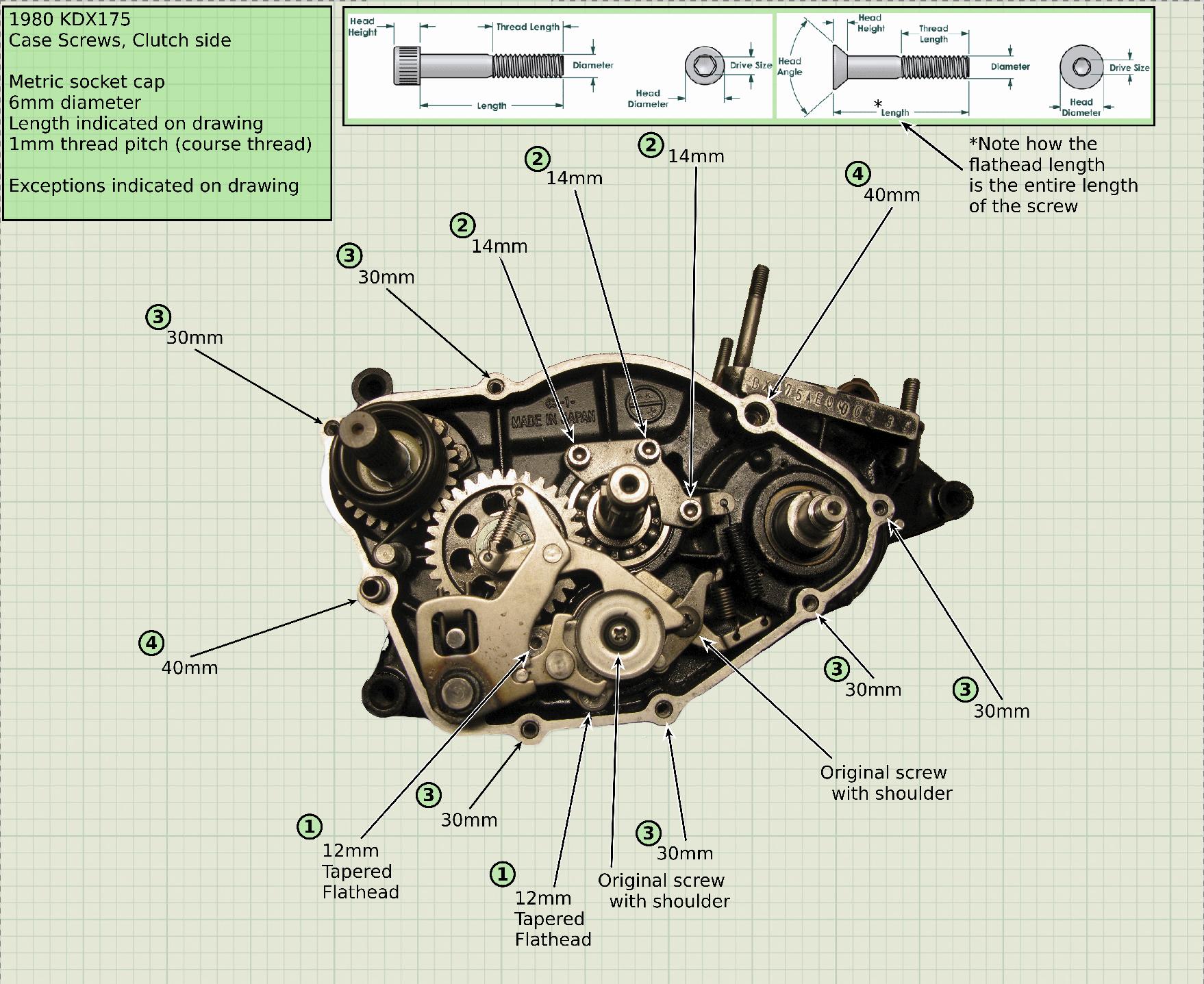

Post by HopFrog175 »

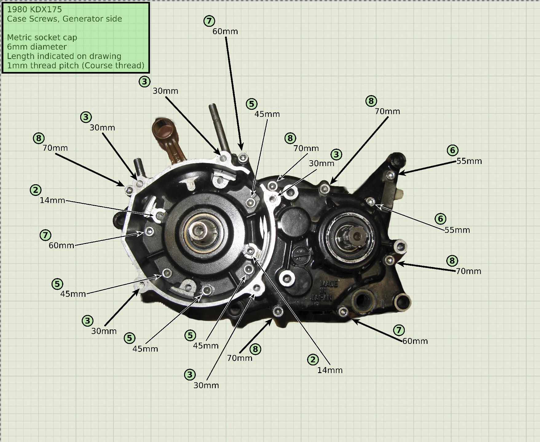

KDX175 Engine Case Screws
I replaced the original engine case screws (Phillips or JIS) with hex head screws where possible for two reasons, 1) some of the old screw had stripped heads, and, 2) the hex head allows the use of a torque wrench. Plus, stainless steel screws just look nice :grin:
I replaced 13 screws on the clutch side and 21 screws on the generator side for a total of 34 screws. I kept a couple of the original shift pivot screws (shown in the picture) because they looked to have an extra shoulder that new screws would lack and they were in good shape.
All but two screws are socket cap Metric Socket Screws. The Stopper Assembly Change Drum takes two screws ( number 11 on the Partzilla diagram ) that are socket flat head Metric Socket Screws. Note that the length of the flat head screw is the complete length and not just the shank length (see following diagram) - I found this out when the new ones were too short. The flat head screws also have a taper which was plenty close to the original.
All of the case screws I replaced were 6mm and I went for stainless 18-8 which is common and cheap. The cost was well under $20 including shipping ( BoltDepot.com ).
Quick list
May 5, 2021
Individual Screws
6mm socket cap Metric Socket Screws except as noted
   diagram number
(see diagram below)     Size     Quantity             Description
        1 .......... 6mm x 12mm      2      socket flat head Metric Socket Screws
        2 .......... 6mm x 14mm      5      socket cap Metric Socket Screws
        3 .......... 6mm x 30mm     11      socket cap Metric Socket Screws
        4 .......... 6mm x 40mm      2      socket cap Metric Socket Screws
        5 .......... 6mm x 45mm      4      socket cap Metric Socket Screws
        6 .......... 6mm x 55mm      2      socket cap Metric Socket Screws
        7 .......... 6mm x 60mm      3      socket cap Metric Socket Screws
        8 .......... 6mm x 70mm      5      socket cap Metric Socket Screws
Clutch side, case screws
Generator side, case screws
Hopefully enough about screws!

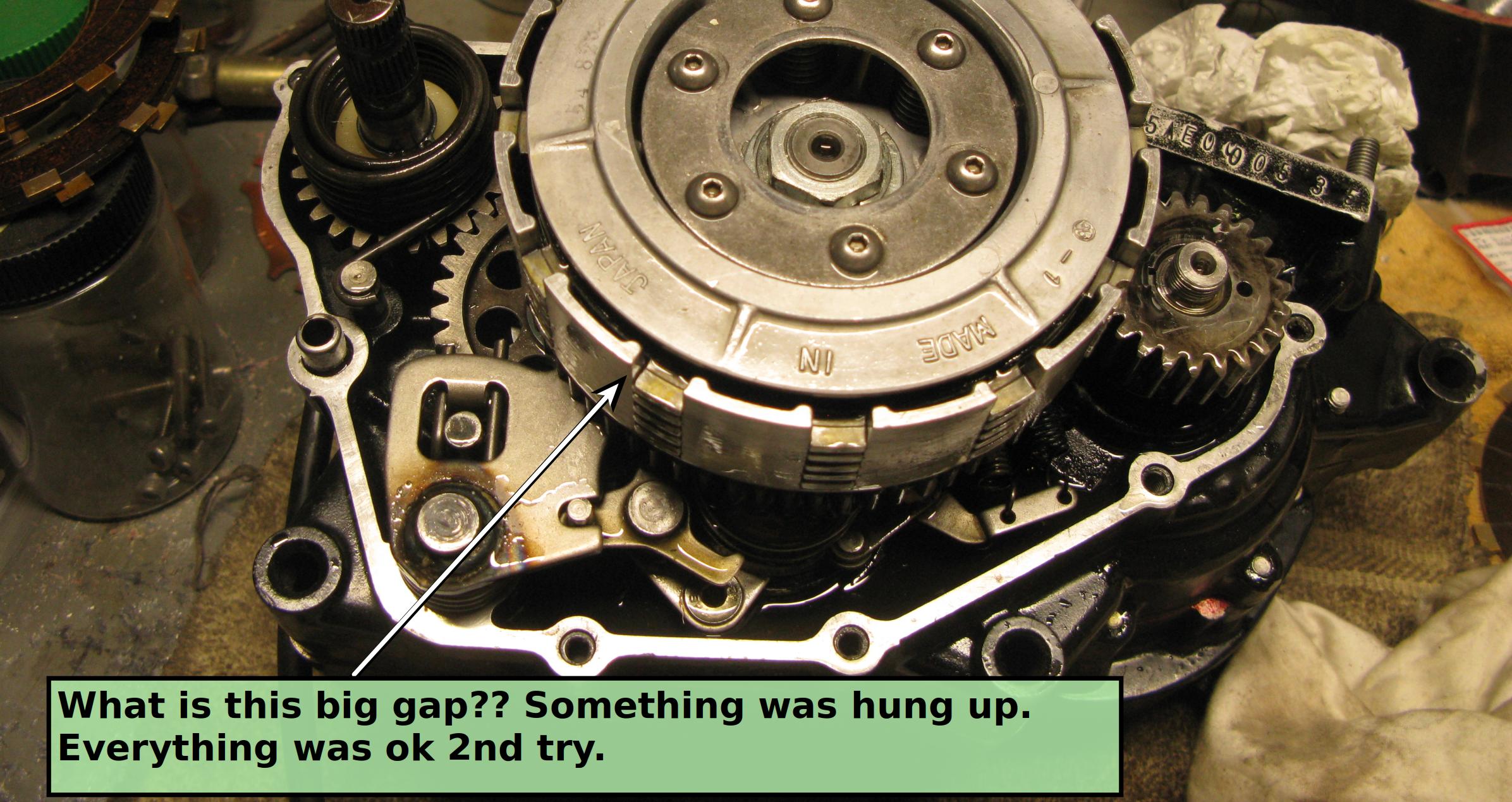

A couple of cuts and a little hammering produced a new tab. All set, time to pack the disks. The outer disks (friction) were binding slightly in the slots until I used the wire wheel to remove some kind of conformal coating (anti-rust?) from the edges of the tabs. Assembly proceeded but, then, while tightening the clutch hub nut to 35 lbs-ft - snap! - and nut and shaft were turning freely :blink:
Torquing the clutch hub nut
I got lucky with this before pic I happened to take - it shows that I did something wrong and there is a big gap between the top friction disks and the top hat.
Clutch disks were not seated
After un-doing everything, I could see that my new tab was sheared off from the washer - that must have been the snap (much relief :-)
I cut a (another) new, slightly larger, tab in the washer and assembly try number two was normal.
In retrospect, is seems like I did two things wrong. 1) I cut the first tab too small (narrow) and it sheared off, and, 2) I failed to notice that something was hanging up and the clutch pack was not fully compressing. There was enough friction to hold but only up to about 10-15 lbs-ft at which point there was nothing to keep the shaft from rotating.
All seems well now and the shifting into each gear feels fine.
Clutch is on.
I followed up with putting on the piston on and torquing down the cylinder. The way things went today, I figure I had better do that leakdown check next :grin:

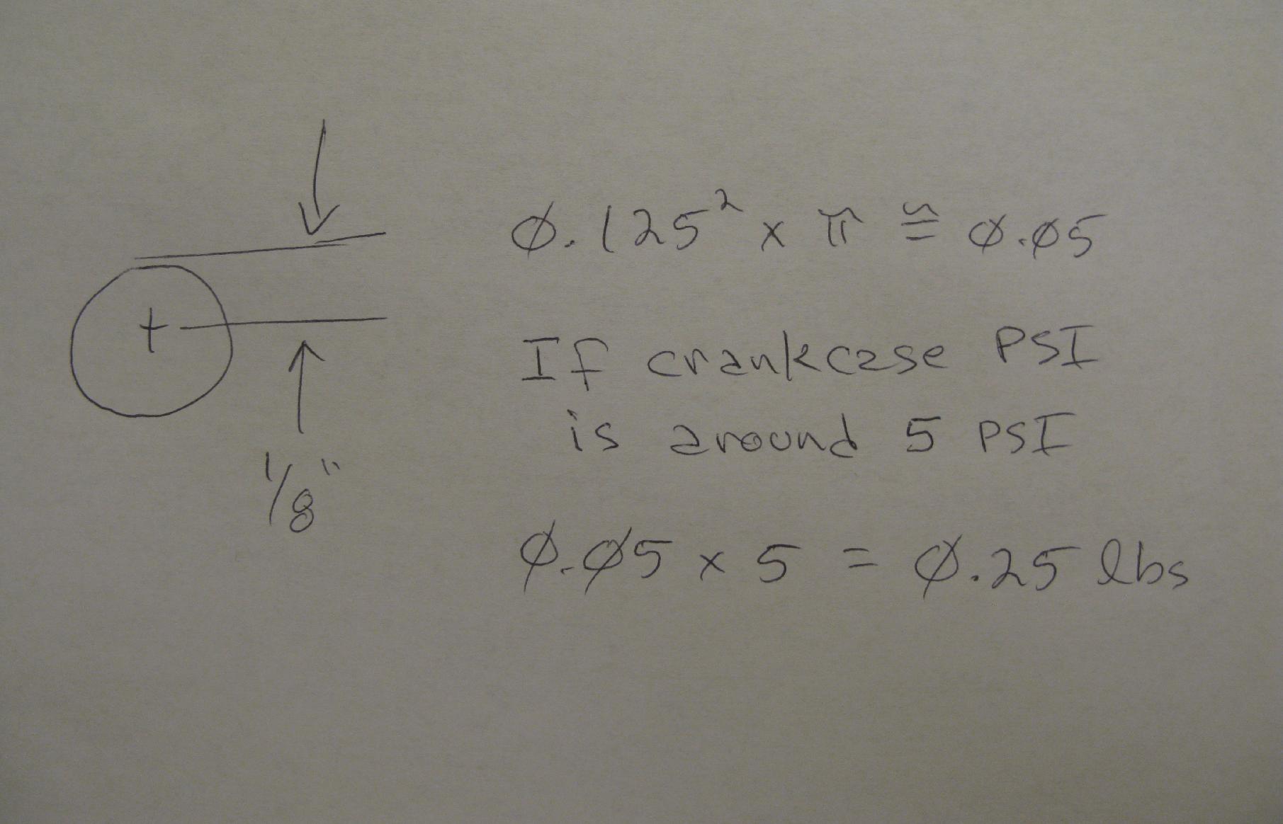

A quick check indicates that the force on the JB Weld plugs is under 1/4 lb.
Worst case force estimation
I think it will hold!

Don't come up on here doing no math now. :-)

Heh, I had to do something while waiting for the epoxy to harden :whistle:
