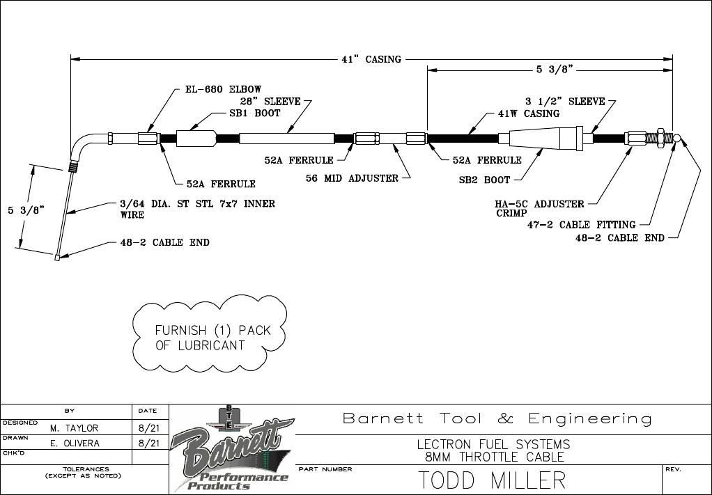

Not the original post about Tyl3r's custom designed Barnett throttle cable for the Lectrons, but this thread has the resulting Barnett Engineering drawing in it of the cable solution. I know for one my cable with fat bar risers on my KLX300R triple clamps is not quite long enough, and routing is very very critical to now get unwanted throttle inputs when turning the handlebars...
viewtopic.php?f=86&t=25306&hilit=Lectron+Barnett
and the drawing:
I sure wish I had seen that before I ordered a spare cable from Lectron that also doesn't fit worth a darn... if I didn't have the carb mounted at an angle due to the VForce3 Reed block making fitment even worse, then the stock Lectron cable offering would REALLY not work. I have the Motion Pro throttle tube Lectron recommends and sells with their package deal.
I'm curious if Lectron machined the spigot sleeve portion per the drawings above in the fitment thread, as it seems to fit quite well otherwise. Hopefully they learned from that.
