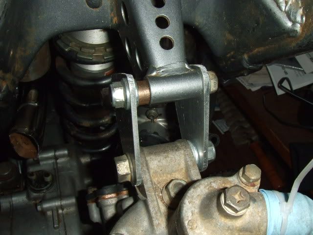

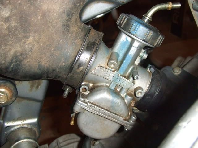

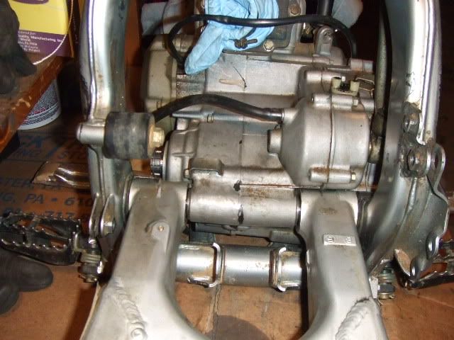

Some progress!

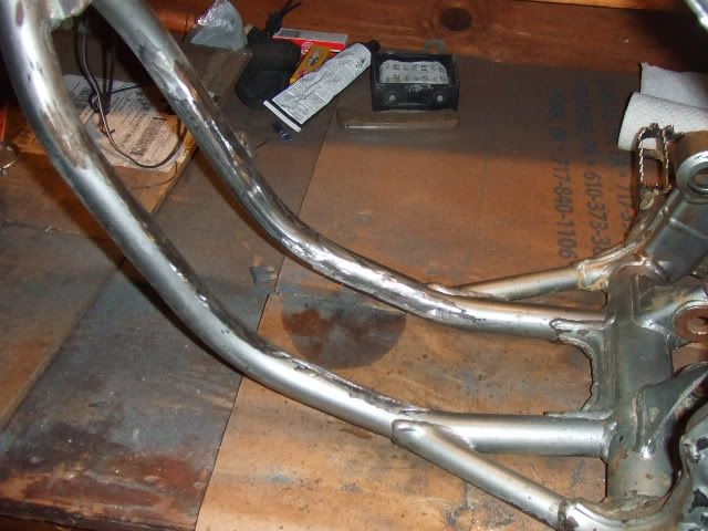

I hacked off the mounts and ground off all remnants of the previous welds.
The swingarm mounted beautifully using the properly cut inner races.

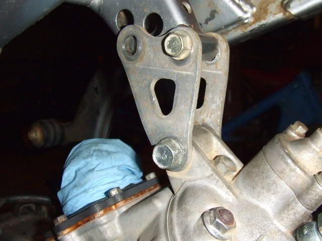

I played a bit with the stock 125's headstay brackets just to get an idea of vertical positioning.
Stock 125 airboot and airbox lines right up. The KDX boot clamp allows enough compression of the too-large boot to seal up with the KDX carb.

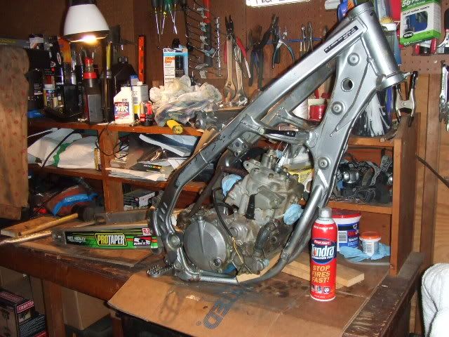

Looking good so far. Time to try the exhaust.

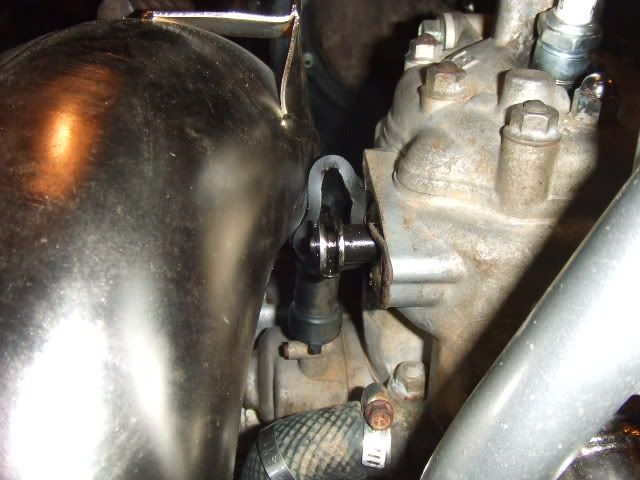

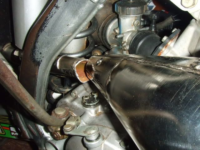

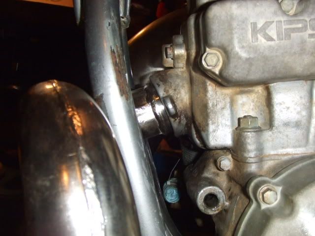

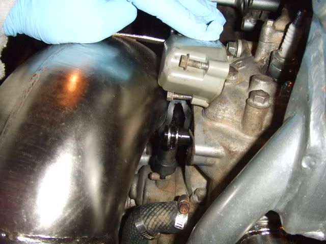

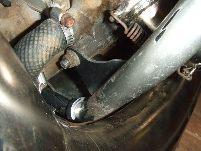

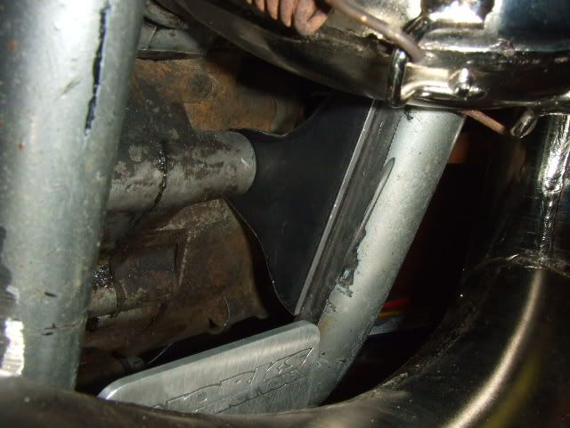

Here's where I have run into a snag with my master plan.
After reading all the hybrid build threads i could, I decided a PC Platinum 2 pipe and KX 250 silencer would work best, likely requiring no mods. The flaw with my plan is that this pipe won't fit an E series engine!!
Looks okay here...
And it's actually okay here, too...
D'Oh!!

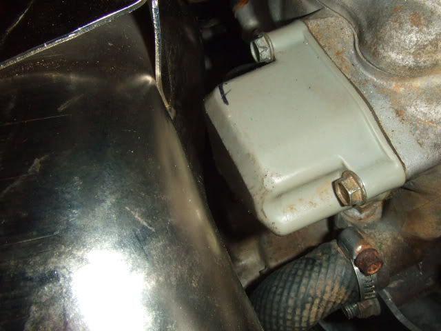

It's going to require a heckuva dent to clear that big ol KIPS thingee.
It's here that I must mention that I don't think anyone has actually done an E series hybrid in a 99-later frame! I'm blazing new territory
So, anyone have pipe mod suggestions?

Break out the BFH! Unless you can return it and get a E pipe.
*** Administrator //***
****'95 KDX 200/****
- Tedh98
- Posts: 1576
- Location: Atlanta, Georgia
Agree.KarlP wrote:I think a dent is called for.
It won't hurt!
Another pipe might clear that cover, but I'd bet it would hit somewhere else. That PC2 pipe fits the frame too well. I think I saw a build where an FMF pipe was used, but it didn't clear the downtube and had to be cut and extended.
Pretty easy to fabricate a dent.

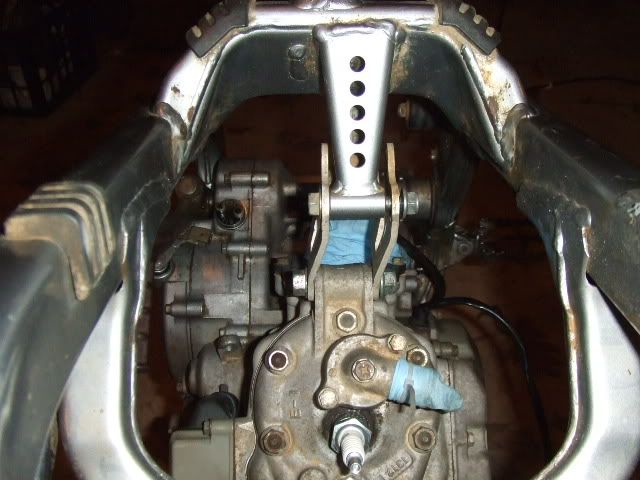

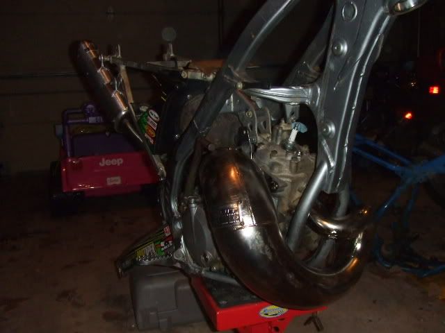

Mo' updatin'...

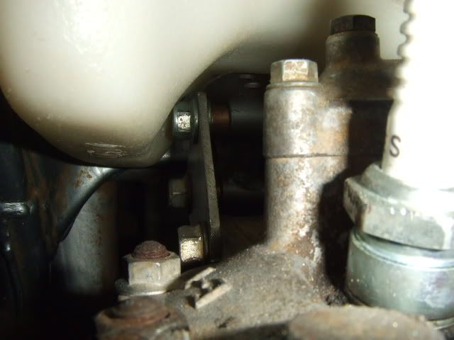

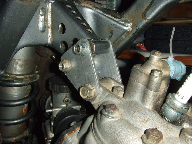

I fabbed up some headstay brackets out of aluminum I bought at Tractor Supply. Initially, I tried to make offset, angled brackets like the KX had originally, but it was beyond my 8th-grade metal shop skills. So, I just made up some flat ones and spacers.
Unfortunately, it looks as if I'll have to get those angled brackets made to clear my IMS tank.
The flat headstay brackets were useful for suspending the motor so I could fab up the other mounts.

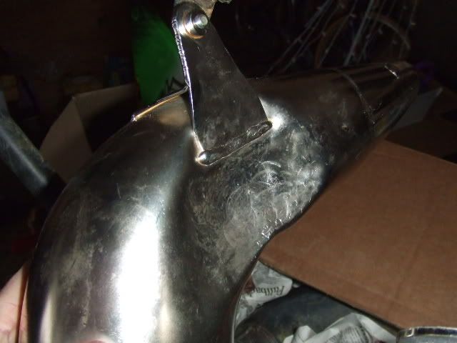

I'm moving the lower pipe mount further back on the frame to match up with the PC mount. However, I'm still not happy with the pipe alignment. I may cut the mounts off the PC pipe so I can optimize the alignment to the stinger and silencer. As you can see, I had to cut the stinger off the pipe because it was coming into hard contact with the airbox. I'll add it to the list of things I need the welder to address.
Here's the expansion chamber post-BFG treatment to clear the KIPS machinery.
If I haven't mentioned it already, I suggest using an H series engine so the pipe fitment is easier!!!
