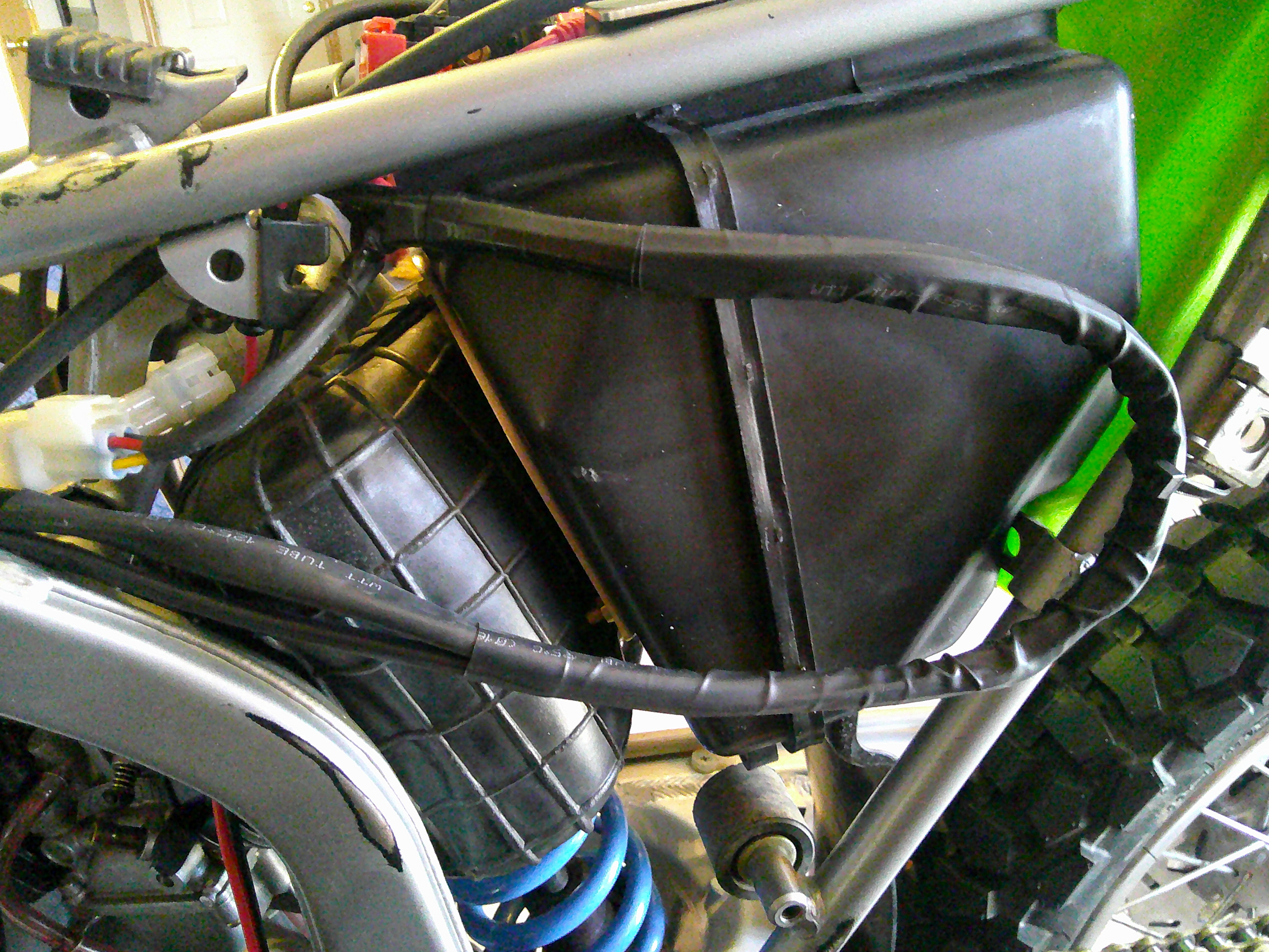

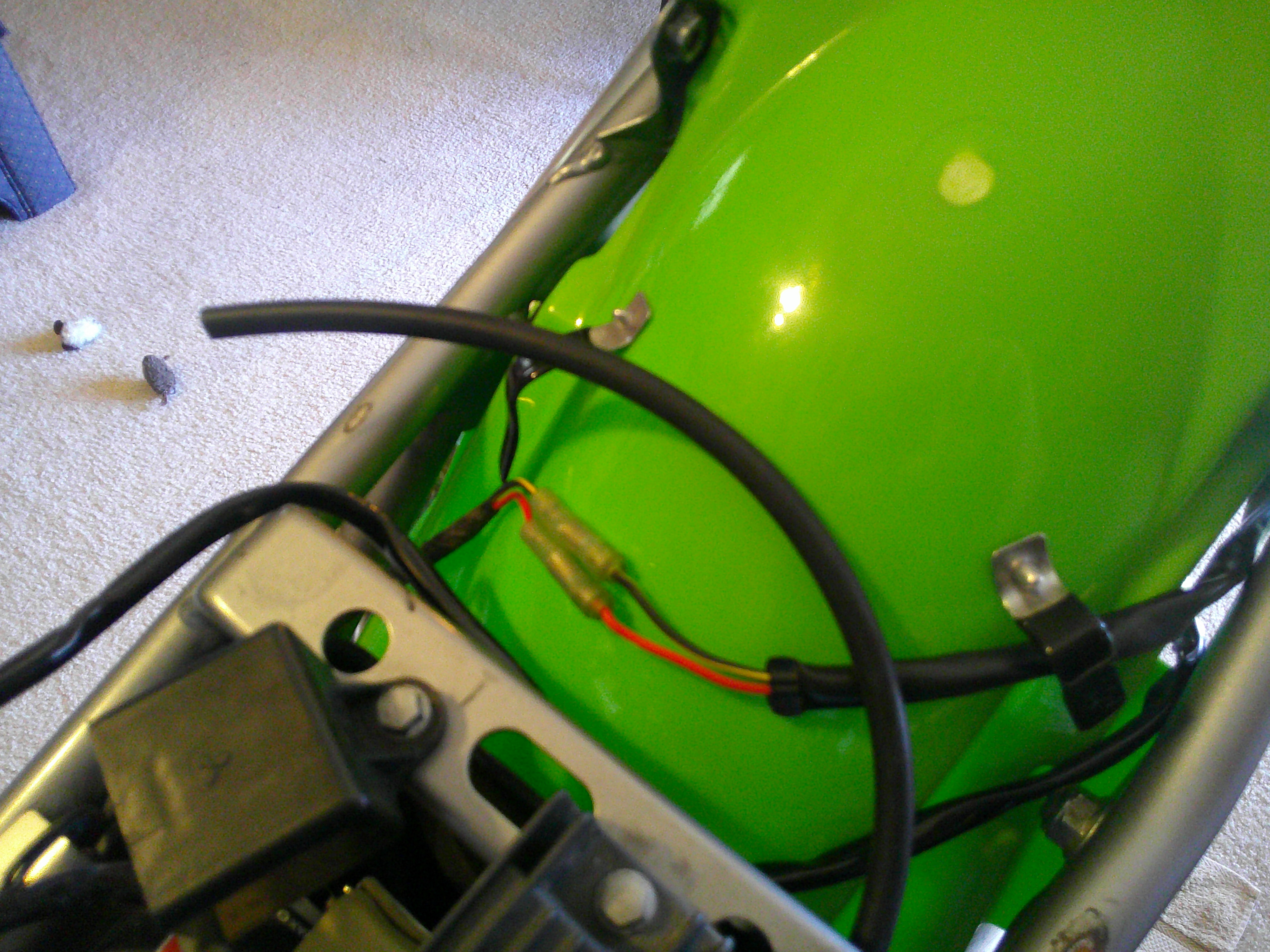

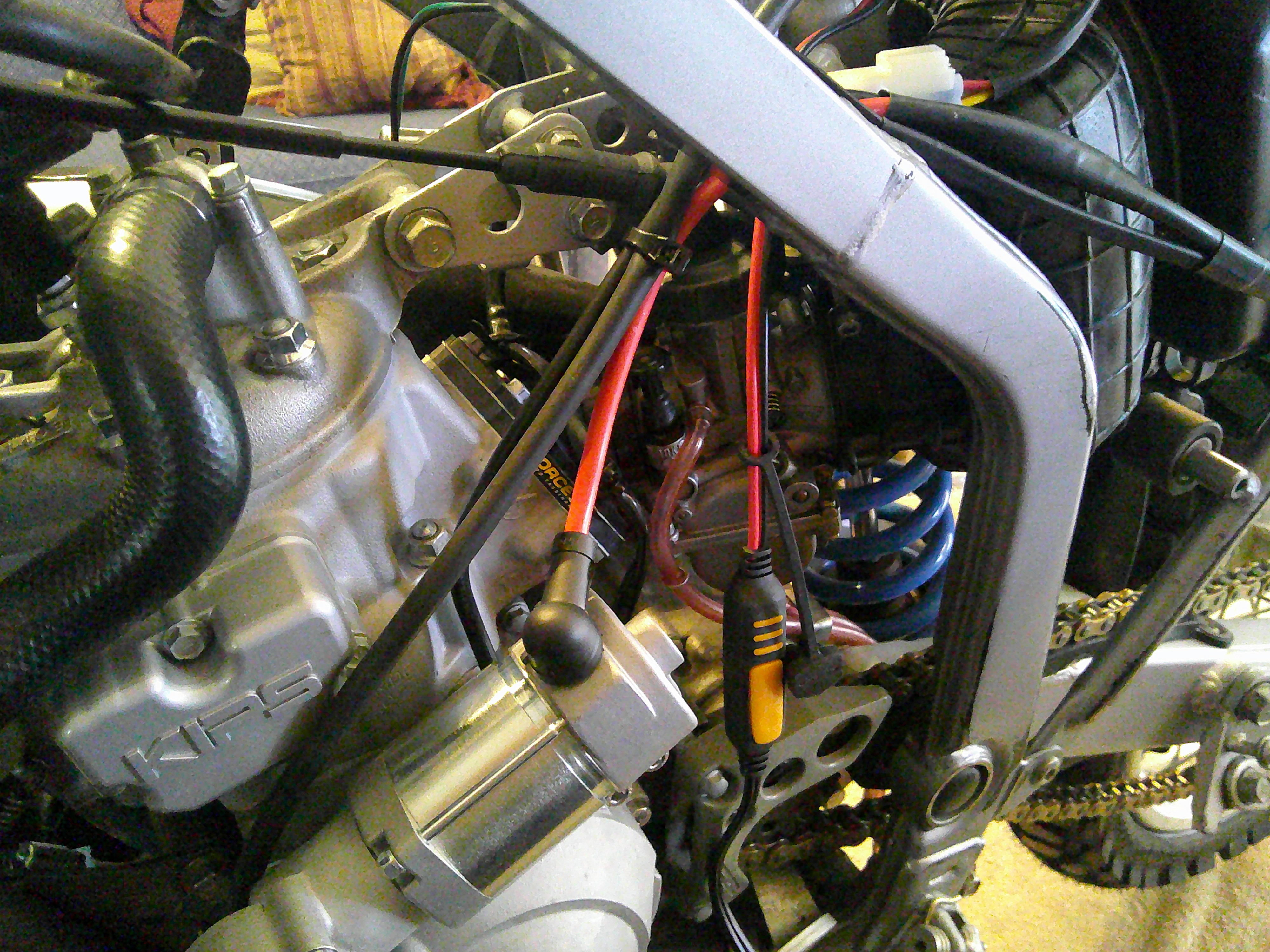

Rubber boot installed. Charging plug installed. I will figure out better routing for this.
I had about 2 extra feet of the main wiring harness to tuck away, so I formed it to fit behind the side cover & zip tied it in place. The rubber tube is the breather for the starter housing. I just routed it up & into the airbox.

Starter turns the engine over like a boss. Starter noise sounds normal. Not loud at all. Starter cover does not interfere with the foot.
Overall, I would give the kit a double thumbs up! Quality kit Easy install. Could be installed in a couple hours if one wanted. If you want one, I recommend it.
It will be a while before I take it out for a ride. I don't anticipate any issues.
