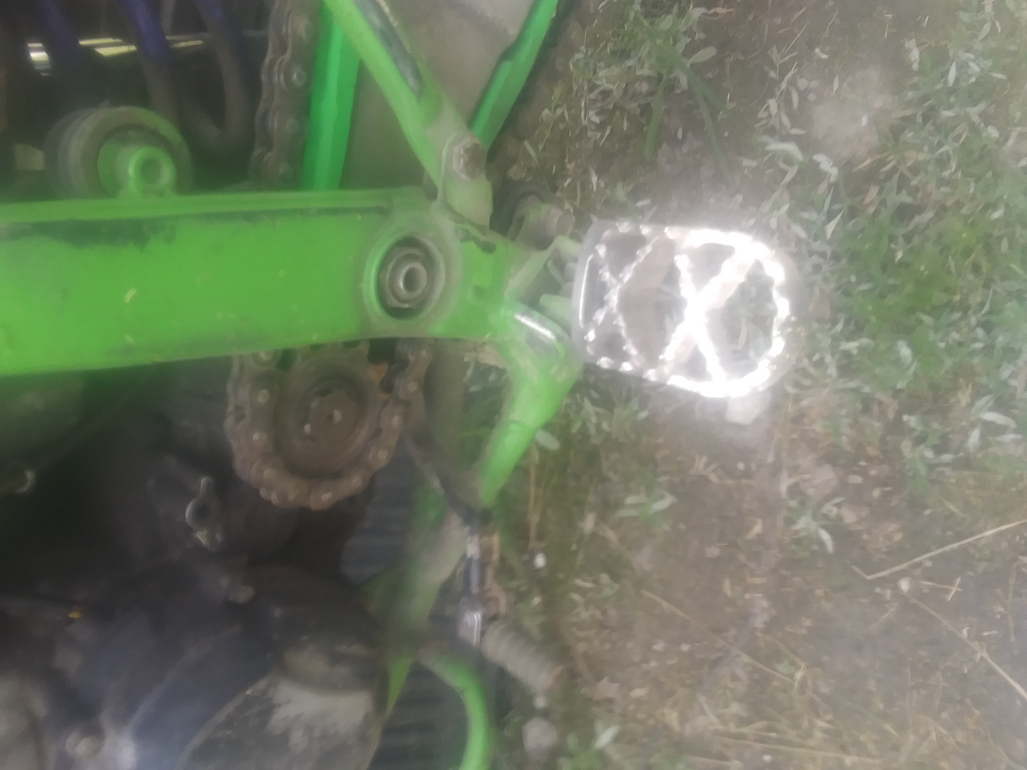

My footpegs had seen better days, but didn't want to go with the ims pegs. After looking up what others had done, I picked up a set for a ktm. They're moose brand, have a curve to them, front to back, and are set back .25". Also, just plain bigger than stock. I used the stock pin, and spring, but had to drill a hole in the peg to capture the spring. Also, the pad area, that hits the frame, was shaved down a little so they sat at 90 degrees. The end of the peg was up/back just a little. Nothing crazy though. To top it off, I shaved down the area of the peg that hits the rear brake lever, so that its flat on the lever, and not a corner. I think a lot of that part has to do with the setback...
