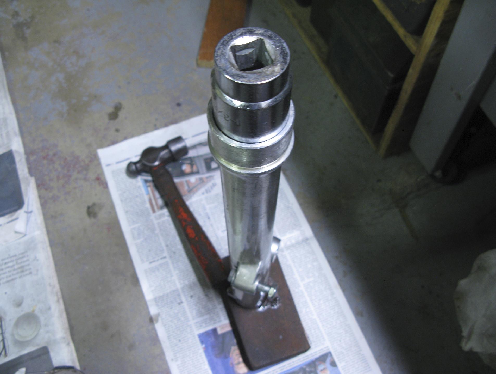

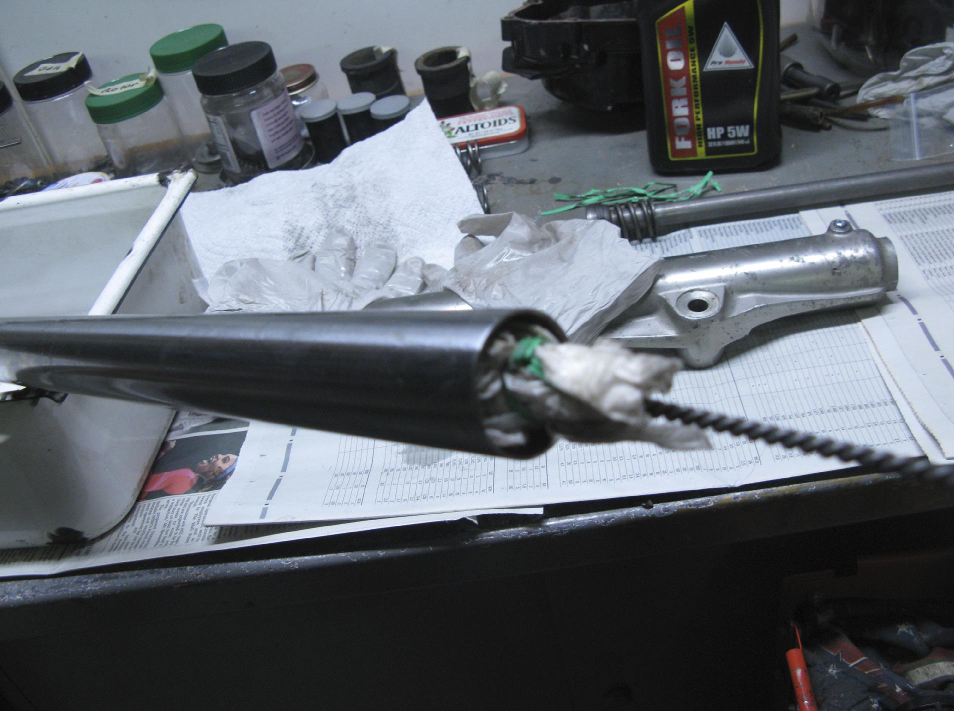

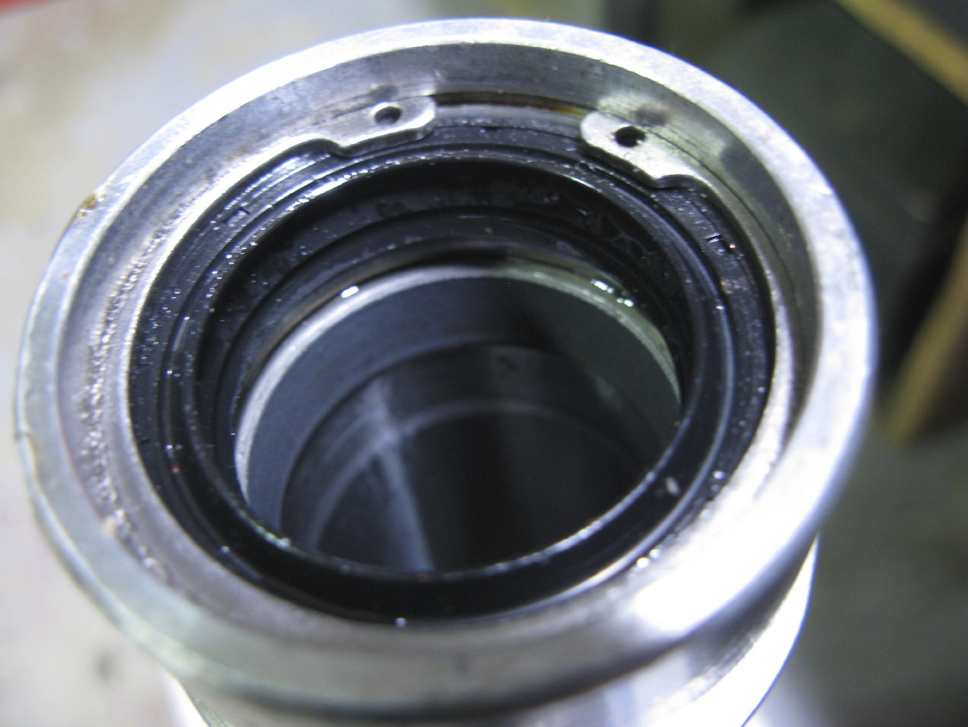

With everything in place, I started fork assembly. First, a little extra swabbing for the right tube which had evidentially ingested a bit of water over the years of sitting.
Final swabbing
_click image to zoom_
Fit the seals in followed by the (original) snap rings. I could not find new ones anywhere but it would be an easy replacement if the need came up.
Fork seal

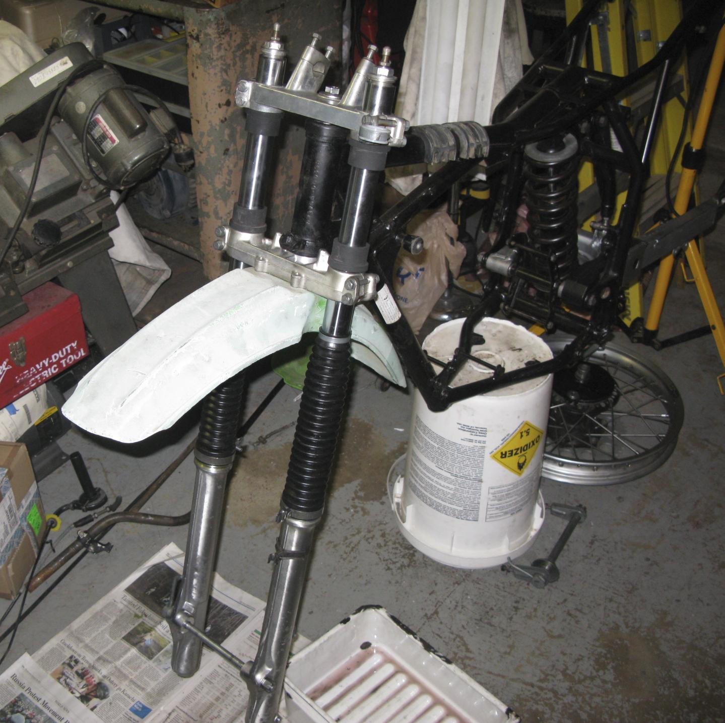

The initial test fit (without oil or springs) looks good.
Forks mounted

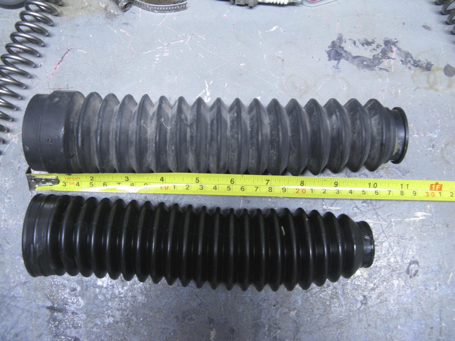

One problem - the darn new fork boots are too short! They simply do not extend sufficiently to accommodate the 9-1/2" travel. And they do not really slide over the lowers far enough. I have the originals but they are too far gone, one has a hole and the other is in three pieces. Fortunately, this is just a test fit of everything so it will be easy to put on better boots once I find some.
New fork boot is too short
Well, at least all of the cleaning and work is done. I will pick up some 10wt fork oil to mix with the 5wt and then fill. Thinking about it, it would seem that I want the same height which should now take a greater volume of oil than specified in the manual. Also, the manual specifies the fork oil height with the forks fully extended, springs removed. No problem except this is a good length, around 21 inches. After I am happy that I have this height, I will try fully compressing the forks and remeasuring to establish a new short height. It seems like this new height would be closer to 11-12 inches with the forks compressed - easier to measure/adjust in the future. Does this sound right?

Trying to determine a height with collapsed forks might be the ticket.
Daystar used to make fork boots in different sizes.
EDIT (later add on) these maybe?? https://www.daystarweb.com/product/fork ... -collapsed

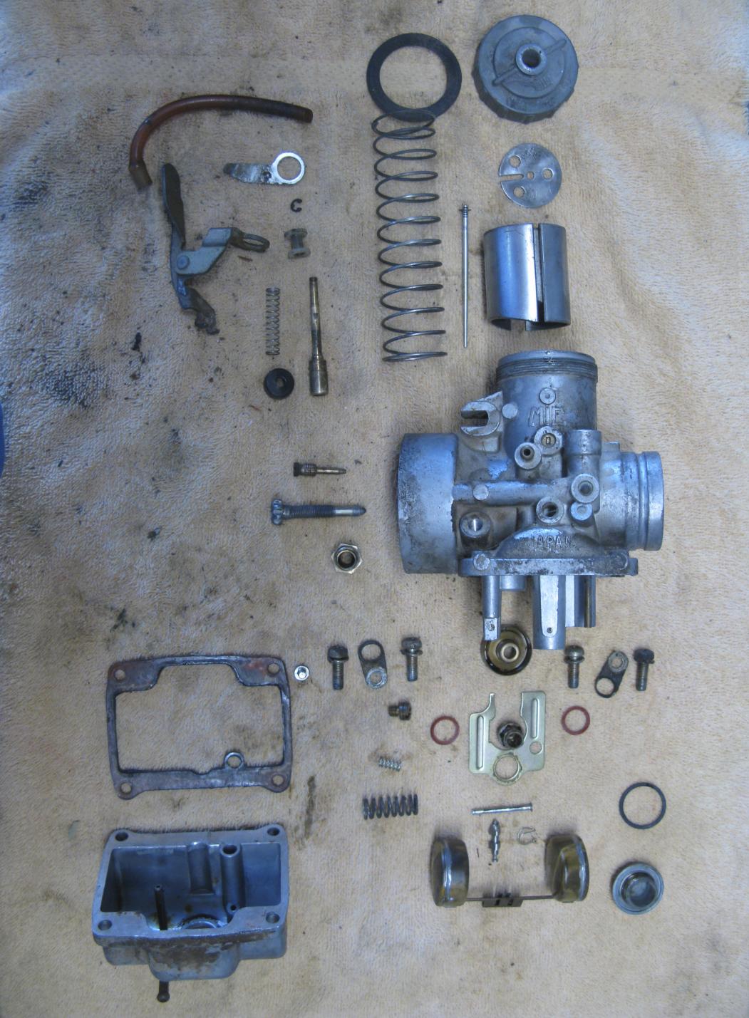

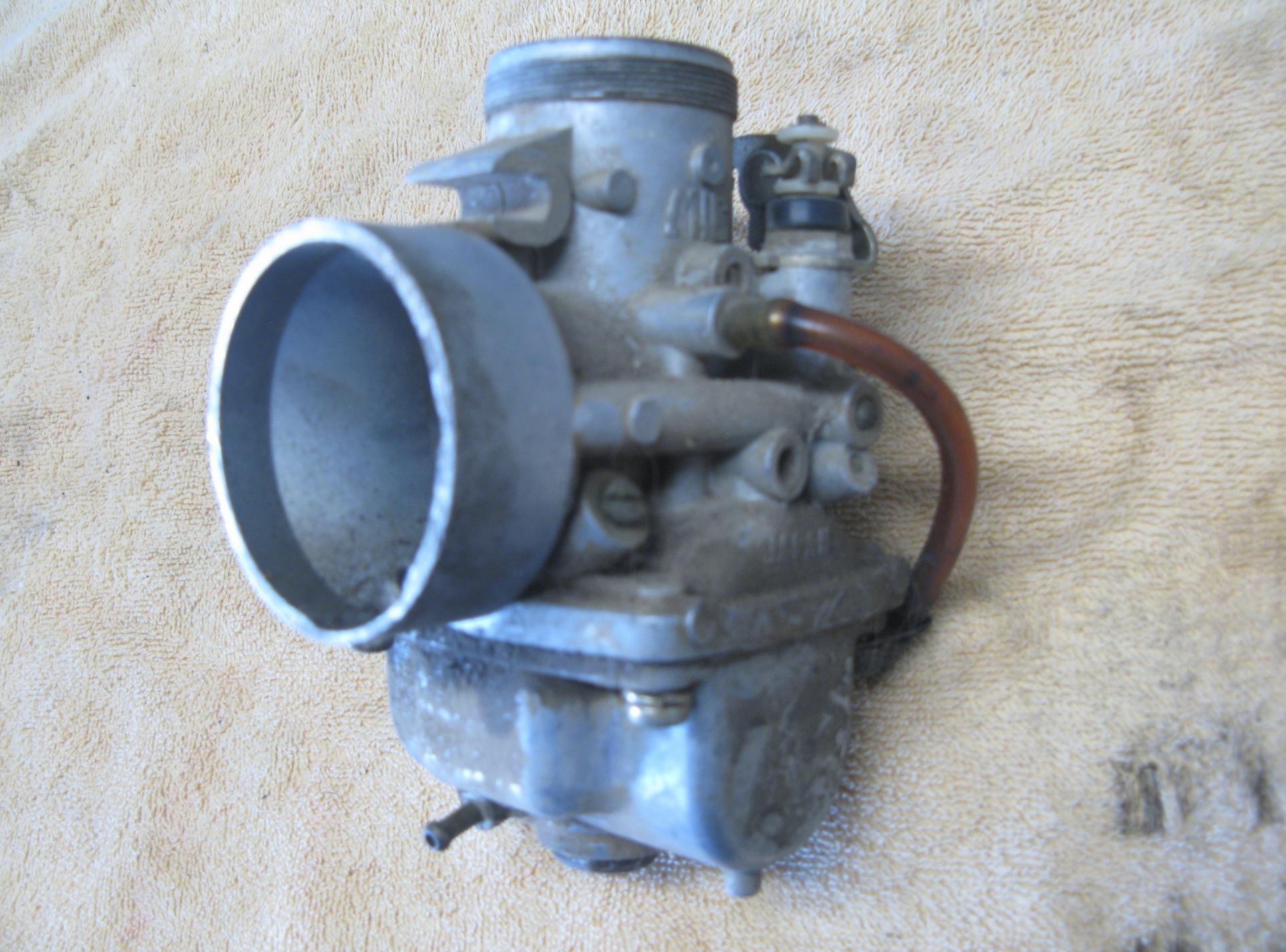

Moving on to the carb now that the forks are virtually finished. It has been somewhat protected in a box but still needed of a bit of cleaning.
Stock carb for the KDX175
The inside looks better than I would have thought.
Float bowl removed

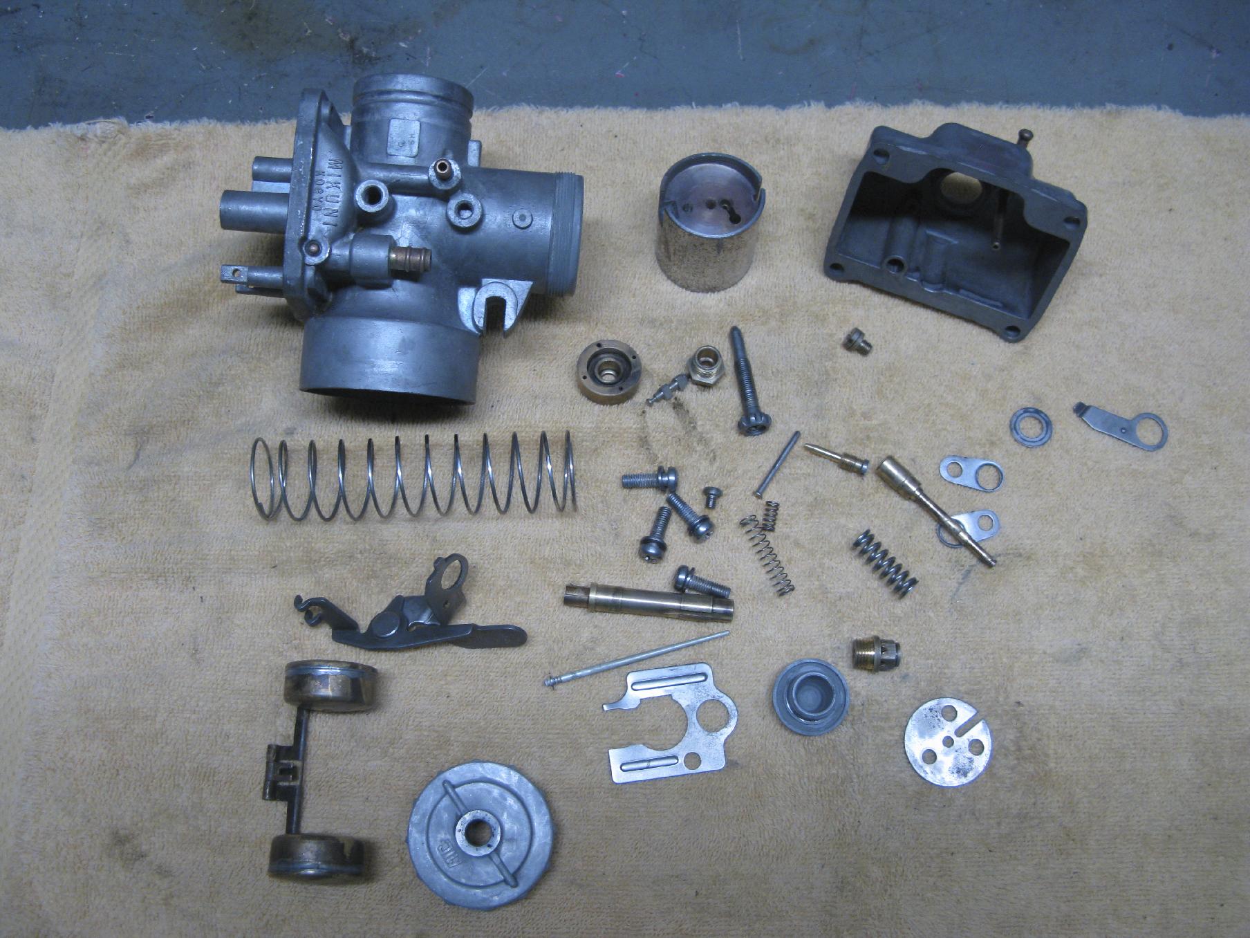

Here are all of the parts. I think that most will be reusable except for the float bowl gasket. All of the metal parts get dunked.
Carb blown apart
Everything came out nice and clean.
Dunked and washed

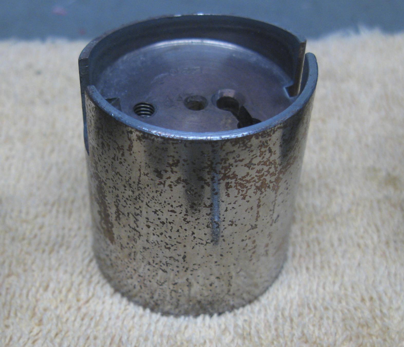

Looking at the slide, though, it does not look too good. The chrome (?) plating is flaking off.
Deteriorated slide
It slides ok with no binding but may be a bit looser. I will have to evaluate my (limited

I think I would have to find the garbage can for that slide.
Maybe sudco or jetsrus has a #2 slide as the diagram shows.
Those floats look so different than the later floats.

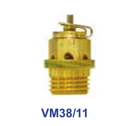

If replacing parts on your original VM34SS consult the Sudco Catalog. One part specific to the original KDX175 carb is the needle and seat. The main uniqueness is that the seat has 10mm threads. They are metal and probably last forever but, if you need on, this is the one to get ($32):
Needle and Seat VM38/11
(002.200VM38/11 3.5 N/V)
KDX175 Carb Needle and Seat
VM38/11
A few other common parts are listed in the table located at the top of this post. If your carb is in good shape, you may be able to clean and use it with a new float bowl gasket and be set.

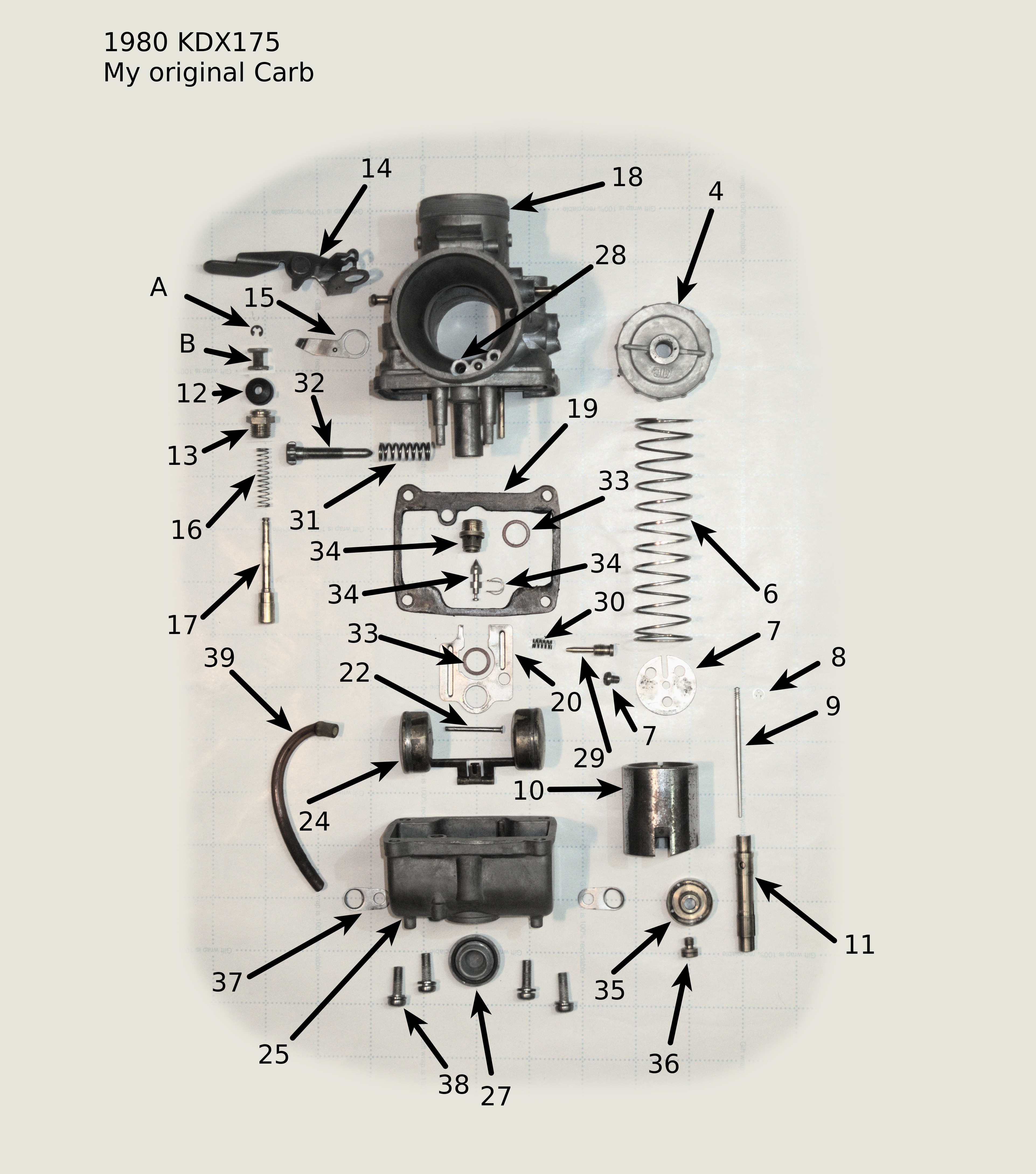

Finally here is a blow up of my actual 1980 KDX175 VM34SS carb. Some parts and hoses are missing or not visible but it gives an idea of parts count and position. The numbers are listed under the image and correspond to the Mikuni numbers from the Sudco catalog. The numbers missing from the pic correspond to parts that my carb does not have.
VM34SS Carb
VM34SS Carb
1 - Rubber Cap, Throttle Cable 2 - “A” Cable Adjuster 3 - Locknut, Cable Adjuster 4 - Top, Mixing Chamber 5 - Gasket, Top Mixing Chamber 6 - Spring, Throttle Valve 7 - Plate, Spring Seat 8 - Clip, Needle Positioning 9 - Jet Needle 10 - Throttle Valve (Slide) 11 - Needle Jets 12 - Rubber, Starter Plunger 13 - Fitting, Starter Plunger 14 - Lever, Starter 15 - Spring Plate, Starter Lever 16 - Starter Plunger Spring 17 - Starter Plunger 18 - Mixing Chamber Body 19 - Float Bowl Gasket 20 - Float Bowl Baffle Plate 21 - Pilot Jet 22 - Float Arm Hinge Pin 23 - Float Arm 24 - Float - Two basic types of float system: Independent (Type A) and Twin (Type B). 25 - Float Bowl 26 - Main Jet Plug Washer 27 - Main Jet Plug (Drain Plug) 28 - Air Jet 29 - Air Adjusting Screw 30 - Air Adjusting Screw Spring 31 - Idle Adjusting Screw Spring 32 - Idle Adjusting Screw 33 - Needle Valve Washer 34 - Needle Valve Set (Needle Valve & Seat Assembly) 35 - Main Jet Washer 36 - Main Jet 37 - Anchor Plate 38 - Float Bowl Screw 39 - Main Jet Extender 40 - Needle Jet Setter 41 - Needle Jet Setter O-Ring 42 - Banjo Bolt Washer 43 - Banjo Bolt A - Starter Rod Circlip B - Starter Rod Plastic Slider

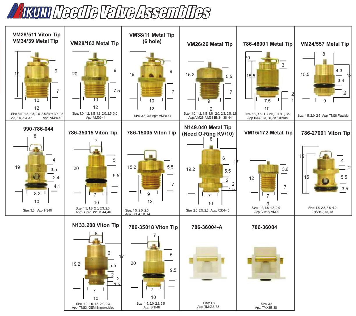

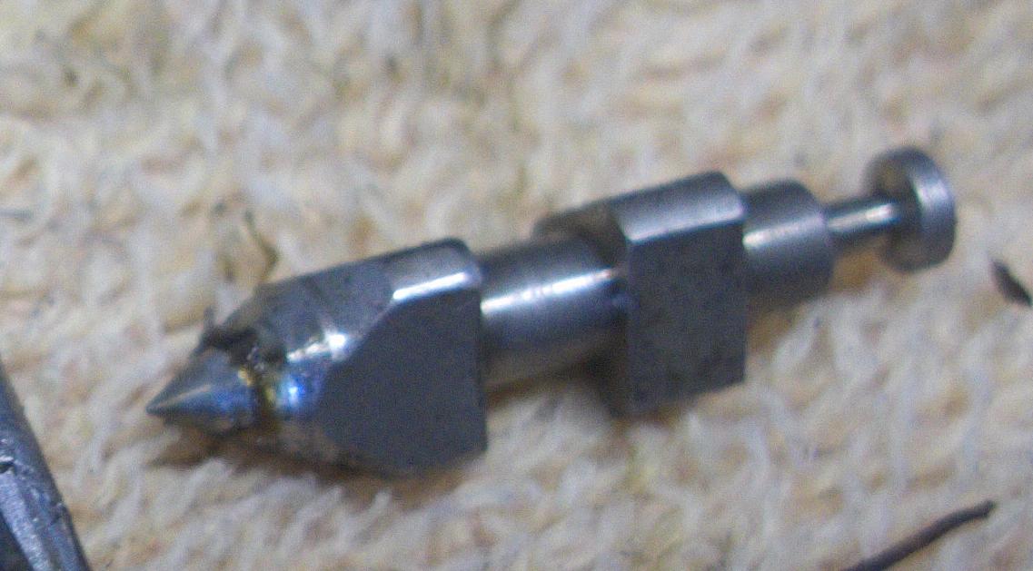

The float needle valve is all metal (no rubber tipped needle). Is it reasonable to lap the needle to the seat with some valve grinding compound? Or, is it even needed? I want to avoid a leaking carb if possible.

no rubber tip on part 34?
How does it seal?? Is the rubber tip completely destroyed by old gasoline??

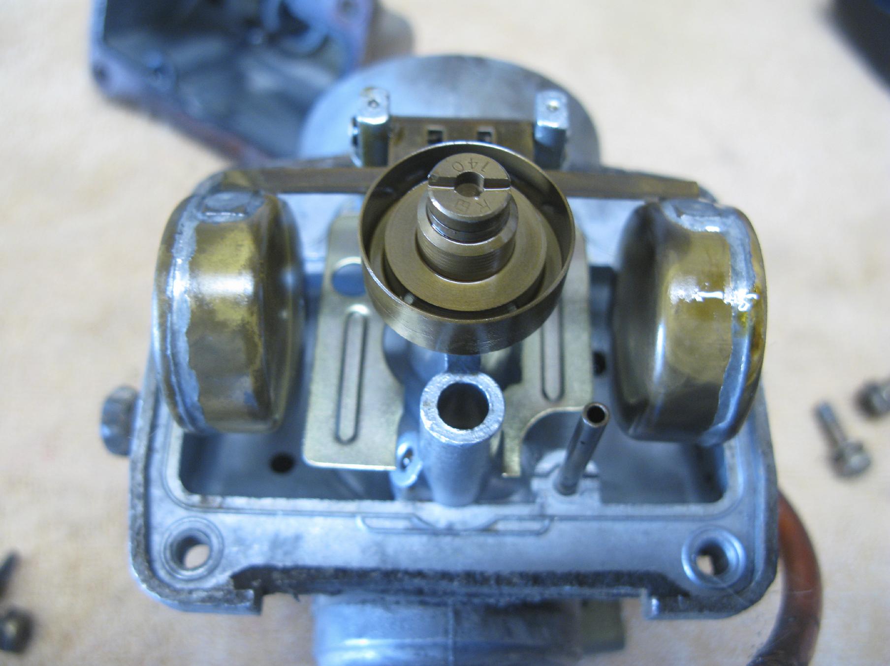

Yep, I had the same doubt on needing rubber and, as far as I can tell though, part 34 (needle) never had any rubber on the tip.
KDX175 Needle before Cleaning
When I was looking through the Sudco catalog, I caught another clue: needle valve assemblies are described as metal tip or viton tip. Here is a pic of the full line of the Mikuni Needle Valve Assemblies (KDX175 uses the VM38/11):
Mikuni Needle Valves
(Come to think of it, I was dealing with a 90-yr old carb some time ago and I do not remember the needle having a rubber tip - of course, it just had to leak out the full tank of gas just after but that was due to a leaky brass float.)
So I was thinking that if I lap the metal (brass) needle in the seat with a bit of fine valve grinding compound, I might get a better seal. If that leaks or seeps I can try something finer and, if all fails, I can order a new needle valve assembly.
Of course, maybe it is fine like it is - I could just run it and then try lapping if it fails to seal consistently.
Or, actually, I just noticed - the VM28/511 has identical dimensions and has a viton tip. Methinks I found a better solution

I'll bet one crisp dollar that the black ring around that valve is all that is left of a rubber tip.
Goofaroo
- Posts: 531
- Location: Edmond, Oklahoma
That needle might clean up and work fine as long as it isn’t pitted. I have had good results for years with Brasso brass polish. For the seat I cut a few q-tips in half and chuck it up in a drill with some Brasso on it. Stick in in the seat and spin it against the seat. As you pull it out work it against the sides as well. Then repeat. Lastly hit it with a dry q-tip and then clean it with carb cleaner. Same for the needle but chuck it up in the drill and use some Brasso on a clean cloth and polish the needle against the cloth. About 90% of the time it’ll bring them to useable condition.
You’re obviously very particular in your work. A good way to clean all of your brass and other things is Barkeeper’s Friend. It’ll make your carb brass look great. Use the powder version and hold your jets, emulsion tubes, and seat in the palm of your hand. Sprinkle some Barkeepers Friend on it and a bit of water. Scrub the parts against your palm with a toothbrush and then rinse with water.
It also works on the carb body and other things. For spokes cut some strips out of an old t-shirt and dip them in a paste of Barkeepers Friend. Loop it around the spokes and work it up and down and it’ll make them look great.
I assume you know how to bench test the needle and seat by attaching a fuel line to the fuel inlet. Blow through it with the carb upright and the turn it upside down and it should hold pressure.
Needles can be tricky sometimes. Don’t be discouraged if you bench test it and then when you put it on the bike and it leaks. It happens. Sometimes even new ones will do this. Even after a thorough cleaning a particle can cause the needle to leak. Bounce the bike around a bit with fuel in the bowl and see if it stops. If not go ride it on a rough surface or a few small jumps. It’ll usually dislodge whatever is causing it not to seal. I’ve had many bikes in my shop that I have fixed by just riding it around my property. lol
Edit: Your needle never had a rubber tip. It just has some goo on it.
HopFrog175
- Posts: 80
- Joined: 11:50 pm Jan 26 2021
- Location: Los Angeles, CA
Great info, thanks! I will try the q-tip with Brasso procedure and follow it up with lapping the needle/seat mating surface a bit. It seems like lapping, at the least, won't hurt and I am curious to find out as I run into old carbs periodically.
Also, it looked like the VM28/511 needle/seat would be a direct replacement for the original VM38/11 but then I noticed that the VM28/511 is rated 2.5 compared to VM38/11's 3.3. I am not sure what the numbers indicate but larger numbers go with gravity feed and smaller numbers with fuel pump feed. I will stick with the original for now.

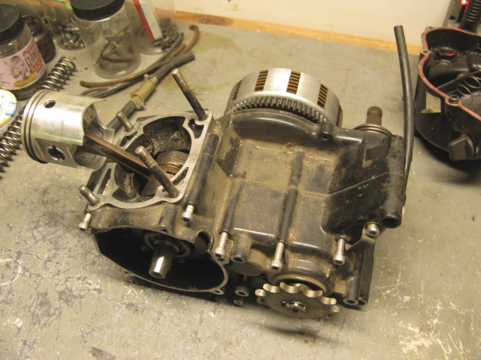

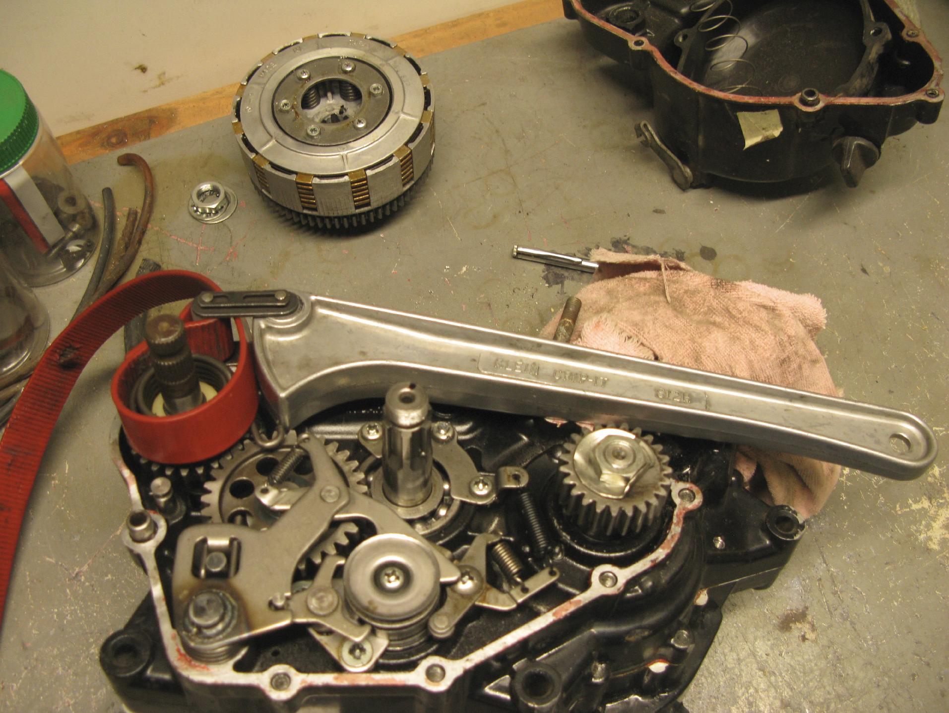

I am waiting for parts for a number of loose ends (fork boots, etc) but need to keep moving so on to the engine. I expect this to be fairly cut-n-dry because I went through it last century but never ran it. I am paranoid about keeping seals up to date after losing an engine to a crank seal leak in the past so all seals get replaced. Additionally, I will keep an eye out for anything that I let slide as good enough back when I was thinking I was going to be passing this bike on to a relative.
I pulled the cylinder and clutch cover a while back just to make sure that things looked as I remembered. I also took the opportunity to test fit replacement socket-head screws I rounded up (I will compile an engine screw list and sources in a later post).
Time for new seals
I tried the strap wrench on the kick-start spring and it worked surprisingly well.
Disassembly

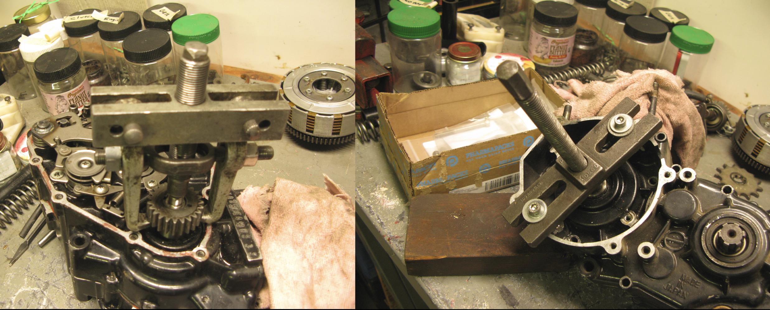

For some reason, the crank gear was stubborn. After pulling off the shift mechanism, the stator-side case pulled right off.
Pulling apart Pressing out the crank

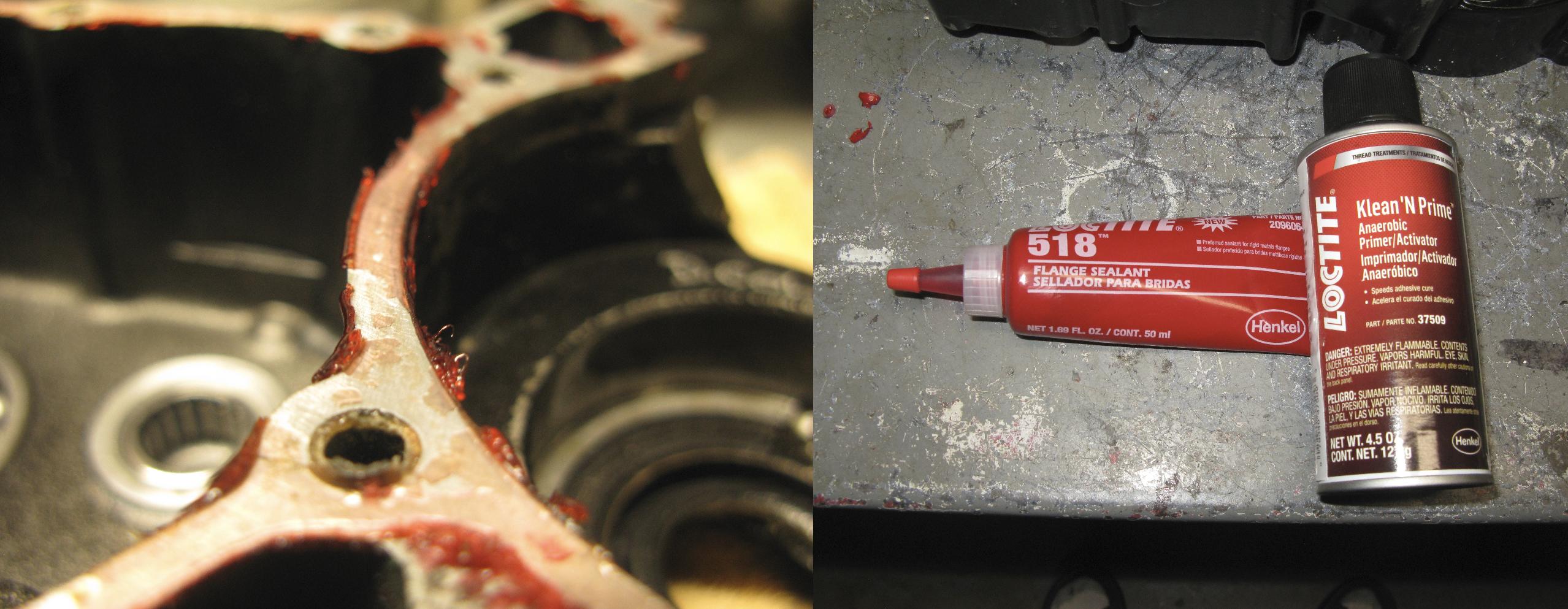

When I put this together, last century, I was keen to try a new Loctite sealer. Now labeled "518 Flange Sealant", it really held up, still relatively soft and pliable, looked fresh. Actually, it stuck a little too well on the clutch cover I had a heck of a time breaking the seal. I expect this sealer to work well on the KDX as I have had success elsewhere.
The sealer lasted
Loctite 518 (tech info) is still available so I will be using it again on assembly. (There are some variants such as 510 and 574 for high temp and other applications.) Cure time is about a day but you can speed it up to about an hour or two with an optional activator LOCTITE SF 7649 (tech info). Klean'N'Prime is the retail branding of the activator if you look for it outside of industrial suppliers.
I have seen it locally at Grainger and online through Summit Racing and Amazon:
After a little cleanup, I will be ready to put the new seals in.
