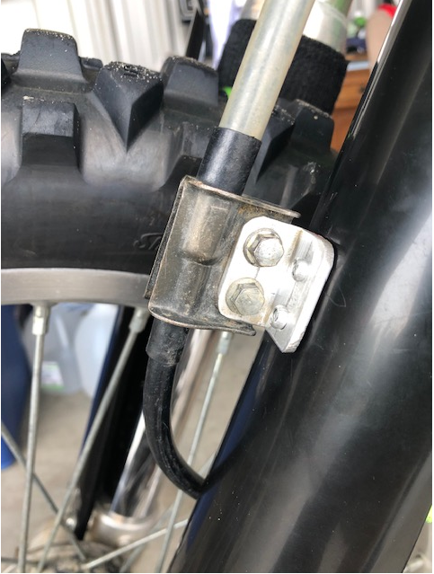

I guess in racing, as in life, it can often be the 'little things' that sneak up and cause problems. A good example is when I was riding in the Alligator National enduro earlier this year. I had loosened my left hand rear brake lever to rotate it out of the way for something, I don't remember what.
I was sure I had remembered to tighten it, but NOPE, I did not. The result was about half way through section #2 the lever started falling down out of reach because the clamp bolts vibrated loose. I stopped a couple of times to finger tighten them but the tool to tighten was in my camel back which meant stopping and stripping out of a lot of gear to get to it. I just struggled on, distracted by the loose brake lever, stopping when necessary to finger tighten again when it got so loose I couldn't find the brake lever. This slowed down an already slow rider! Imagine the surprise of the guys who were enjoying watching the race from the back of their pick up when I pulled over and asked if anyone had an 8mm wrench or a pair of pliers handy! My fault for lack of proper bike prep prior to the race.
Modifying and updating a 20 year old KDX to be competitive with modern bikes opens the door for even more "little things". I have KX250 forks from the time when Kawi ran the brake line under the fork instead of wrapping it behind the lower fork tube as on "modern" bikes (and a stock KDX too!). To solve the problem of how to attach the KDX brake line to the fork guard I've fabricated a plastic tab riveted to the fork guard. It worked sorta, but has failed me twice now so I recently fabricated a new bracket out of aluminum stock that will hopefully be a little more durable.

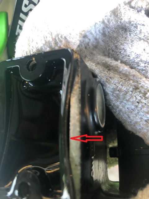

Another "little thing" popped up yesterday while I was doing some bike work. I have a left hand rear brake set up. Lately I've noticed I am loosing brake fluid in the master cylinder. It's a very small leak and hasn't affected the rear brake yet, but just another distraction on the trail when I should be giving the ruts, roots, rocks and trees my full attention! Yesterday I noted through the site window the fluid was low again. (I've never found the source of the leak.) When I took off the cap to fill the cylinder, this is what I saw:
LHFB master cyl..jpg (99.16 KiB) Viewed 31997 times
See that little gap between the gasket and the edge? I wonder if that is another "little thing"? Dunno' but I paid more attention to seating the seal this time before tightening down the cap for sure!

Maybe it was not leaking there. They CAN be tricky!
Remember, blue Loc-tite. :-)
Bought blue Loc-Tite yesterday!

If this is an old clutch actuator Rocky Mtn sells the replacement bellows; I think that's what your picture is? RM's number is 131307001013 it's called a "bellows for reservoir '98". Buy two b/c Magura doesn't make any rebuilding stuff for the older units. .........If it's new Magura sells it........KDXDave Although KDXGarage has it right figure out where the leak is. If it's coming from the actuator you can nurse it along for a while......
Thanks, guys! It’s a Nissin unit but I haven’t started looking for repair parts yet. Actually thinking of switching my Magura hydraulic clutch system over to a LHRB unit with a new custom made line.
KDXDave
Posts: 255
Joined: 10:37 pm Dec 27 2007
Country: New Mexico
Location: New Mexico
Post by KDXDave »
YEP! One braided SS line from the clutch actuator to the the master on the rear wheel. Easy simple...Pick a hot day to install be ready to bleed all the way through. I use a good gas check valve like on your gas tank to bleed without open and closing the rear brake...good luck Dave
Yeah, that’s how it is rigged up now. I just don’t like the Nissin stuff.
