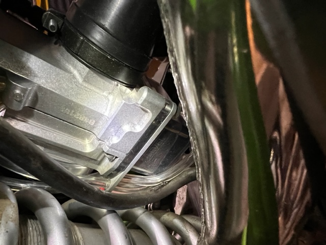

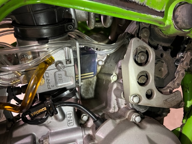

Was able to get out yesterday afternoon and test the new top end and carb, it was a whole lot of fun! I still need to do some tuning on the lectron as it seems to not like just cruising throttle at 1/4-1/3 twist.
One side of the carb does seem pretty full since it sits at a slight angle.
Idle/first start no adjustments: https://www.youtube.com/shorts/2q6PhDy5Y9g

Hey Kevbot, thanks for the pics and video...any chance you have a pic of the top of the carb where the elbow and tank area are?Kevbot wrote: 09:41 am Oct 16 2023 Was able to get out yesterday afternoon and test the new top end and carb, it was a whole lot of fun! I still need to do some tuning on the lectron as it seems to not like just cruising throttle at 1/4-1/3 twist.

Yeah I will grab some pics, getting the itch to ride with this nice weather we have been having. Need to finish up a couple things and get the carb tuned a little better. I have a dead spot on the low end power, idles great and up top it screams. Also ordered a boyseen rad valve since my boot might be leaking a bit with the Vforce 3.jedidan45 wrote: 10:26 am Nov 28 2023Hey Kevbot, thanks for the pics and video...any chance you have a pic of the top of the carb where the elbow and tank area are?Kevbot wrote: 09:41 am Oct 16 2023 Was able to get out yesterday afternoon and test the new top end and carb, it was a whole lot of fun! I still need to do some tuning on the lectron as it seems to not like just cruising throttle at 1/4-1/3 twist.
