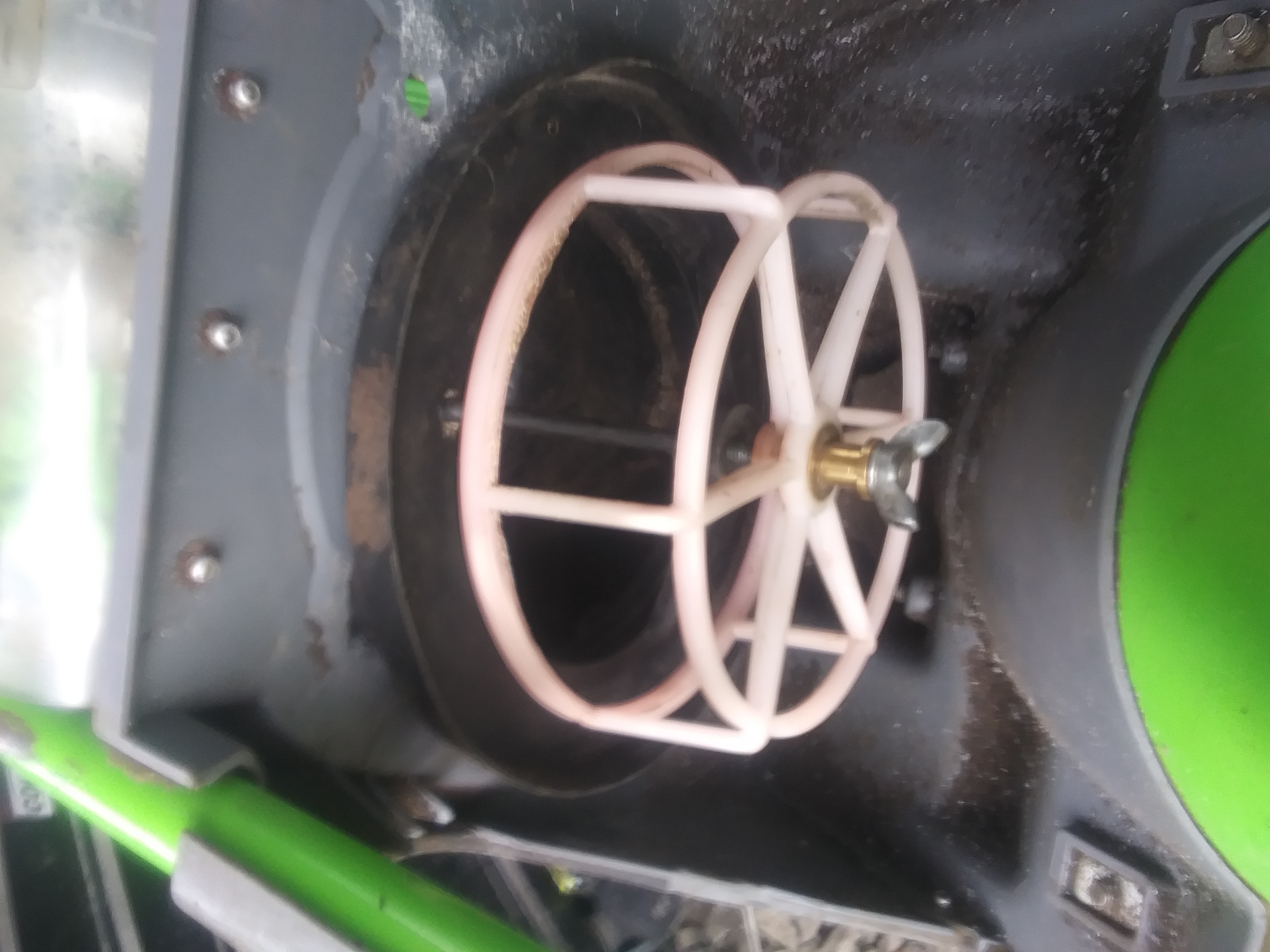

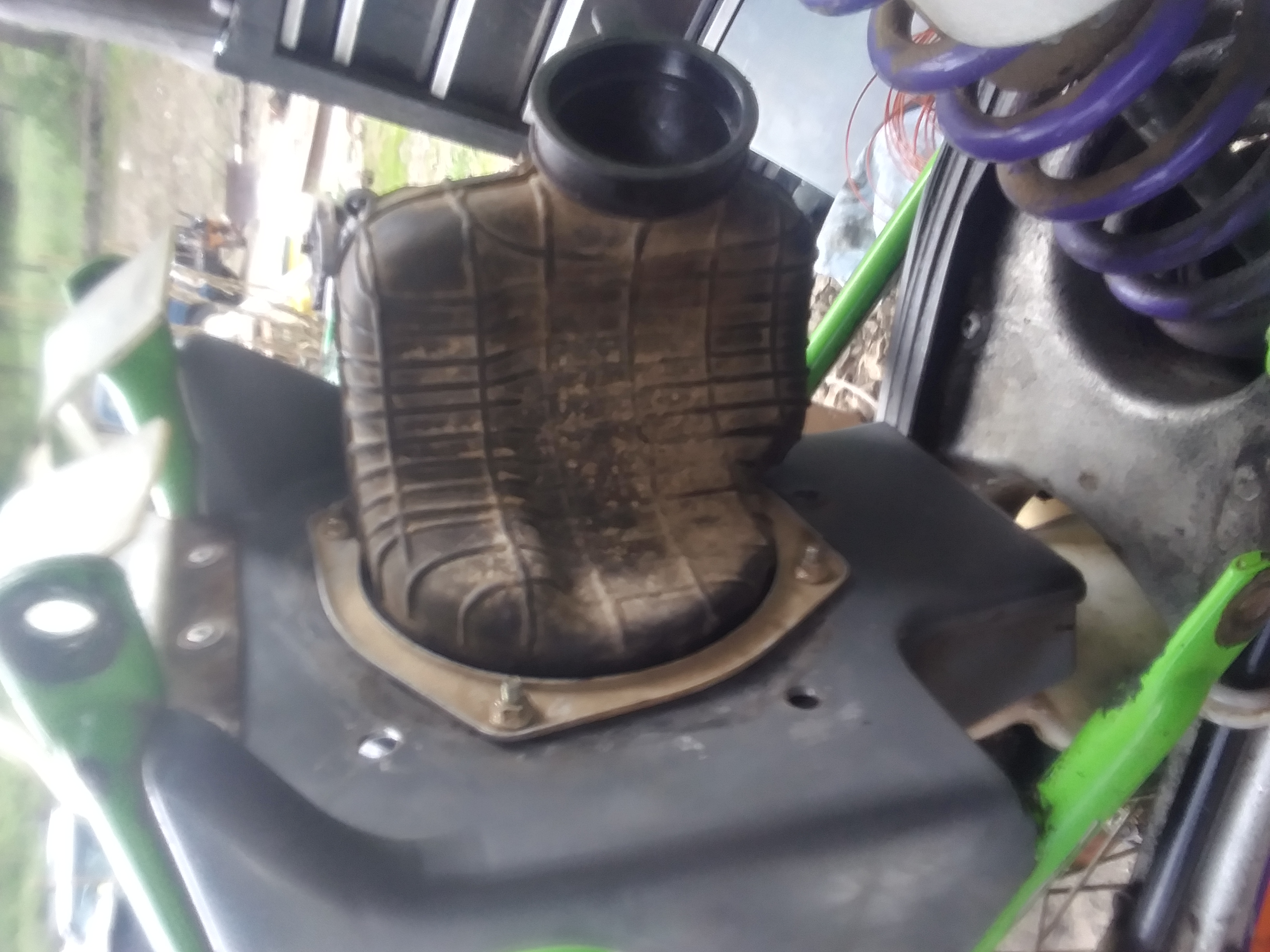

Well, there's still some to do, but here's some pics anyways. The opening on the kx box is a bit bigger, so I just cut the face off the kdx box, and trimmed to fit. At first, I used plastic epoxy, but it didn't hold, so I used a solder gun to melt it together, adding filler from scraps from the kdx box.

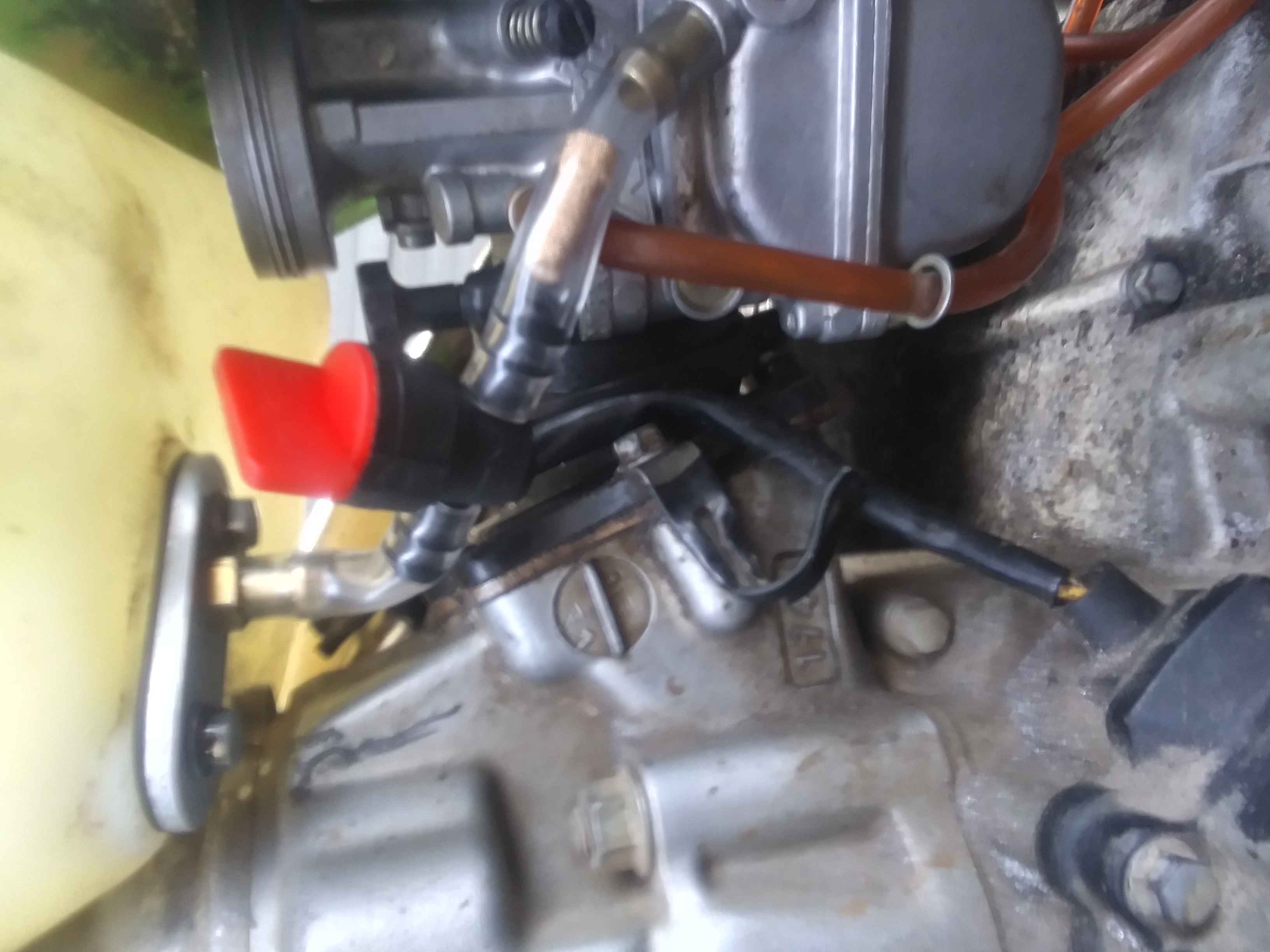

This is what I did for the desert tank petchock...

Re: A path less travelled 97 kx125
Nice convenient spot. Old cdi location.

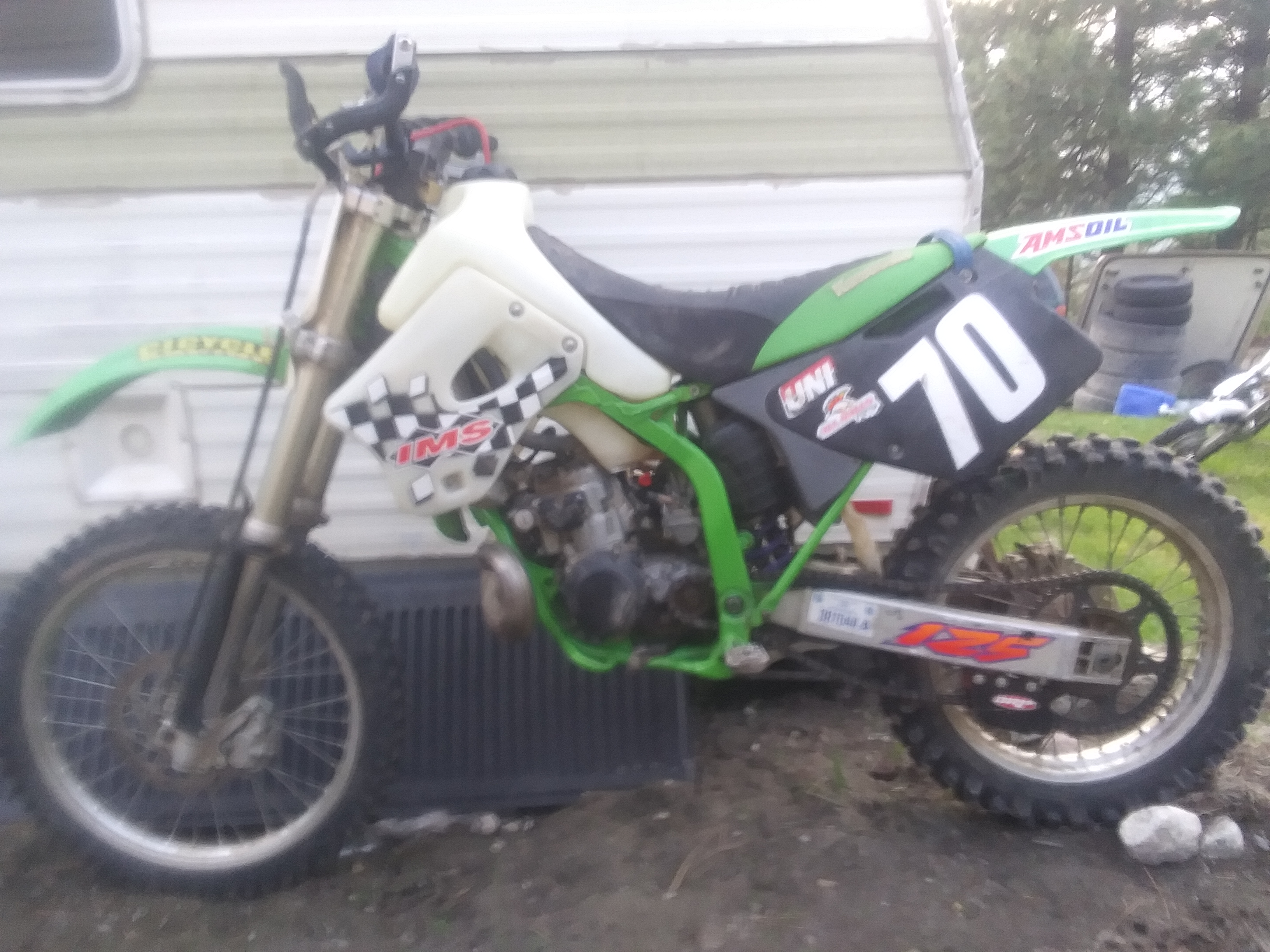

Getting there...I think its time to start cleaning everything up, paint the frame, assemble (hopefully for the last time), then see if it starts...
- 20230517_165639_HDR.jpg (2.41 MiB) Viewed 13640 times
- 20230517_165019_HDR.jpg (2.4 MiB) Viewed 13640 times
- Posts: 86
- Country: Usa
Did some painting. Didn't do the hole frame. Just the spots that really needed it. God willing, I'll get it done tomorrow.

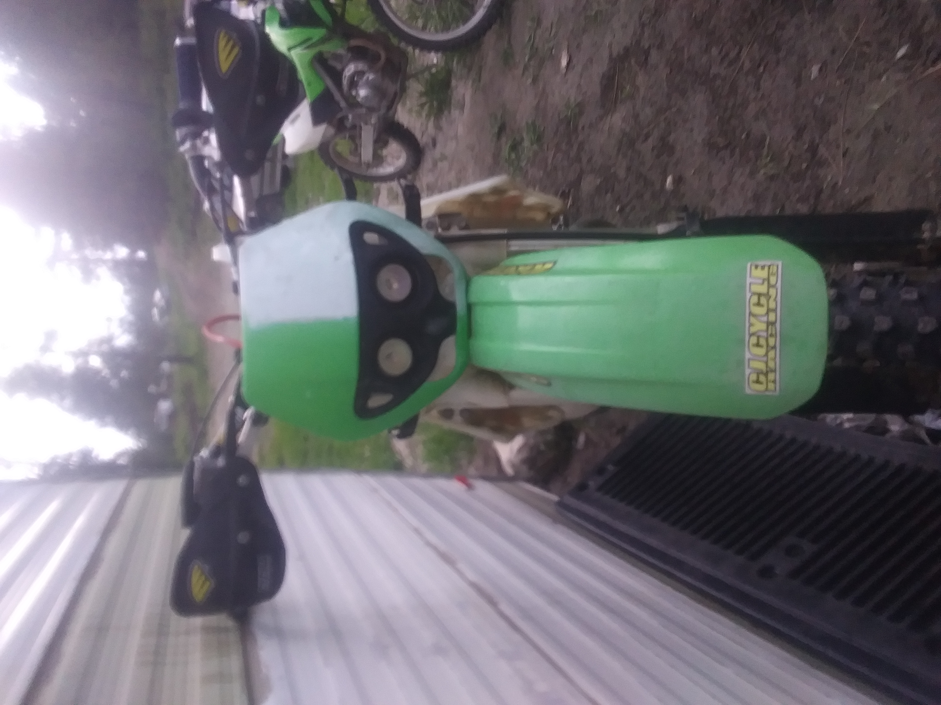

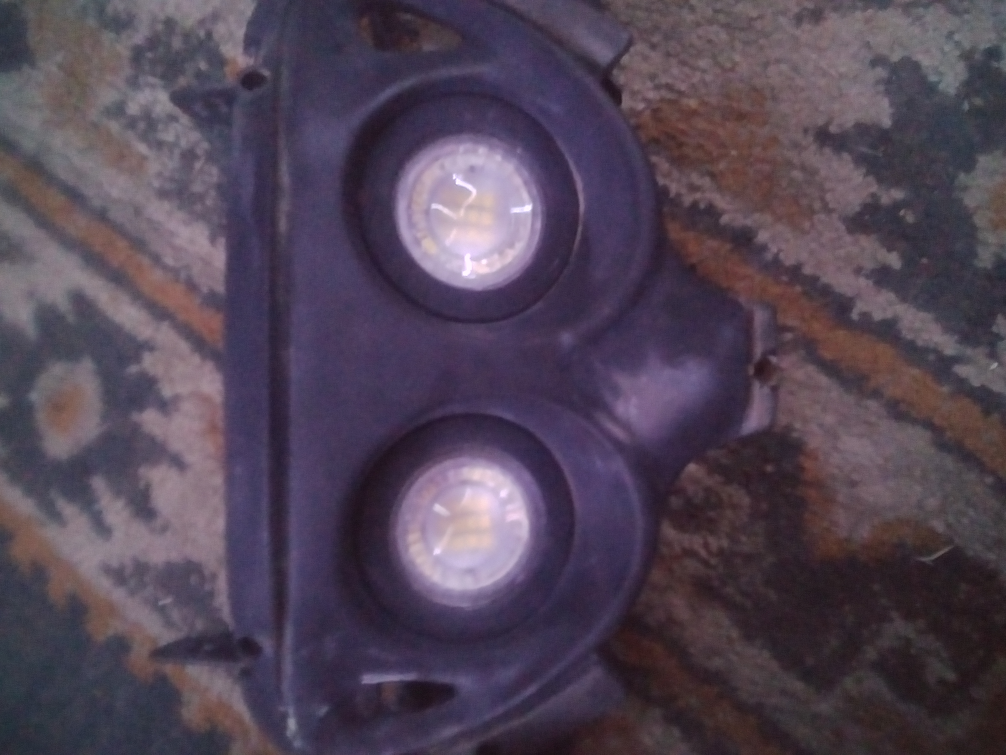

I've been debating putting a light on. I have this old ufo light sitting around, but the lights are busted, and the plastic has seen better days. Spent some time, and got the green to come back out. Might finish that up, and swap in some leds? I don't need it for racing, but might be nice around here at times...

A light can be very helpful asset when something happens out on the trail and you have to ride back in the dark. Do it!
Still need to finish up, but the shroud is green again, and found out I can get replacement lights at the hardware store...Also, went for a little longer ride today. Still nothing weird, so that's cool.

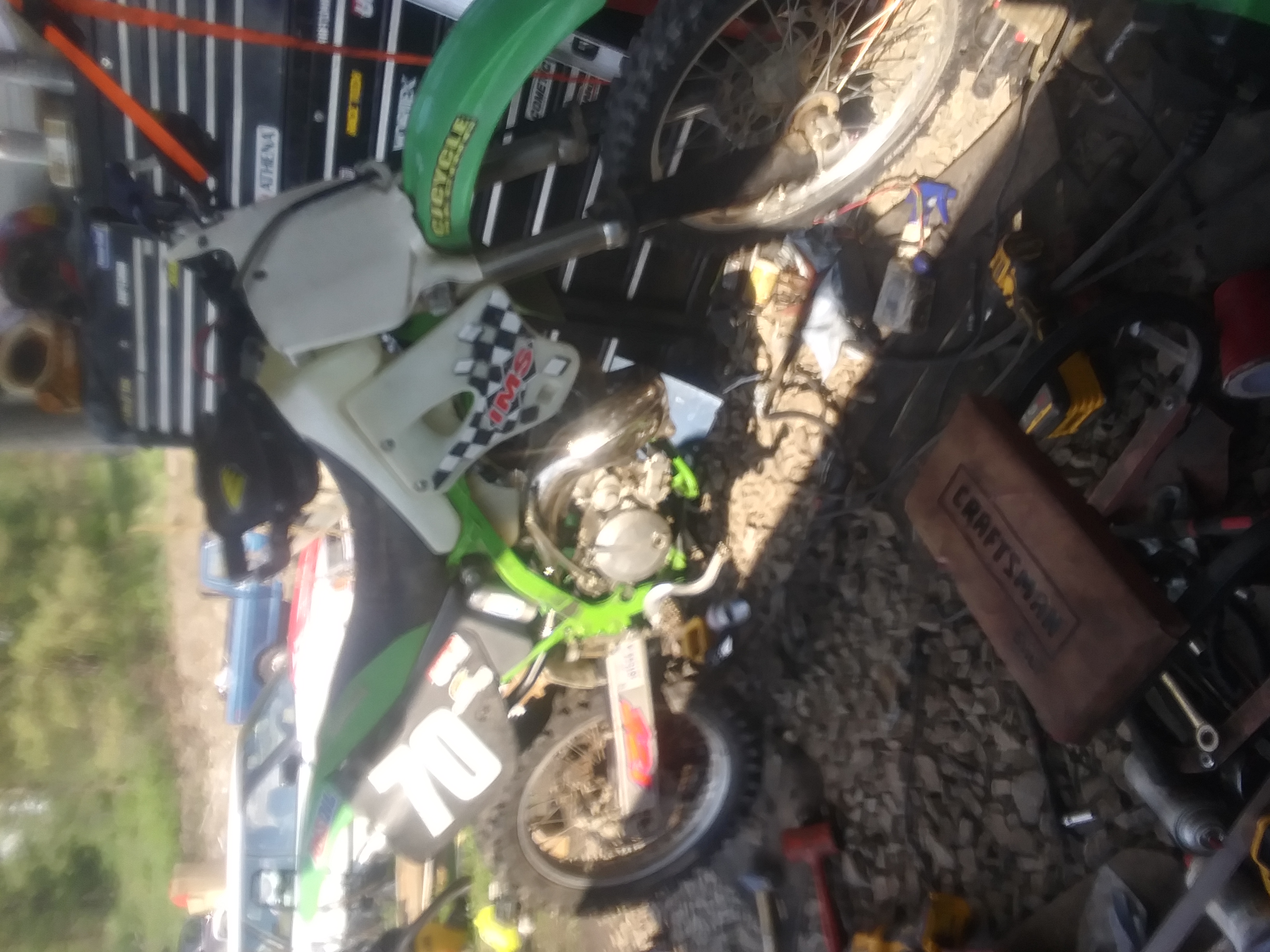

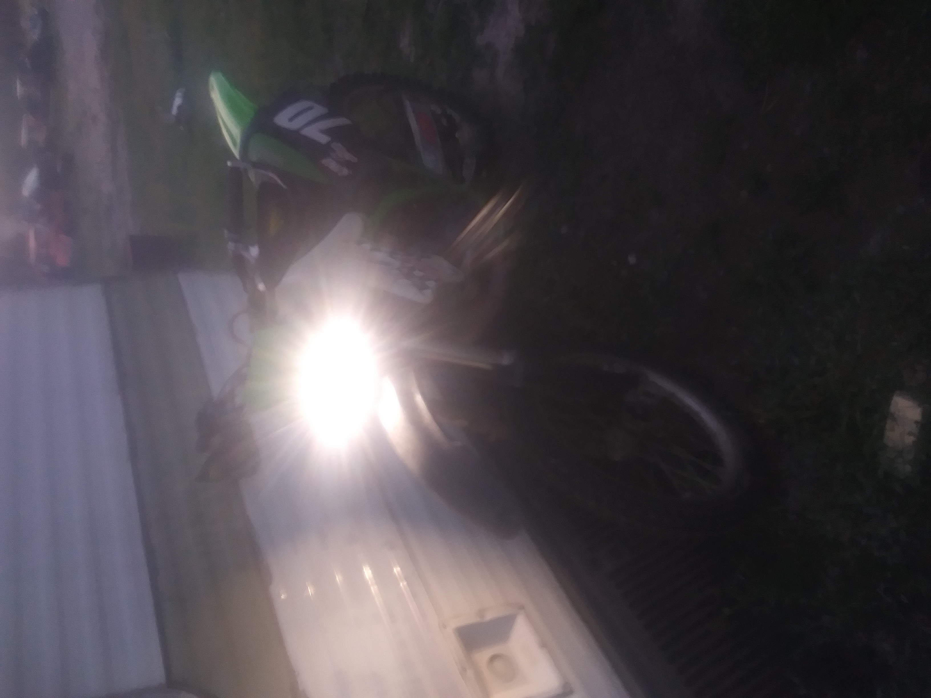

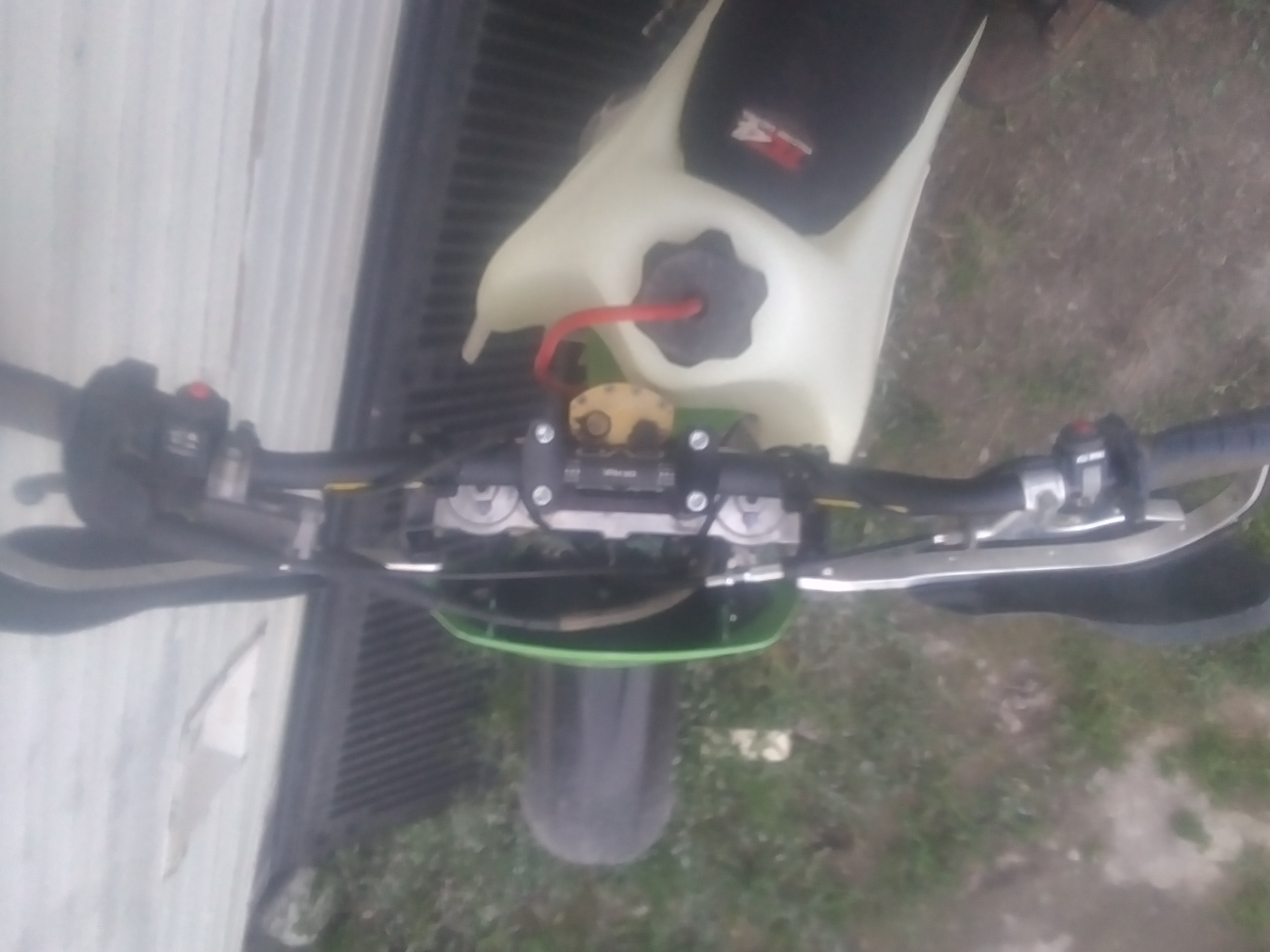

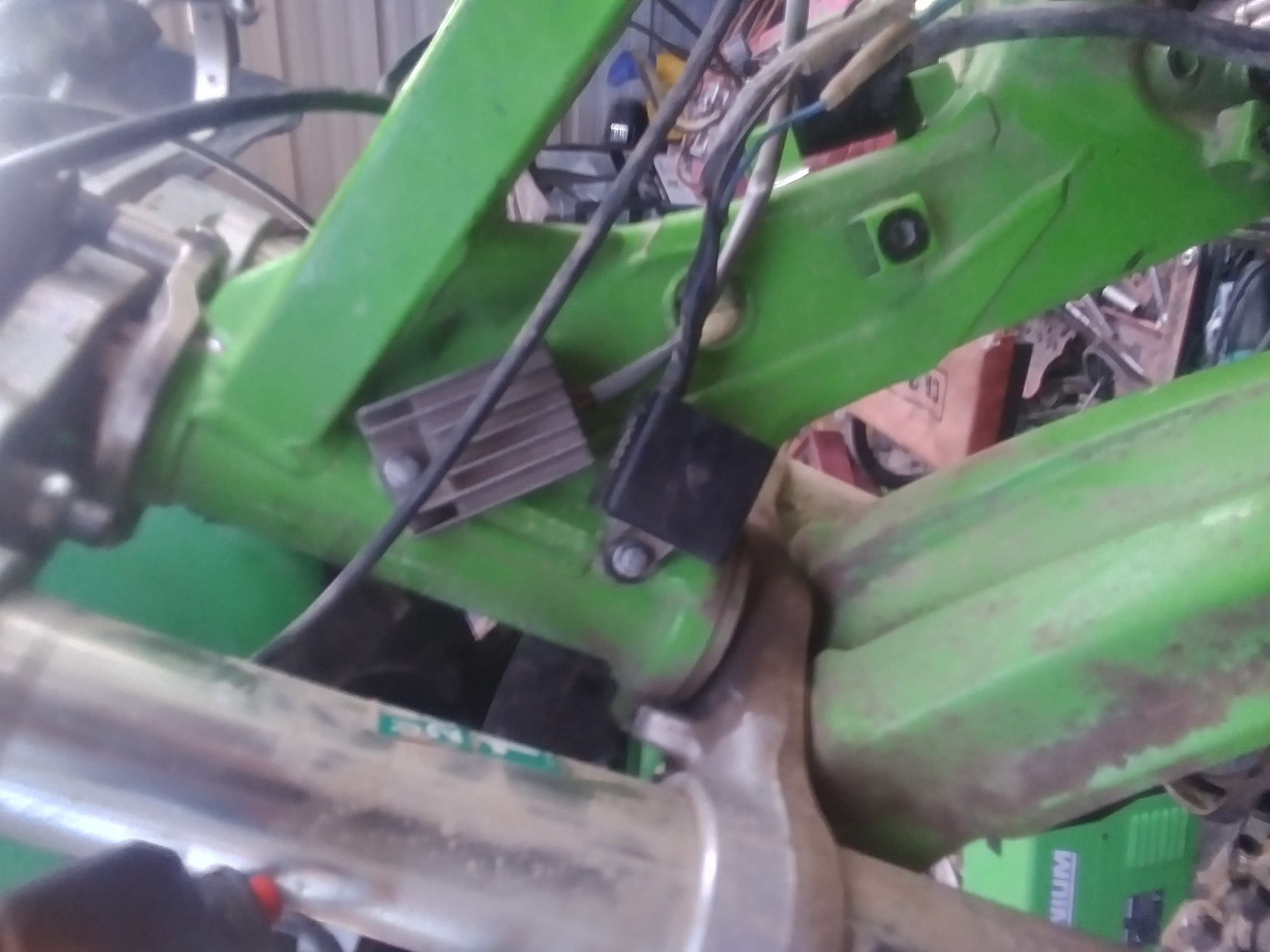

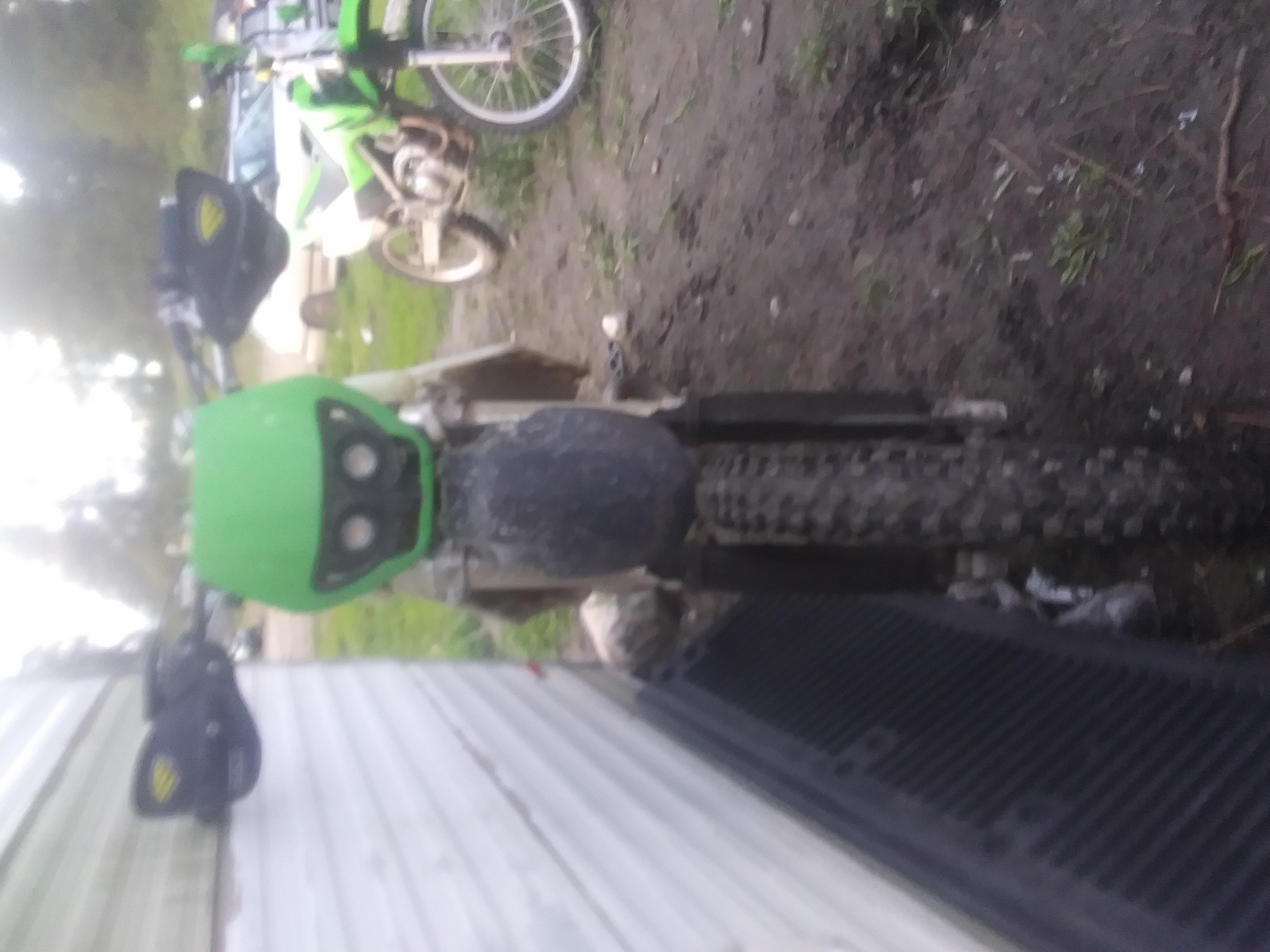

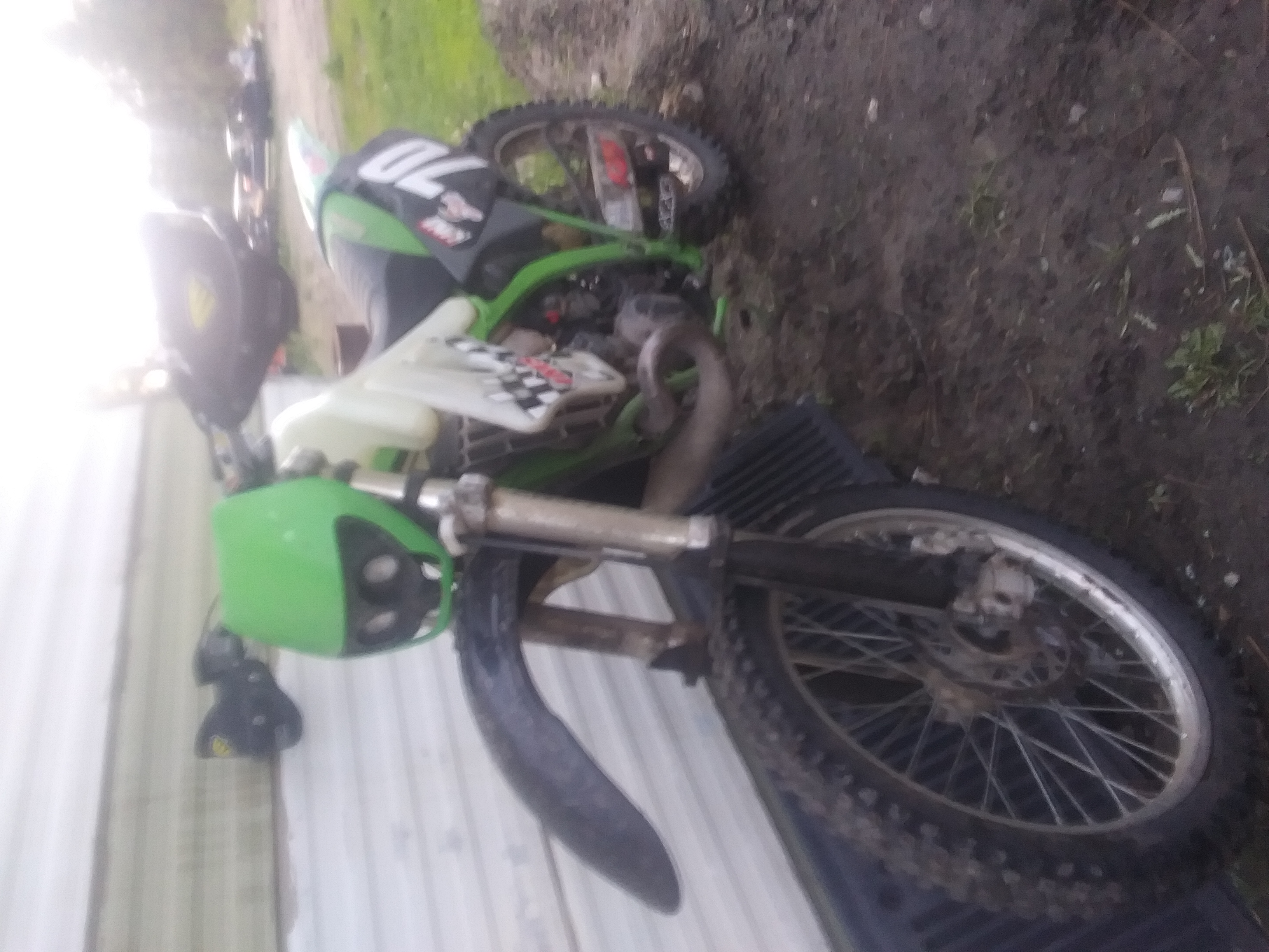

A few weeks ago, the kid, and I went on a "community ride". Afterwards, there was a bbq. Well, on the way back, we just about ran out of light. Just barely enough to barely see.
Today, I finally wired the lights up. That, and swapped the rear fender. Also, the other day, I installed a new chain slider.
