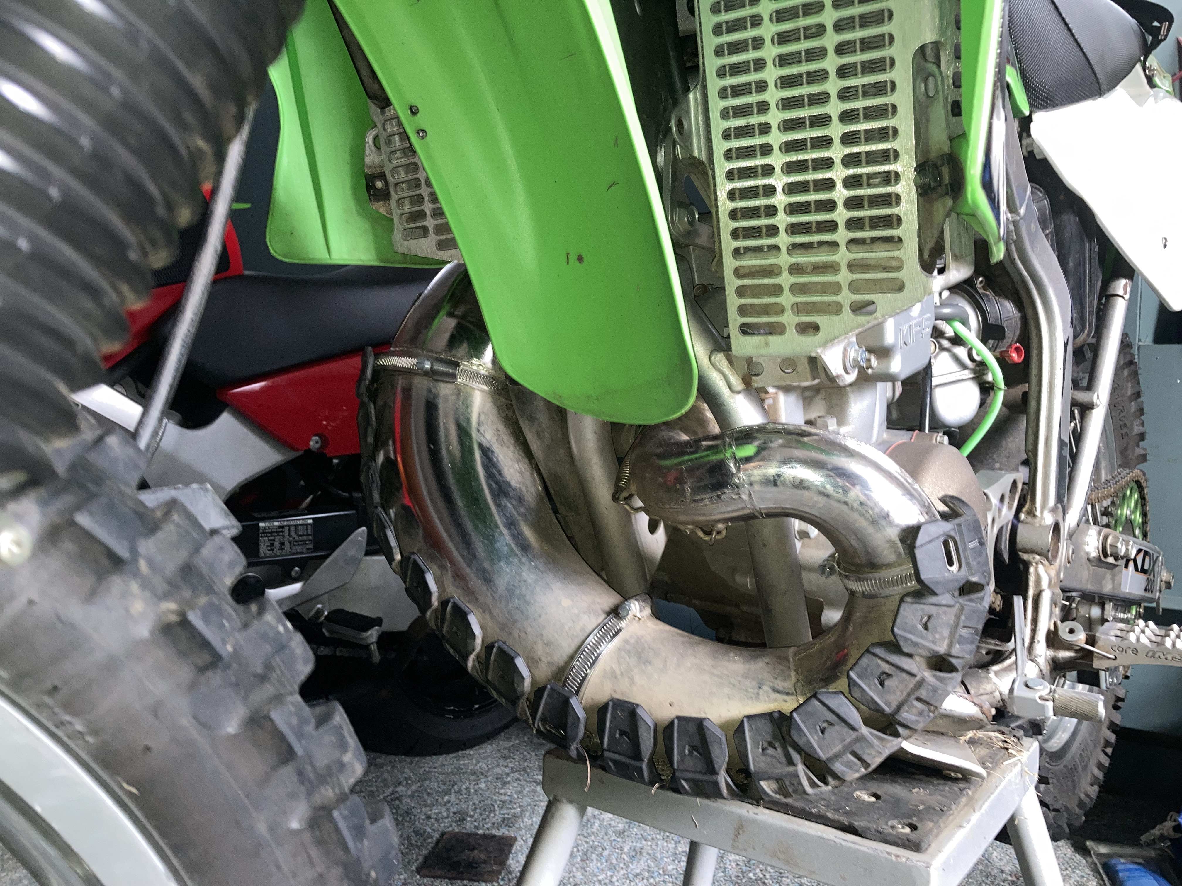

Everything Chuck says about the PC is true.
I went from stock to the PC, so no FM experience.
Snorkel delete
Twin Air filter
JD Jet Kit - set bowl at 18mm, 155/48, clip position 2(<1000ft)
Boyesen Rad Valve
Stock bore(Wossner Piston)
I am on everything from really tight single track, power line roads, and an MX track.
This bike puts a big smile on on the face of anyone that rides it, especially me.
Of course my suspension is dialed in with nice rubber too, so that helps a lot.
Sprung for my weight with race tech springs and Gold valves.
I can lug it thru the tight muddy, root filled rock wall xing trails, rip down the power line trails and with a pull on the bars lift the front end at speed.
Ans she's quiet, as advertised by the 296(I tested it it with my own decibel m,meter to be about 95db)

Trackdog said, "I am on everything from really tight single track, power line roads, and an MX track."
I dunno...his photos show a bike so clean that it could be parked in any living room.
