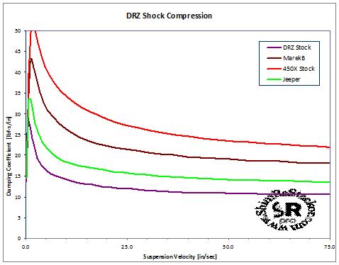

Here's some of the best info on DRZ400 shock valving I've found:
https://www.thumpertalk.com/forums/topi ... t=10987650
and
https://www.thumpertalk.com/forums/topi ... tor-valve/
Terry Hay's valving stack is my #1 pick so far, tuned specifically for the DRZ shock with a rebound separator added. Chopperpilot noted to me that he was following those ThumperTalk threads on the DRZ400 shock valving as well, and was looking to settle somewhere in between MarekB's and Jeeper's DRZ400 shock stacks when using the DRZ400 piston specifically. I would tend to agree with something in the vicinity of those two combos as well, in my very limited experience.
This links directly to Kyle Tarry's post where he ran 4 Showa 50mm shock shim stacks in ReStakor, and posted a graph of them:
https://www.thumpertalk.com/forums/topi ... t=10994244
I've got a handful of open tabs on my phone of other Showa 50mm shock woods valving to sift through as well.
Stock 2002+ DRZ400 compression: ||
44 x 0.20 (4) . . . . . . . . . . . . . . . . . . . . .
44 x 0.15 (3) . . . . . . . . . . . . . . . . . . . . .
34 x 0.15 . . . . . . . . . . . . . . . . . . . . . . . .
26 x 0.10 . . . . . . . . . . . . . . . . . . . . . . . .
42 x 0.20 . . . . . . . . . . . . . . . . . . . . . . . .
40 x 0.20 . . . . . . . . . . . . . . . . . . . . . . . .
38 x 0.20 . . . . . . . . . . . . . . . . . . . . . . . .
36 x 0.20 . . . . . . . . . . . . . . . . . . . . . . . .

Kyle Tarry revalve, compression:
44 x 0.20 (x4)
44 x 0.15 (x3)
34 x 0.15
26 x 0.10
42 x 0.20
40 x 0.20
40 x 0.30 (one shim taken from below)
38 x 0.20
36 x 0.20
34 x 0.20
32 x 0.20
30 x 0.20
28 x 0.20
26 x 0.20
24 x 0.20
25 x 0.60 (spacer due to shorter/modified rebound stack, shim is from stock rebound stack)
40 x 0.30 (spacer)
41 x 4.00 (plate)
18 x 0.60 (spacer)
Jeeper's Revalve, compression: . . . ||
44 x 0.20 (x6) . . . . . . . . . . . . . . . . . . . . .
44 x 0.15 (x5) . . . . . . . . . . . . . . . . . . . . .
30 x 0.15 . . . . . . . . . . . . . . . . . . . . . . . .
40 x 0.20 (x3) . . . . . . . . . . . . . . . . . . . .
34 x 0.20 . . . . . . . . . . . . . . . . . . . . . . . .
32 x 0.20 . . . . . . . . . . . . . . . . . . . . . . . .
30 x 0.20 . . . . . . . . . . . . . . . . . . . . . . . .
28 x 0.20 . . . . . . . . . . . . . . . . . . . . . . . .
26 x 0.20 . . . . . . . . . . . . . . . . . . . . . . . .
22 x 0.20 . . . . . . . . . . . . . . . . . . . . . . . .
25 x 2.0 . (spacer for washer/nut) . . . . .
MarekB's revalve, compression:
44 x 0.20 (9)
44 x 0.15 (6)
38 x 0.15
30 x 0.15
42 x 0.25
40 x 0.25
38 x 0.25
36 x 0.25
34 x 0.25
32 x 0.30
30 x 0.30
28 x 0.30
26 x 0.30
24 x 0.30
22 x 0.30
25 x 2.0 (spacer for washer/nut)

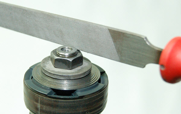

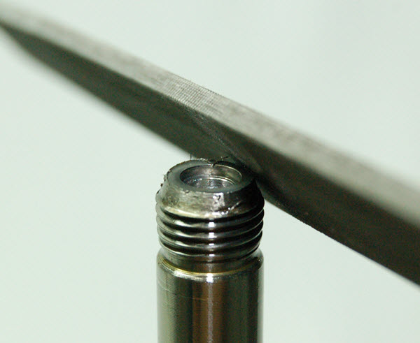

Also a note for disassembling and revalving the shock shaft/piston on all Showa shocks, per Race Tech's shock Gold Valve install instructions (still pertains to any revalve even with stock piston).
https://racetech.com/ip-sk-valving-std/
Look at the special note for Showa shock revalving when removing the peening on the end of the shafts. You have to file around the edges of the shaft protruding above the nut to remove only the peening/staking, NOT filing flat across the top like you would on a KYB or basically any fork base valve.
The rebound adjuster has a bleed orifice seat in there that the staking/peening holds in place, and you must not file into that otherwise the adjuster will be rendered useless!!!!

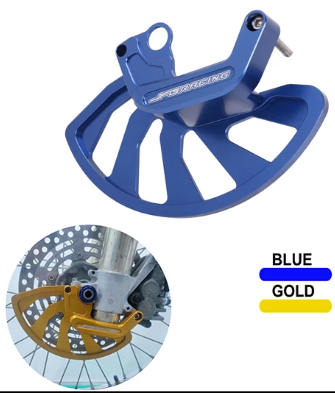

Also, I found that JFG makes cheap billet aluminum anodized front rotor guards for the DRZ400 (& '97-'98 RM) Showa 49mm conventional forks!
$35 on eBay or AliExpress, as low as $23+$4 shipping on AliExpress if you prefer blue instead of gold anodized.
https://jfgmotor.com/products/front-bra ... XUgAYCq9rp

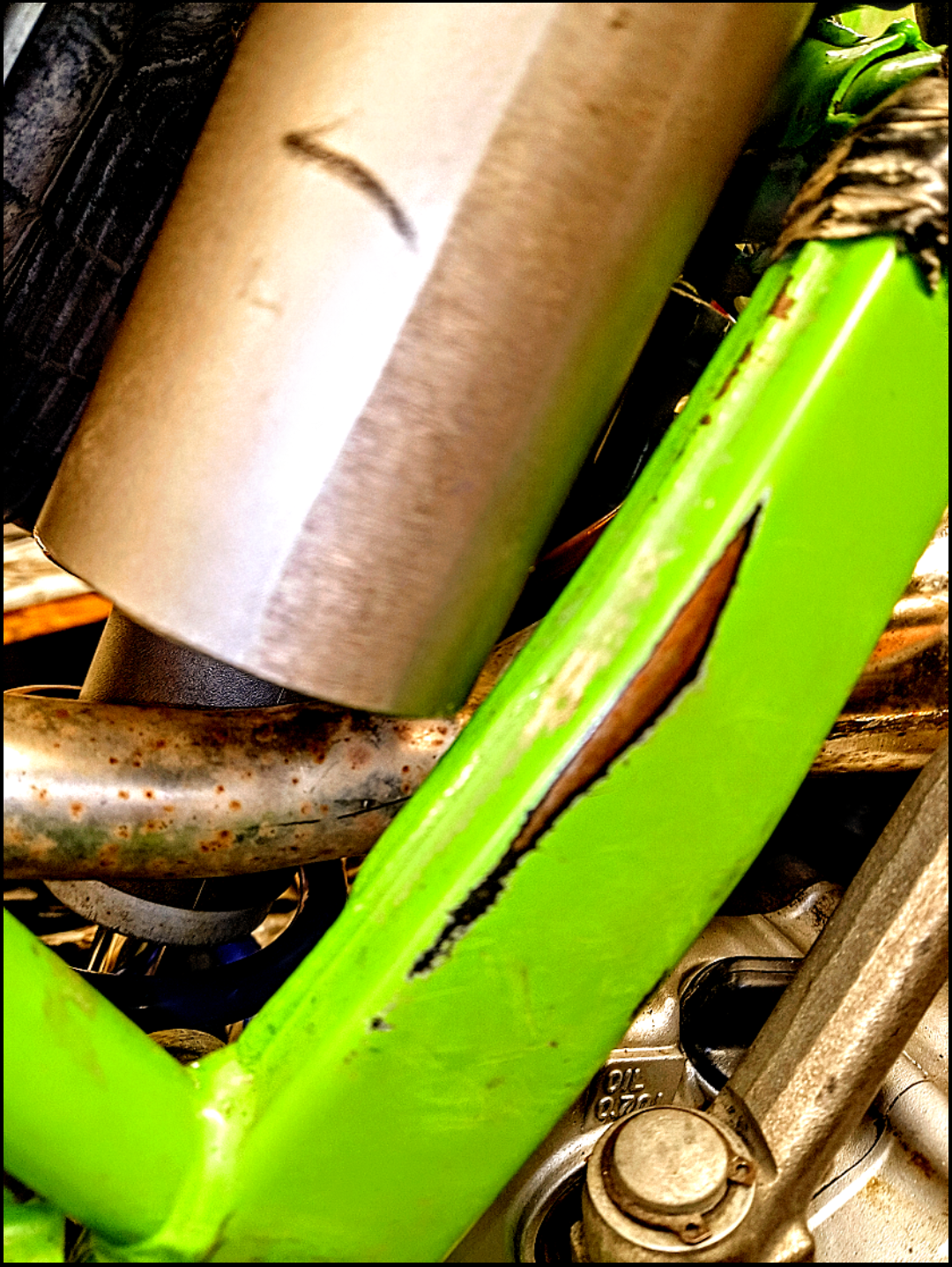

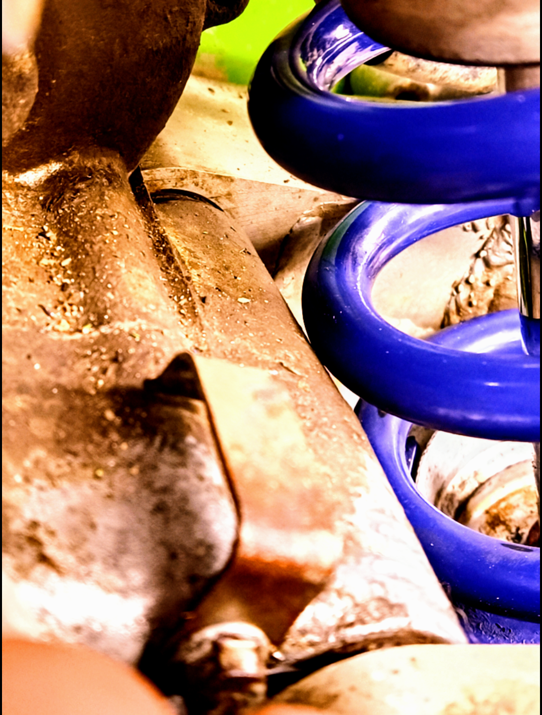

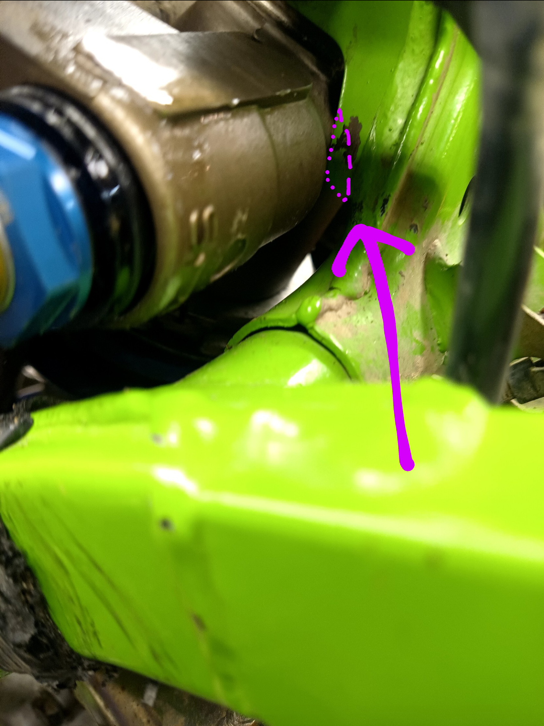

The DRZ400 clevis made contact with the top of the KDX's suspension linkage rocker at top-out, but I was still able to tilt the shock forward to get the frame's upper shock mounting bolt through the shock, although it does need filed slightly.
The '01-'04 RM clevis, with it's rocker mounting bolt holes located 5.5mm higher (shorter clevis), won't even come close to tilting forward to bolt unto the upper frame mount without some significant filing and dremel work to bevel the front facing horizontal surface crotch edge of the clevis.
The '98 RM shock looks great installed, but is a close fit in a few areas of the frame, one which really needs massage by grinding off unnecessary metal on the edge of the flat steel stock making up the upper shock mounting point on the frame, the lower right rear side needs a bit of excess trimmed off to not rub the shock body when topped out.
Reservoir clearance on the '98 RM125/250 shock is close to the frame, but clears and works. With the full weight of the bike on the ground, the shock will swing backwards, giving more clearance. The modern Showa 50mm shock is such a significant upgrade that I'll go to great lengths to make it fit perfectly.
****Here's where no one prior had made any comments about required spring clocking due to engine case interference... You need to rotate the spring so that with suspension topped out, the gap in the coils is aligned with where the spring would otherwise rub the engine case swingarm / engine mount bolt area.
As soon as travel starts, the shock moves further away from the engine case, but at initial travel, this needs to be clear and aligned strategically. I have no issue filing a bit of clearance into the engine case halves here (the area is 10mm thickness at left and right, but thinned to roughly 7mm guesstimate in the entire area in question), as this is a substantially improved rear suspension over stock... I just wouldn't want to file all the way through into the bore of the swingarm/engine mounting bolt - I'd drilled a small pilot hole through to witness the material thickness as to not grind all the way through it.

On 12/31/2020, CWToyota on ThumperTalk.com wrote: Your suspicion is pretty inline with what I've learned (at least on the Yamaha).
In my track testing of a 1.5mm longer YZ link length, the longer link was just slightly softer early in the curve and it delayed the major increase in ratio until later in the travel. The delay was the more significant of the two effects. It was great in some flat or slick corners, especially when steering with the rear end or scrubbing a jump. It was terrible in the whoops (Washougal this summer) where the bike wallowed and I couldn't consistently get a forward drive because it was moving up and down too much. That feeling was confirmed by a rather savvy local pro buddy who was watching that race, he observed exactly what I was feeling.
Looking at my bike hanging from the basement ceiling as a makeshift "motorcycle lift" work stand, and swapping suspension pull rod links, it became pretty clear that the main leverage changes occur from swapping a different rocker knuckle in, and behind that, altering the shock length which puts the rocker in a different position in it's curve. Adding a different length pull rod / dog bone link set has a minor effect but still contributes. A longer pull rod link set primarily just changes the swingarm position. It has no change in the rocker, although the differing angle of the swingarm vs rocker linkage via the connection of the pull rod links will be slightly altered, which is where the changes in the traits come from above on the YZ referenced.
If there is a significant change in suspension traits with the 117mm links vs stock 112mm, I have the KLX650R 115mm links that I can swap in. From hearing feedback on Kouba KDX1 links, there is very minimal change in the damping action when lowering the bike around 1" (almost the exact lowering link length as the KLX300 117's). If I swap in the 115's, the ride height will increase, but I can back off the shock spring preload to lower the height again as well as get some more initial plushness.
https://www.thumpertalk.com/forums/topi ... t=15885632
more:
On 12/31/2020, GHILL28 on ThumperTalk.com wrote: A rod with 4mm longer length wont change the leverage curve dramatically enough to matter. A bellcrank that changes the shock placement to alter geometry will majorly affect the leverage curve and the average leverage ratio.

I'm out with a fractured wrist for the reminder of the season, but becoming more active as the bones are starting to heal (with the help of a surgical screw holding my scaphoid halves back together!).
I spent a little time one-handed looking into shock lateral movement through the stroke vs airbox boot clearance.
Compressing the shock to the bottom out bumper, the lower end of the shock moves a significant amount rearward, no clearance issues there aside from the topped out starting point I'd mentioned previously with the shock spring coils needing rotated into necessary clearance alignment in order to not hit the crankcase's rear swingarm/case mounting bolt area.
At the top of the shock, the airboot has a larger clearanced area where the shock spring is adjacent, but is much closer at the top of the shock body above the spring. This clears by about 5.5mm still at almost full bottoming (I didn't compress the bottoming bumper). It moves probably 5mm rearward closer to the airbox boot during a full compression stroke however.
This test was done by me as I wanted to see how far back I could get away with relocating the upper shock mount to help slightly with the clearance at the lower end...
What I'd gathered is that I can bend the upper rear airbox mount z-bend more straight and rearward slightly to gain a touch more airbox air intake boot clearance as to be able to cut, extend, and reweld the upper shock mount 5mm-6mm rearward as planned and 16mm roughly upward, as to be able to utilize the full travel of the RM125 shocks or near it, and and not worry about any significant internal lowering of the shock to prevent it from topping out.
Without raising the upper shock mount higher, we'd be very slightly different reducing the overall available travel just a touch with any of these shock upgrade combinations. Less than 12mm travel reduction, hardly noticeable, and a short chain vs long chain axle adjustment covers probably a similar amount of travel gain/loss.
