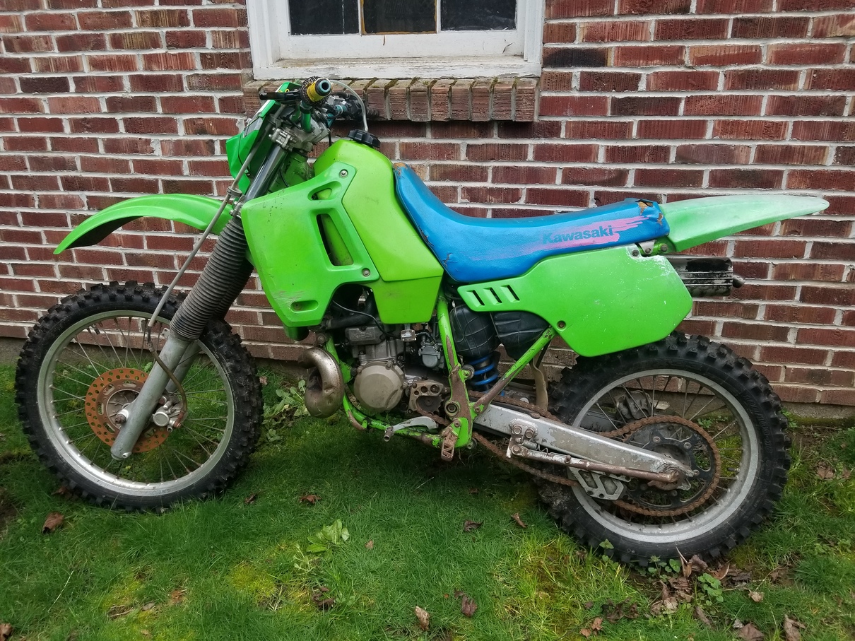

Here she is. Was finally able to find this pic

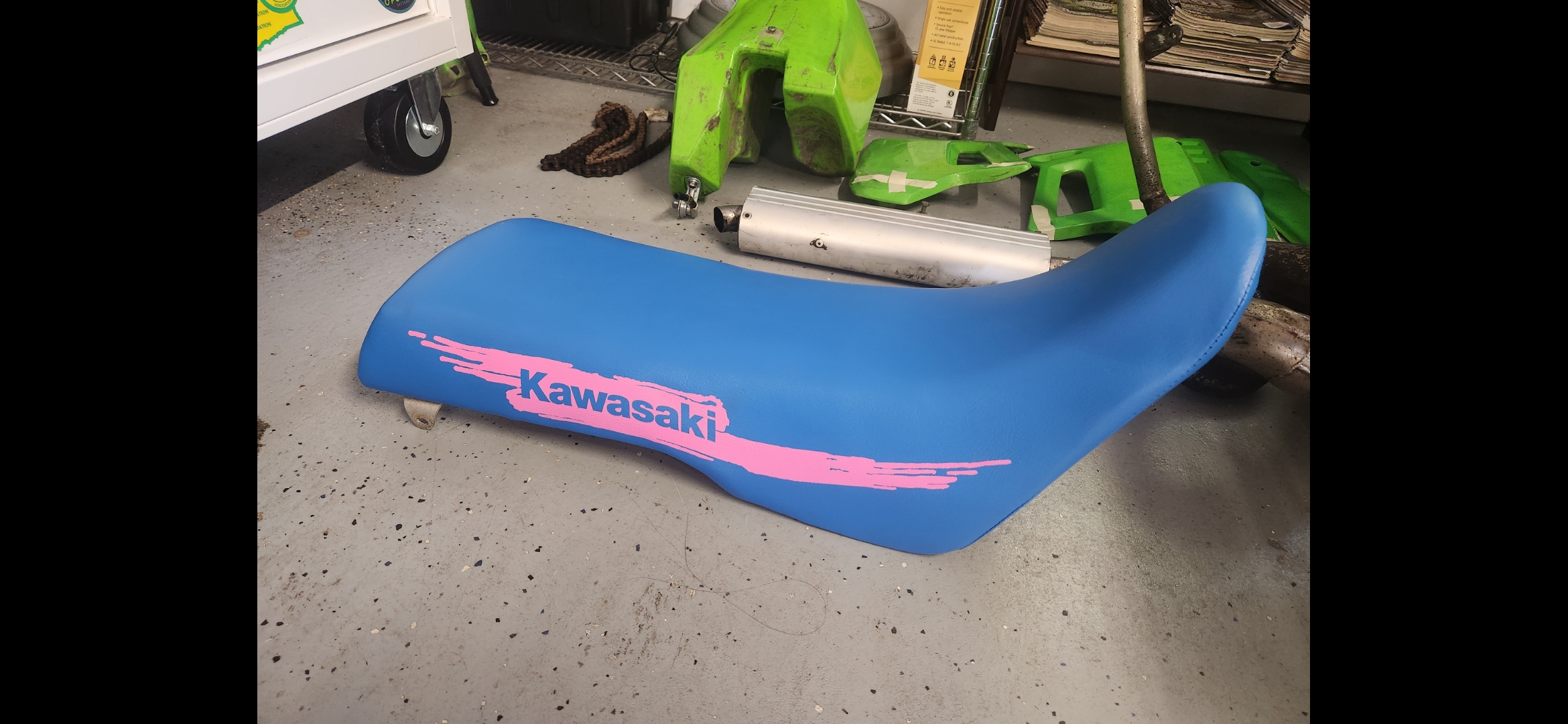

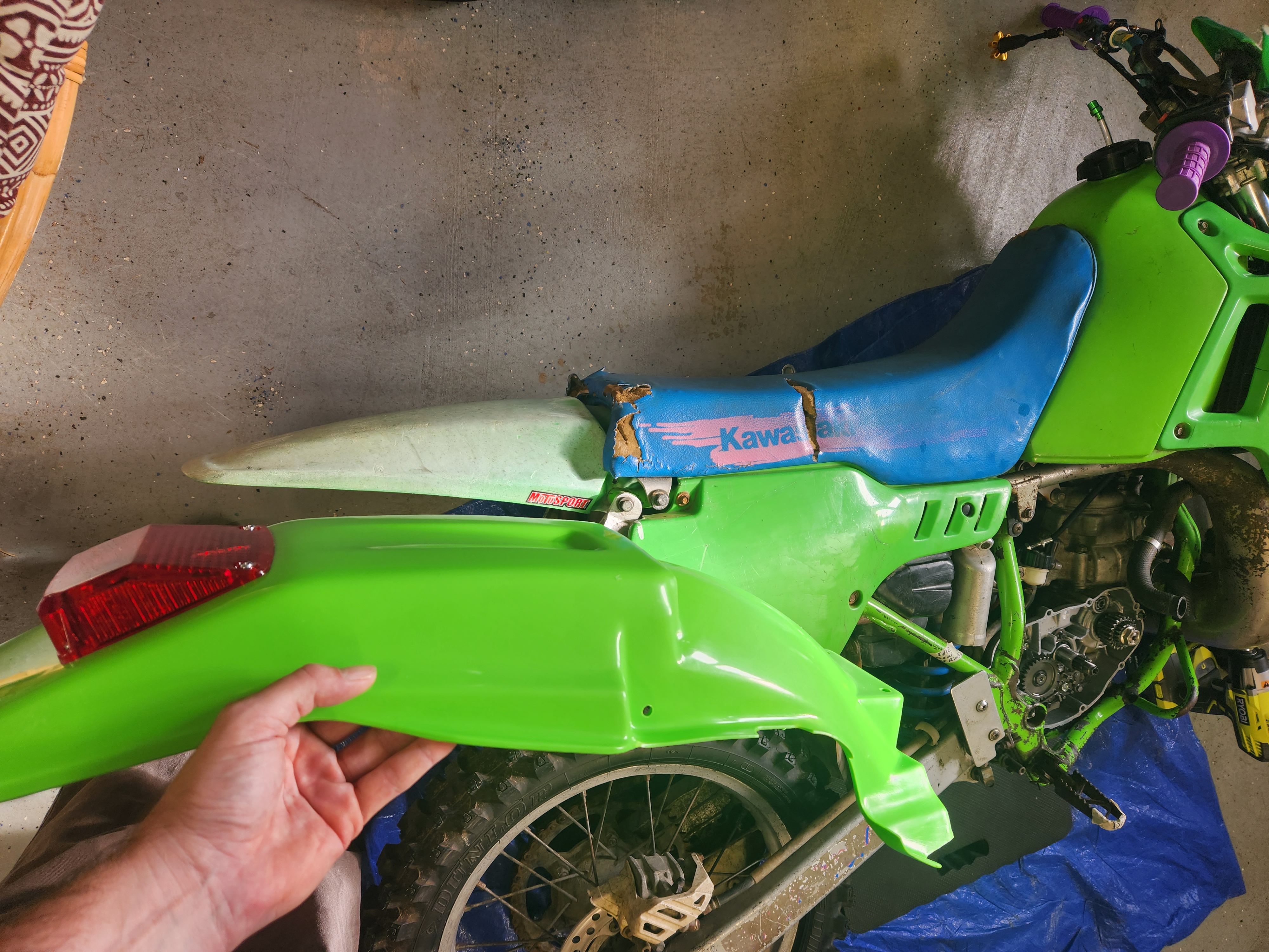

Also new seat & UFO rear fender with it. Has almost new Dunlop tires on it.
I think previous owner was going to restore it and didn't want to finish it for whatever reason
