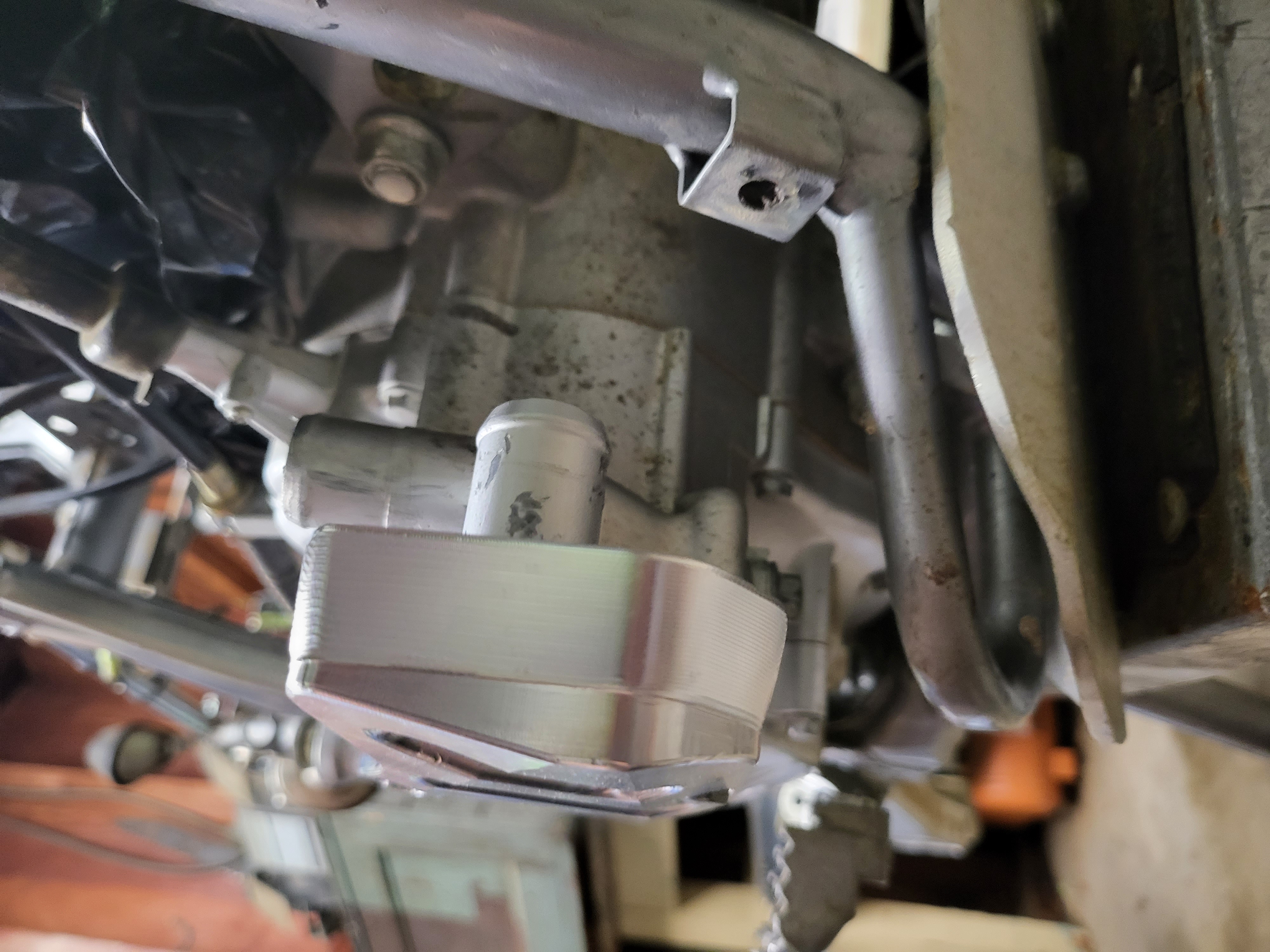

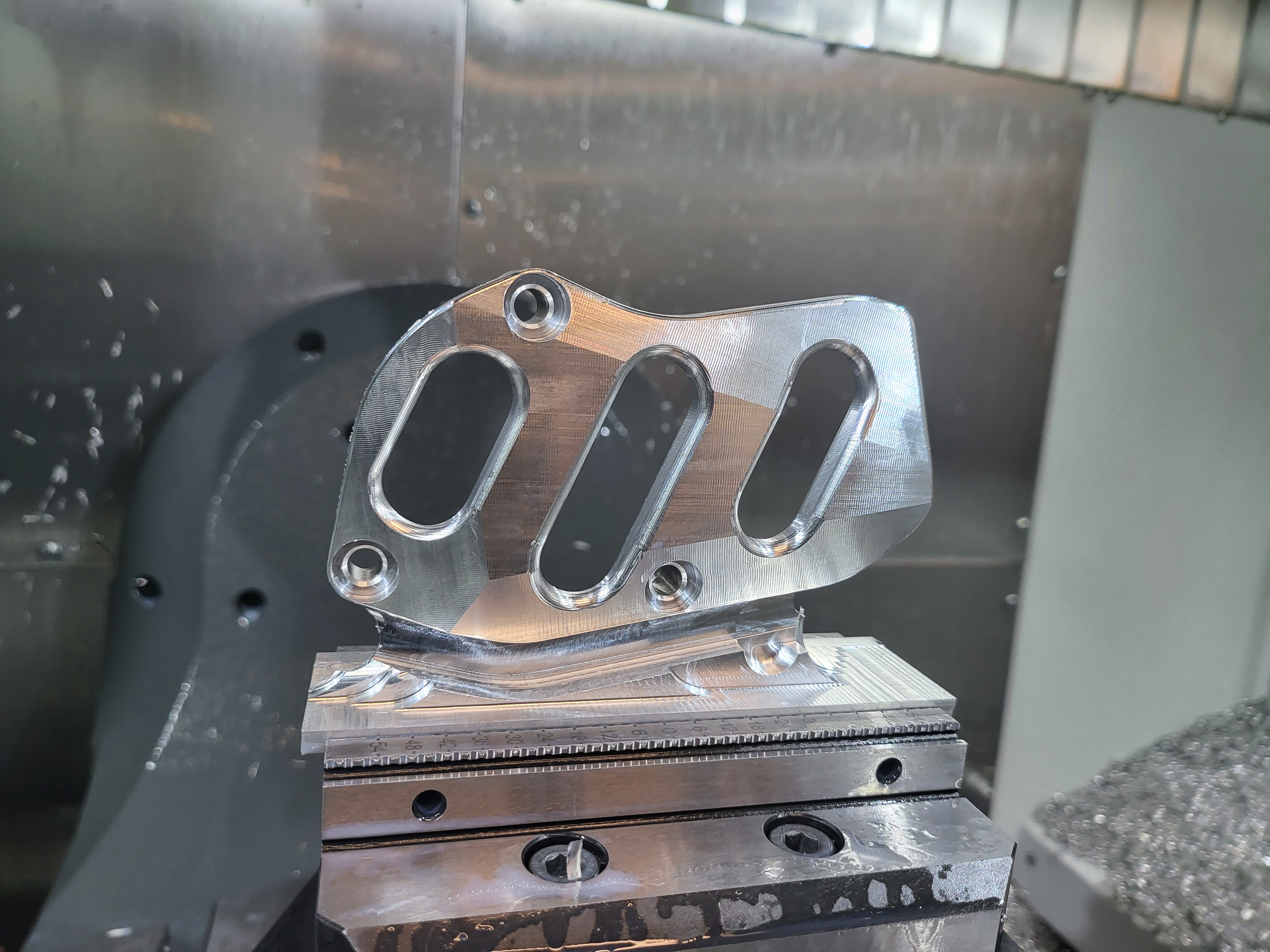

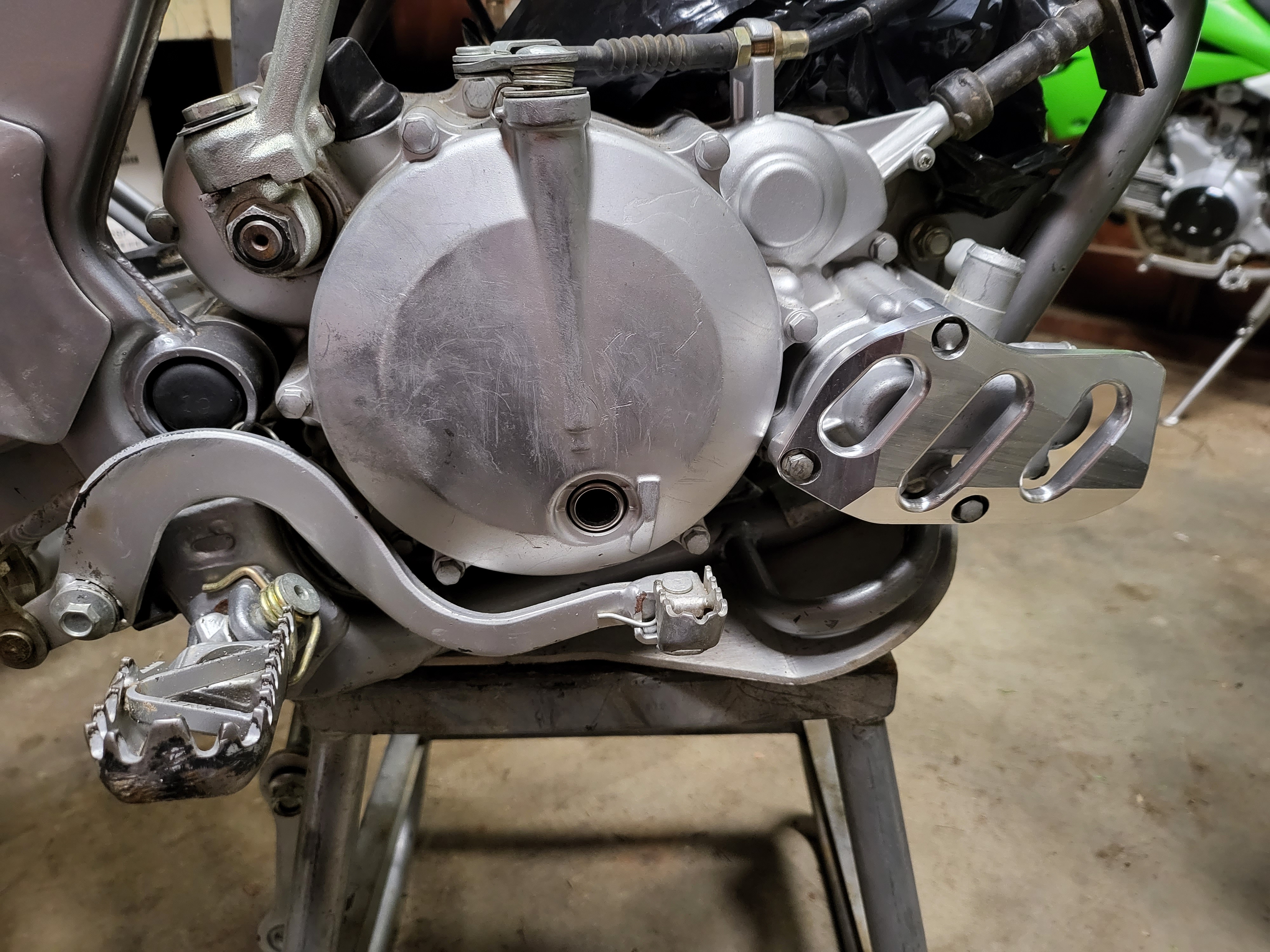

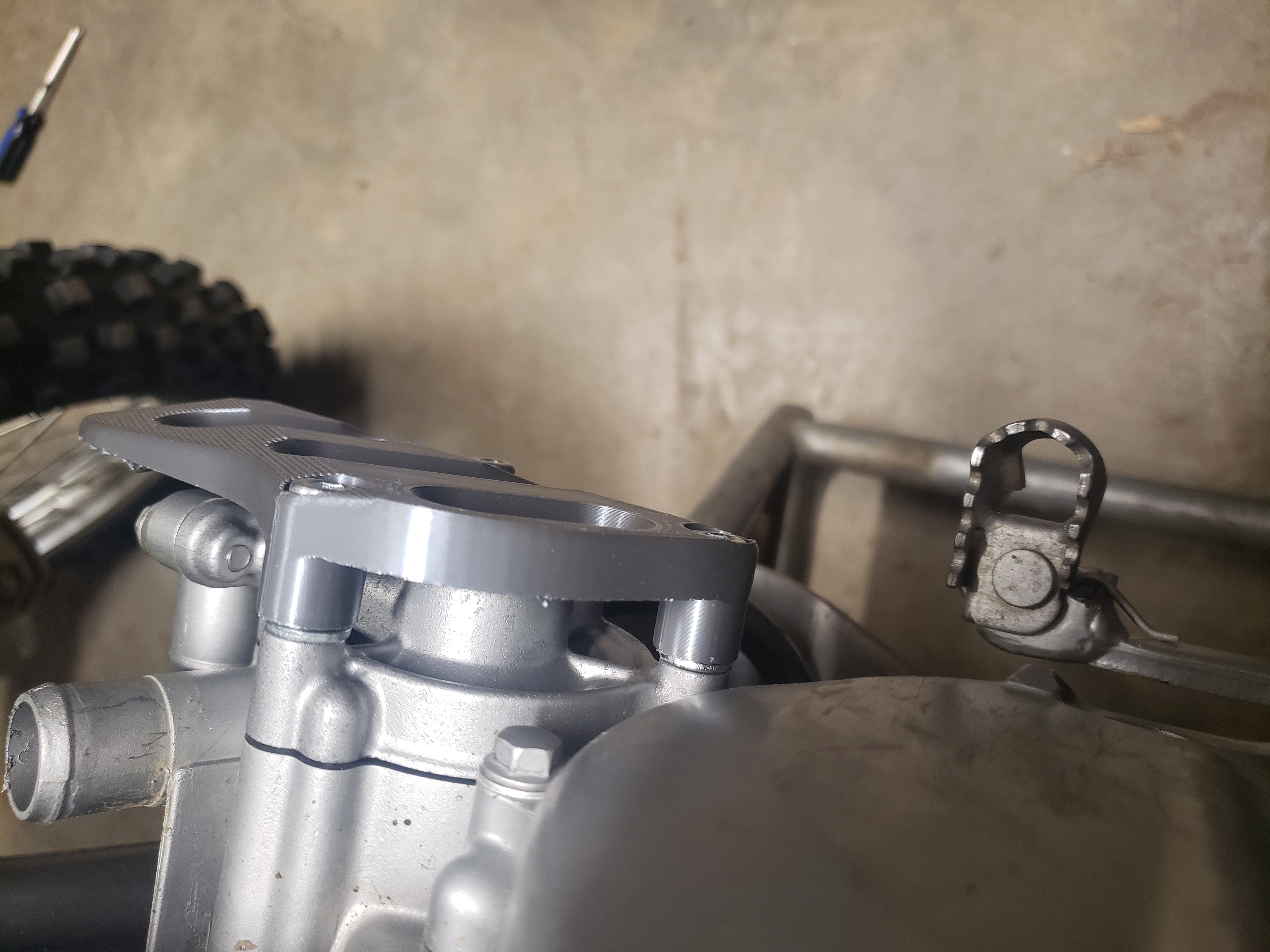

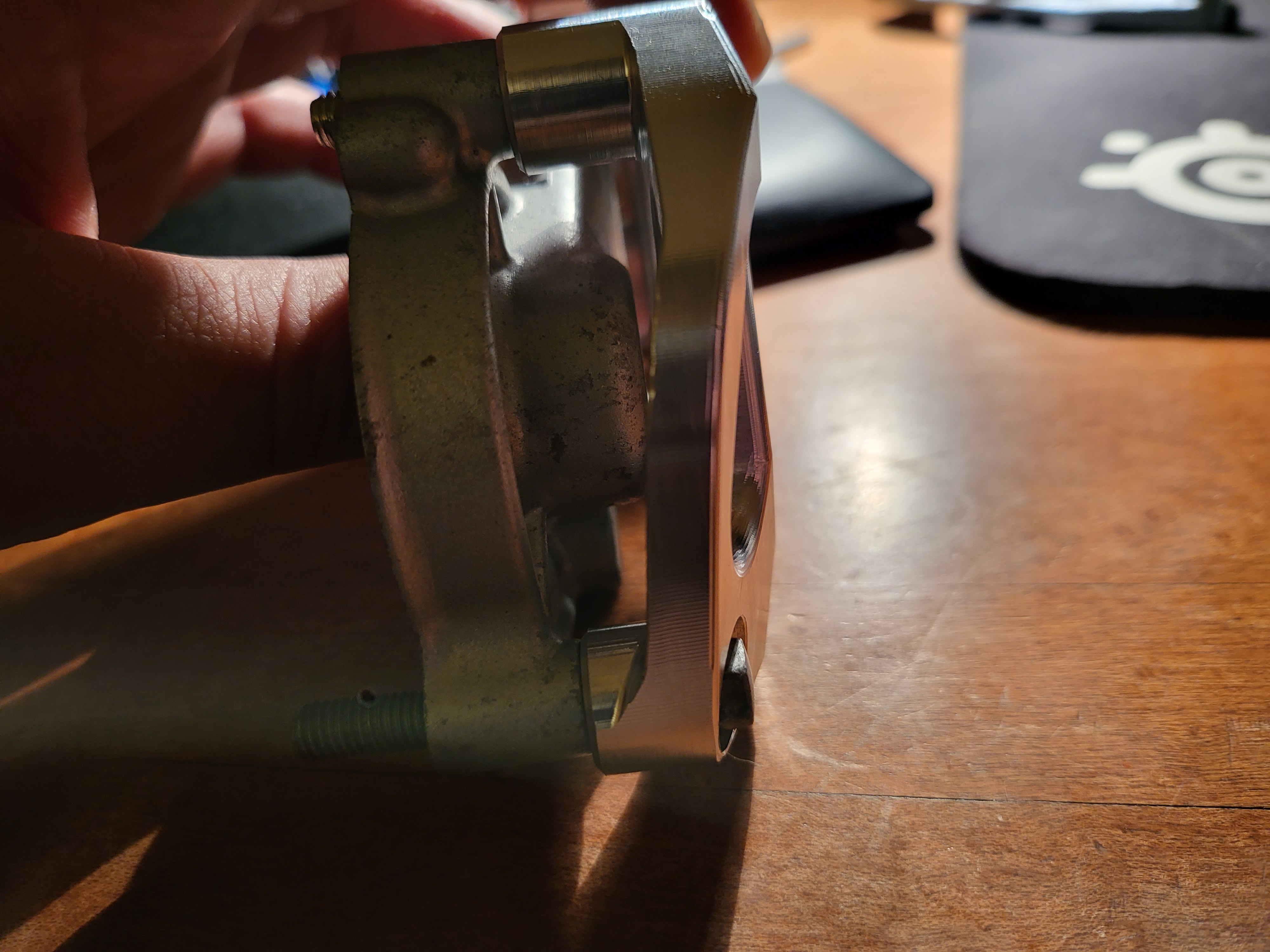

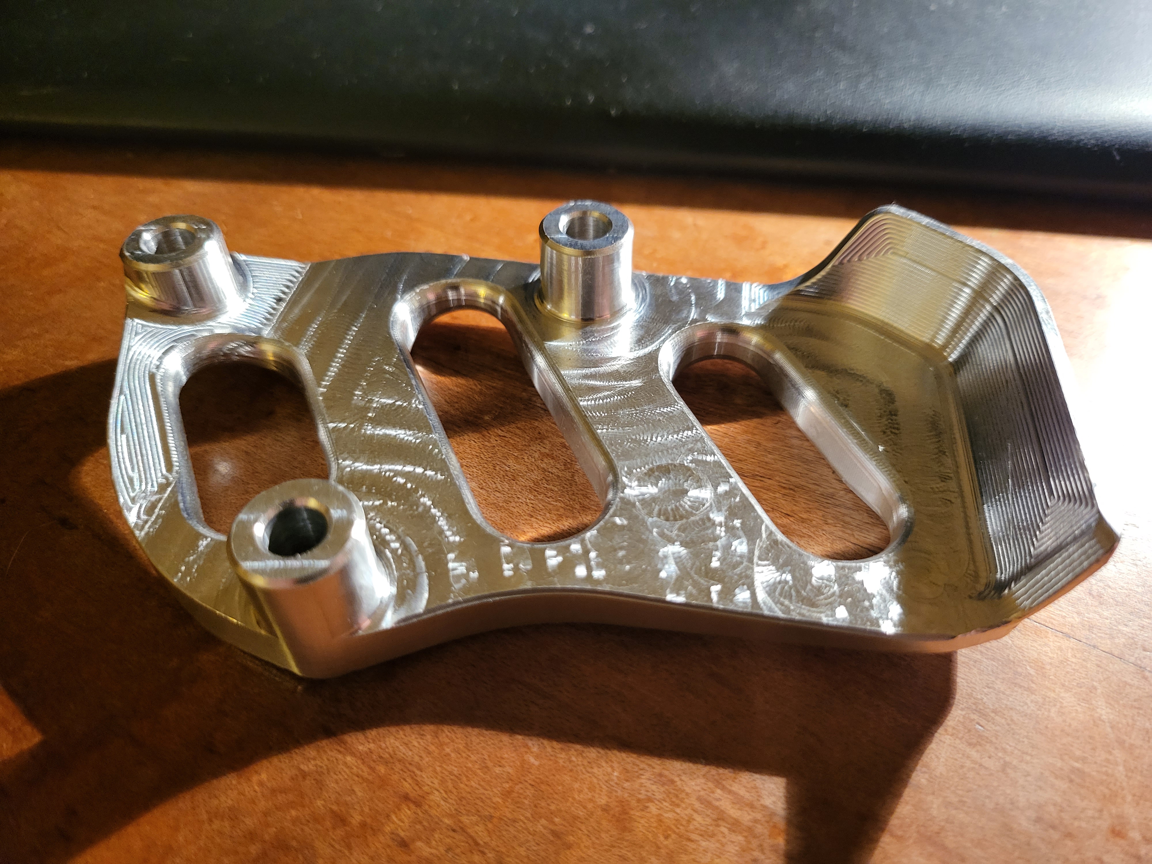

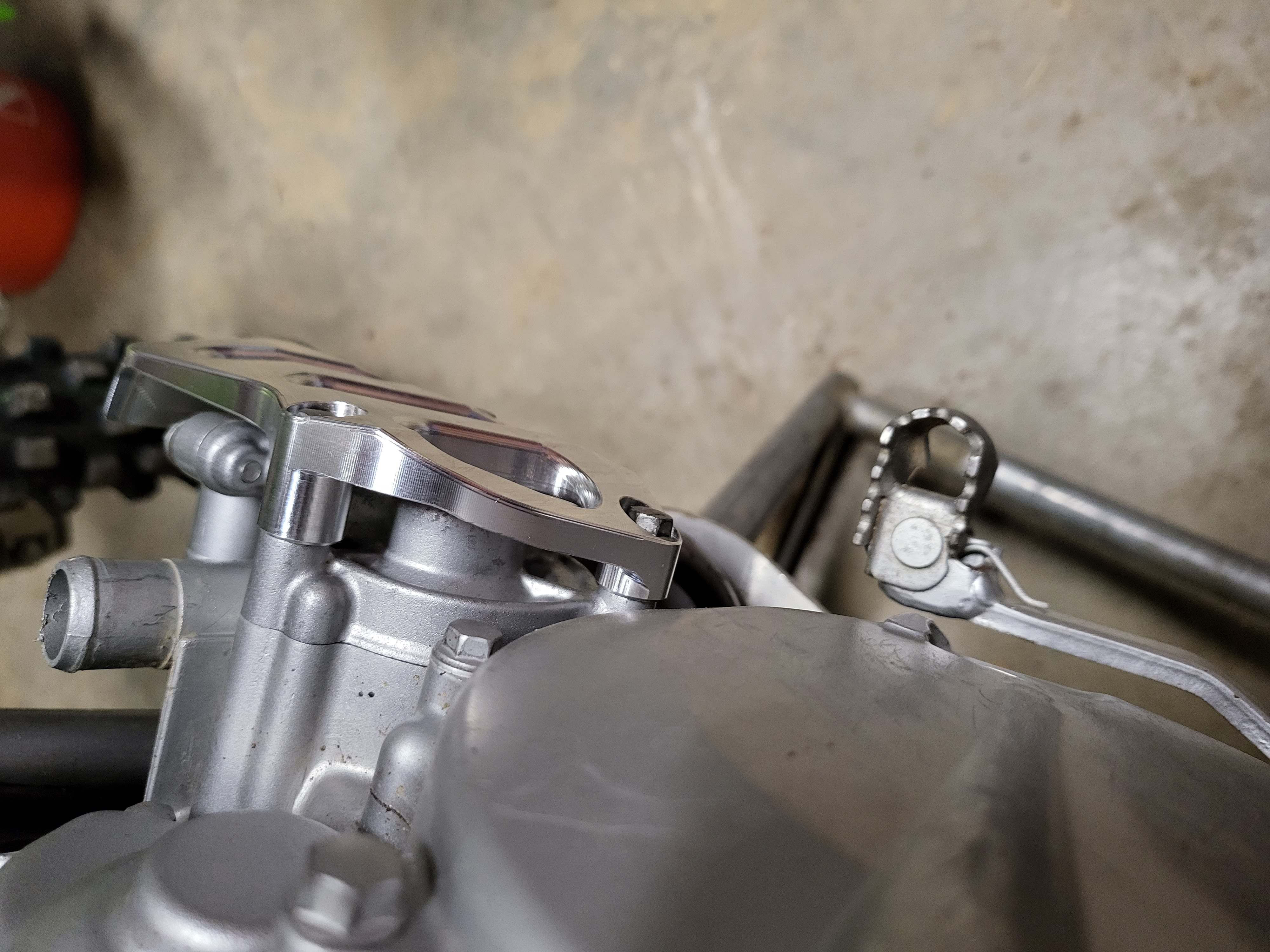

Sorry for the lag. Work has been busy and our 5 axis has been setup as a drill press until last night. Finally got one done, had some chatter on the inside but the outside looks good. Was hoping to find a double sided bolt with a hex in the center so you dont have to loosen the pump cover to take the shield off. Couldn't find one long enough so the bolts just run straight through. 2 bolts are +15mm from stock and one is +5mm. I angled one side because the original one seemed like your foot would hit it. see the 3d printed part picture.

Damn, that's a nice piece! Well done! :supz: Now the question begs... how much? :mrgreen:

@SS109 I was going to look at hard anodizing one, but regular anodized black probably $50 + shipping. I have to see how much the material costs, it might be $40. I have 8 pieces of material cut that I used from a left over bar, to make any more id have to order a 12ft bar of 1.5 x 3.5" and Ill get 27 blocks.

Damn! That is sweet!

Very nice, heavy duty, I like it!

I would like one, I like hard anodize. Let me know.

@Molly's 70 Sure man, send an e-mail over to info@foesracing.com with your info and say its for the kdx pump guard. I can cut another one right now but i want to try and change the program so it doesn't chatter so bad on the inside. I need to order some bolts too so it can come with them. Ill take a pic with the pipe on tonight I wanna double check that its not too close to it.
