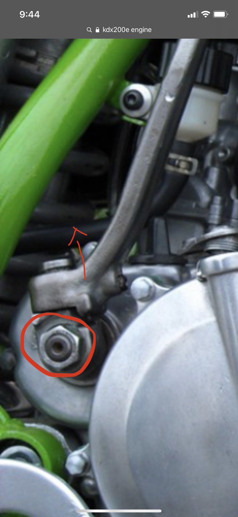

This photo isnt my bike, but here is what I am talking about.
The nut/bolt that is circled would not budge, and i was afraid I would do internal damage if i really reamed on it. Since the kickstart slips, my wrench would too as I leaned into it. I didnt want to use an impact because Im afraid that the gears inside would just shear apart with that force. I tried a little bit of heat but I didnt want to cook the kickstarter seal behind it.
The arrow pointing up is showing what I meant when I said the arm would not slide off. That one may take a little gentle tapping/working to get it off, but I figured if I couldnt get the bolt out of the splined shaft, theres no reason to pull the arm off.

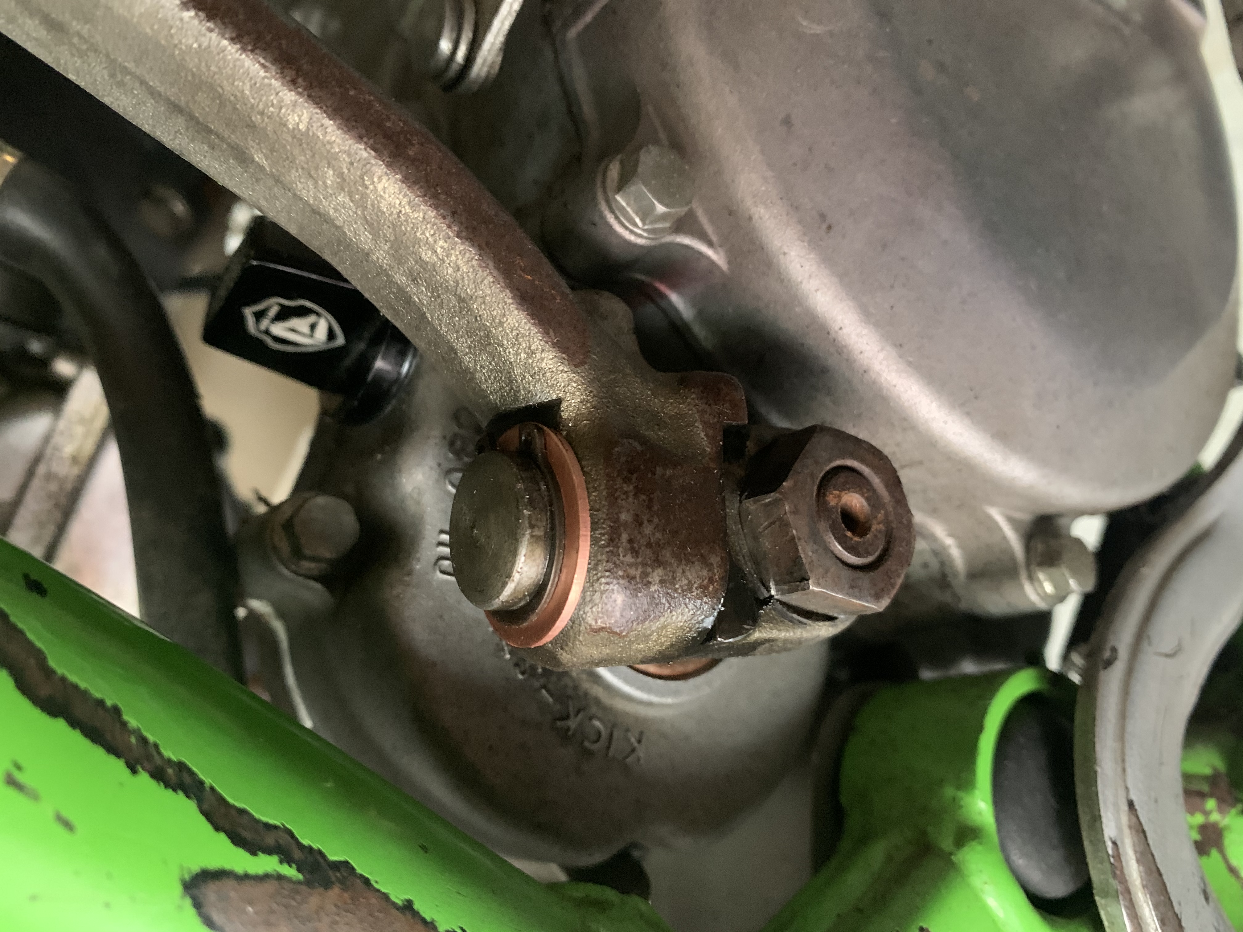

Take a picture of what you have right now

The circled bolt is seized. I will have another go at it in a little bit.
Doesnt look like much since its all back together, but here it is. Washer on there is a new copper one i put on when i put it back together since the old one was nasty.

One way or another it needs to come off. You might start spraying it with penetrating oil and see if you can get it to budge. If not an impact driver might break it loose.

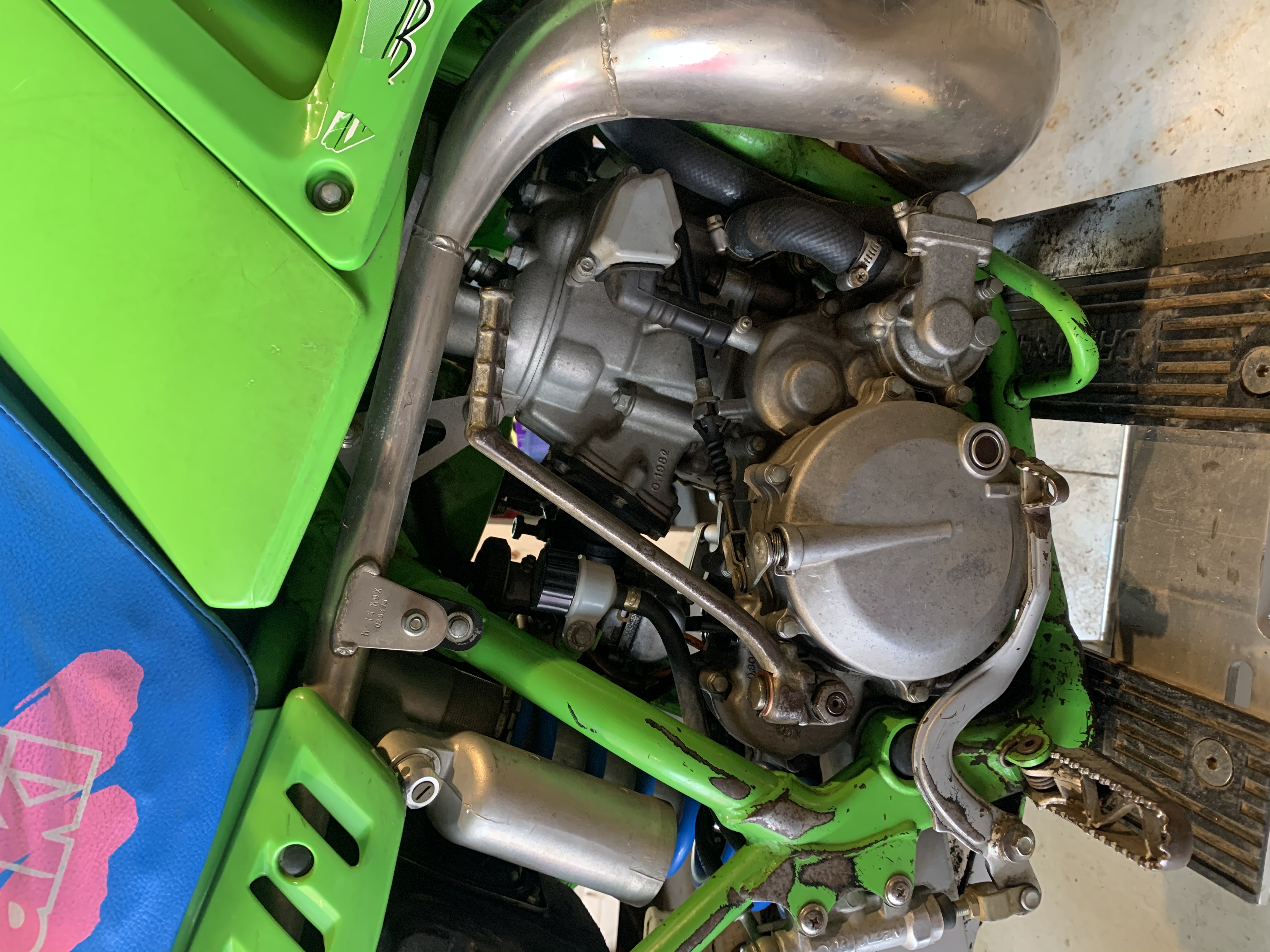

Are you sure the kick lever is not able to make contact with the pipe and that is the noise you’re hearing? Your engine sounds pretty healthy from what you’ve shown us in the video. The radiator “mount” also seems suspect.

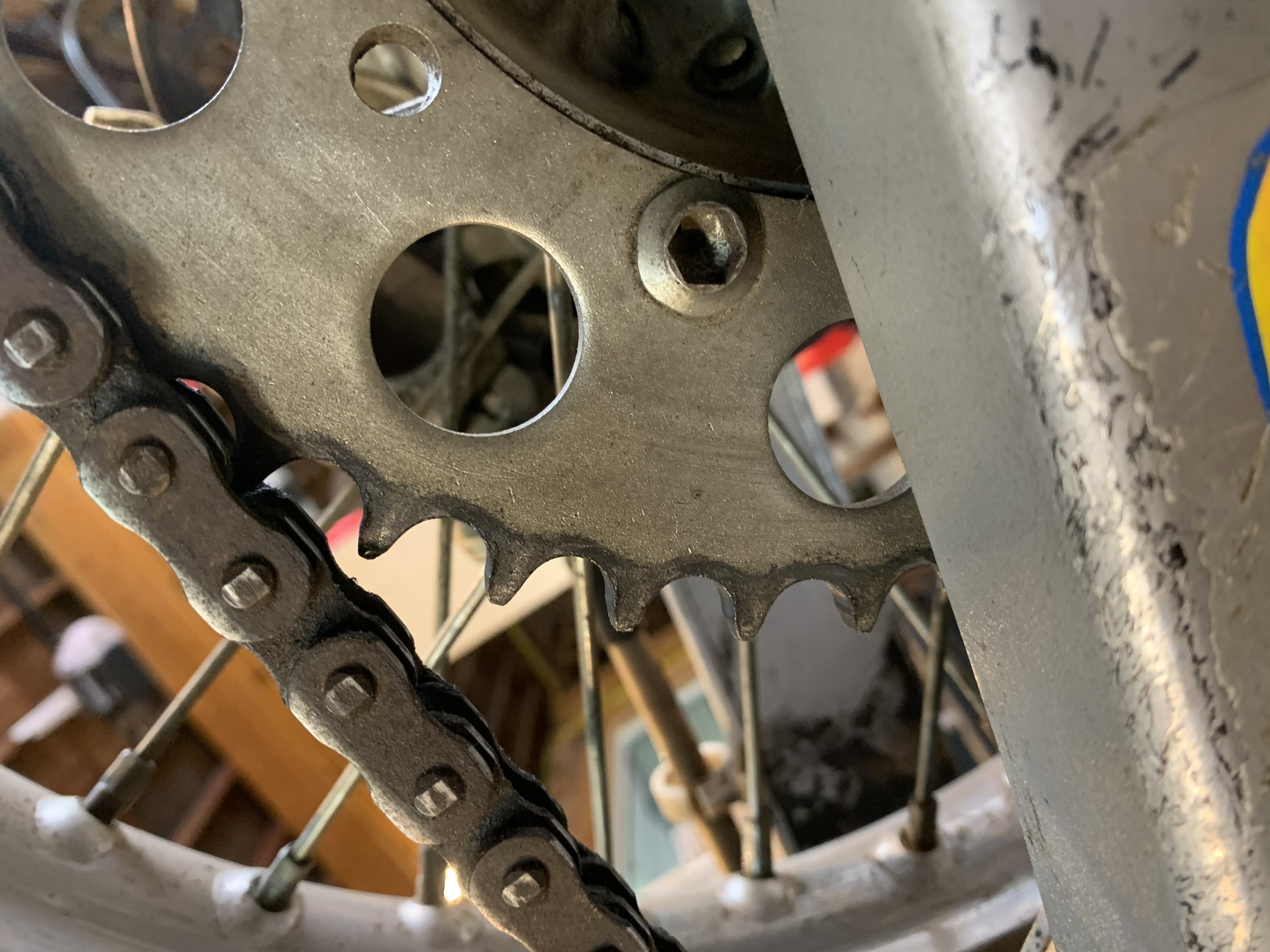

How about a pic of the condition of your rear sprocket? Are you getting any undulating or odd rhythmic sounds and vibrations from the chain?

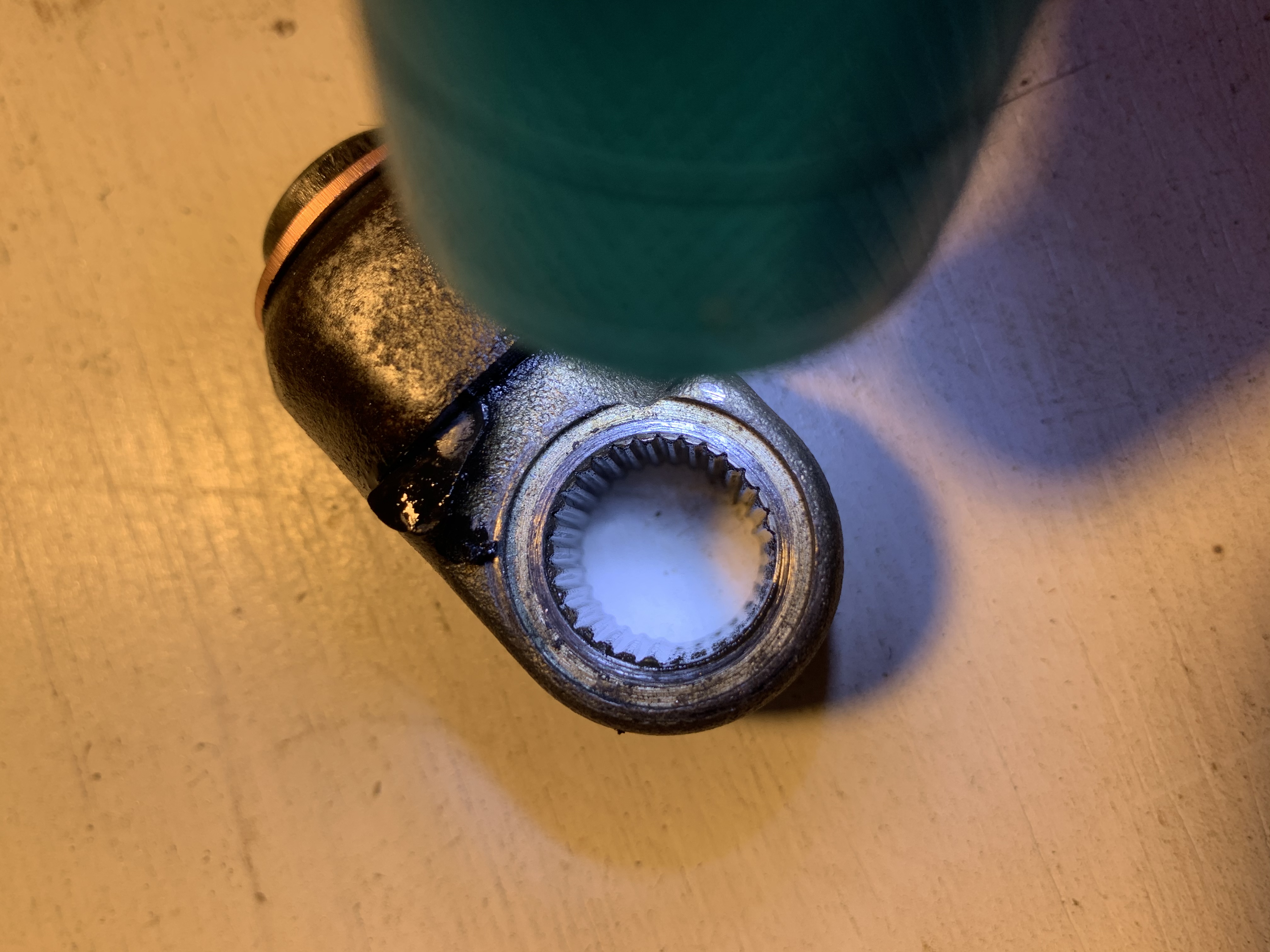

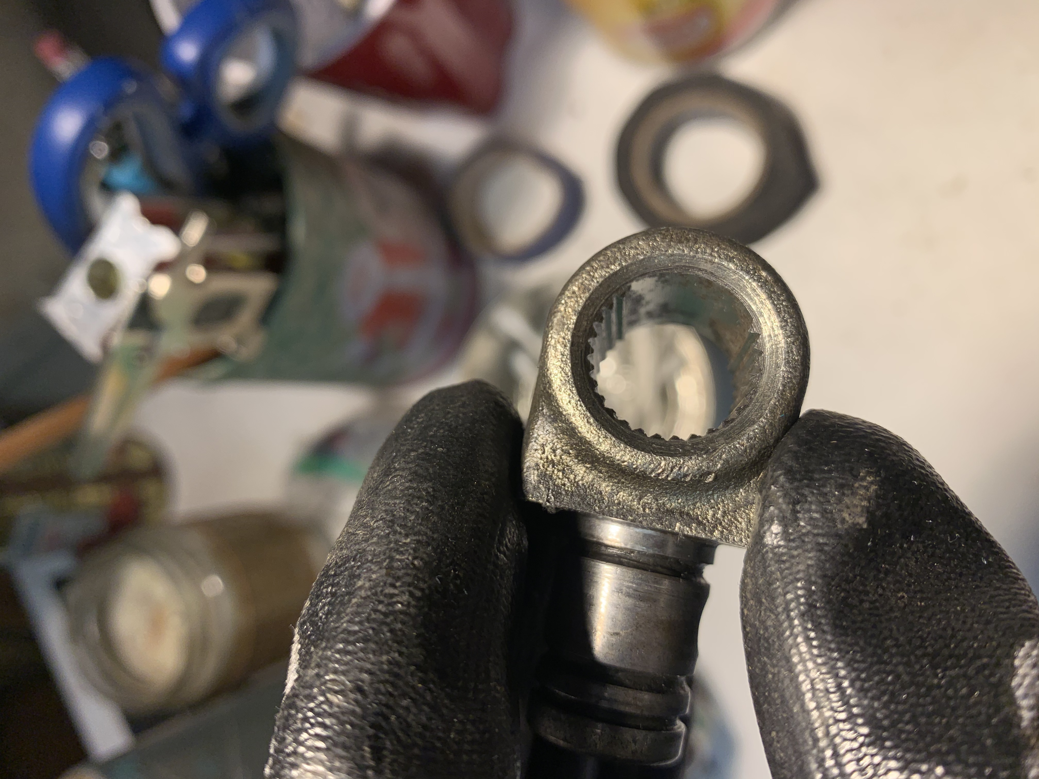

got it! just took a 2x4 as a brace and some muscle. guess i just had to step away for a little. in process of cleaning it all up now. Splines on the bottom of the inside of lever seem pretty shot, although thats not my issue because if thats what was slipping then it wouldnt keep returning to 12 o clock after kicking it.... gonna start searching for ebay replacements anyways- definitely past due. unless anyone knows of a good aftermarket assembly?Goofaroo wrote: 10:40 am May 31 2021 One way or another it needs to come off. You might start spraying it with penetrating oil and see if you can get it to budge. If not an impact driver might break it loose.

I am sure the kick lever cant touch the pipe, and im also sure that the radiator is not the sound I was describing. I am really thinking (or maybe more hoping) it could be chain related. I will have to get it up to speed again to think about it some more.
Rear sprocket isnt too bad. Ill clean the chain and test it out once i get it back together to see if thats my issue.

after cleaning it, i realize those splines are in good shape, they just appeared stripped when thats how they were designed.

There’s some wear on your sprocket but it’s not as bad as I expected. How does the chain sound with the rear tire off the ground and spinning it by hand? Is the slack adjusted properly? If you rotate the rear wheel and check the slack as you go does it have tight spots and loose spots?

I thought your splines might clean up. Move it into the correct position and see if your starting seems more consistent.

no tight/loose spots and it sounds uniform. Ill clean and lube it anyways. Slack is about 1.5" movement if i push up on the chain below the swingarm.Goofaroo wrote: 11:00 am May 31 2021 There’s some wear on your sprocket but it’s not as bad as I expected. How does the chain sound with the rear tire off the ground and spinning it by hand? Is the slack adjusted properly? If you rotate the rear wheel and check the slack as you go does it have tight spots and loose spots?
