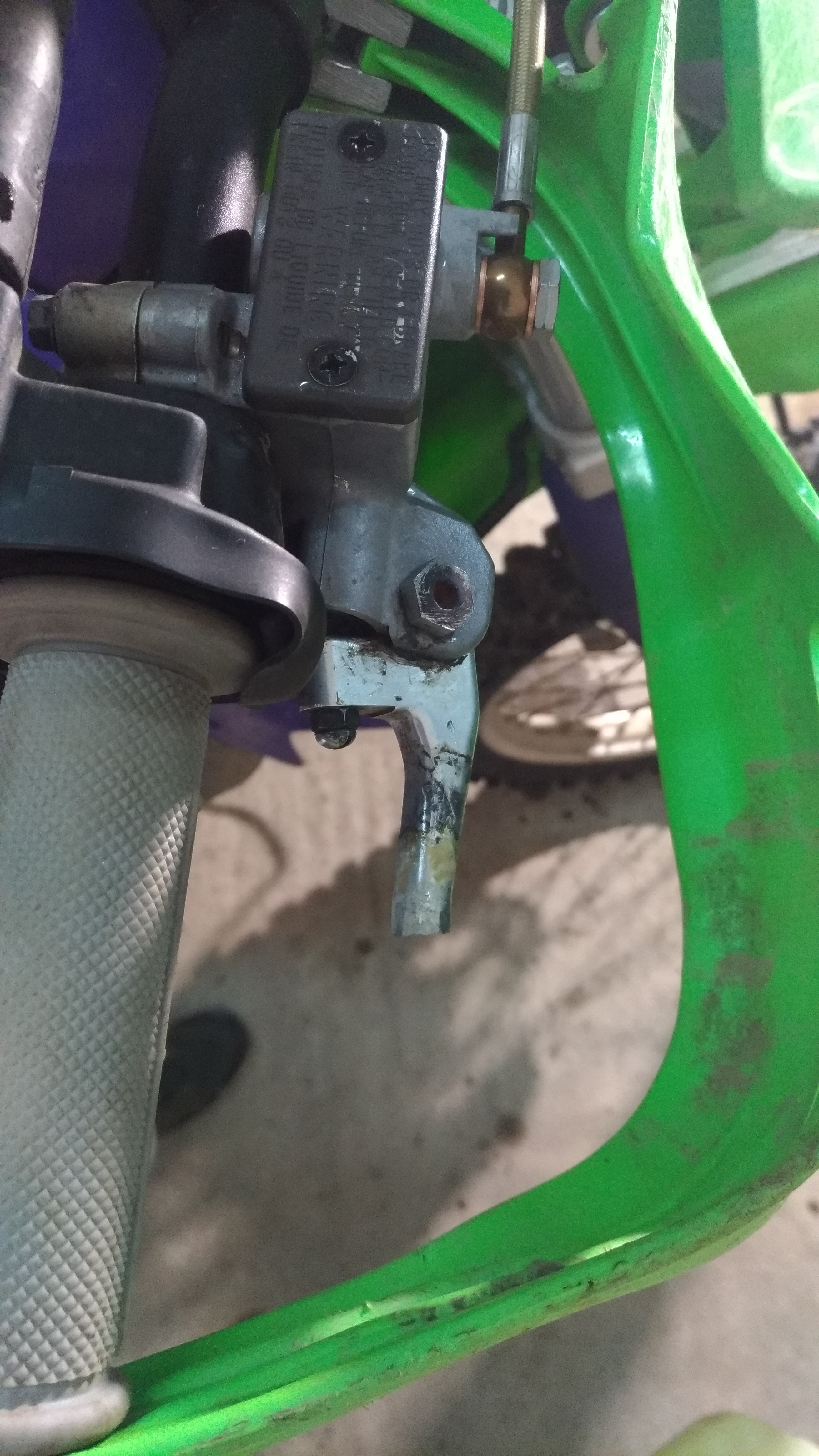

Here's what's left of the lever. Also I'd love to replace the clutch one while I'm at it.

That's crazy!
Look to see if the KDX lever part number is the same as a KX lever. If so, then shop for the KX lever, as some lever companies might not list it as fitting a KDX. The part number is in a 12345-6789 format.
- Posts: 3553
Re: Classic front brake issue?
That would certainly mimic a spongy brake, as the pressure got higher the lever was likely flexing inside the copper sleeve and making it feel soft.
As for levers, the OEM ones are available (at least here in the states) for relatively cheap. Any KDX 95-07, KLX300 same years, KX125/250/500 93-96. Aftermarket ones are available but most are the normal length. ASV makes some nice stubby ones, but they aren't cheap.

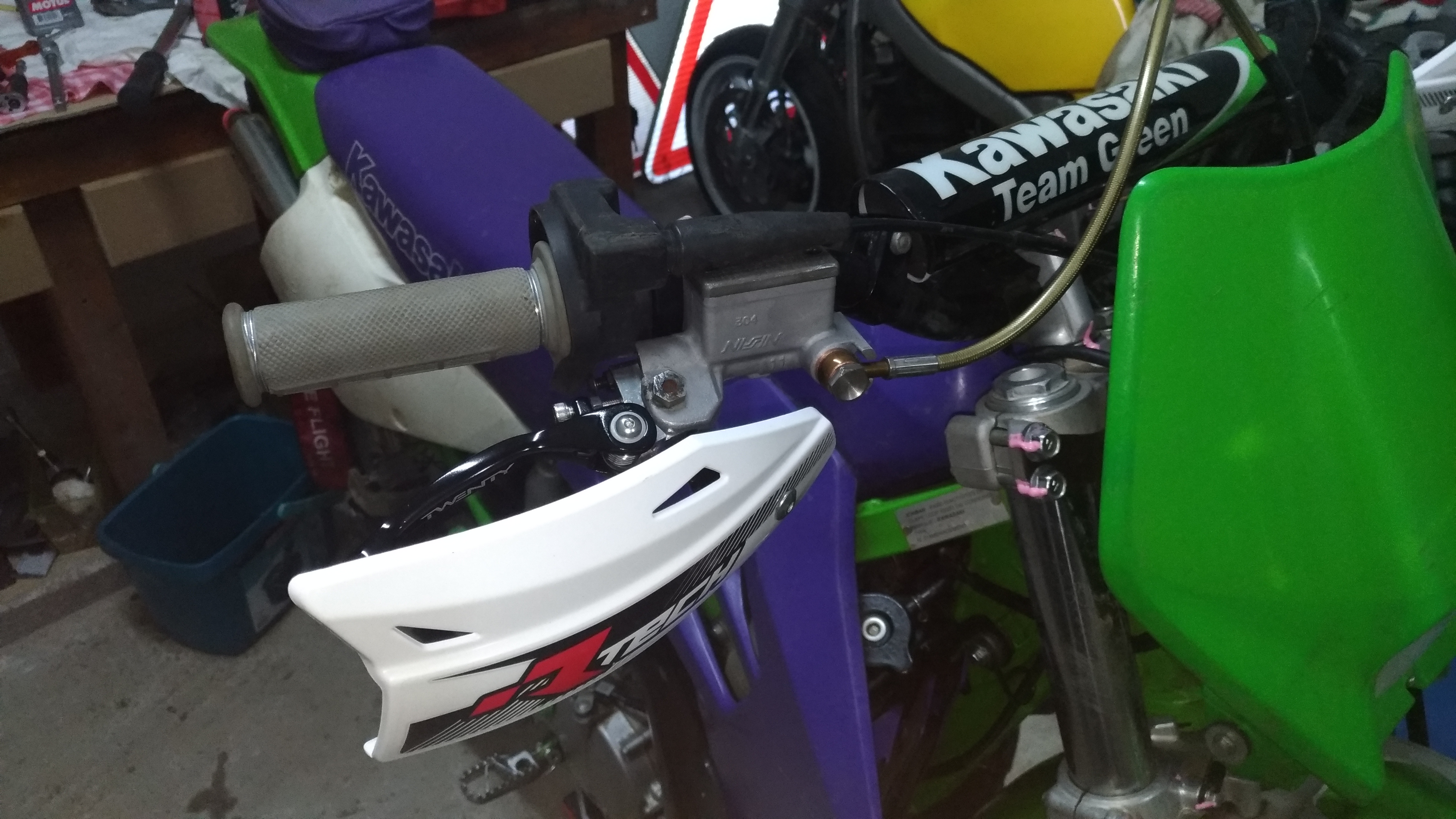

I think it's finally over!
Took some quiet time tonight to bleed it, and set the lever action.Lever is nice and firm. I had to get rid of my barkbusters,the lever was touching them and I didn't want to cut it so I put some flag-style handguards instead. Last detail would be to add handlebar plugs.
Thanks to everybody for the help, the issue was right in front of my face the whole time..
Tomorrow I've got a ride planned we'll see how much it improved the bike.

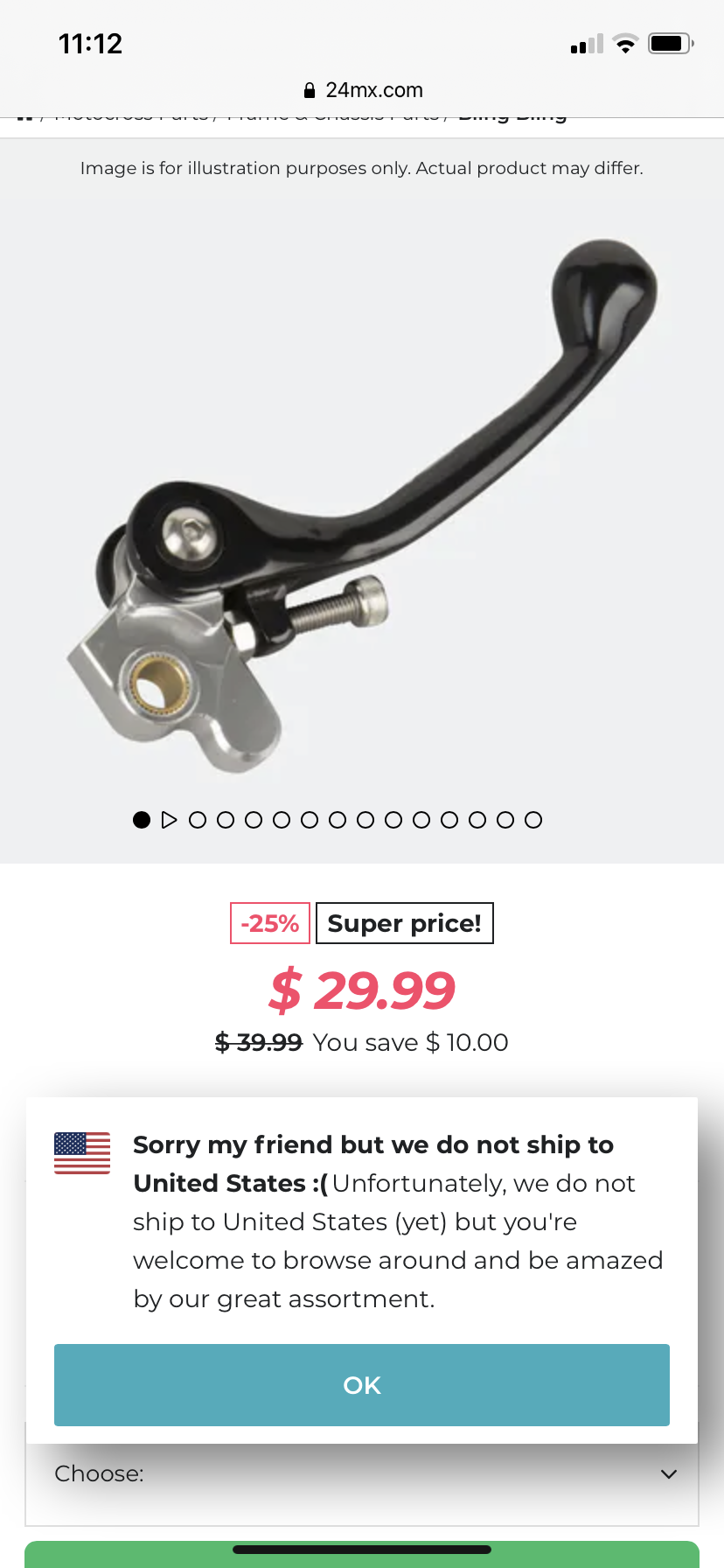

When I broke mine, I replaced w the $12 OEM style from Outlaw racing and it has worked fine. But I do like the one you picked much better so will put that on my list for next time.
So glad this is finally done. That must feel a huge relief.

Re: [SOLVED] Classic front brake issue?
Darn, Guess not. Oh well, maybe next trip to Toulouse!
