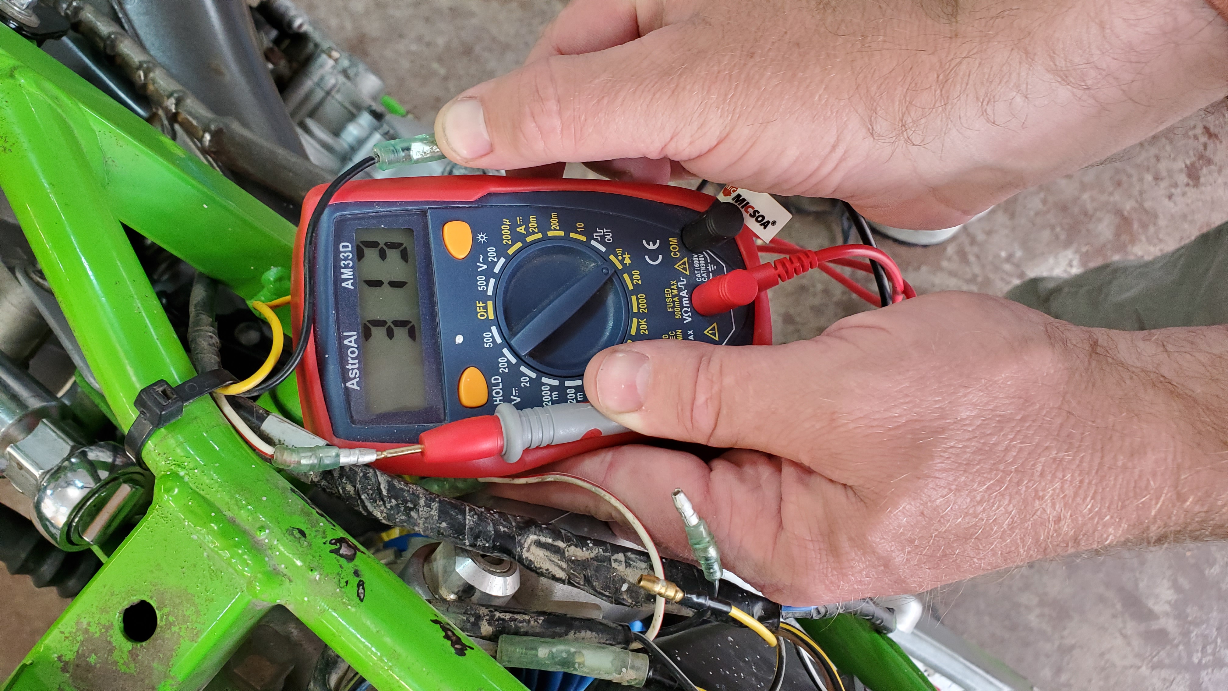

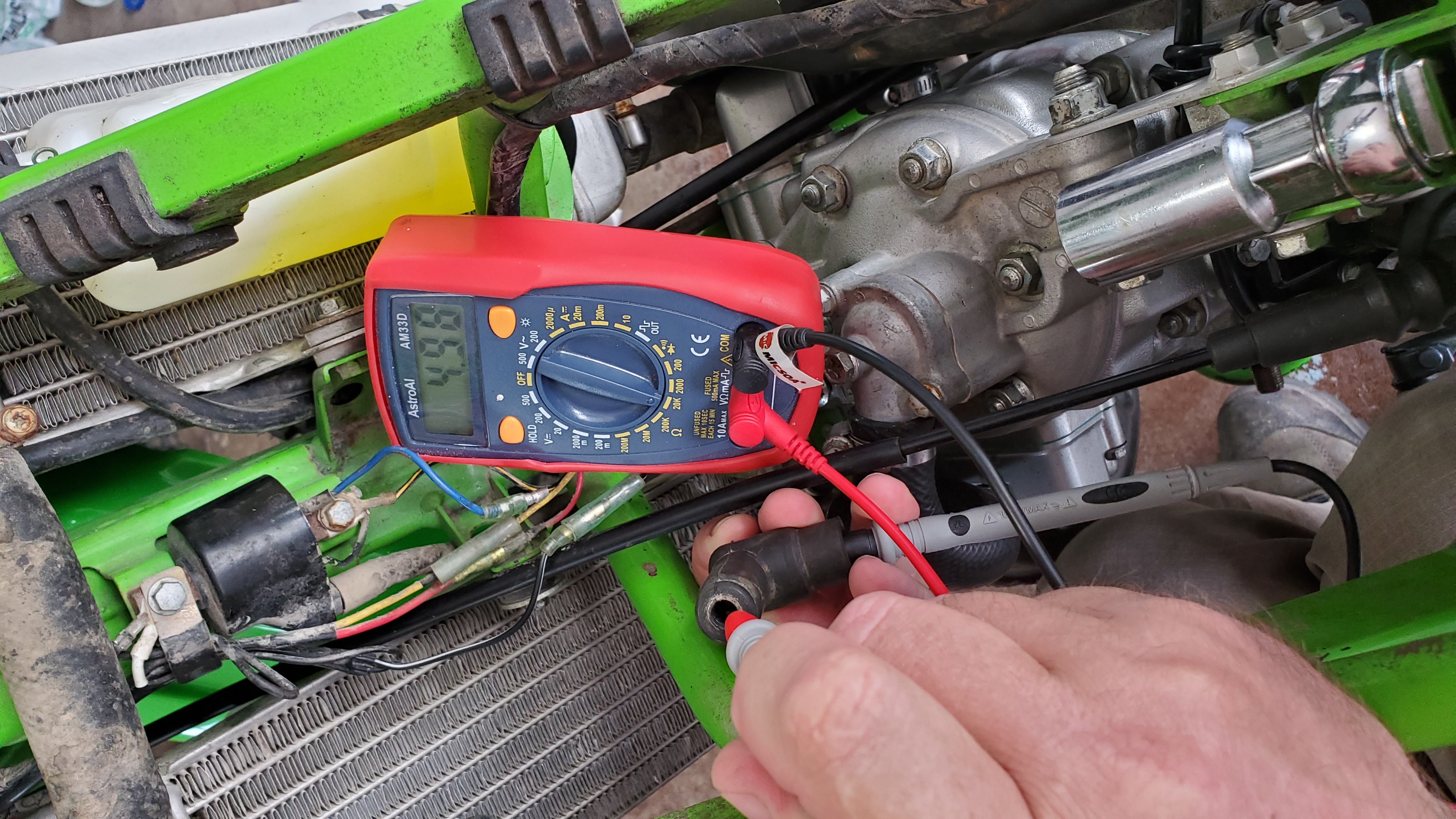

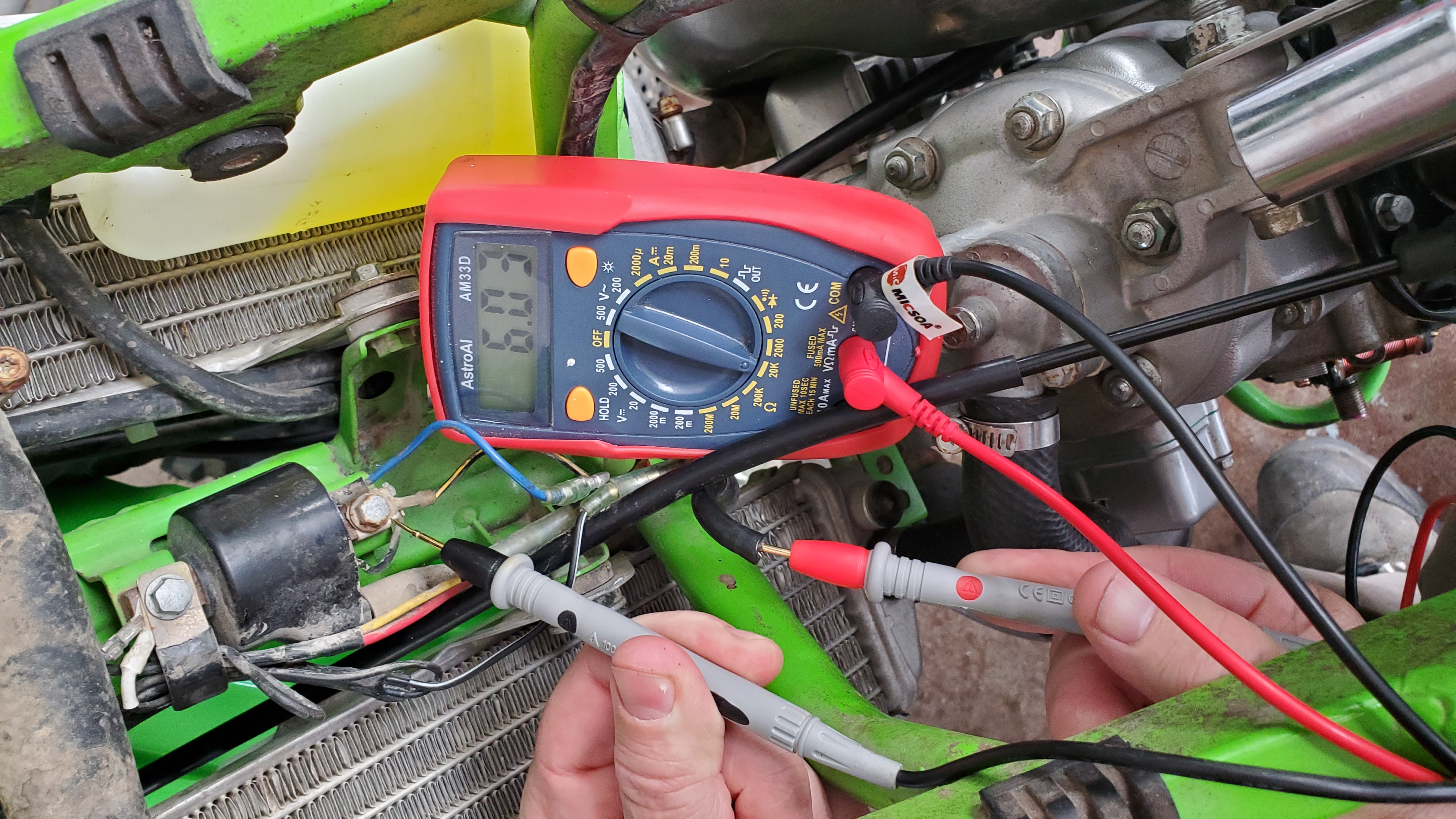

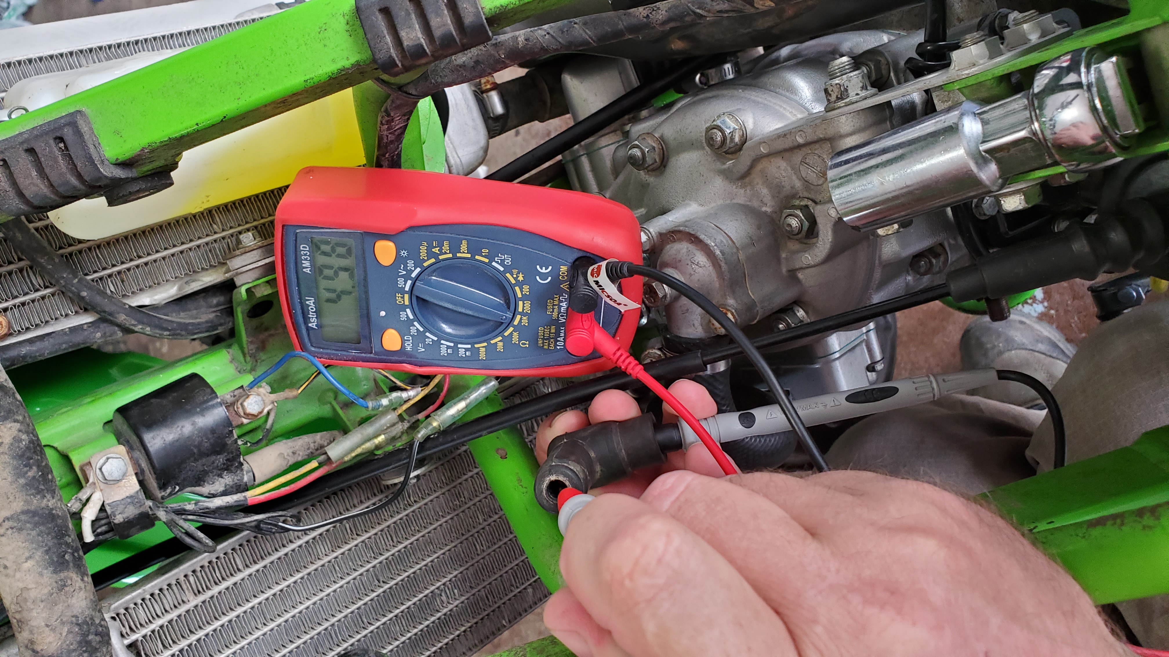

Here are my readings. Hopefully you can see what the meter is set on as well.
