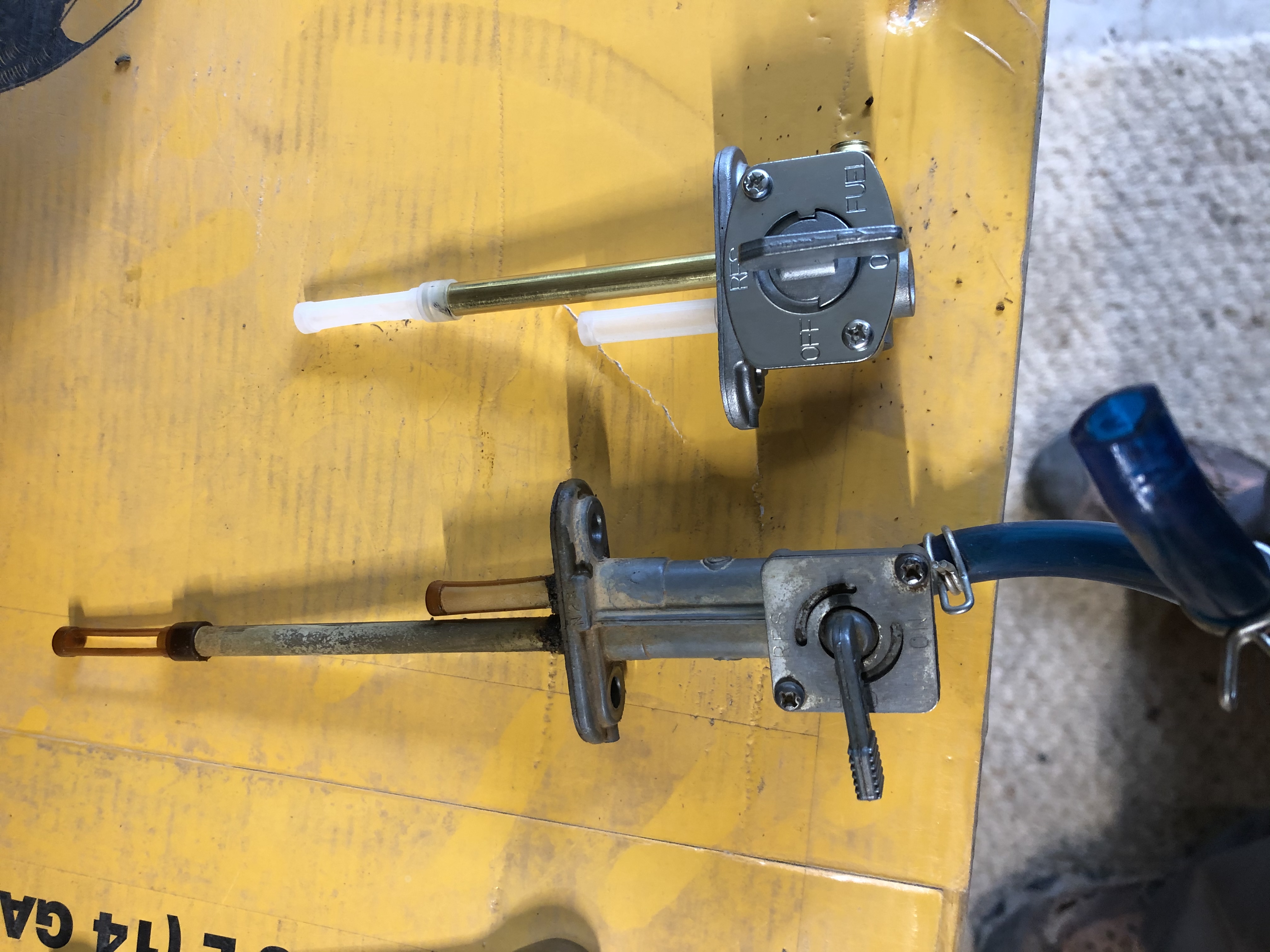

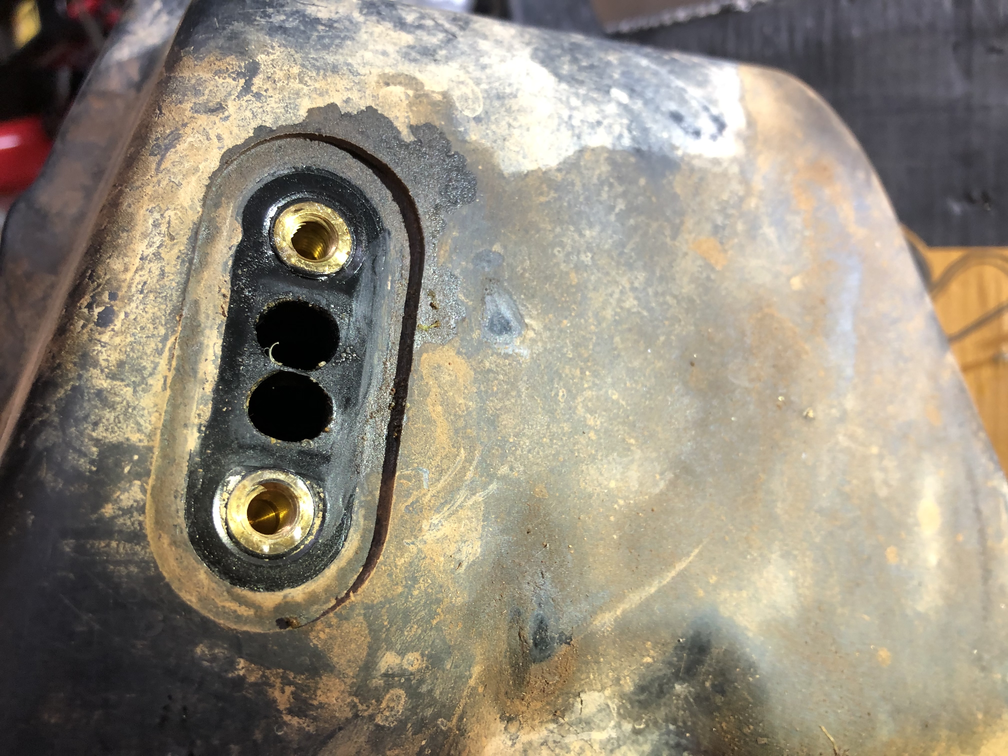

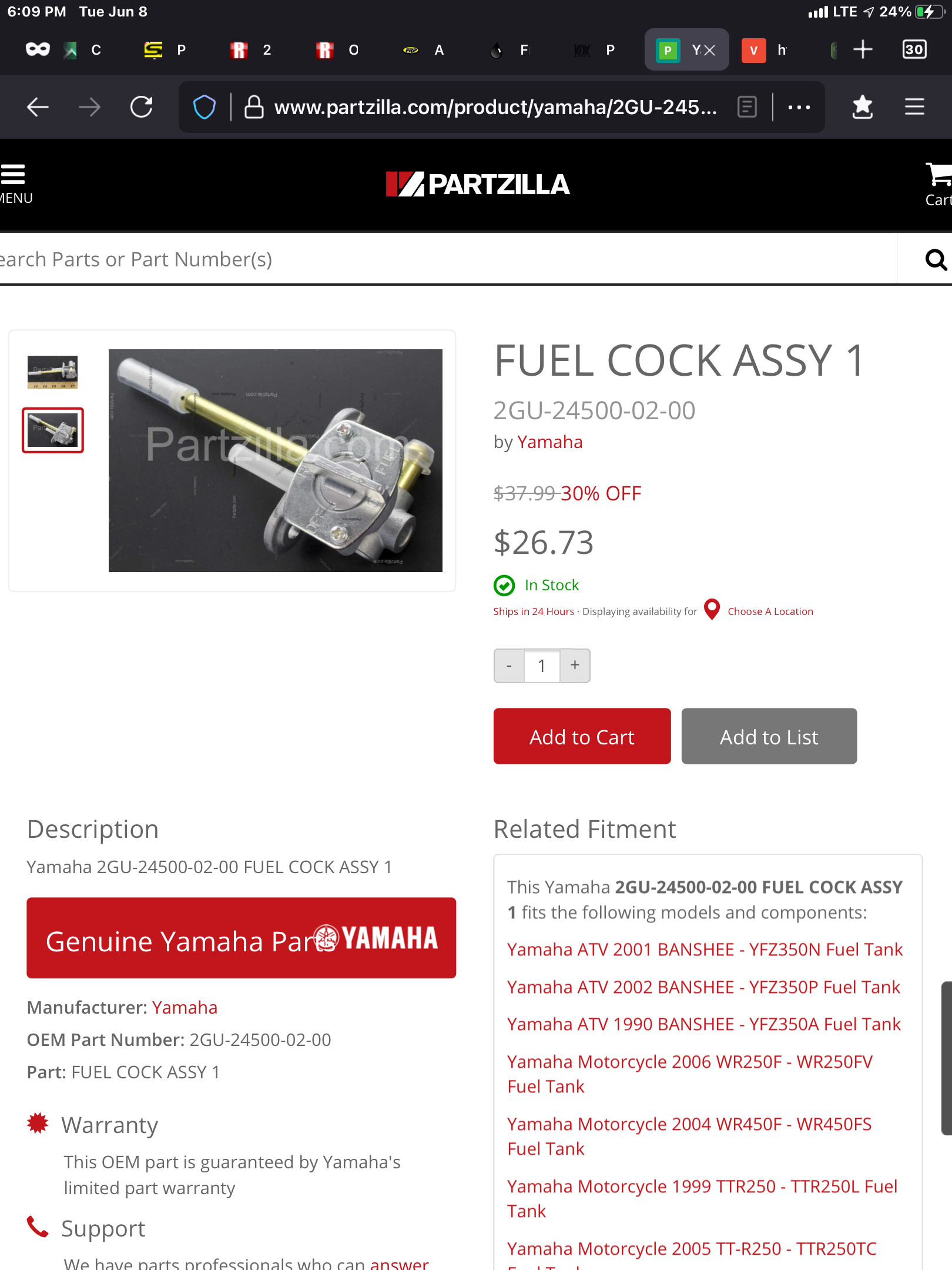

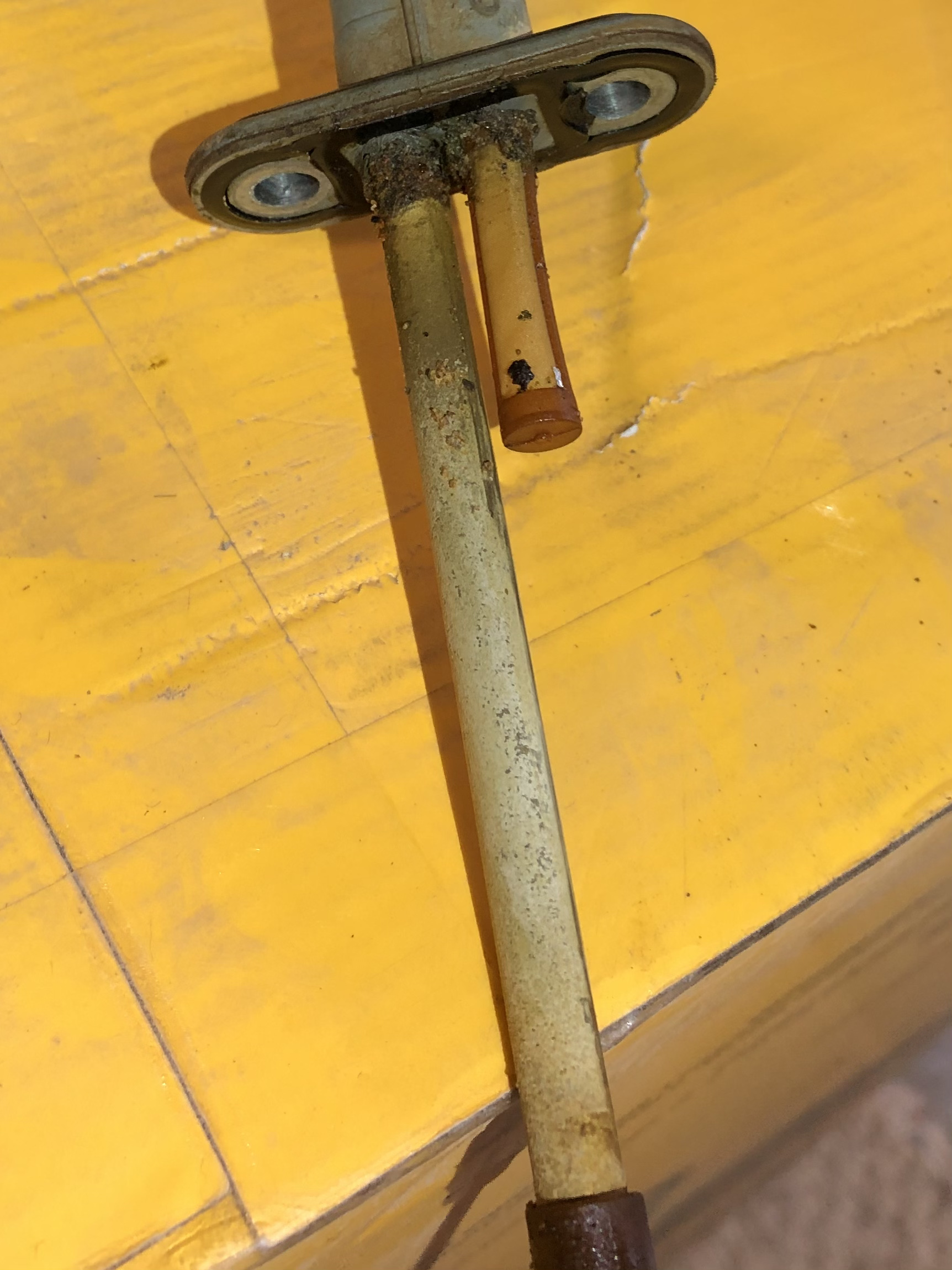

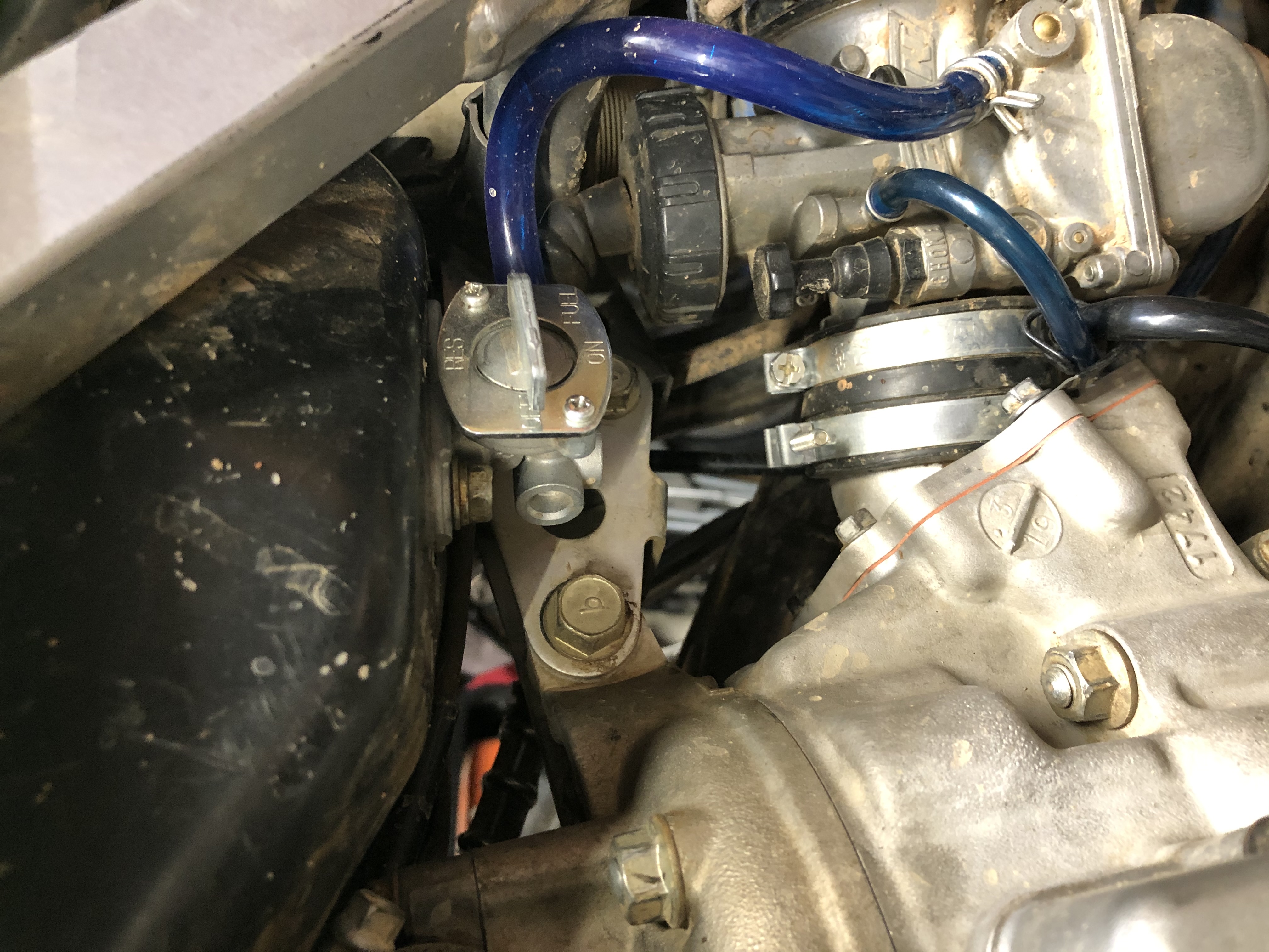

Update - replaced the original fuel cock...
After the latest round of upgrades I felt motivated to finally do the ‘Yamaha petcock swap’. The original had to be long in the tooth and seemed rather exposed considering the affinity I have for dropping my bike in the woods. I’d also noticed dust sticking to the area at the base of the tank and also around the lever. Those gaskets were probably circa 2003. Putting a shorter one in there with fresh gaskets seemed like the right call. It’s actually cheaper than buying just the replacement gaskets and as you’ll see a real bang-for-your-buck upgrade.
Found the correct Yamaha part number on here and then by cross-referencing some parts sites I was able to locate it on RMATVMC for $19. So I snagged it along with some other items we needed. Showing her age... Old one out and new one on right for comparison... Bottom of tank in case you are curious... New one in, fit perfectly and operates flawlessly. Took longer to drain the fuel than to install and reassemble.
- Posts: 6055
The only thing I hate about that petcock is the fuel line routing. I'm trying to locate a better fitting alternative.
Just looking at the photos, could you simply mount the Yamaha valve flipped 180*? That would put the little selector lever on the back side but really, how often during a ride do you move it? I don’t know if that is feasible.
- Posts: 6055
Hmm, interesting idea but it would be really tight to the upper engine mount if it fit. Probably be super hard to actually switch it on and off.doakley wrote: 04:35 pm Jun 09 2021 Just looking at the photos, could you simply mount the Yamaha valve flipped 180*? That would put the little selector lever on the back side but really, how often during a ride do you move it? I don’t know if that is feasible.
We're getting ready to do our yearly bike maintenance so I'm going to pull the petcock off my buddy's '18 YZ250X and try it on the KDX tank. It looks the same as the other Yamaha except the fuel line exits straight down.
- Posts: 202
- Location: Orlando, Florida
Or, you could insert a fuel filter with a small 90 degree elbow.
- Posts: 6055
Good idea!
- MoonStomper
- Posts: 600
I actually like the way it’s routed, seems less exposed.

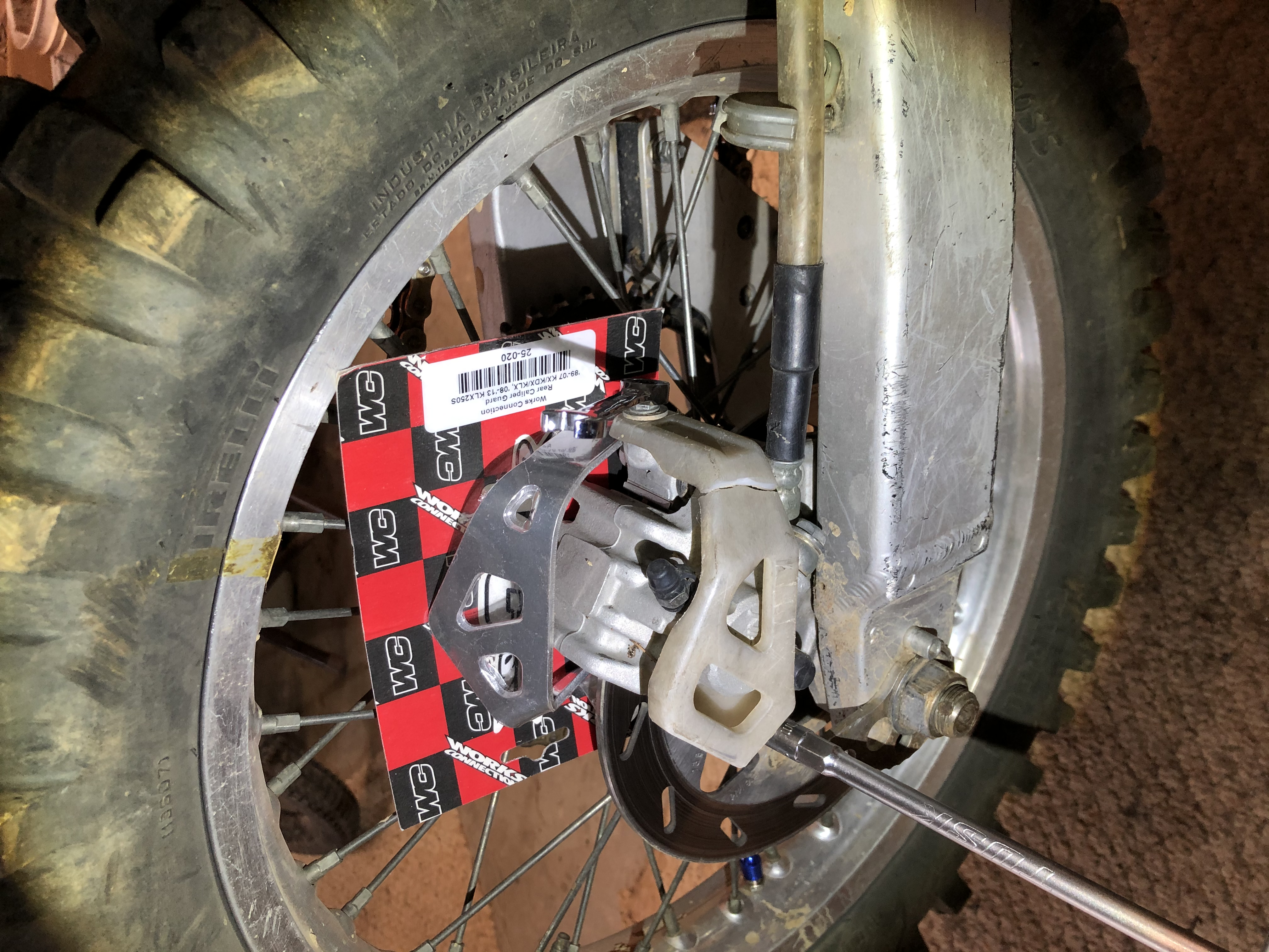

UPDATE - broke the original rear caliper guard...
Couple weeks ago I noticed I’d cracked the plastic caliper guard so I found this Works Connection aluminum replacement at RMATVMC...
Perfect fit and looks like it will do nicely...
Nice! Thanks for the pics. It does look sturdy.
- Posts: 6055
Got the same one. You won't break this one!MoonStomper wrote: 10:57 am Jun 12 2021 UPDATE - broke the original rear caliper guard...
