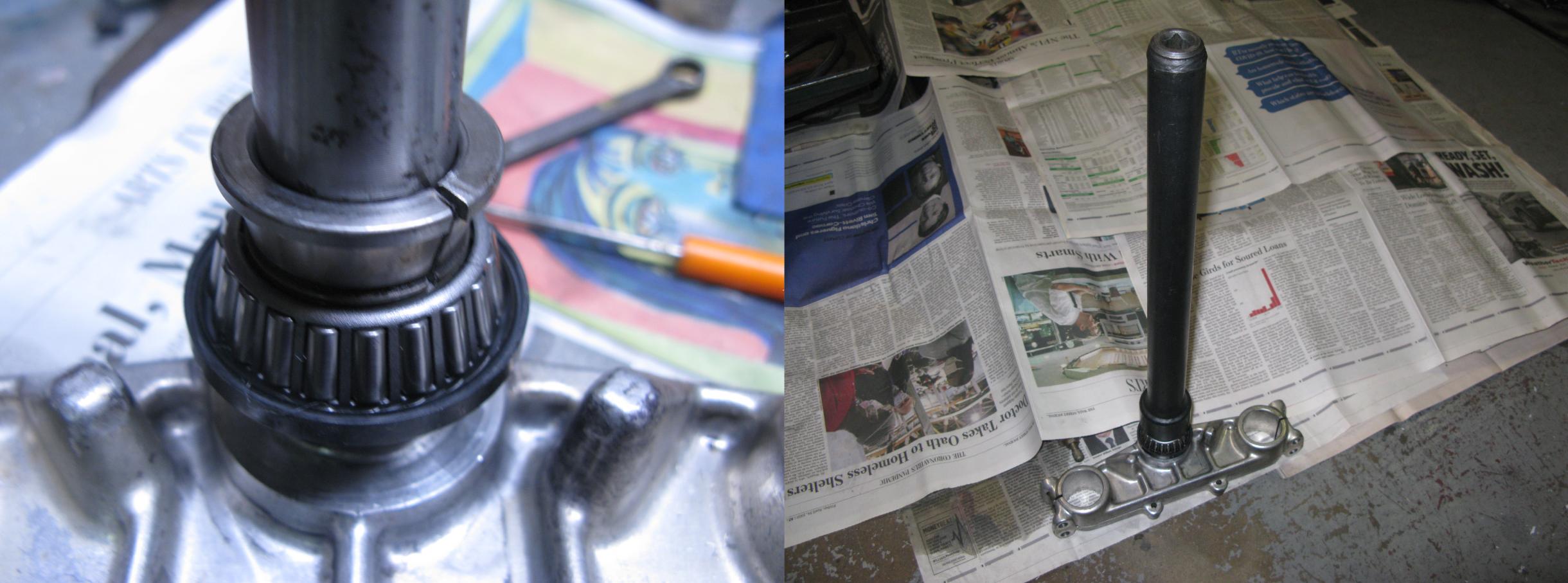

Thanks for the feedback everyone, saving an old runner is especially rewarding and I hope to get a reliable bike by the end :grin:
I have pulled a number of stems apart and this one seem pretty normal. A little rust on the shaft but nothing to worry about. The top bearing slid right off as expected and the lower was a press fit. I worked it a little with a tapered chisel then got the pickle fork started and off popped the bearing.
KDX175 steering stem bearing removal
_click image to zoom_
With the bearing out, I was able to get dimensions and evaluate the various bearing sources. For the KDX175, the same size bearing is used top/bottom and it appears that Koyo supplies it to Kawasaki. It looks like a good bearing with an integrated rubber seal on the exteral facing side. Other sources offer the bearing but they may have separate seals or may not have a seal at all. I ended up ordering Koyos from a bearing supply and expect them to be exact replacements when they get here in a couple of days. Here are the details:
KDX175 Steering Stem Bearing Details

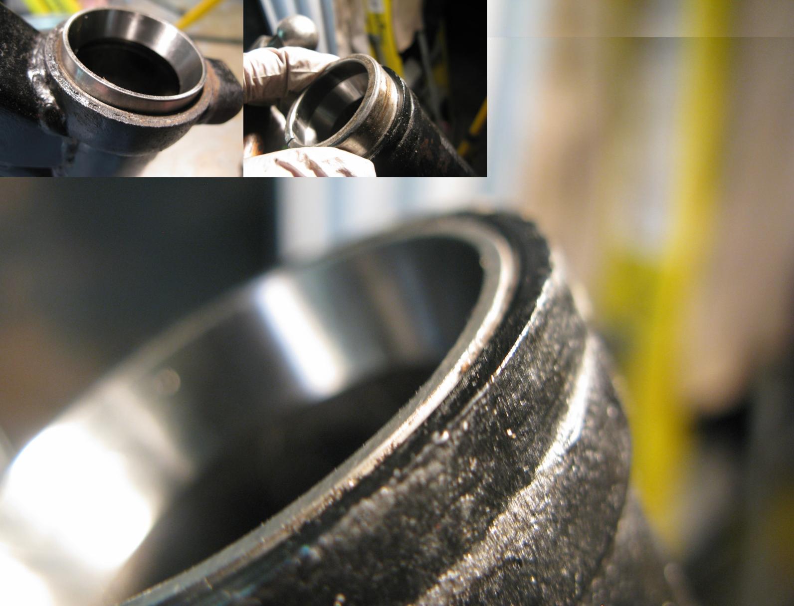

Be sure to get the old bearing races out of the frame and install the new ones. I doubt that is something you were planning at this level of a rebuild, but just throwing it out there since I have seen several people do it.
Posted: 04:09 pm Mar 11 2021
by Goofaroo
It looks like he already has them out.
Nice job on the build and the patience to document it so well. It’s coming along nicely!

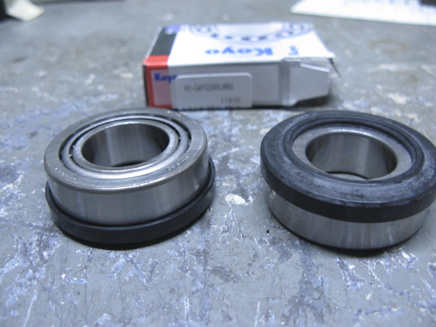

The Koyo bearings came in so I jumped back to the stem in order to finish it up (having too many half-finished sections of a project is a sure way to throw me off stride!). The bearings looked great with the rubber seals nicely attached.
New Koyo bearings

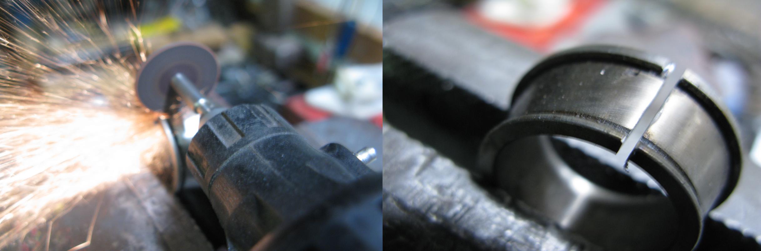

The bearing races got recycled as installation tools for the new bearings by cutting a slot in one old inner race and one old outer race (the KDX175 has the same bearing size for top and bottom). The slotted race can be use to drive the new race and then be removed - the slot makes the removal easier.
Slotting the races
After a little deburring, the slots were ready. The bottom bearing was slid down the stem as far as it would go followed by the slotted race. Then a handy pipe/tube was slid over the stem to drive the new bearing into place. Worked like a charm :-)
Driving the lower stem bearing

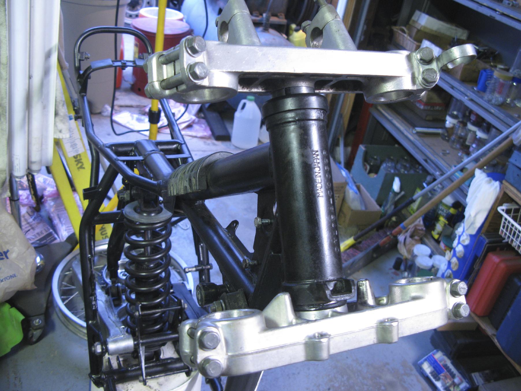

Well, it turns out that on the kdx175, the outer races are flush - no slotted race required. No problem, you can't have too many slotted races in your slotted race box :grin:
I will do final adjustment after the forks are back on.
Stem - greased, installed and ready

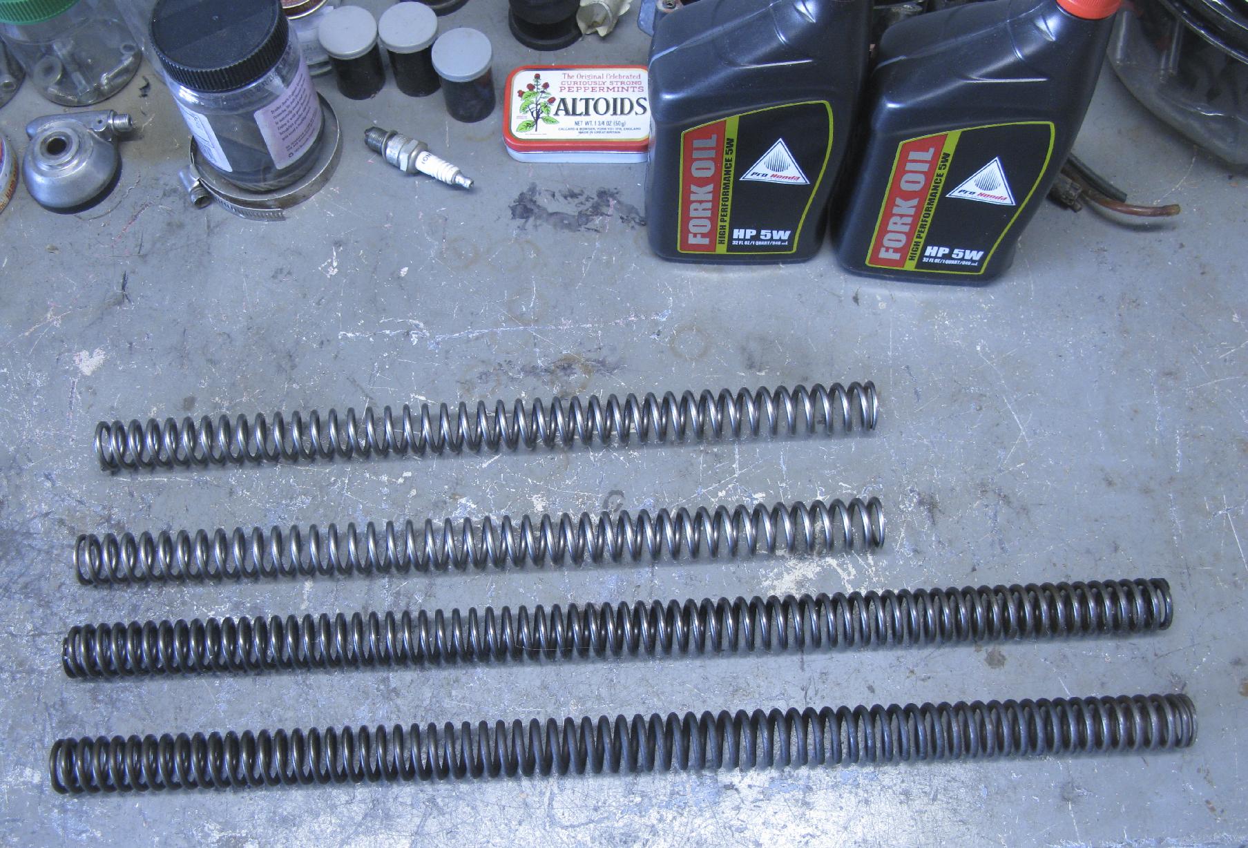

So, I picked up with the forks. "Might as well measure the springs," I thought. Hah - mental note: always measure the springs as soon as you pull them out :whistle: Both springs measured below the specified 592mm minimum. Ok, time to round up some new springs.

Progress on the forks, I left off after discovering springs sagged out of tolerance. Some of the older KDX's are listed as having 30mm dia fork springs so when mine measured a little under 30mm I figured I was set. Still, I wanted to talk to someone to make sure I was on the right path so I called RaceTech and ended up talking to Matt.
I told him that I thought the springs were 30mm even though they measured a little under. Nope, he said, they are 29's which nobody uses. He put me on hold to "dig around" and came up with some 28mm springs with an acceptable rate of 0.40 kg/mm and a length of 490mm. It turns out that they have similar travel as the old springs even though they are shorter - evidentially, newer springs are made from metal with superior properties when compared to springs from 40-years ago. The wire is thinner so you get more travel per unit length. You just have to replace the original preload tube with a longer one,
The springs came in a day and looked fine.
RaceTech FRSP 284340
I also got the fork oil (5wt) and was ready to go but then looked at the new spring preload spacers: a couple of pieces of 3/4" PVC. My immediate task was to figure out what length to cut them to. This led to checking around and sifting through stuff to get a grasp on which way to go. Everyone reports that the KDX front is too soft for anyone over 120lbs. I am 155 but am in the novice category for dirt so I figure to start softish and build up as needed. To this end, I am thinking using the 0.4 springs with light preload (4mm) and 5wt fork oil. When I get to the point of checking fork sag, hopefully, I can adjust the preload to get it close. And, if damping is to little, I can always move up to a heavier fork oil.
I will do a write up on all of the details of the springs and setting the preload.
The forks - they are half way assembled, hoping to have the front end back together in a day or two.

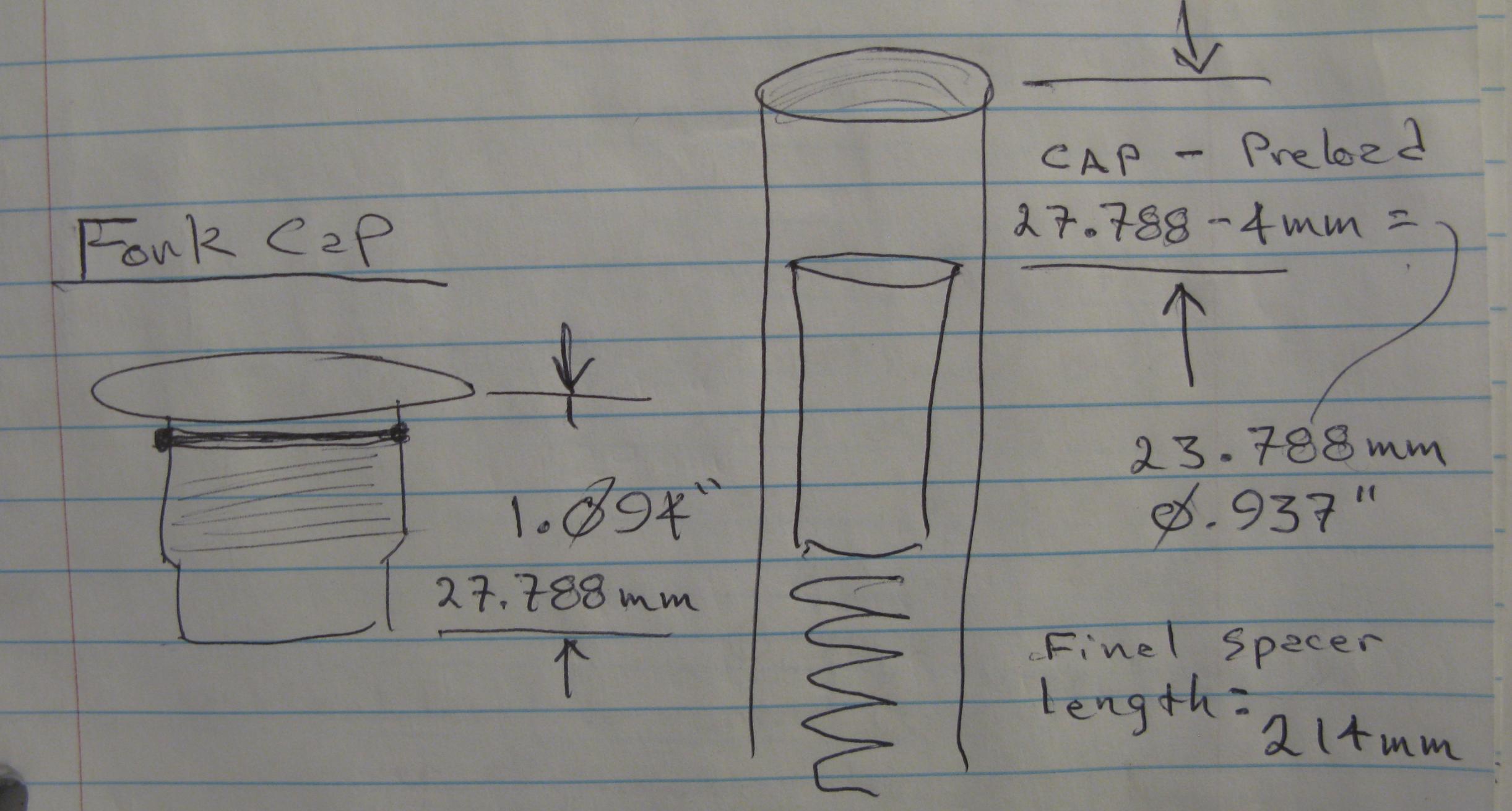

For the spring preload, I settled on starting with 4mm and then moving up later if/when needed. The fork cap protruded into the fork tube a little over 27mm so the top of the spacer needed to be 4mm higher.
Preload calculations
The steps were to insert the spring, washer and the overly-long PVC. Then, mark the PVC at the top of the fork tube. Remove the PVC and measure down from the mark by the calculated amount (23.8mm in my case) plus the thickness of the top washer and make a second mark. This is where to cut. I forgot to add in the thickness of the top washer but it still came in close enough and it is easy to add additional washers for fine tuning.

While reading about the springs, my burst out loud comment was, "Please tell me you bought them!" :-)
Good going.
A couple of considerations, I would suggest 7.5 weight (mix of 10 and 5).
Also, the original oil quantity is based on those springs and a different spacer. You have less spring metal taking up space, but more spacer volume, so it may be OK with the stock oil quantity. You might have to play around with that.
You are going to be world's better than what was stock. A source for KDX175 new fork springs, AWESOME!
Some of the KDX's had stiffer springs than other models and years. A 1995+ is 0.35 Kg / mm rate, but 1989 - 1992 is just 0.30 Kg / mm. Ridiculous!
Are you 155 in full gear or is that 155 plus the weight of gear, water backpack, tools, spare partss, etc. ?
As always, thank you very much for posting all this. It could help people for years to come.
