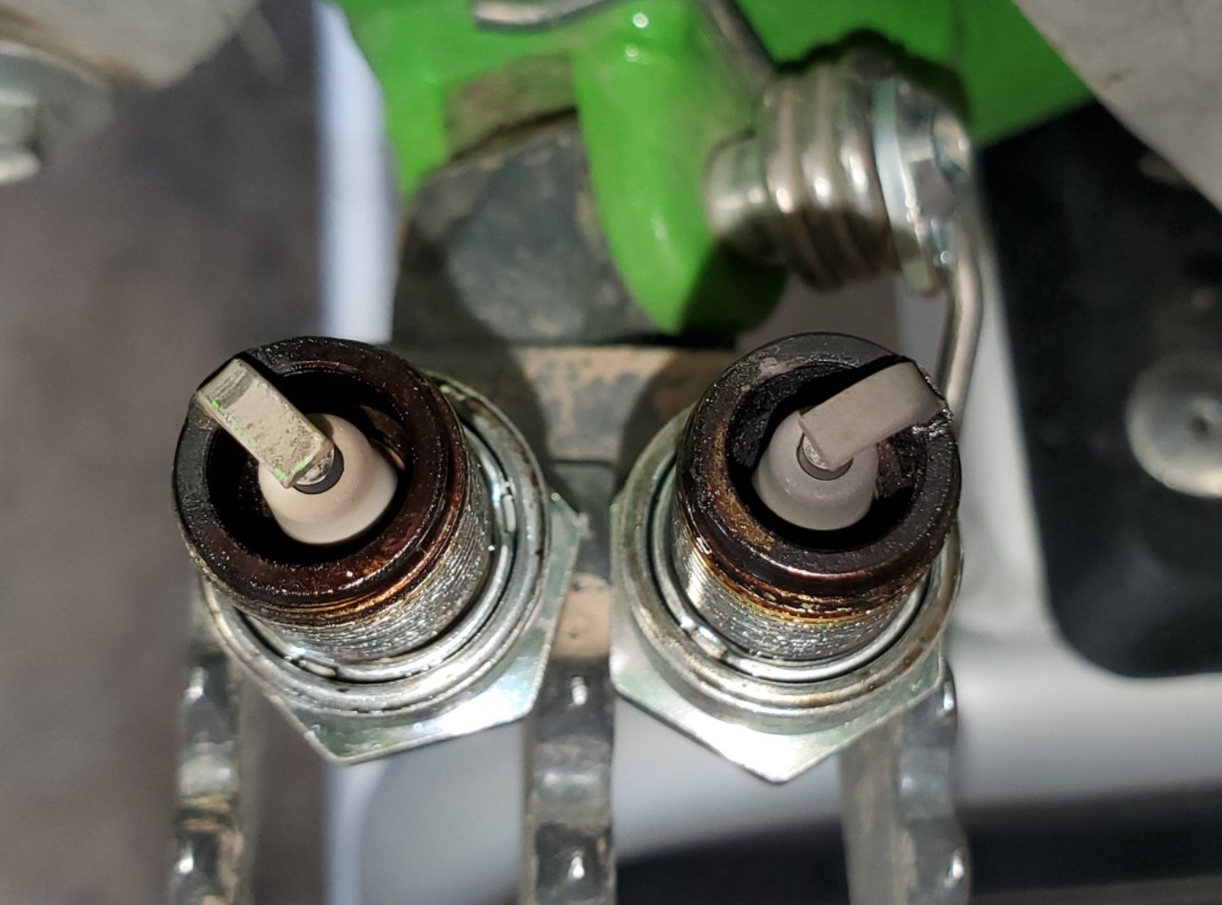

Ride went well - 50 mi of mixed rocky mtn singletrack, probably 20 of it was bar banging tree riding! During 2 of the uphill sections I did manage to boil the coolant pretty good, lost nearly all the overflow capacity on one and had to give it a drink from my camelback! Not sure whats going on there as I straightened the radiators, the fins and flushed them then put new coolant lines on and flushed the bike with distilled water before finally filling it with engine ice which I've been loyal to here in Colorado's thin air...
The bike ran what I felt was rich up in the 11k and up elevation. It ran pretty good around 9k to 10k though. I'm thinking a different needle which can let me fine tune will be better - more research to be done there, currently running a DEK on middle clip.
First day plug on left, this ride's plug on right.

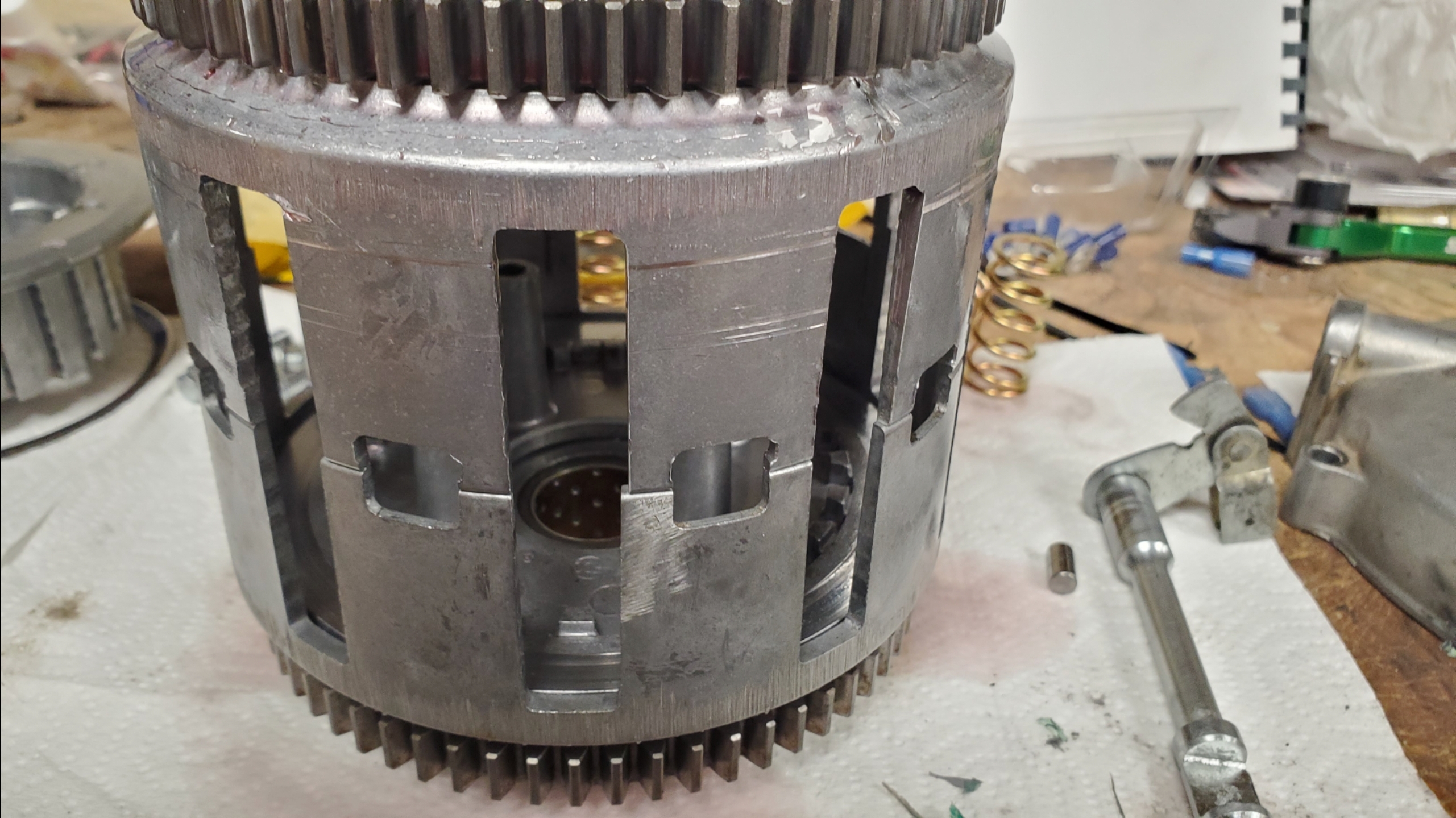

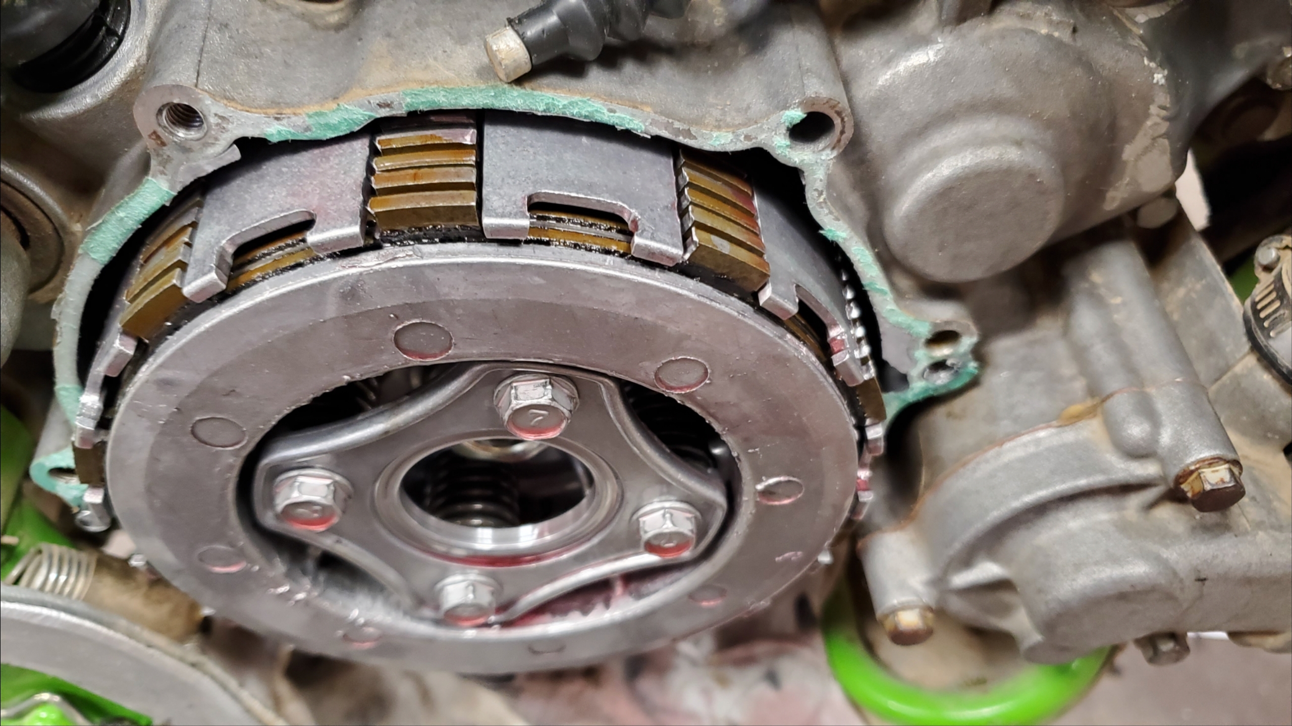

New basket arrived today. The new pro-x plates fit very precisely in this new lightly used basket. It has marks of plate use but no real grooves - just going to use it as is. Another interesting observation is that the last plate staggered groove width is just under 14mm (13.95 to 13.98mm) whereas the main slots are just over 14mm (around 14.08 to 14.12). So i think that may have something to do with why the last plate is suggested to go there.
And finally - my filed basket held up decently for the ride! But I do notice very obvious light damage - its already nearly as bad as my new / lightly used replacement! It was noisy too - you could hear the plates being racked back and forth as the bike transitioned from drag to power output.

I think that left plug looks a little too white for my taste.

Got the new (lightly used) basket and pro-x clutch kit in yestarday. Went together as expected and the pull is a little stiffer now. I may look into getting a kx125 clutch arm like I've seen on here with the longer arm length. But it was pretty manageable tonight!
I also ordered a CEK needle. The DEK I have is nice but I like everything I've read about the CEK being more responsive and for $10 I figure its a cheap upgrade!
Tonight I got out for a 16 mile ride on some great singletrack (2nd and 3rd gear stuff with occasional 1st gear sections). The new clutch was very noticeable - throttle blips in 1st and 2nd now loft the front wheel - progress! But my favorite part was the continued power delivery in the mid to top end! Slamming trail whoops and just accelerating in general is as expected now.

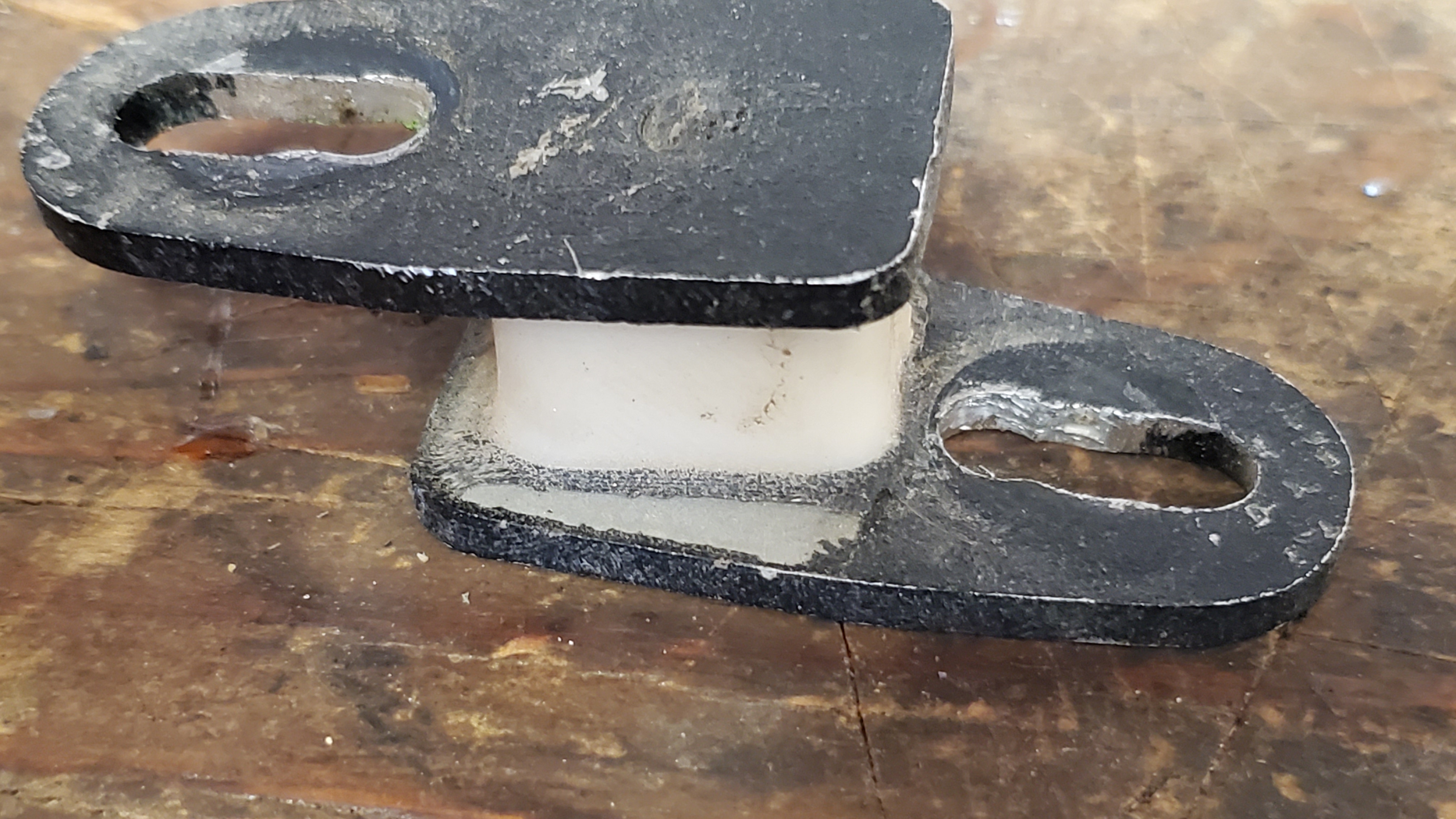

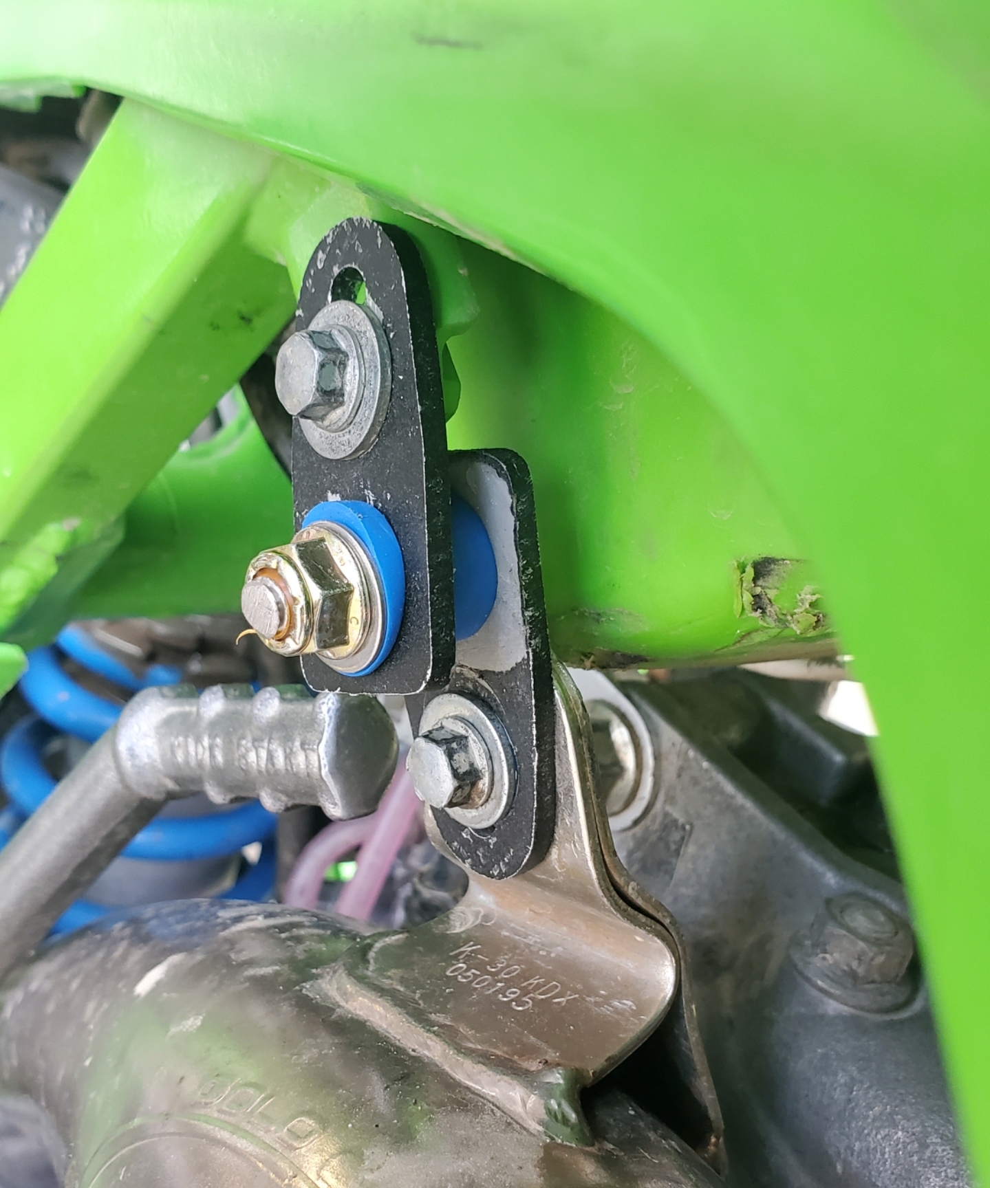

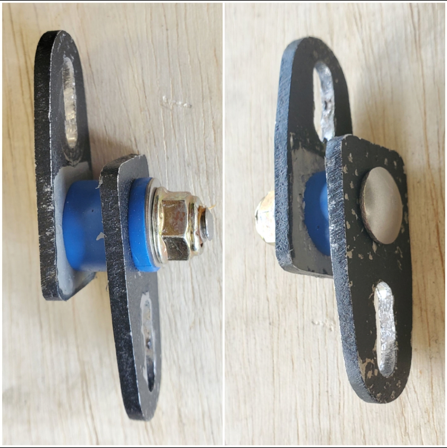

I assume my pipe's upper exhaust hanger is bent way out of the original position. I tried to bend it to be inline with where the stock exhaust hanger mount would fall but no luck. I ran an aftermarket hanger made by ORG engineered products - so it's not some cheap knockoff, they actually are pretty passionate about their products. It failed anyways and I hate not running all pipe mounts if I can help it so I re-made their mount with some elastomer dampers I had from an old project (on McMaster Here)... results below:
Failure Mode: Sheer on exhaust side - possibly from heat and being at a constant bend angle.
Replacement:
On the bike:
Held up fine for last nights ride. I'm at the point in this bike build where I don't feel like continually dropping $20 here and there on replacement parts unless they actually provide an 'upgrade' so this is part of my DIY adventures haha.

The pipe hanger is REALLY bent, causing the hanger to fail. Good workaround.
