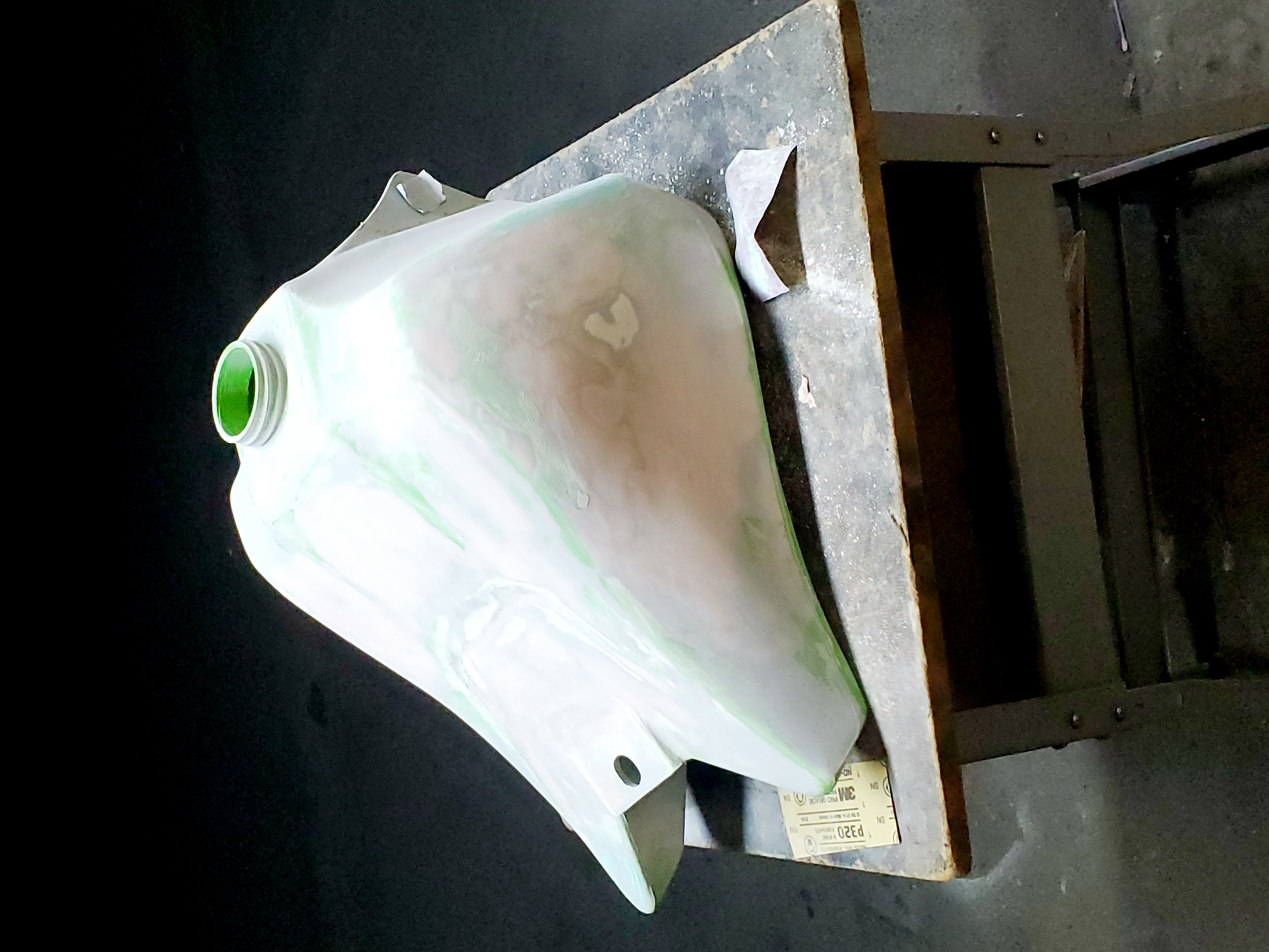

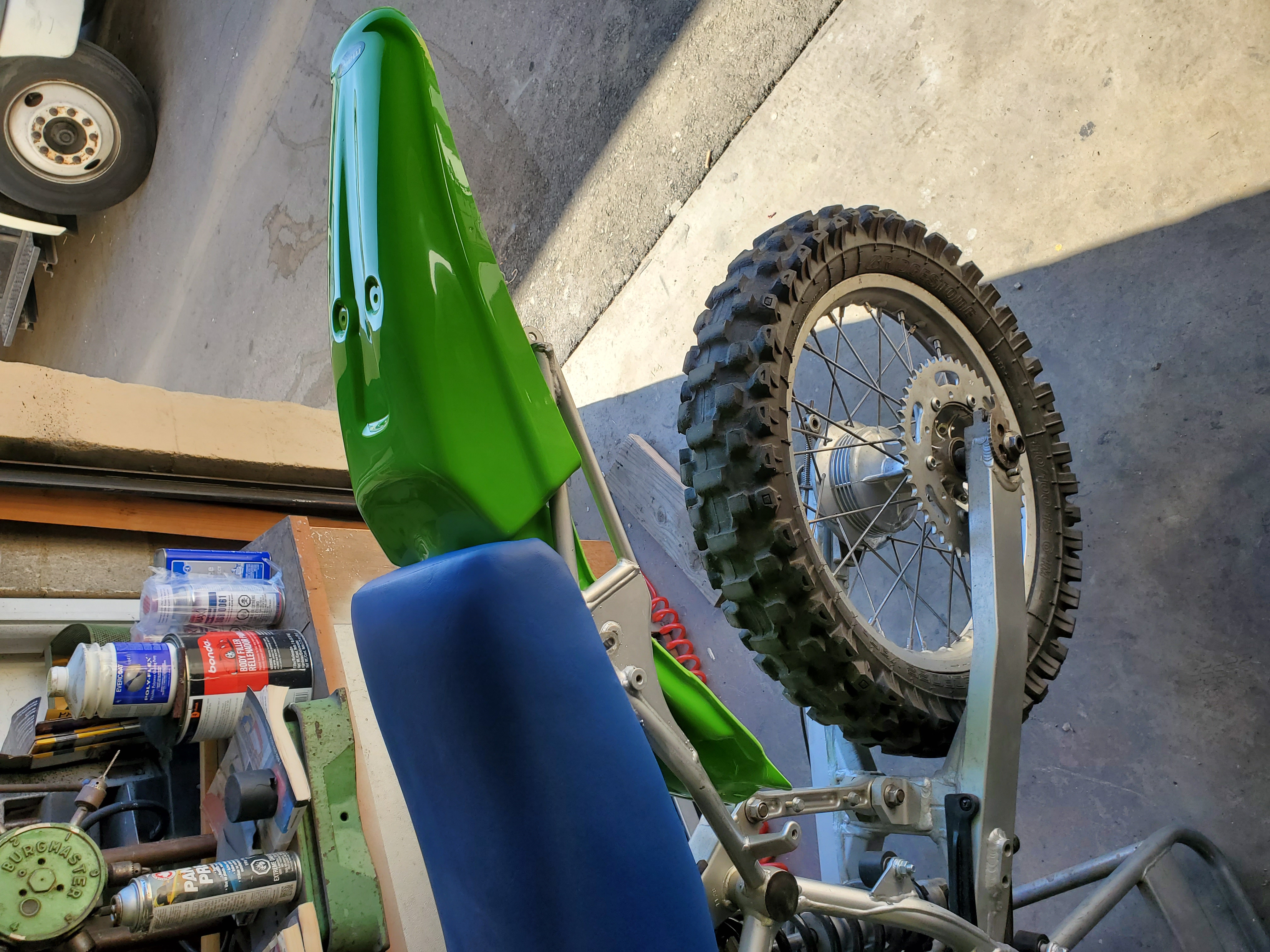

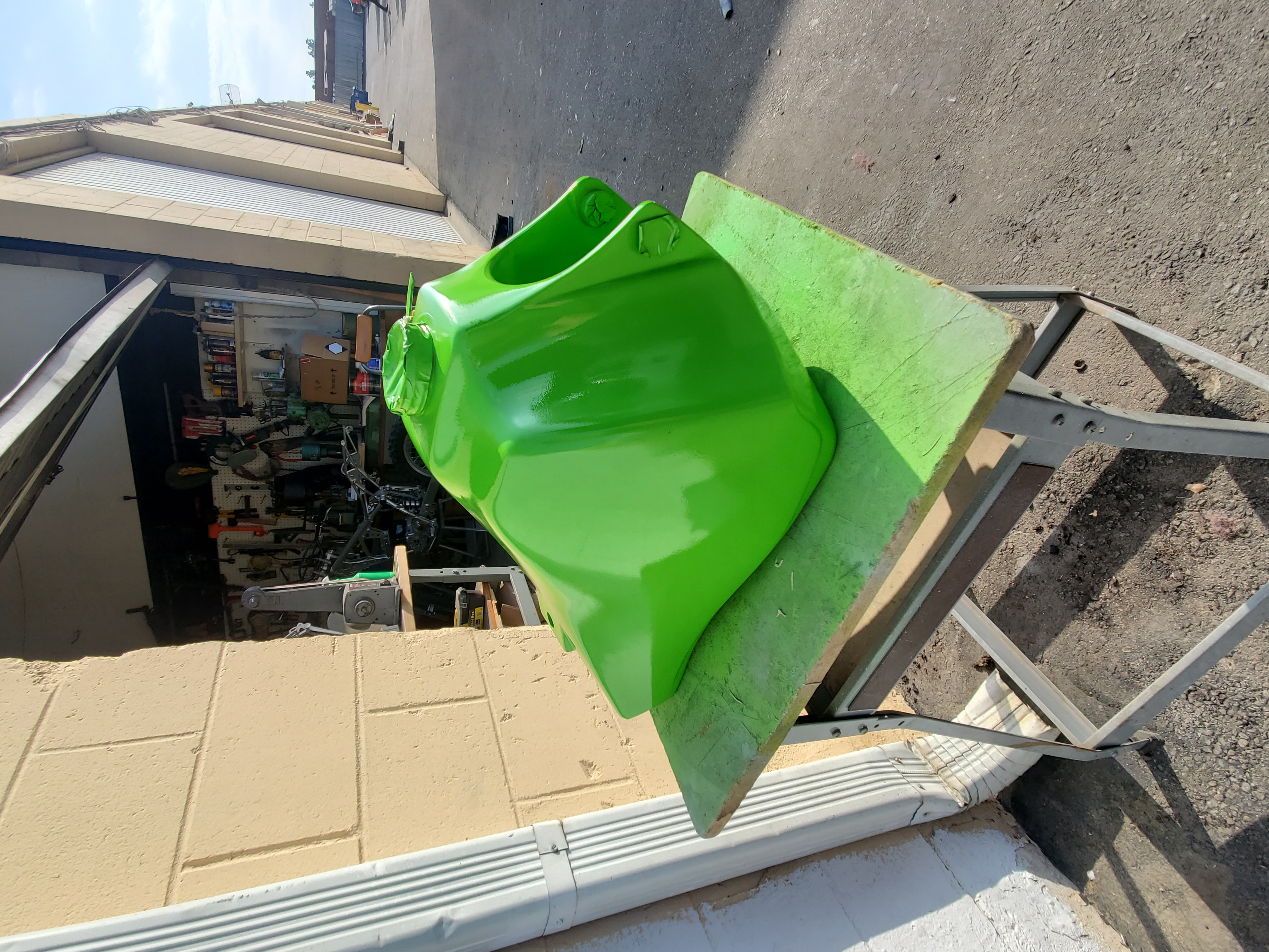

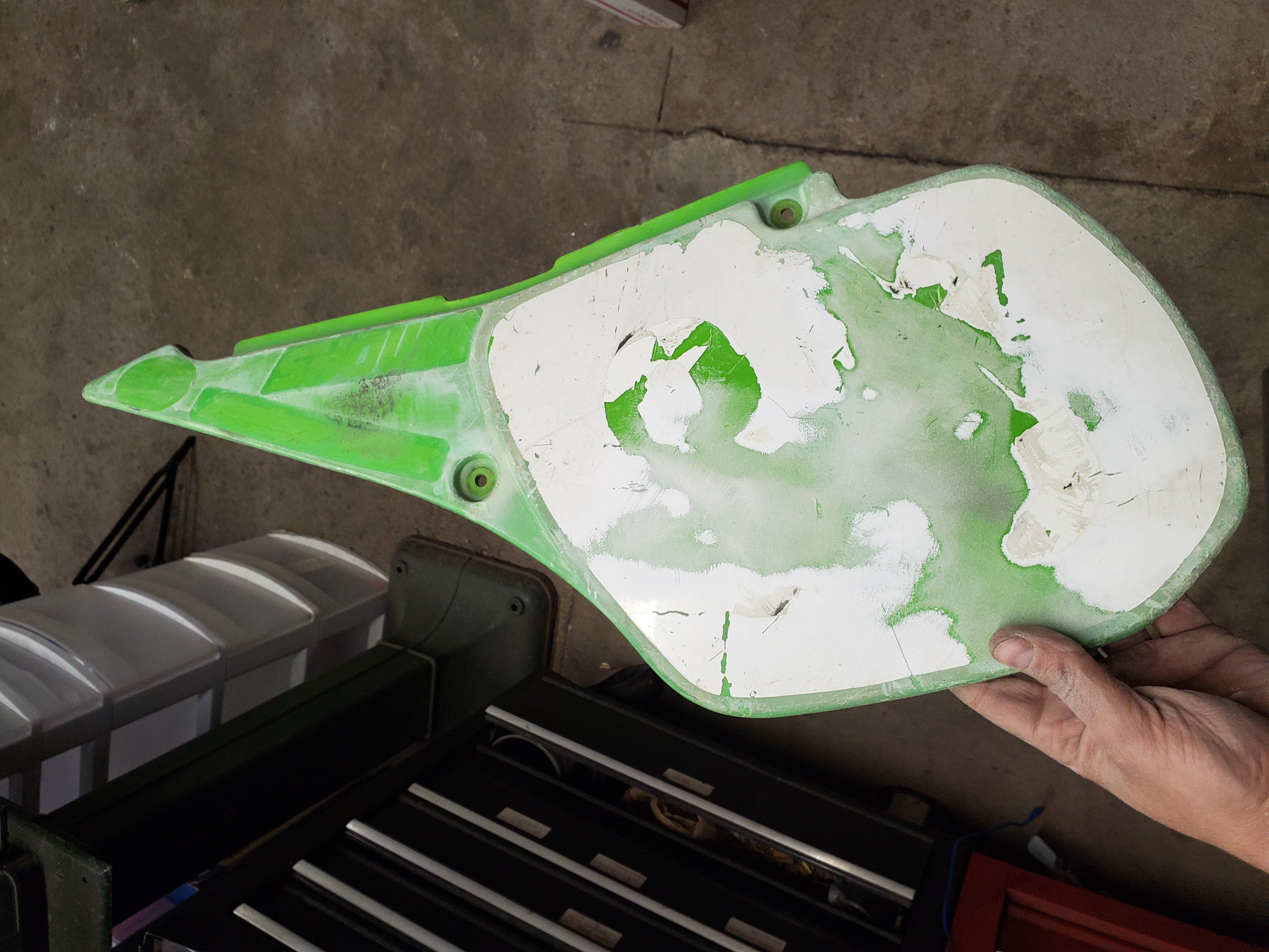

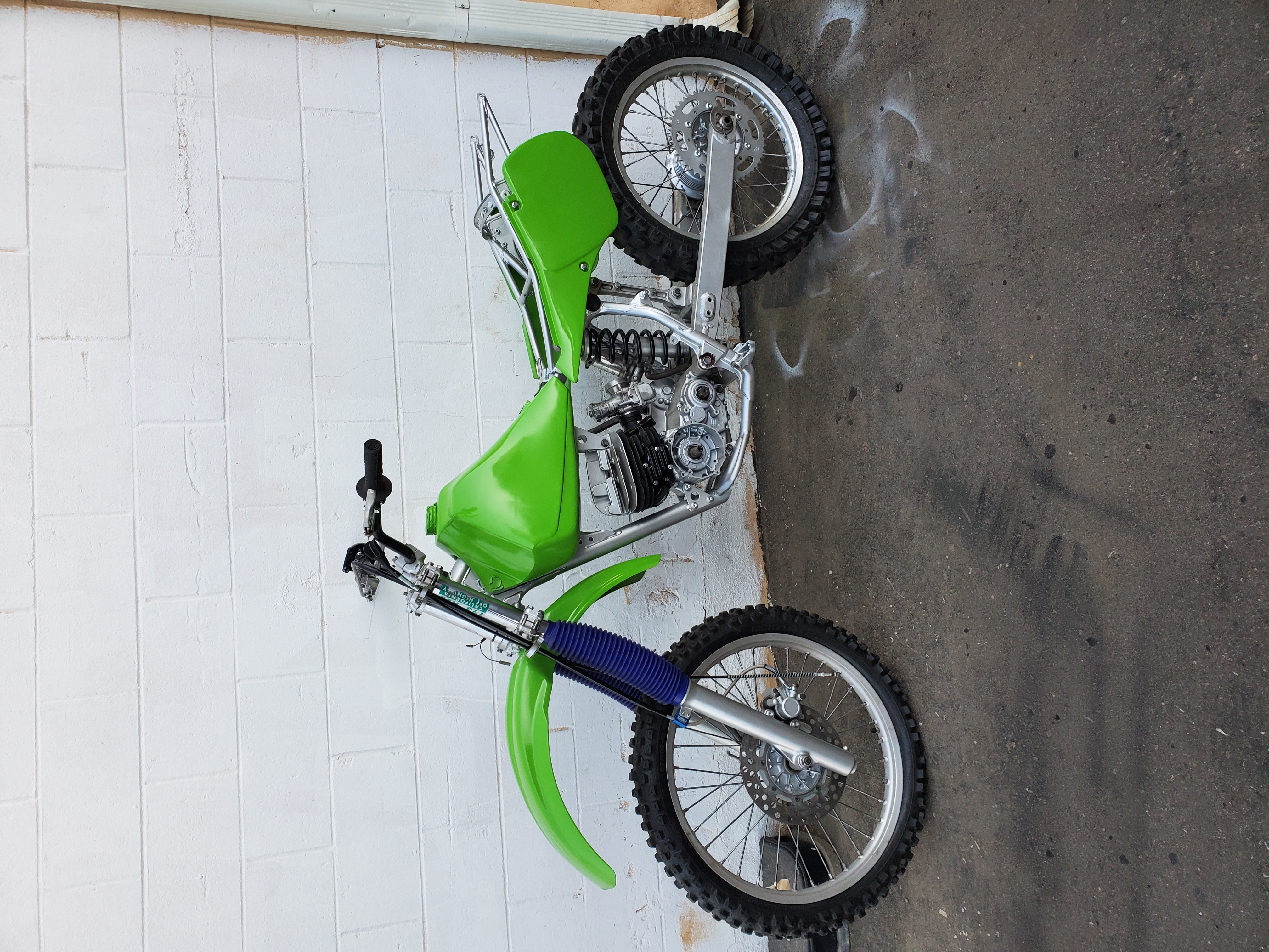

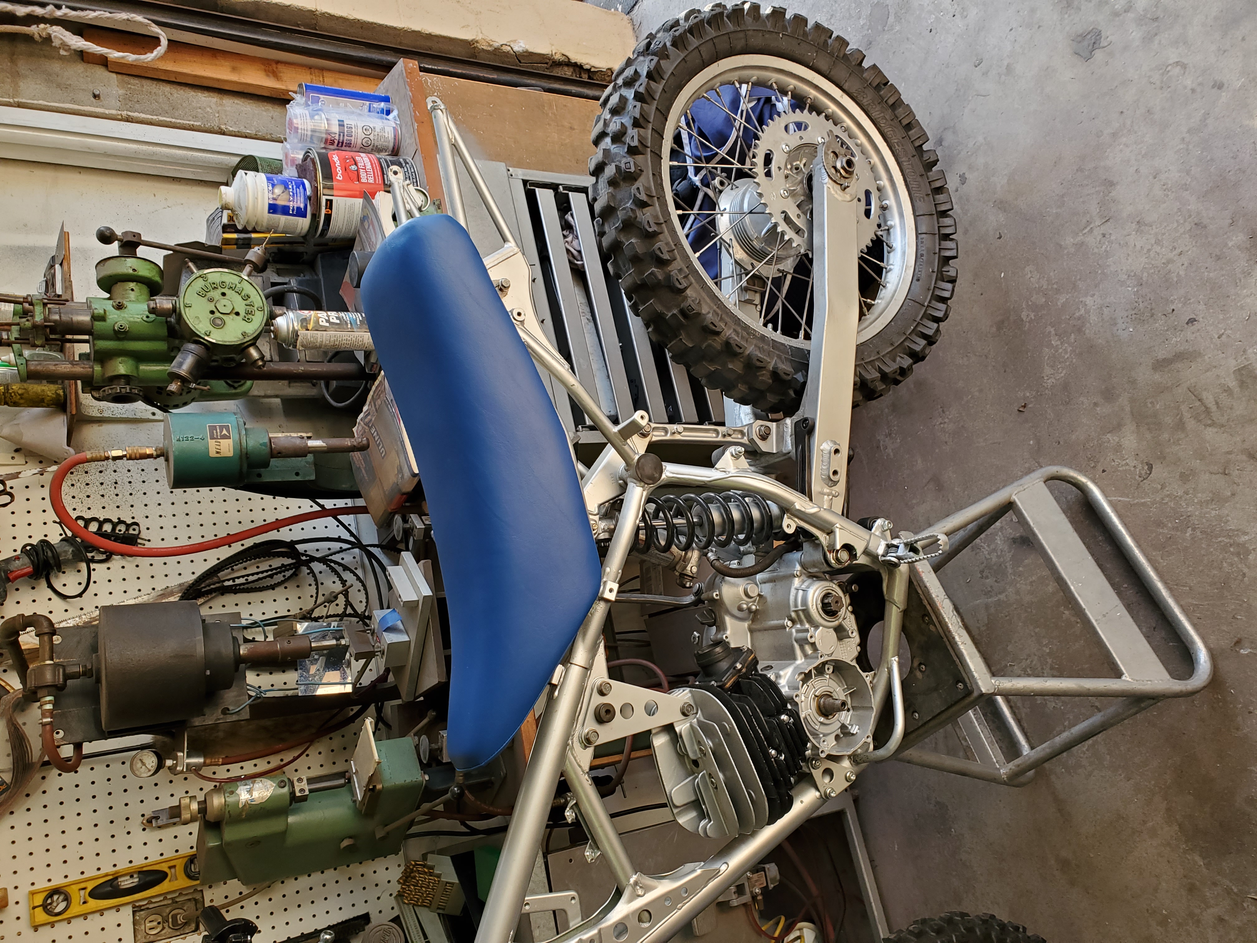

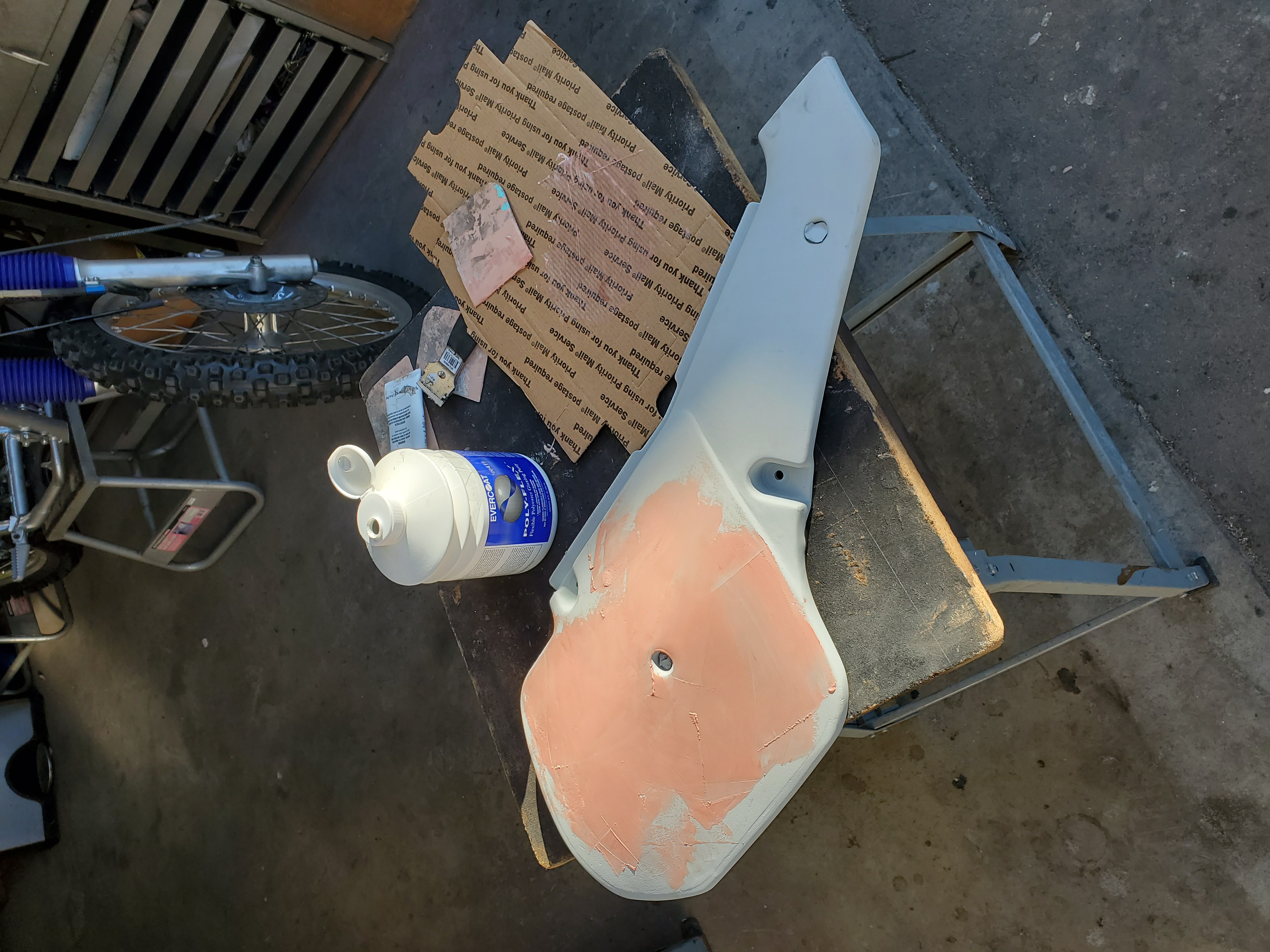

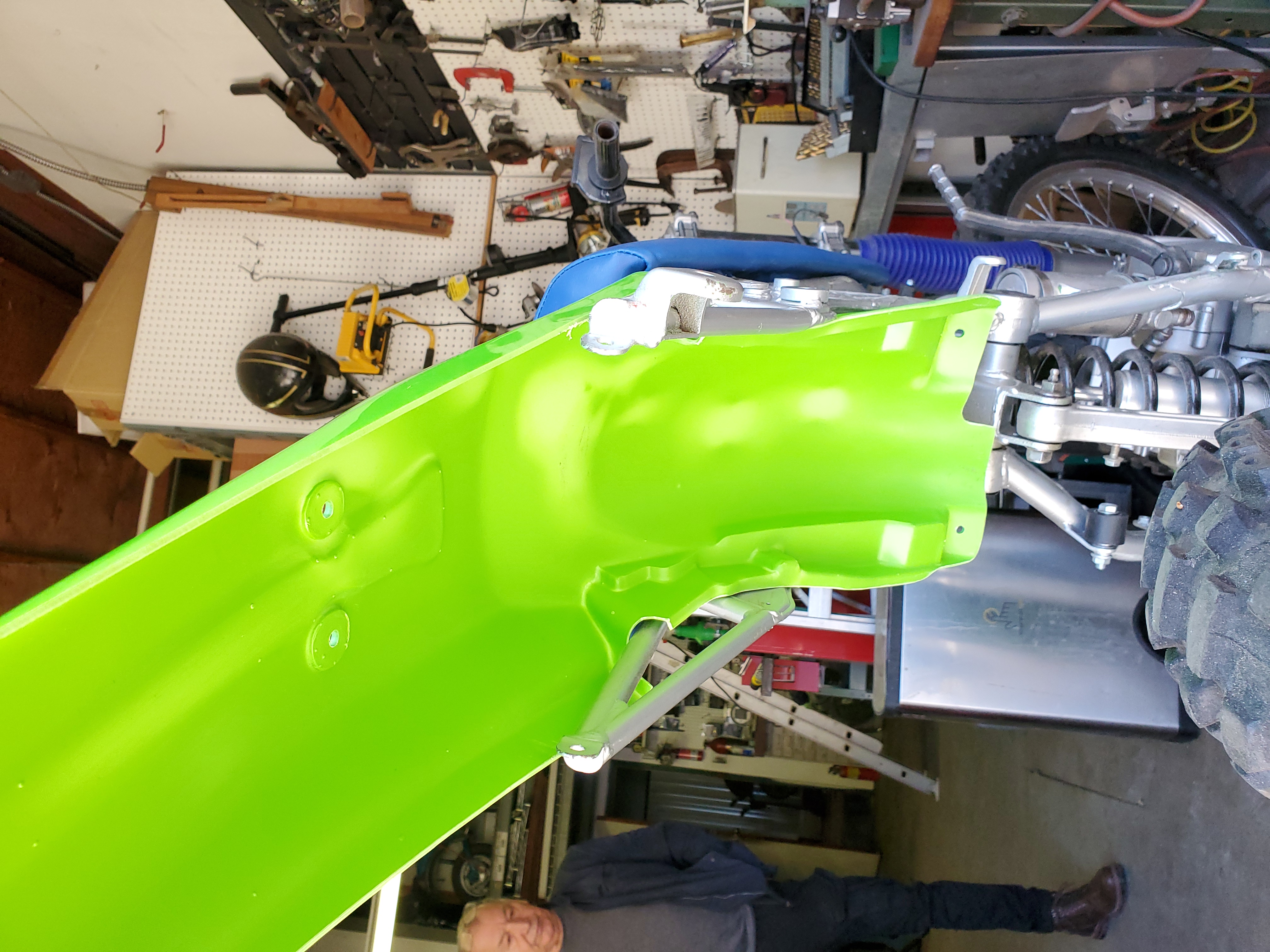

Some updates on the bike

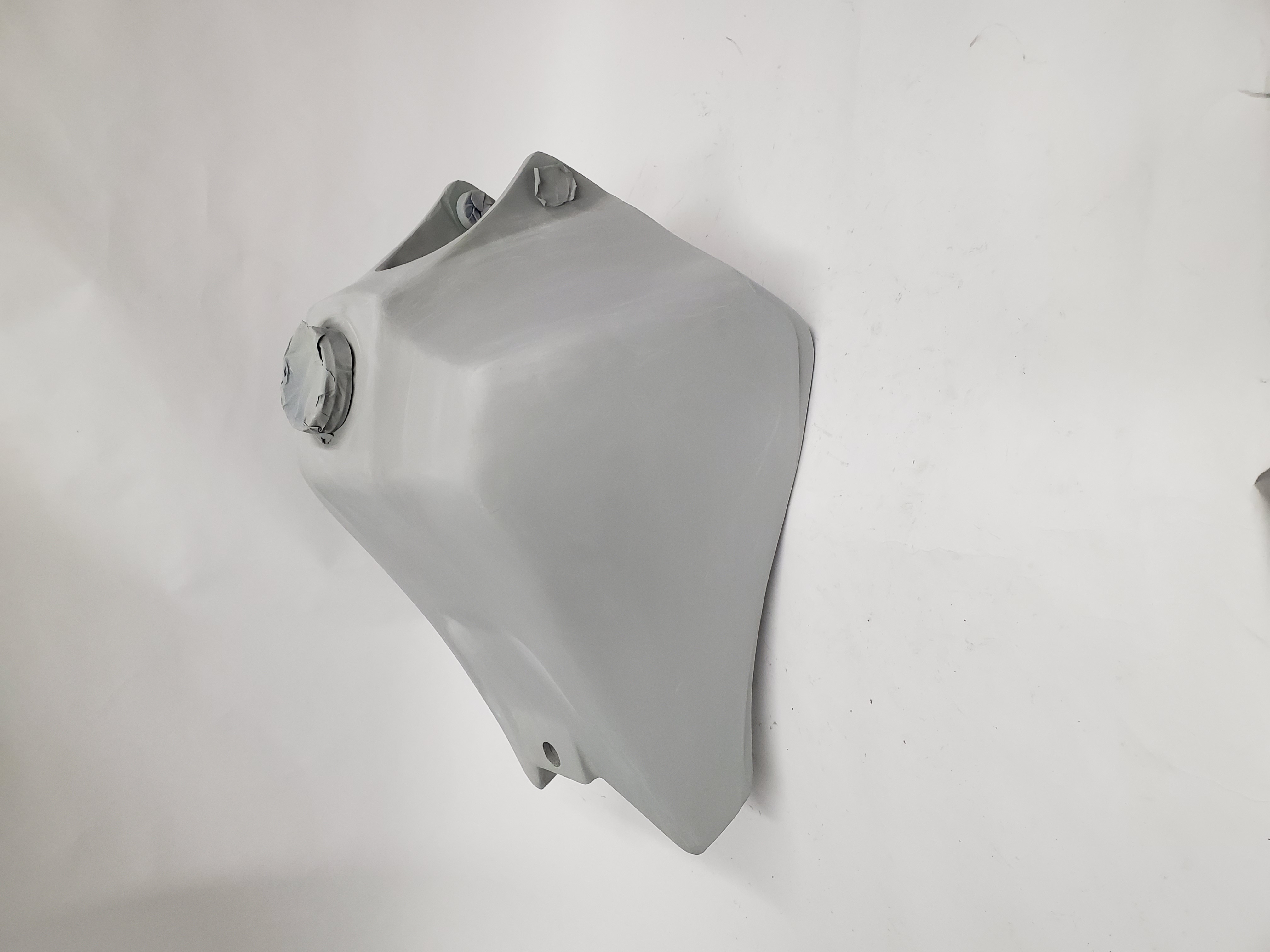

Got the paint done on the plastic tank, side plates, and front fender. Took a helluva while to get done but came out pretty good for what it is.

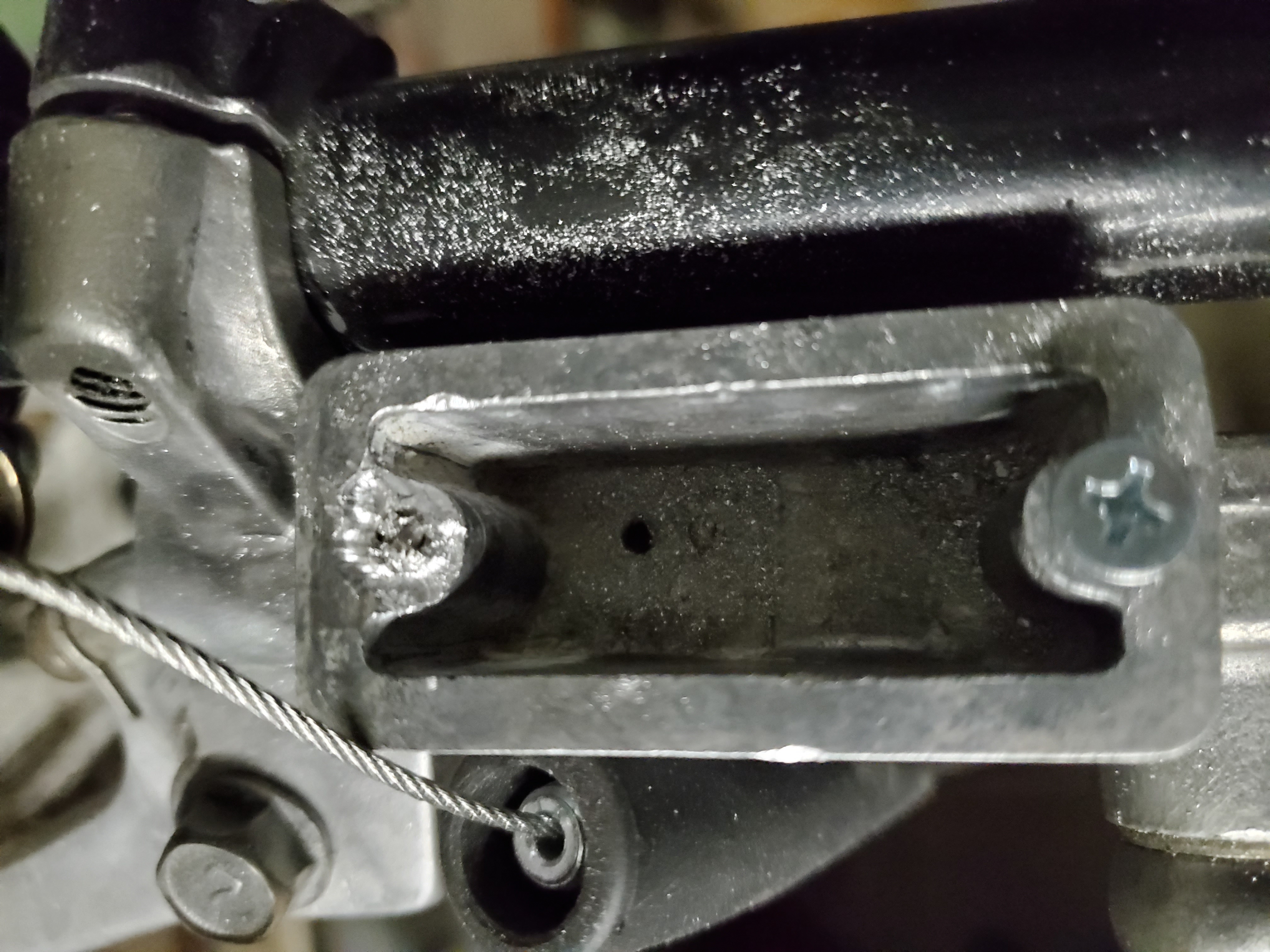

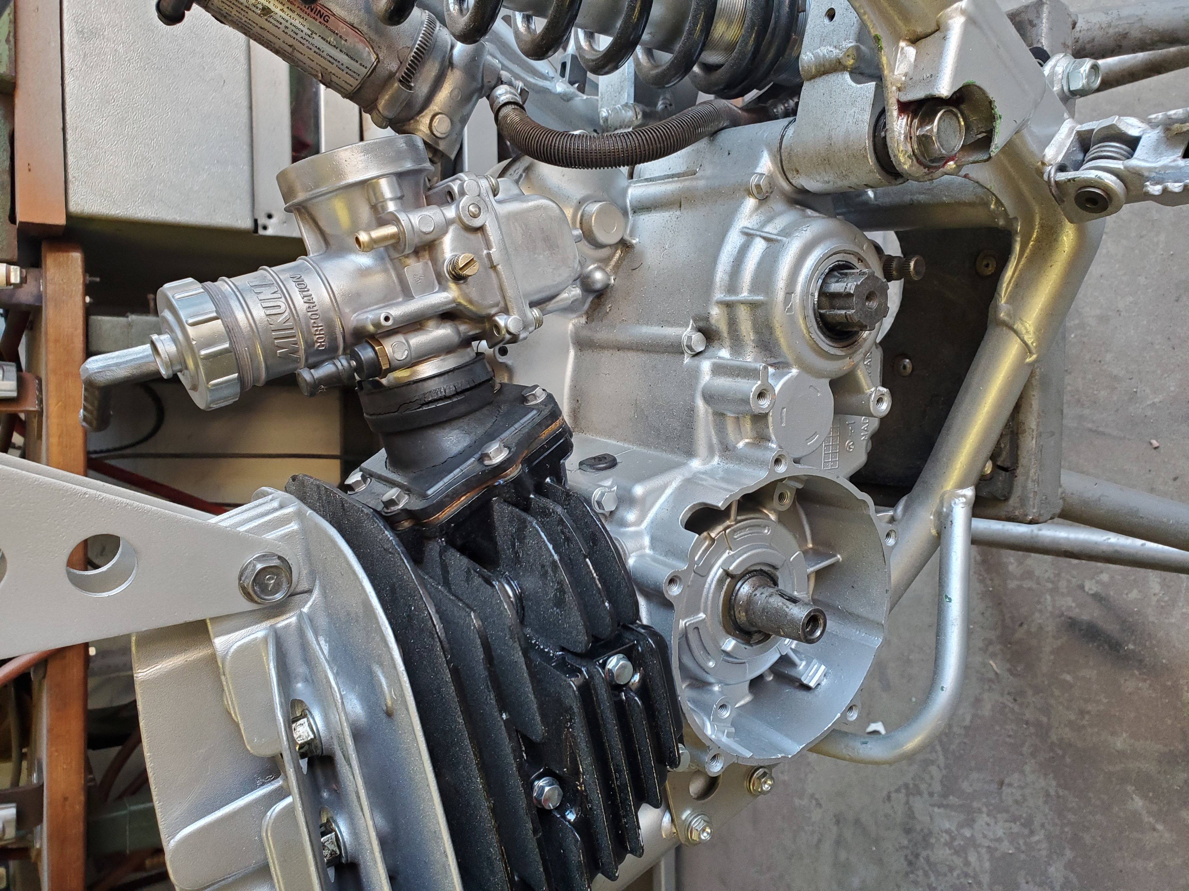

Got the carb cleaned up and took a scotchbrite wheel to it and looks sharp. Also put in new Boysen reeds . Pictures don't show the the muffler on the bike but that has been painted and put on. Also added new front brake lines for the master cylinder. Also had to purchase a used master cylinder lever off ebay from an 89 kdx because the broken screw that rusted into the threads on mine ended up breaking a tap bit :(
Waiting on a new flywheel and coil from FRP , and also in the process of cleaning up the airbox. Also waiting on my new seat to finally get back from upholstery. The put on the wrong color for the seat, just a shade too light even though it as a bitchin color.

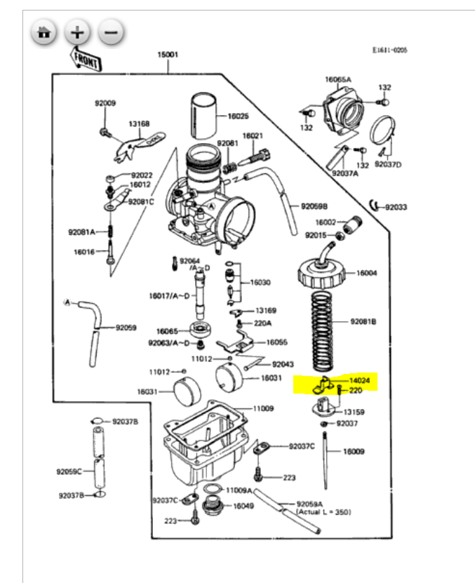

Anyone know what the part that holds the throttle cable into the throttle cable connector is called ? Apparently I'm missing this piece for my Mikuni and cannot figure out how to replace it ? m

You might be able to try a standard part or just find the OEM part somewhere. It fit a lot of models.
https://www.partzilla.com/product/kawas ... 680723062b
https://www.ebay.com/itm/MIKUNI-002-080 ... 4085355931
http://www.sudco.com/Catalog37Digital/f ... ge205.html

I can see from your close-up picture of the carb mounted on the bike that your intake boot is beyond saving - replacing it is mandatory, not optional given how cracked it is. Last thing you want is to do all this work and then seize the engine when it goes lean due to an air leak.

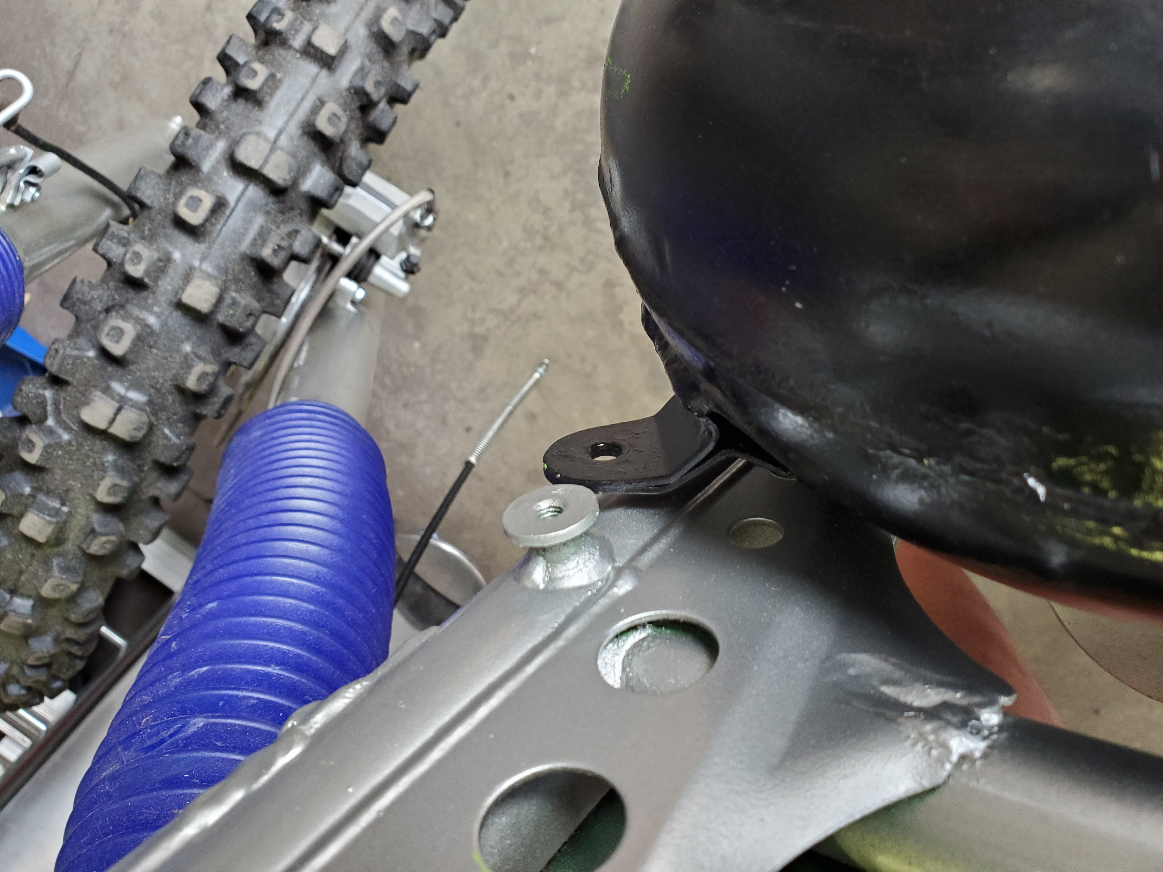

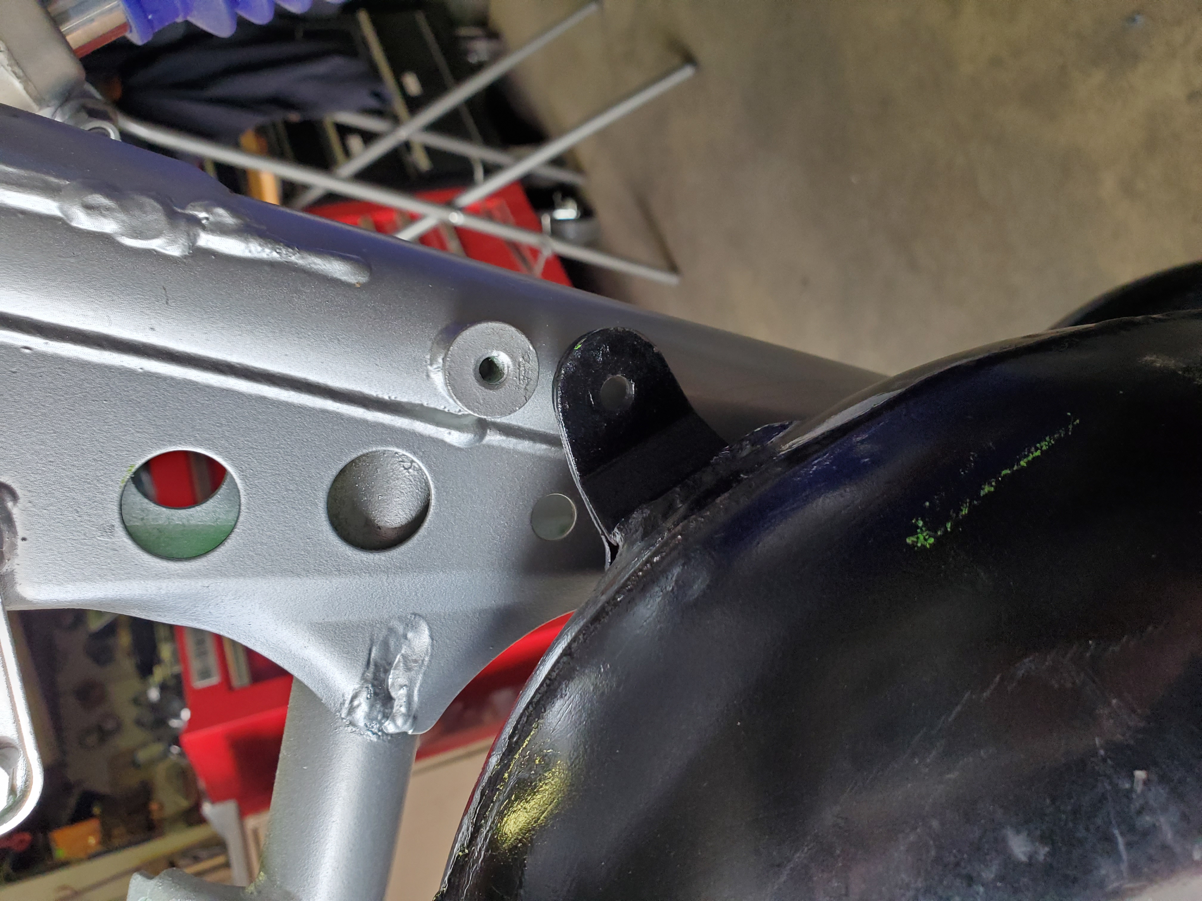

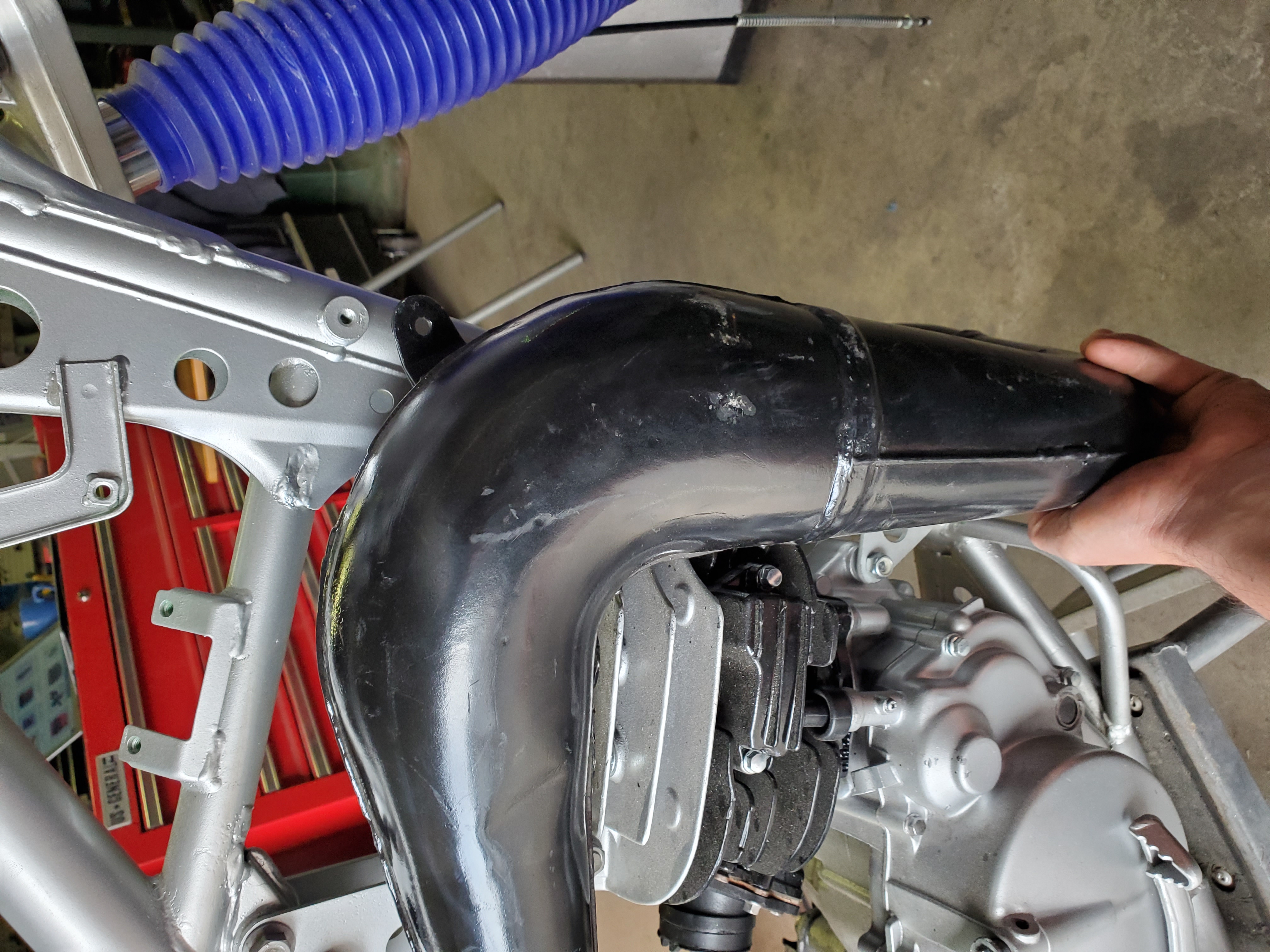

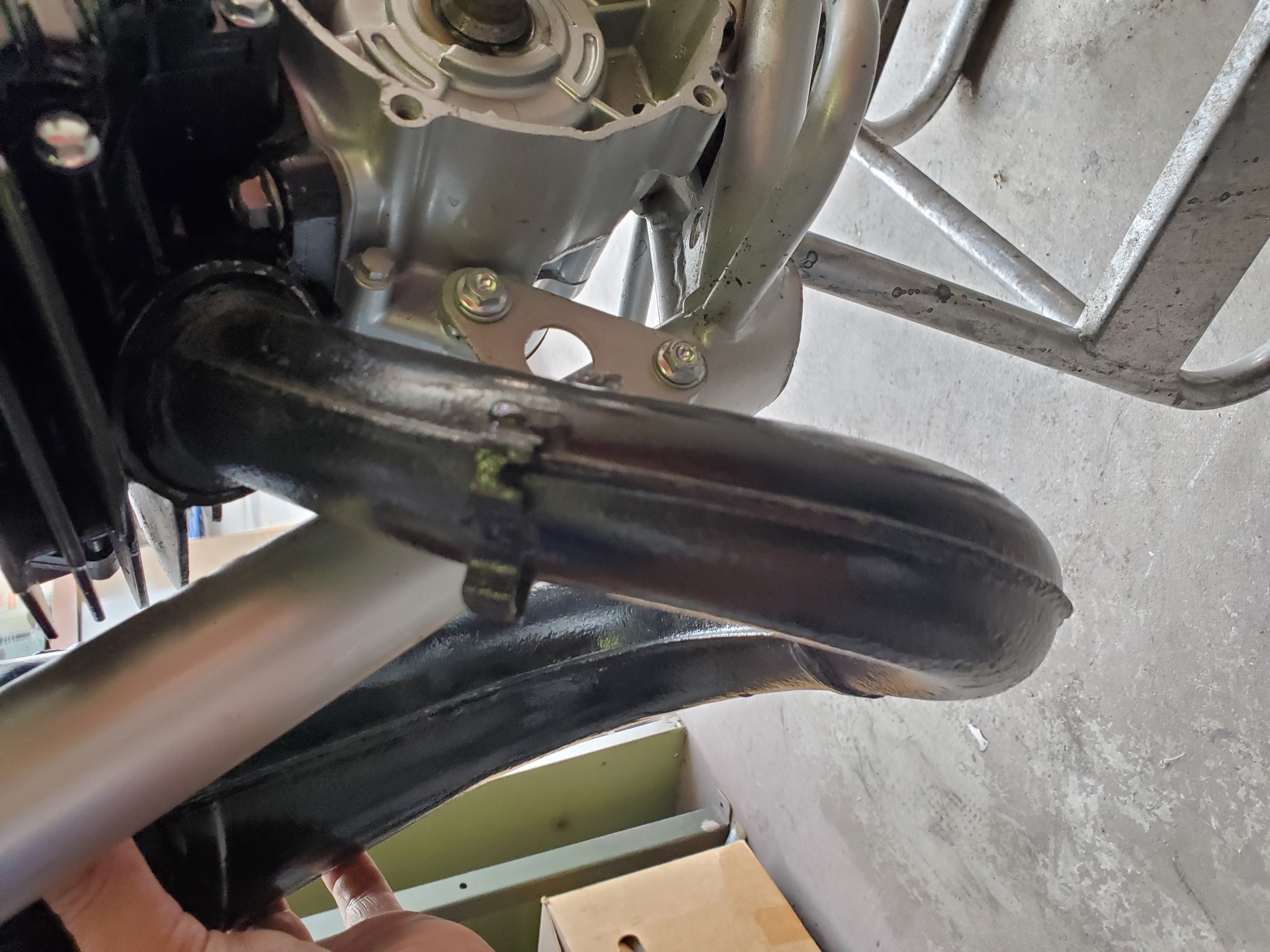

I tried fitting my exhaust pipe on and noticed that the mounts dont seem to line up. Not sure what the story is here... The pipe seems to fit well but could I somehow have the wrong exhaust pipe for the bike ? I might have to fab a temp solution if that is the case .

Re: 1988 KDX200 build thread : The gift that keeps on giving (me headaches)
https://www.partzilla.com/product/kawas ... 40ecf9534b
Here you go, a holiday gift for you:
https://www.partzilla.com/catalog/kawas ... -kdx200-c3
- Posts: 60
TheGarBrah wrote: 05:30 pm Dec 23 2020 Thank you Pressingonward your build thread has definitely been a motivator for me.
TheGarBrah, that's an '88 pipe with the three springs. '86 and '87 just have two.
It makes me wonder if an '88 cylinder had differences besides the paint color and extra spring hole.

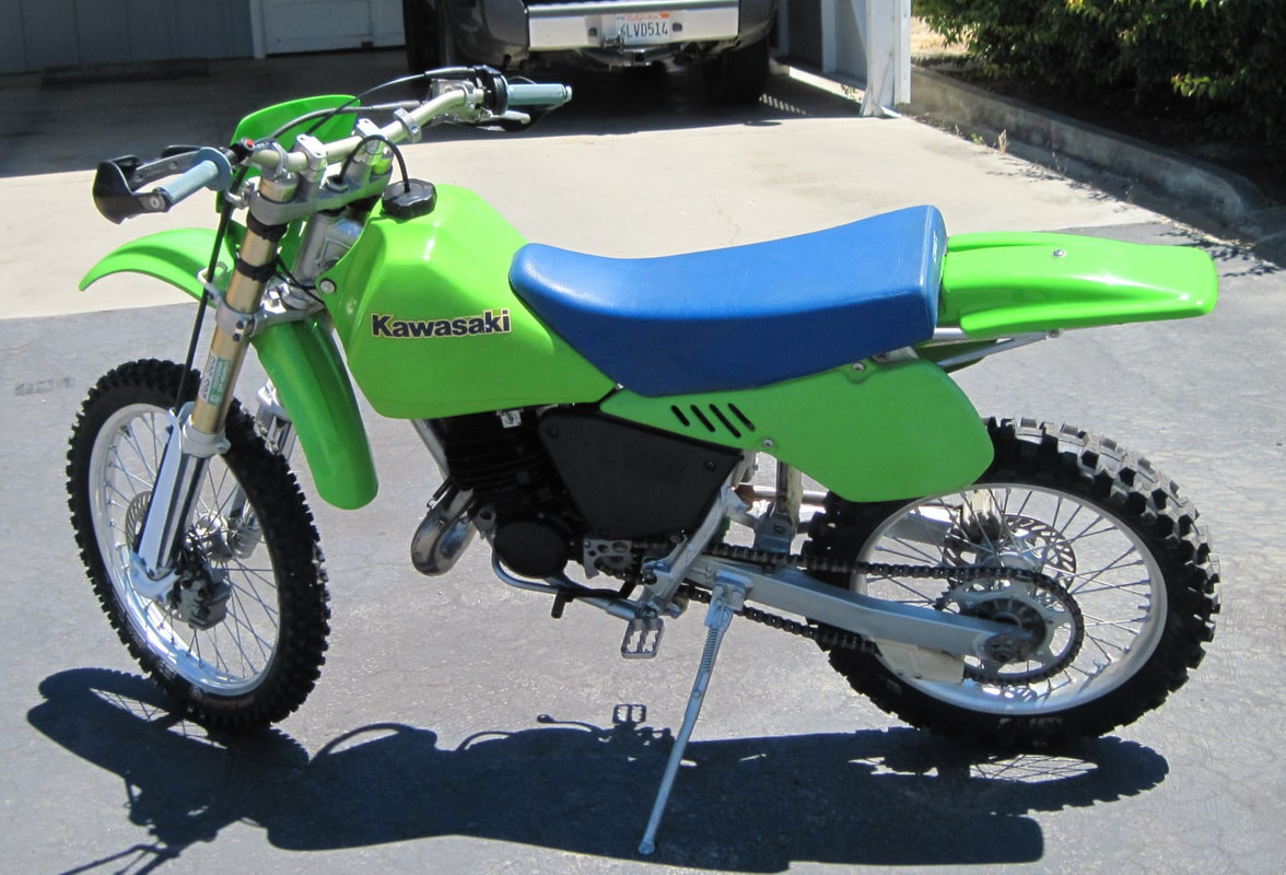

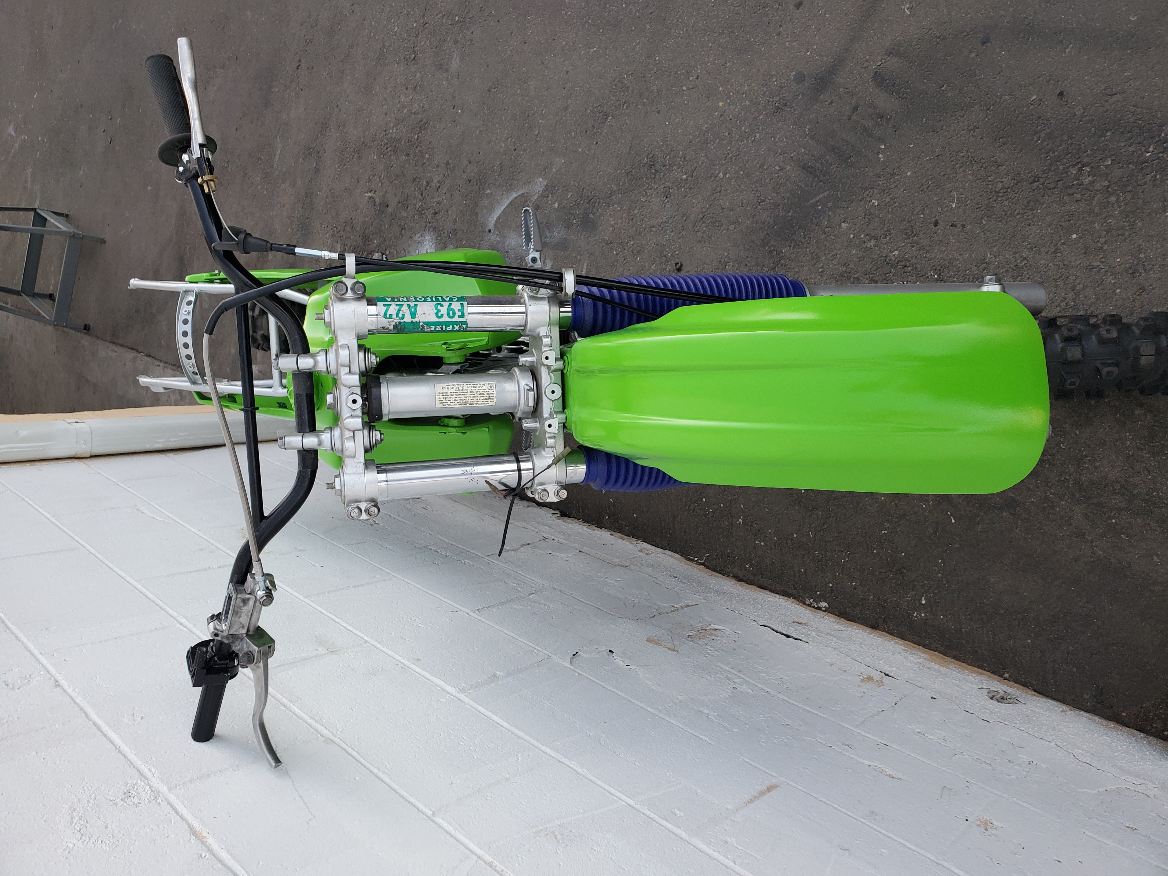

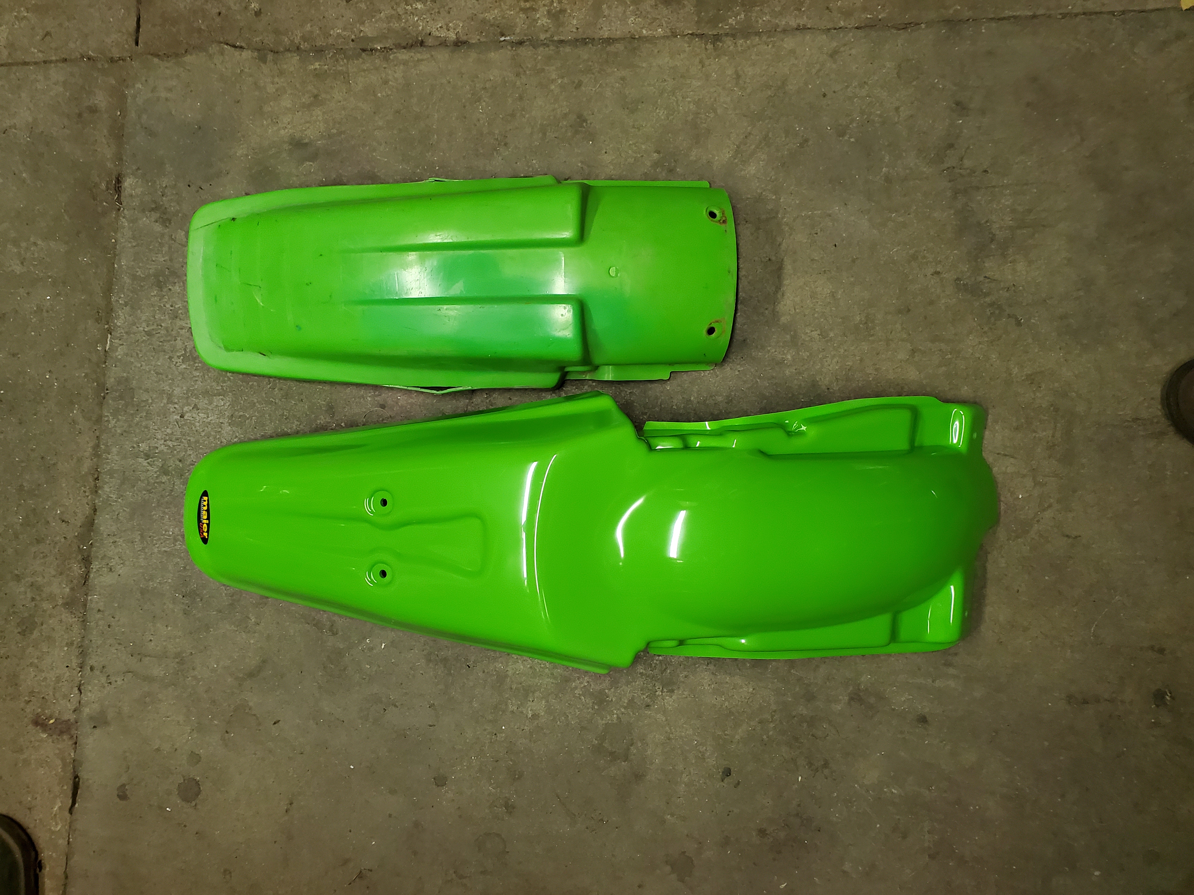

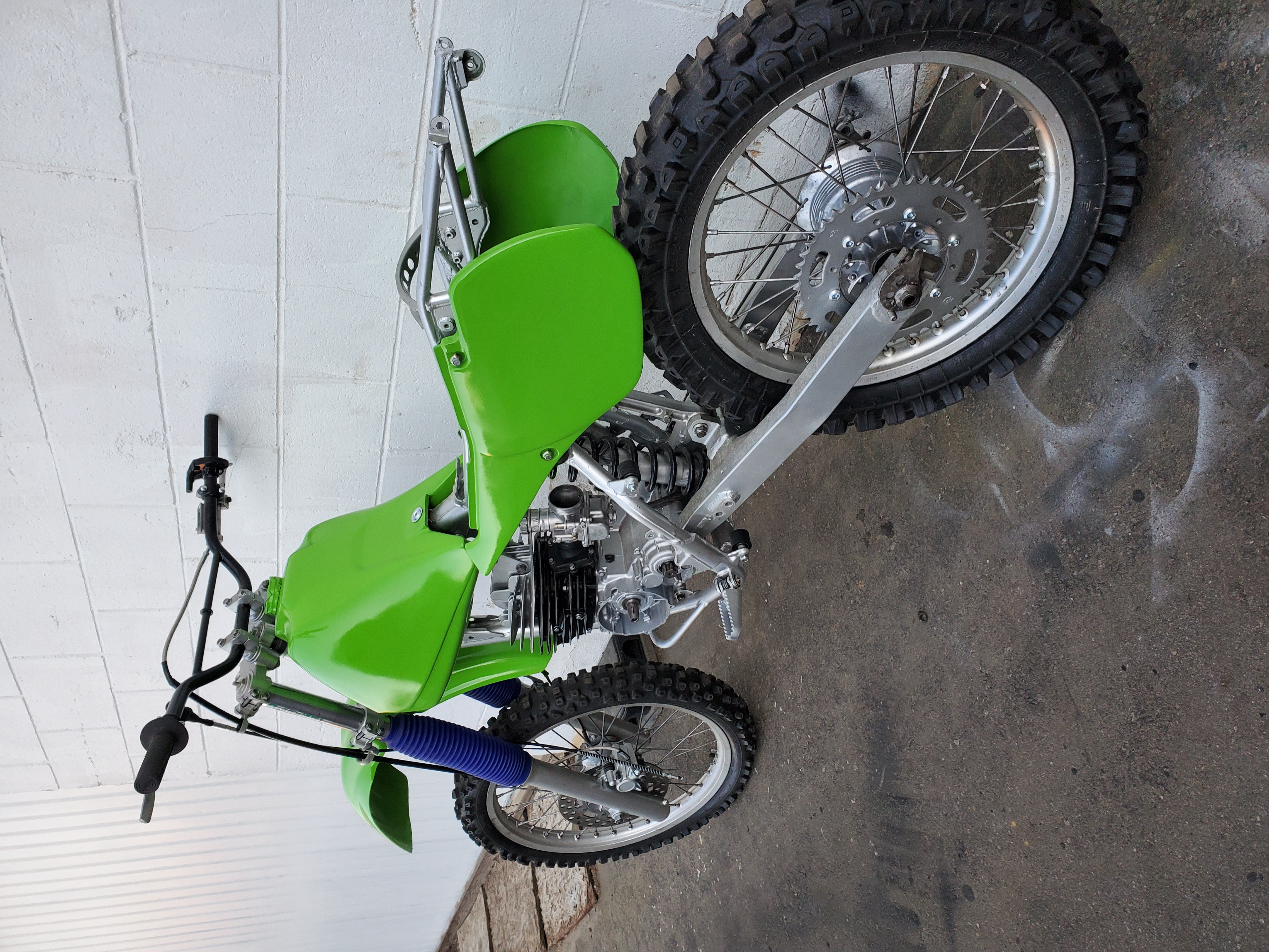

Little update on the bike. I got my custom seat back finally after several mishaps with the upholstery guy. I went with a custom color that looks close to a factory color and got new seat foam put in. The original rear fender that came with the bike was an mx style but not sure which bike it was from. I ordered the maier and I immediately noticed that it doesn't quite have the lines and fit that I was hoping for. Does anyone know of a good write up on fitting one of these fender to an older bike ? I get that it won't quite fit to exact specs but for the price tag I want this fender to fit just right or I'll return it and get a less expensive option that I can chop up to fit my needs.
The Maier rear fender is for 1995+ models.
You and the last picture are 1986 / 1987 KX125/KX250/KX500 rear fender.
Get a DC Plastics 1986 - 1988 KDX200 rear fender if you are wanting a taillight.

I 've tried out the ufo kx rear fender for 80's models and It didn't really look to great. Was hoping maybe this fender would pan out but I'm not really digging it either .
Get an OEM or DC Plastics rear fender.

I ended up going with an 86 KX fender from Maier since it matches the specs from the busted fender that I have . Once I get the fender In I'll update the photos. Bike is done except for the stator coil and flywheel (waiting on FRP to get those back).
