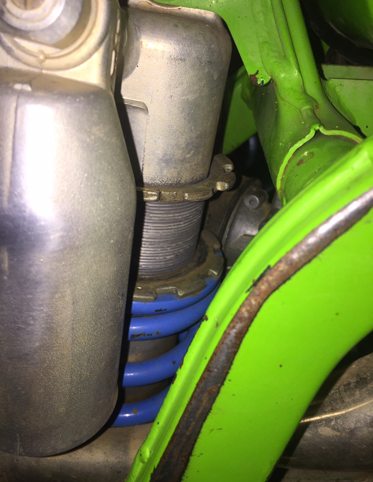

I have never even checked the sag. Been on my to-do list since reading the forum. I’m gonna bet it’s way off but will check.

Setting your sag is the single most important adjustment to make on any suspension. You would be surprised of how many weird front end issues are solved by proper rear sag.

Finally checked my sag. Long overdue. But helps explain why this bike has been such a treat to ride. It was spot on: 100mm race / 19mm static. I bet static was bout perfect when I bought the bike & I need to loose the COVID 19 that crept back on since last turkey day.
Pleas note that this perfect race sag number was attained because the spring was set to auto-adjust.

Re: Joining the Club (KX125)
Auto adjust, ha ha!
Time for a stiffer spring.

Dear KDXG, would you guess the original has just lost some sproing over 25yrs, and I should replace with new stock... or would aftermarket be the way to go.
I am rolling about 205-210 in gear, now.

Aftermarket is what you need. I would probably go Racetech.
