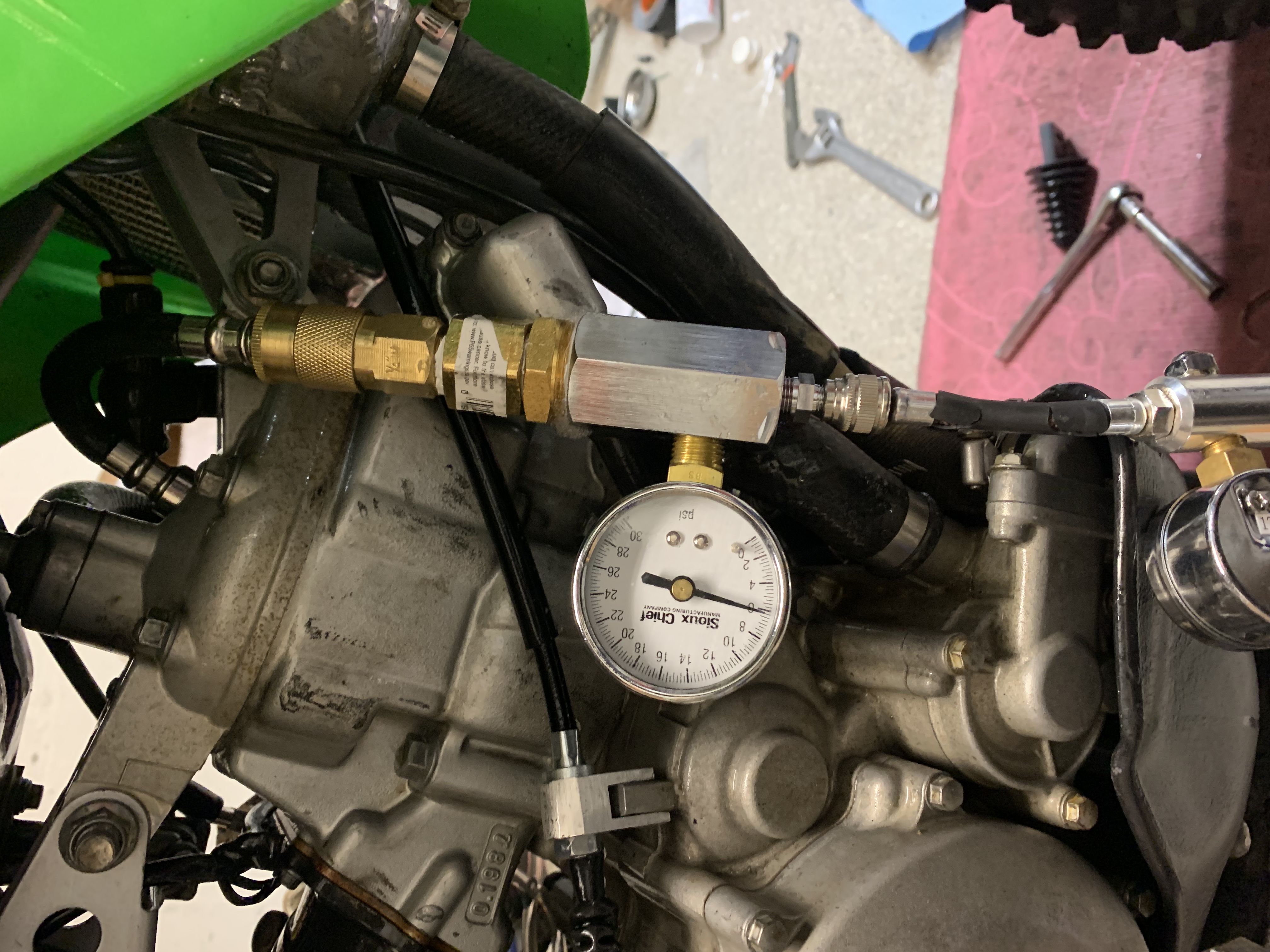

So I ended up doing a leak down test. First test I plugged up both ends and it held 6psi for 6 min which I think is good.
Second I kept the exhaust plugged and tested the lectron. Could not get a good seal out the top of it because it is an American bolt. I jamed a rubber plug in but it only held 2 psi and was bubbling from there. The intake did not bubble around the boot at all with the carb so I feel it’s okay but I would like to find the right bolt for the top and retest.
Then I plugged the intake and put the pipe on. I sealed the end of it and i found 2 small pin holes. Would only hold like 3 psi but no bubbling around the exhaust flange so I feel that’s okay. I’m going to see if I can get the pipe welder to fix the pin holes but I think everything pretty much checks out.
Here is my tester I made. Just used a comp tester hose.
Re: Lectron: KDX happy customers ????
no drop for 6 minutes is great!!

Yeah I am pumped on that. I was just dreading splitting the cases to swap crank seals. Then I would prob replace all bearings and send the crank off while I’m In there but I think it’s good.
Posts: 6117
Sounds like the engine has no leaks if holding 6psi for that long. Double check the rod that Lectron sent you is the correct one and installed at the correct starting length. Something is definitely wrong somewhere.
