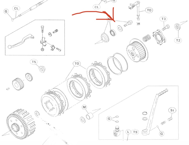

I took out this washer because I like the way the clutch feels without it.

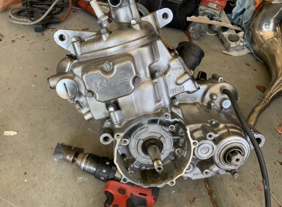

I used acidic paint stripper on the cylinder. I wonder why kawasaki decided to paint just the cylinder and not the rest of the motor. I tried using engine degreaser and power washer on the motor, it had a big countershaft leak, but it would just smear the grease everywhere. I used a set of mini wire wheels for a dremel and it worked great because it would just fling the smut off into space.
