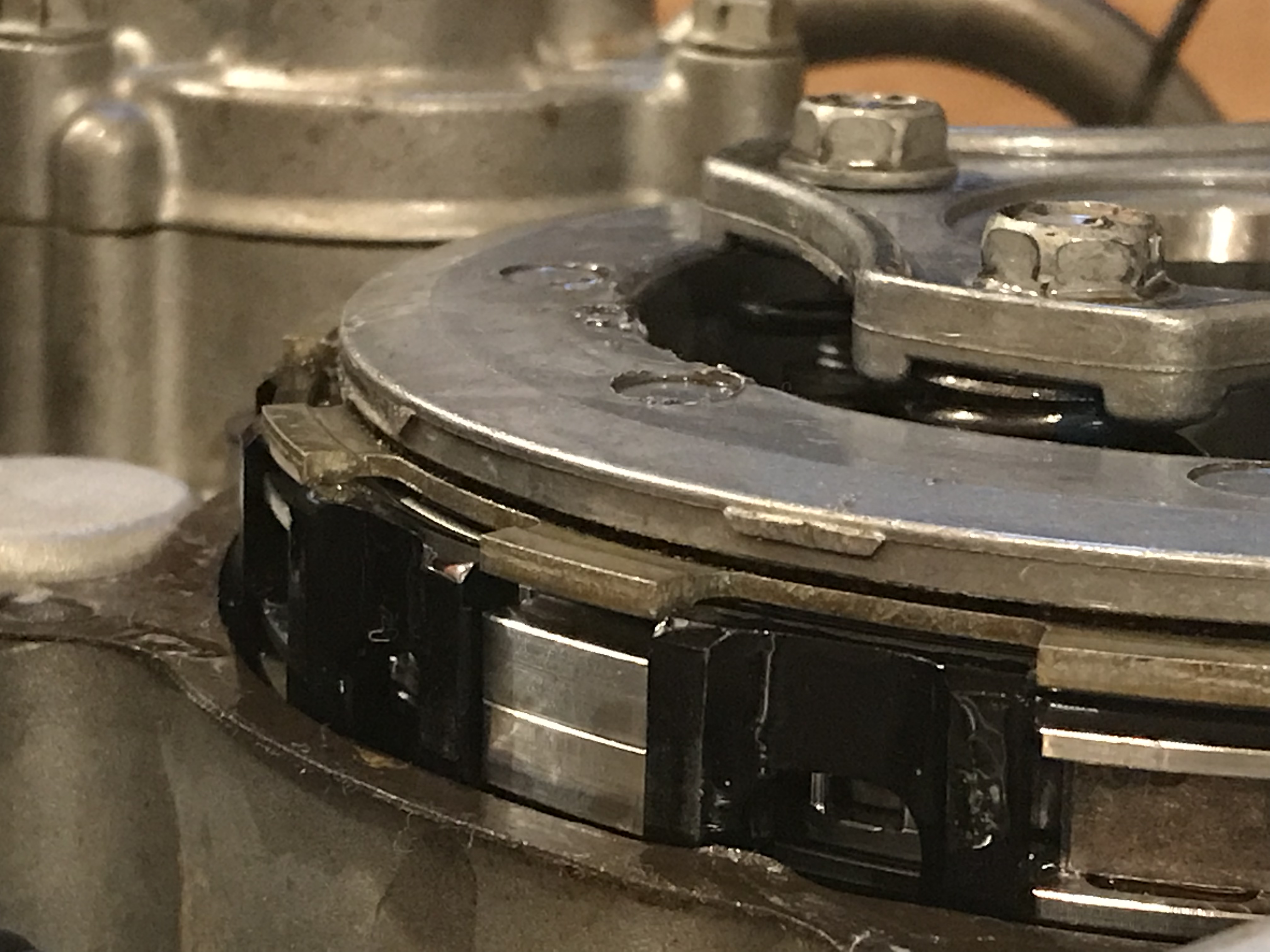

bradf wrote: 01:07 pm Jan 01 2018 Added a shim to the pressure plate push rod to make up for the difference in hub depth. Top friction plate is app .025” below top of basket which means push rod is further away from actuator rod.
Got everything installed and buttoned up but I have the exact opposite issue. My top friction plate is just barely "captured" by the clutch basket fingers with most of the friction plate tab above the basket fingers. I know the plates and frictions will expand "down" into the basket but is this an issue as is? Can it be run this way? If not, what is a solution?

Re: Rekluse EXP in an H series KDX
As you are a supporting member:
Click on "Full editor"" instead of submit.
Below "Save draft" "Preview" "Submit" will be: "Options" "Attachments". Click on Attachments. Then click on Add files. A box will pop up to allow you to choose which photo to upload. Click on the picture, then "Open". After the file is uploaded, click on "Place inline". A similar text will appear within the body of your message showing a picture if you click on preview:
[attachment]123456789.jpg[/attachment]
G22inSC
Posts: 513
Joined: 10:23 pm Jul 24 2006
Location: South Carolina
Post by G22inSC »
This is how it looked...

G22inSC
Posts: 513
Post by G22inSC »
I am wondering if this is my issue. The pressure plate does not meet the hub when they are dropped into the basket with just the necessary washer between the basket and pressure plate (no friction disks or steel plates). It's almost as if the pressure plate is too tall and the top edge is too far away from the basket allowing the last friction to rest too high.

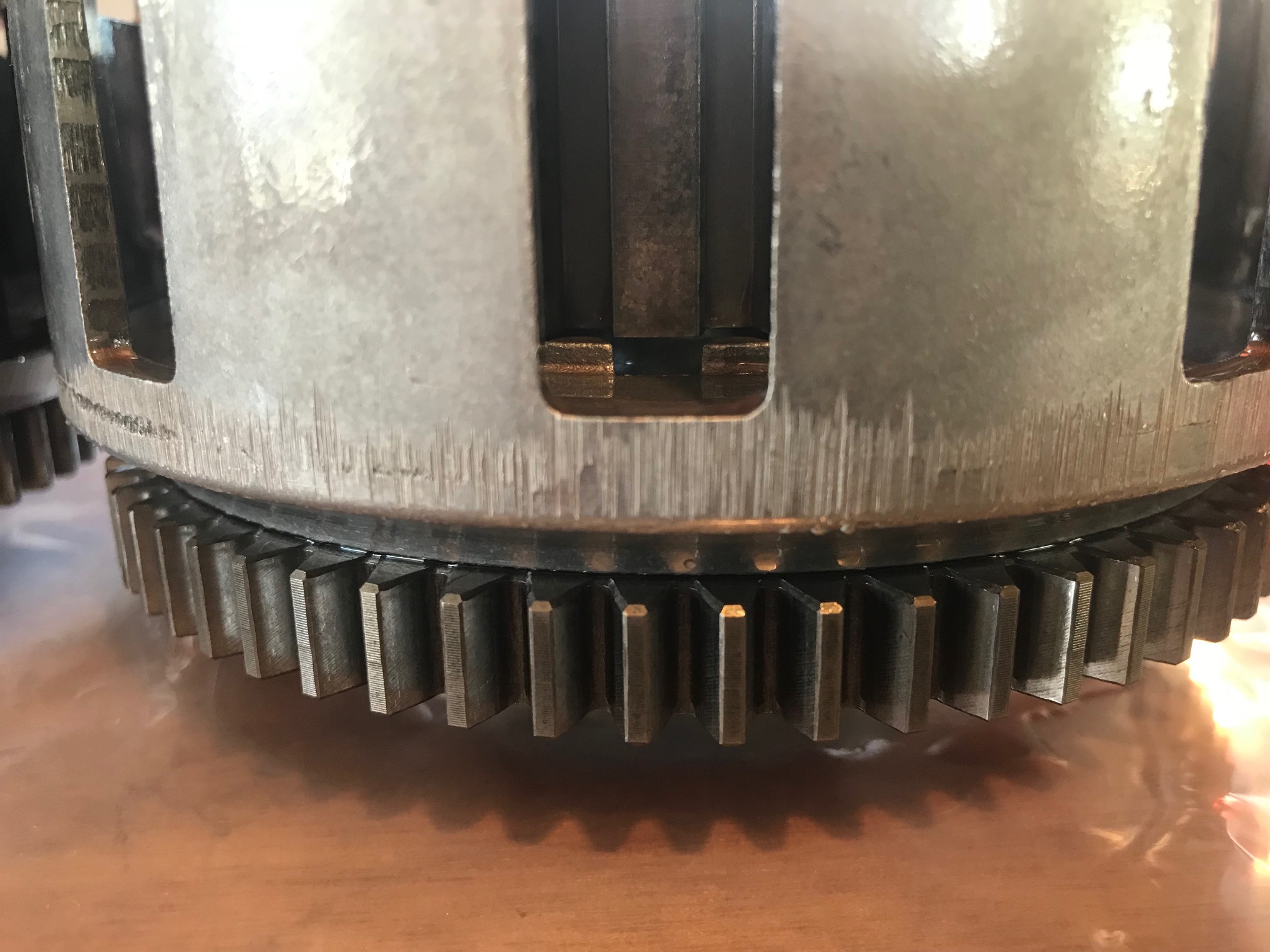

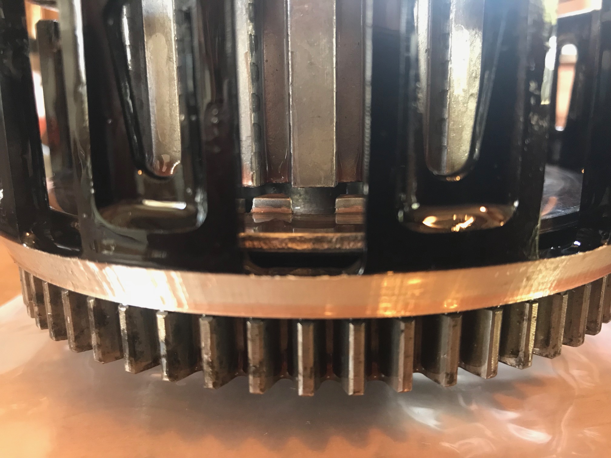

G22inSC
Posts: 513
Post by G22inSC »
I know the KDX clutch disengages or releases inward toward the center of the cases. How much room or clearance is needed for the inward movement? Do you want the hub and plate to completely separate with a gap between or just almost separate? Does anyone know off hand?
'10 Honda Recon (wife's)
'08 Kaw KX65 (Sold)
'07 KTM 50SX Sr. (Sold)
'09 Yam PW50 (retired)
'97 Kaw KX250 (Sold)
Gallery
2005 KDX200 Bike Profile
G22inSC
Posts: 513
Post by G22inSC »
Just an update...I had a shop machine 0.070" off the back of the inner hub and everything works perfectly now. I've got the Rekluse installed, adjusted and now it's just time to find a time to go ride with the boys. Can't wait!
