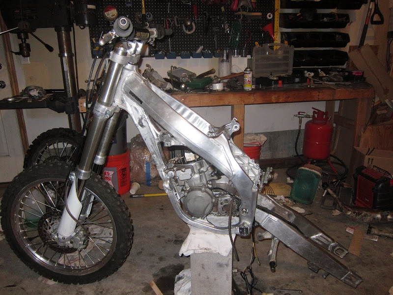

Didn't get a ton done tonight, but that's ok.
I got the front forks/bars mounted, and I pulled the head.
I have no clue how I'm going to get those 3 stripped head studs out. They're soaking in PB right now. I wonder if I'm going to have to weld some nuts to them and back 'em out with a wrench. Anyone have any great ideas? I can't double-nut them because they're stripped (I can't even get a nut on them).

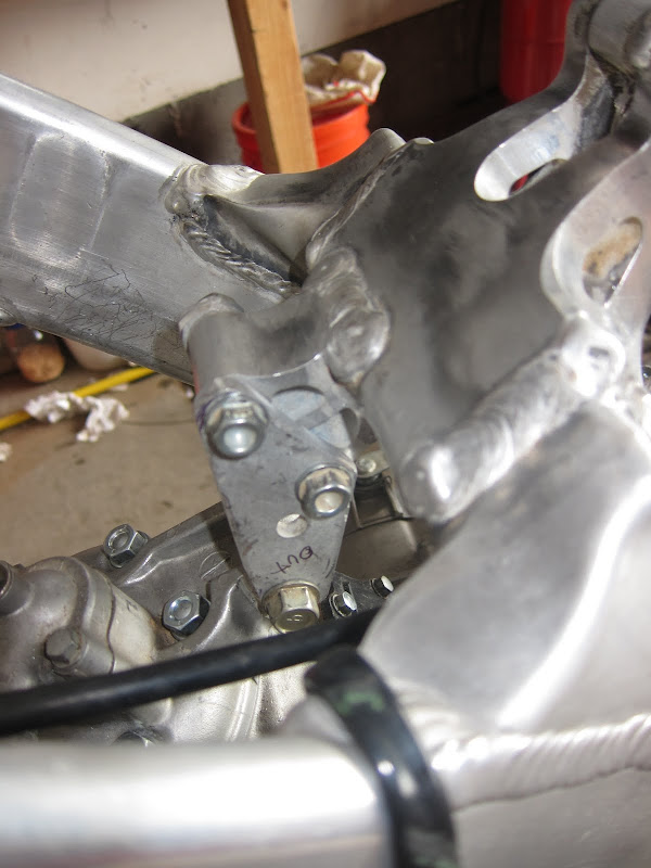

The above pic shows a rough idea of where the c/s sprocket is in relation to the swingarm pivot bolt. I think it'll be fine.
