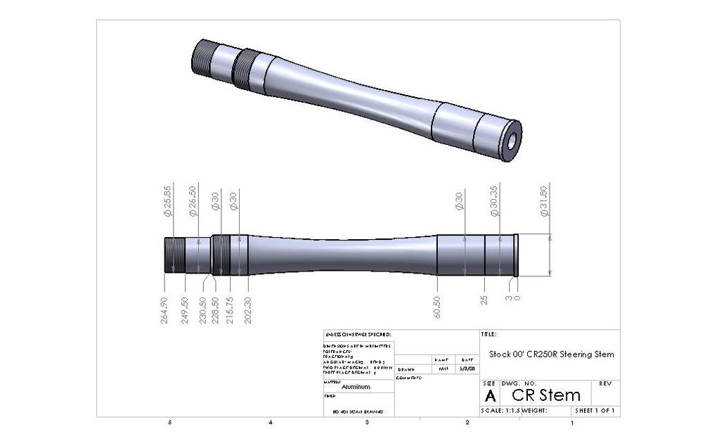

This 2000 CR250 steering stem drawing shows dimensions which are very helpful, 191mm spacing from bottom of lower bearing to top of upper bearing surfaces, this could work just as well or better than the medium length or long Yamaha stems! I believe around 190mm bearing spacing was perfect to me for the KDX frame when sizing up the VStrom DL100 stem I have here (190mm bearing height bottom to top) for my '98 RM125 triples

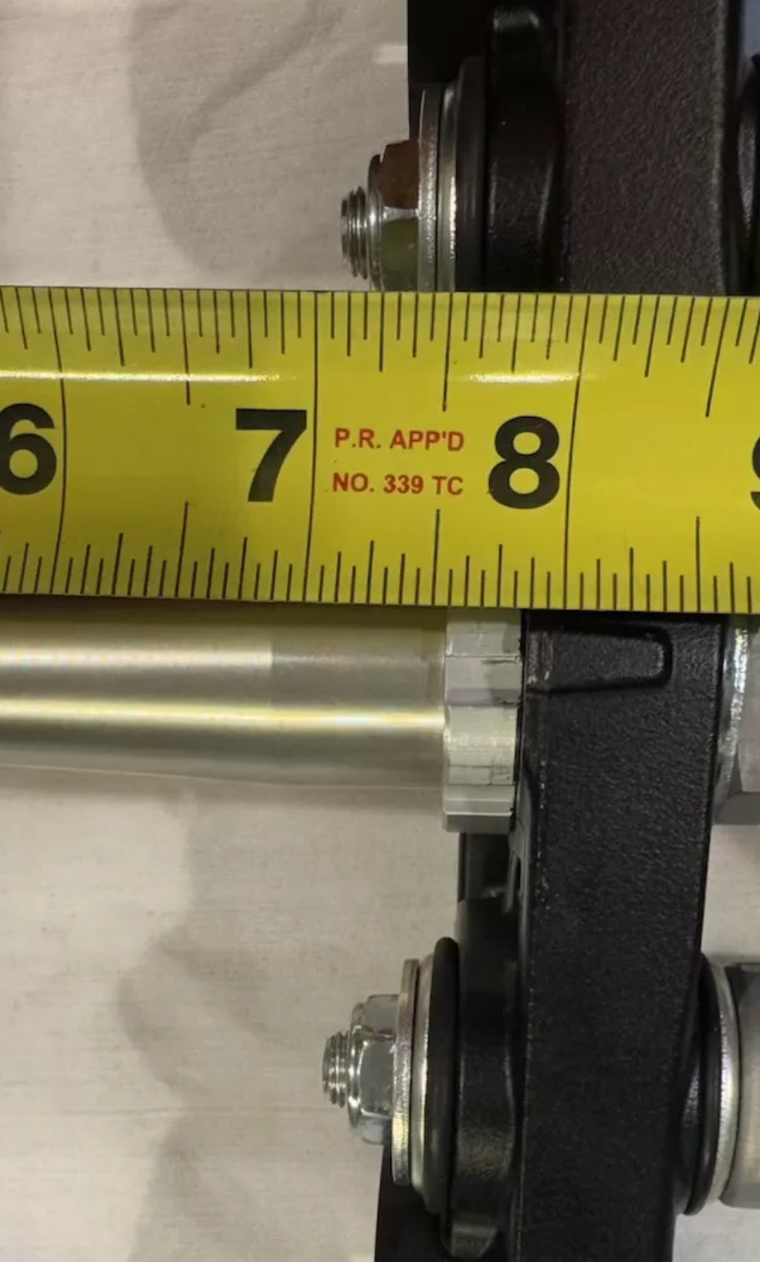

I've asked an eBay seller to measure the steering stem length between the outer ends of the lower bearing vs upper bearing @ threads, out of curiousity...He's getting back to me shortly, quick service! I believe I can get the appropriate .38kg springs for those forks from RaceTech. The CRF250RX probably has the same forks I'd imagine, listed also as 49mm Showa Twin Chamber inverted. Those have pretty heavy springs still, not anything near the rates I'd need on the KDX @ 155lbs-ish +/- rider weight. 4 strokes are still heavier than 2-smokers for the most part, although the mass is located lower for a "lighter feel."

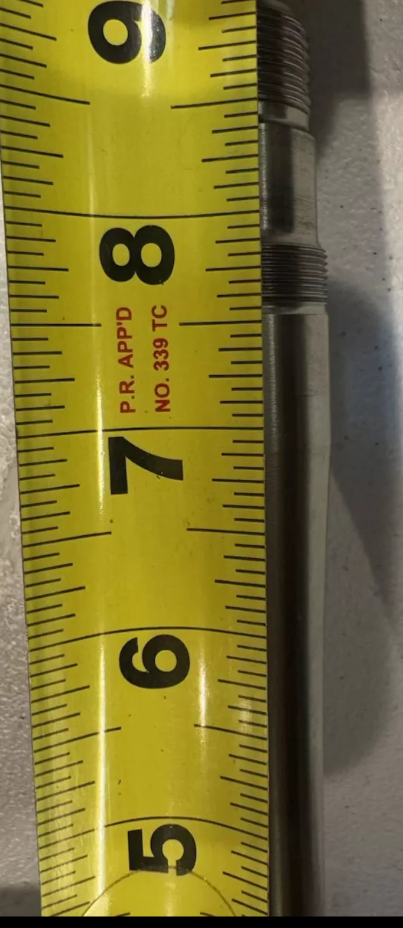

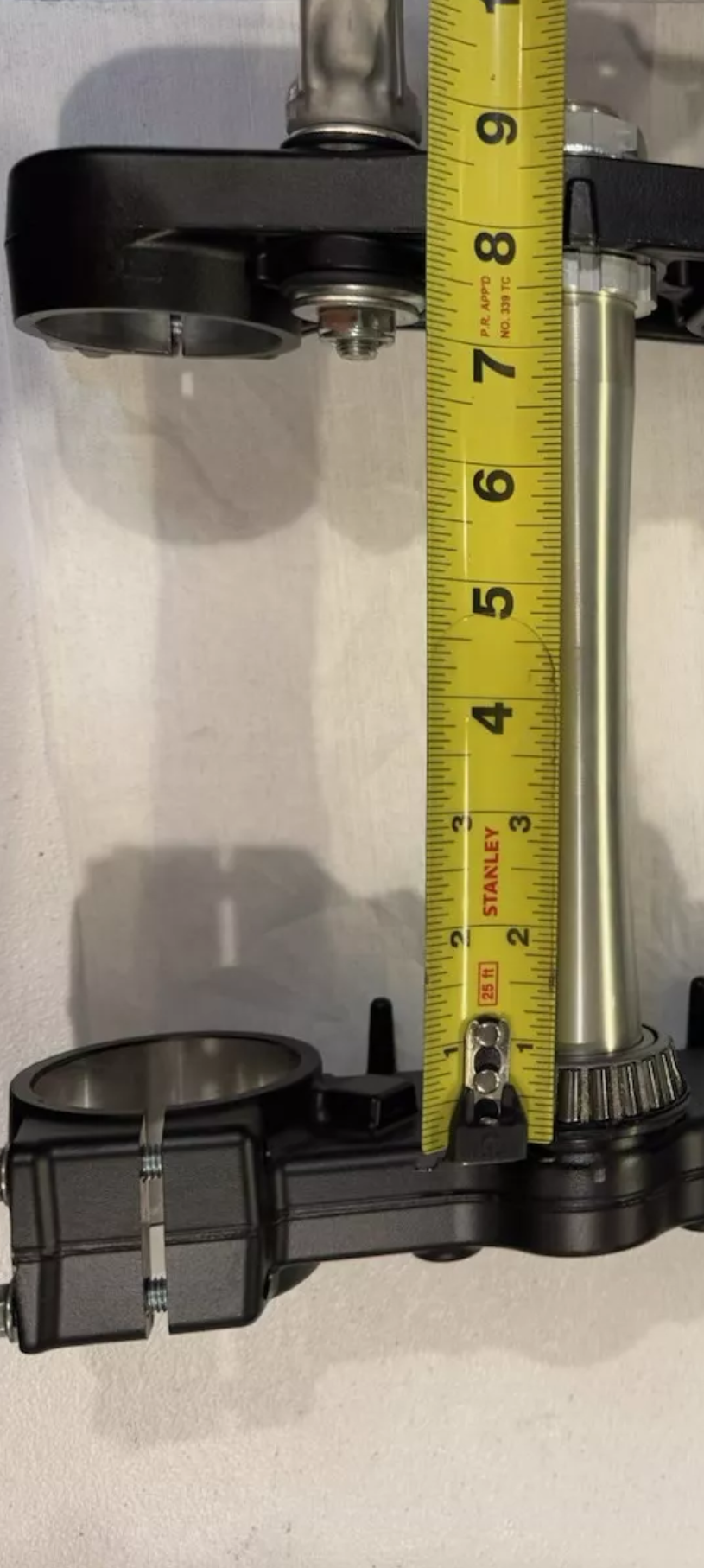

Chuck78 wrote: 02:32 pm Feb 02 2025 I'm curious about the 2019-2023 KX450X Showa 49mm forks now, although the price is quite high for used late model forks...
I've asked an eBay seller to measure the KX450X steering stem length between the outer ends of the lower bearing vs upper bearing @ threads, as I have a suspicion this could potentially work out really well with a spring swap and upper adapter bearing
Older forks always pose a risk of having less than desirable chrome tube condition, which is a big deal breaker, and is tough to inspect adequately when buying off eBay.
Well... Whaddya know?!?!
7-9/16" = 192mm!!!!
2019+ KX450 MX & KX450X off-road GNCC enduro racer forks could be a really good swap here!
