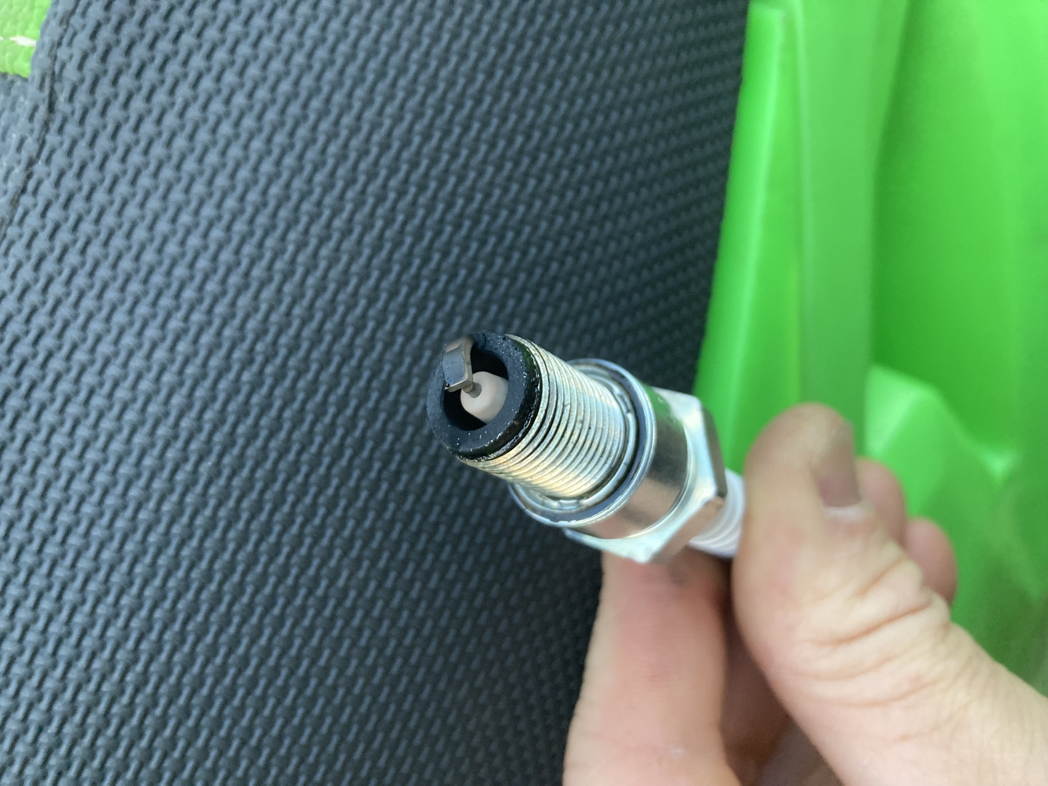

I ran a BR8EG for a long time, but thought I’d try a 7 for all the tight woods riding I do. According to the ground strap, 7 is right and 8 is too cold when I’m riding normally.
However, i agree that I should probably be using an 8 for plug chops. The only reason I’m using iridium 7 plugs is because I got half dozen for $20.
Any thoughts about the soot ring? Should I go richer yet? Or is this all kinda moot because of the 7 range plug?

The soot ring looks ok to me considering the heat range. Would like to see what it looks like on a BR8ES.
As to the heat range, we've all learned over the years that an 8 range plug is good for literally any condition, from hike-a-bike to wide open desert, you could ever encounter on your KDX provided the jetting is good. I literally change my plug (BR8ES) once a year just because I feel I should and not because I actually need to.

I’m sold, i’ll go back to an 8 tomorrow and do another chop. Never had any fouling issues with an 8 before, but had been told that a 7 might help clean up the spooge for slower woods riding.

plug chop technique sounds perfect to me
I would not run a 7 for a plug chop. I can't imagine needing to run a 7 around here for local riding. The pre-1995 KDX's actually came with 9's, but I switched to 8's and it was SO MUCH BETTER.

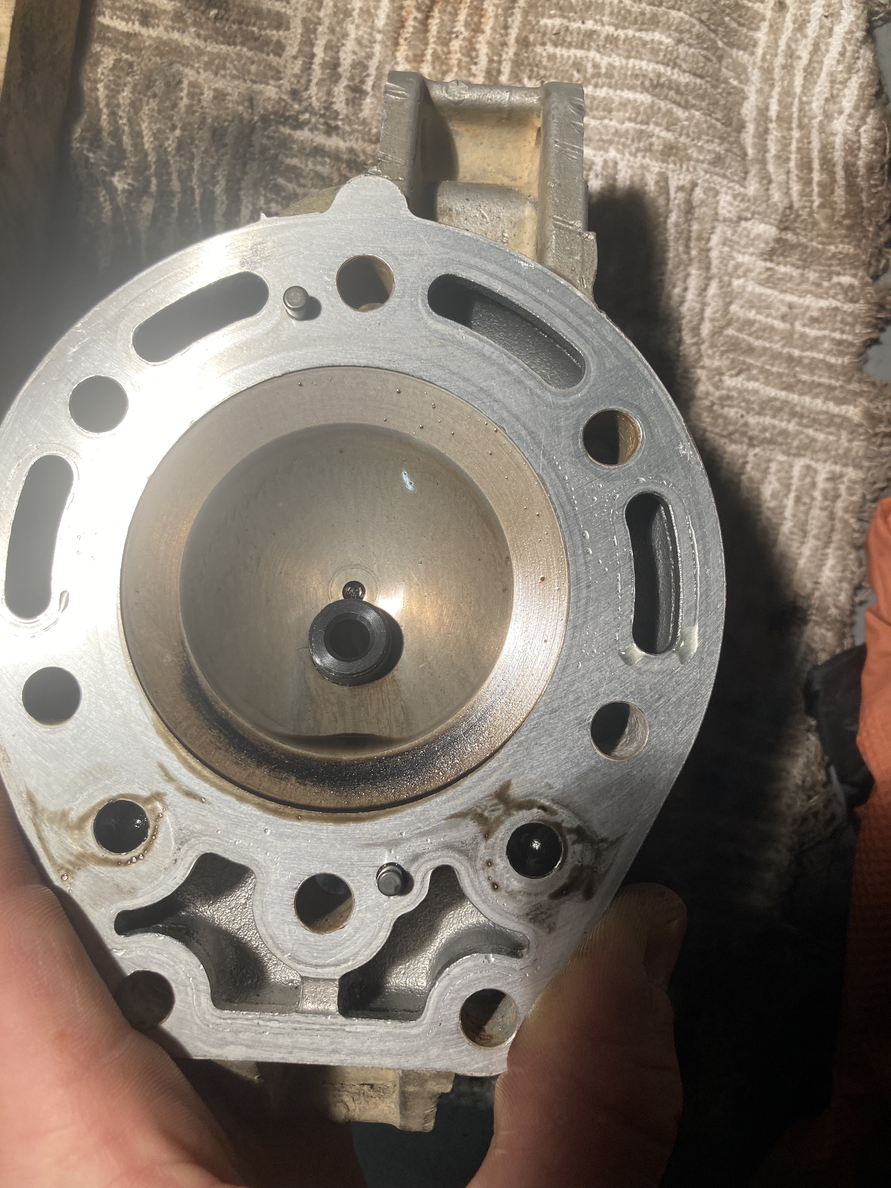

SS109 wrote: 12:32 pm Oct 12 2024 Ah, yeah, that will exacerbate the problem for sure. Do you have an RB head by chance? If not, it can help in reducing spooge in the lugging situations.
Just a follow up: I looked through some old photos a bit this morning and found a nice clear pic of my cylinder head from last summer. Comparing my head to the photos chuck78 posted recently, i'd say i think this IS an RB modded head after all. Whadya'll think?
Follow up plug chop with BR8ES coming soon...

Yes that's an RB head, you can tell by the machining, sharp transition and the head has been milled

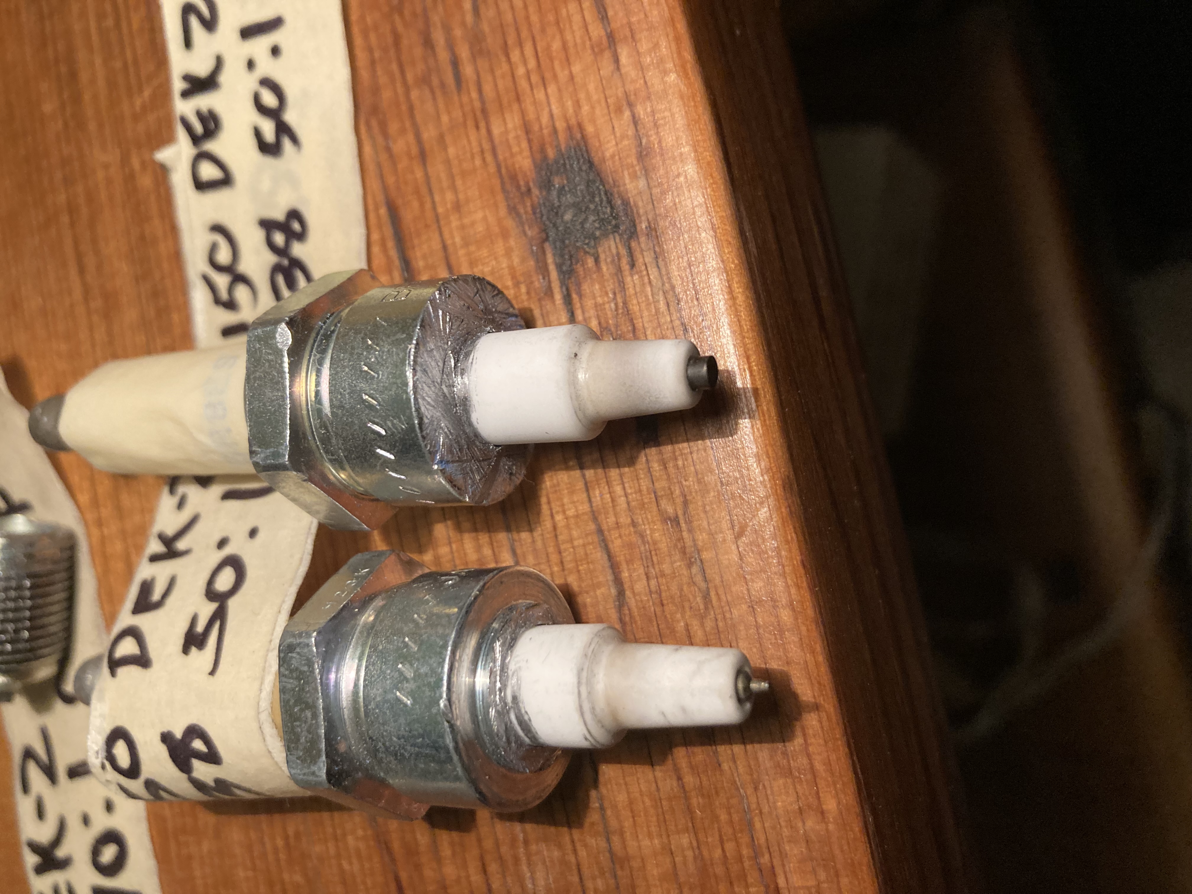

Here’s the latest plug chop with a BR8ES plug (on the right, BR7EIX on the left for reference). Same setup on both plugs with about 15°F warmer ambient temps for the 8 range plug on the right.

Wow. That looks too lean to me.
In general riding, how often are you revving the heck out of it?
Did you take the pipe off and clean it before starting the plug chops and jetting? If it was rich for a long time, the oil was still in the pipe and spark arrestor.

Yes, very lean.

I did not remove the expansion chamber before this process. I do a fair amount of slow wheelies & pivots, so it should help evacuate some residual spooge. I did have the silencer off the other day to install the exhaust joint sleeve- nothing was dripping out of it.
For what it’s worth, I’ve been running this exact jetting or something very similar to the 40,150 setup the RB carb comes with for quite a while now- the main thing that I’ve changed recently is using 50:1 fuel instead of 40:1.
I don’t rev the bike to the moon very often, but it was hard on the pipe heading out to the fire roads for a plug chop just before I snapped that pic of the plug I’ve been running. I think that plug has about 2 or 3 hours on it- mostly in the woods
You guys think it’s too lean despite the full ring of black around the base? I could fatten up the main another step or try raising the needle a notch. I’m hesitant to mess with the pilot as the bike starts well hot or cold, idles perfectly and runs crisp in that throttle range.

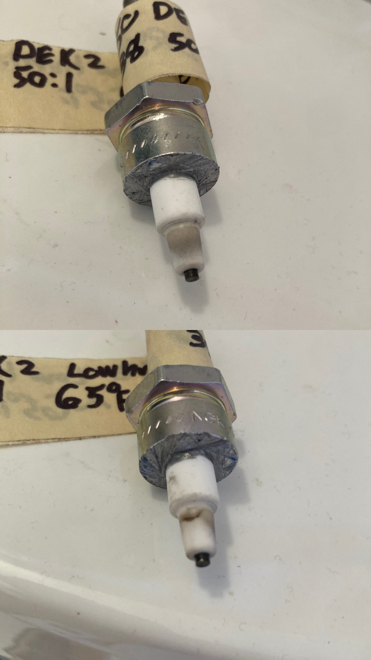

Here’s a pic of both sides of the most recent plug chop with decent lighting

My jetting and plug chop saga continues on, but I just wanted to address the topic of this thread once more for posterity and say that despite increasing my main jet size incrementally, my spooge production has dropped off dramatically since switching to a 50:1 mix. So yes, jetting is very important, but i couldnt lean the fueling lean enough to stop the spoo. Less oil was the key for me. I believe the 50:1 mix is less heavy than the 40:1 mix and therefore atomizes better resulting in a more complete burn.
I'm not advocating that anyone run less oil, but if you're struggling with a silencer that looks like an environmental disaster, it could be worth trying a different mix ratio and then re-jet accordingly :supz:
