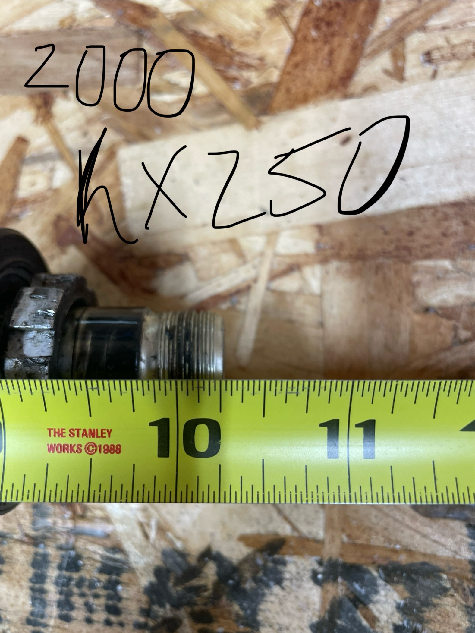

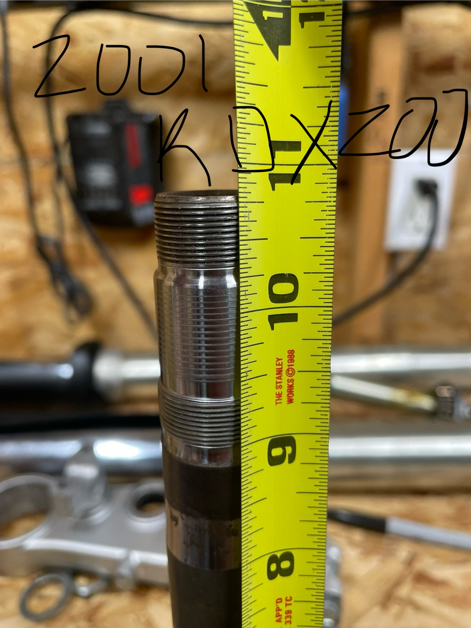

Alright. I’ll do my best to explain this. First off, the measurements aren’t 100% accurate because the stems are still pressed in, but fairly close. Both stems are measured on their total length. KX250: ~266mm. KDX200: ~292mm.
However. When both stems and triple clamps are stood on the bench, the inner race of both bottom bearings are parallel. So, when stood on end, the taper for the upper bearings line up almost exactly and the threads for the bearing retainer nut line up. This just leaves the upper threads that don’t align as the KX stem is about a 1/2” shorter.
If those measurements aren’t helpful, let me know and I can re-measure. So, will it work? Idk. I’ll mock it up on the KDX this weekend when I get the front end off.

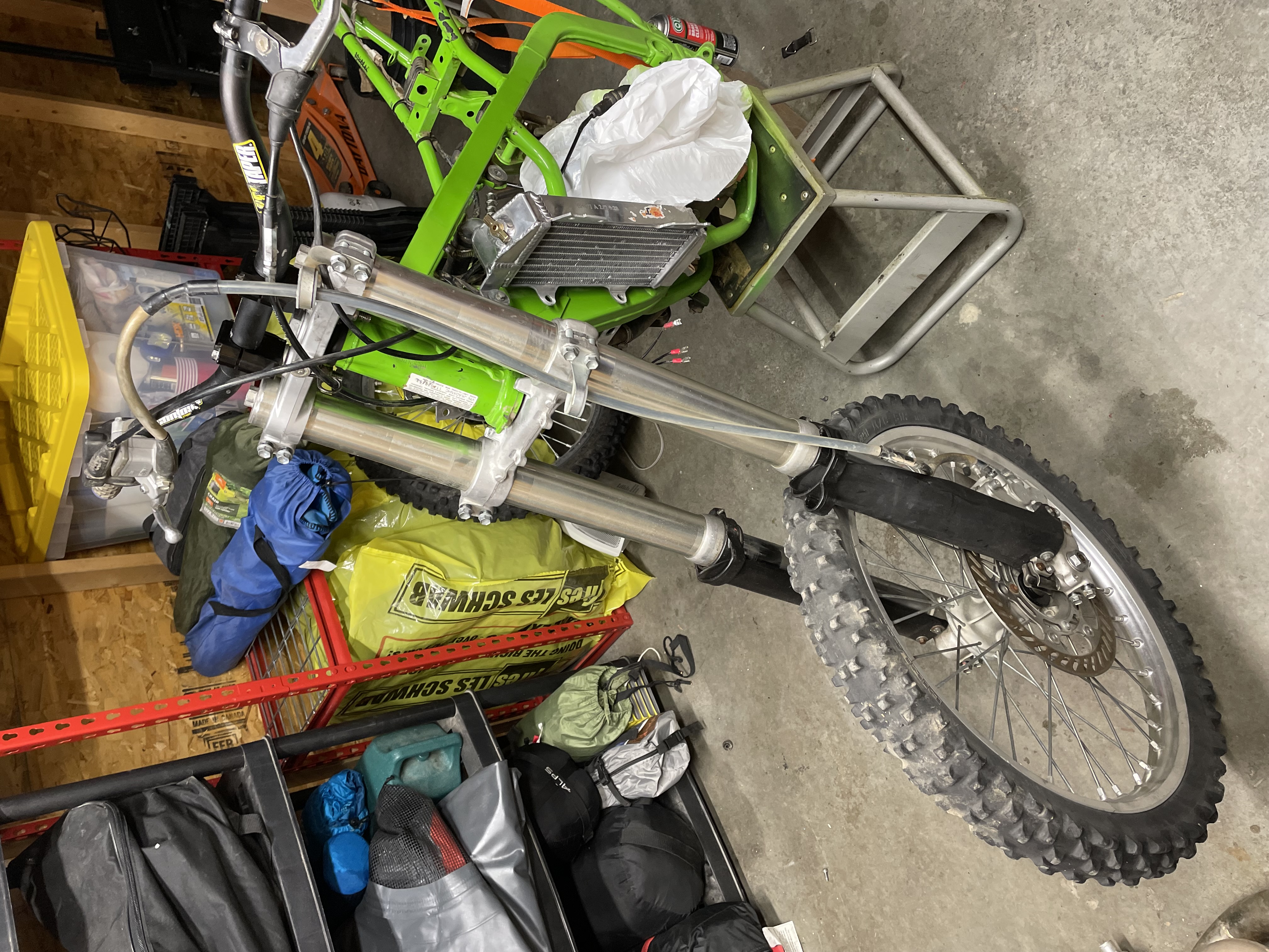

Well, I got the front end off the KDX last night. The bearing races were mint, very happy about that. With the KX stem on the bike and visually looking at how things line up, this is looking very promising. More to come once that bearing shows up.

It’s good news!! With the 28x47x15 bearing the KX front end becomes a direct bolt-on. I re-used the KX lower bearing as it was in good shape. There’s no slop, play, or loose-ness either up/down or side/side. Steering is smooth with no binding. No washers or spacers needed. I used the KDX dust seal, everything else is KX. If anything, the top nut doesn’t thread quite all the way on, but nothing a little blue loc tite can’t fix. Obviously, the bearing is the product of a certain Asian country, so time will tell if it holds up. Seemed to be of decent quality though. It’s not completely bolted together as the forks need to be rebuilt. But here’s the proof.

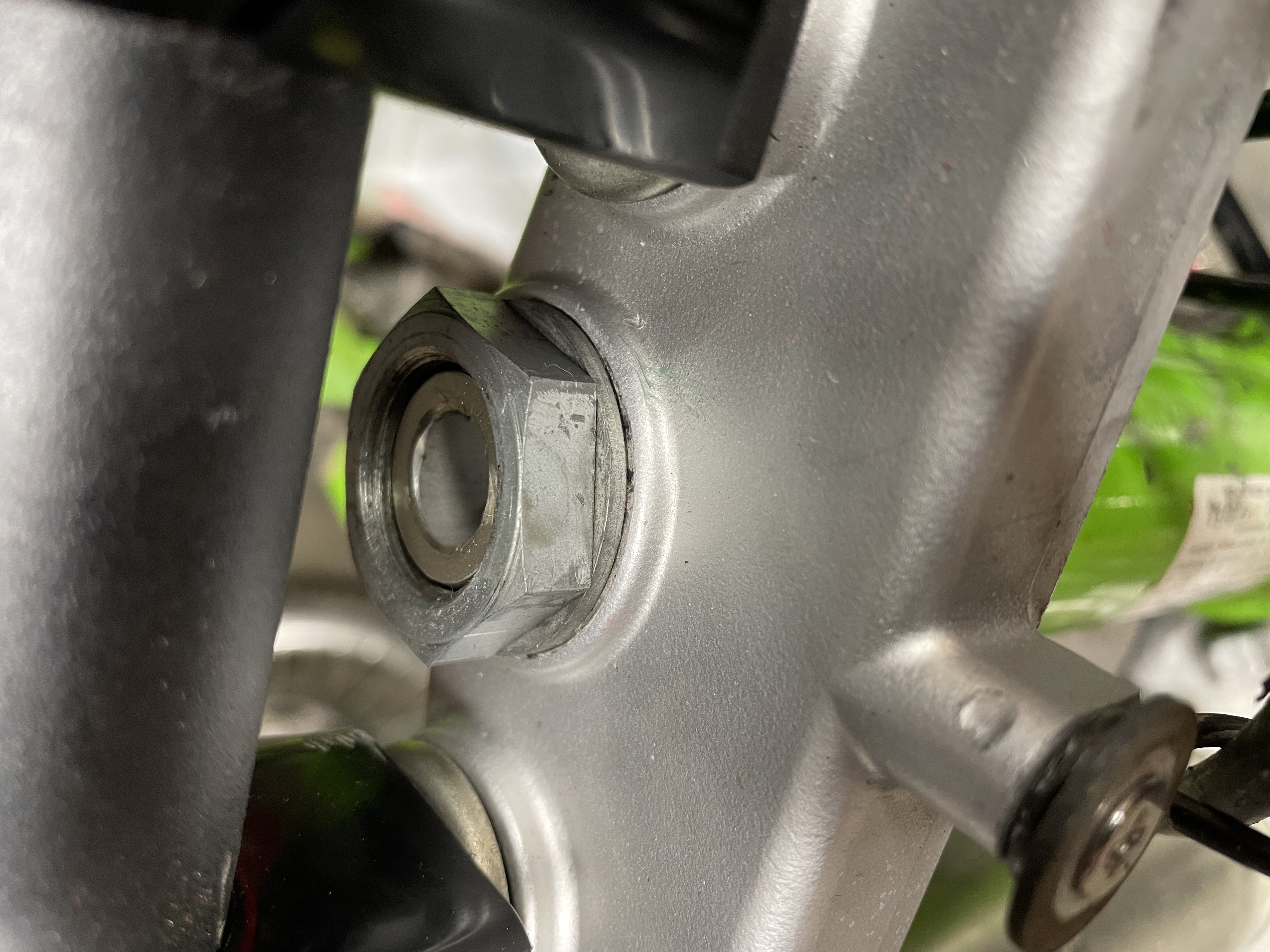

I suspect I’ll get more engagement on the top nut after one change. The ID of the dust cap causes the bottom nut to rest on top of it when tightened down. Thickness of the dust cap is about 1mm. I should be able to open the ID up and then the bottom nut will tighten directly onto the bearing (please correct me if this is a bad idea). That will then lower the whole assembly and top triple and I should be able to get full engagement of the threads on the top nut.

Bz1hx wrote: 09:02 am Mar 20 2025 I suspect I’ll get more engagement on the top nut after one change. The ID of the dust cap causes the bottom nut to rest on top of it when tightened down. Thickness of the dust cap is about 1mm. I should be able to open the ID up and then the bottom nut will tighten directly onto the bearing (please correct me if this is a bad idea). That will then lower the whole assembly and top triple and I should be able to get full engagement of the threads on the top nut.
Sounds good, but make sure you keep it perfectly concentric and make sure that the seal will still have pressure on it keeping it forced downward into the bearing and against the frame, so perhaps this is not a good idea considering that last bit. I'm not sure what the nut is shaped like if it has an integrated collar/sleeve below it like the KDX stem beearing nut does.

The lower nut on the KX is just a splined nut. No collar. I’m sure I can trim the dust shield without causing an issue. I’ll work on it and report back.

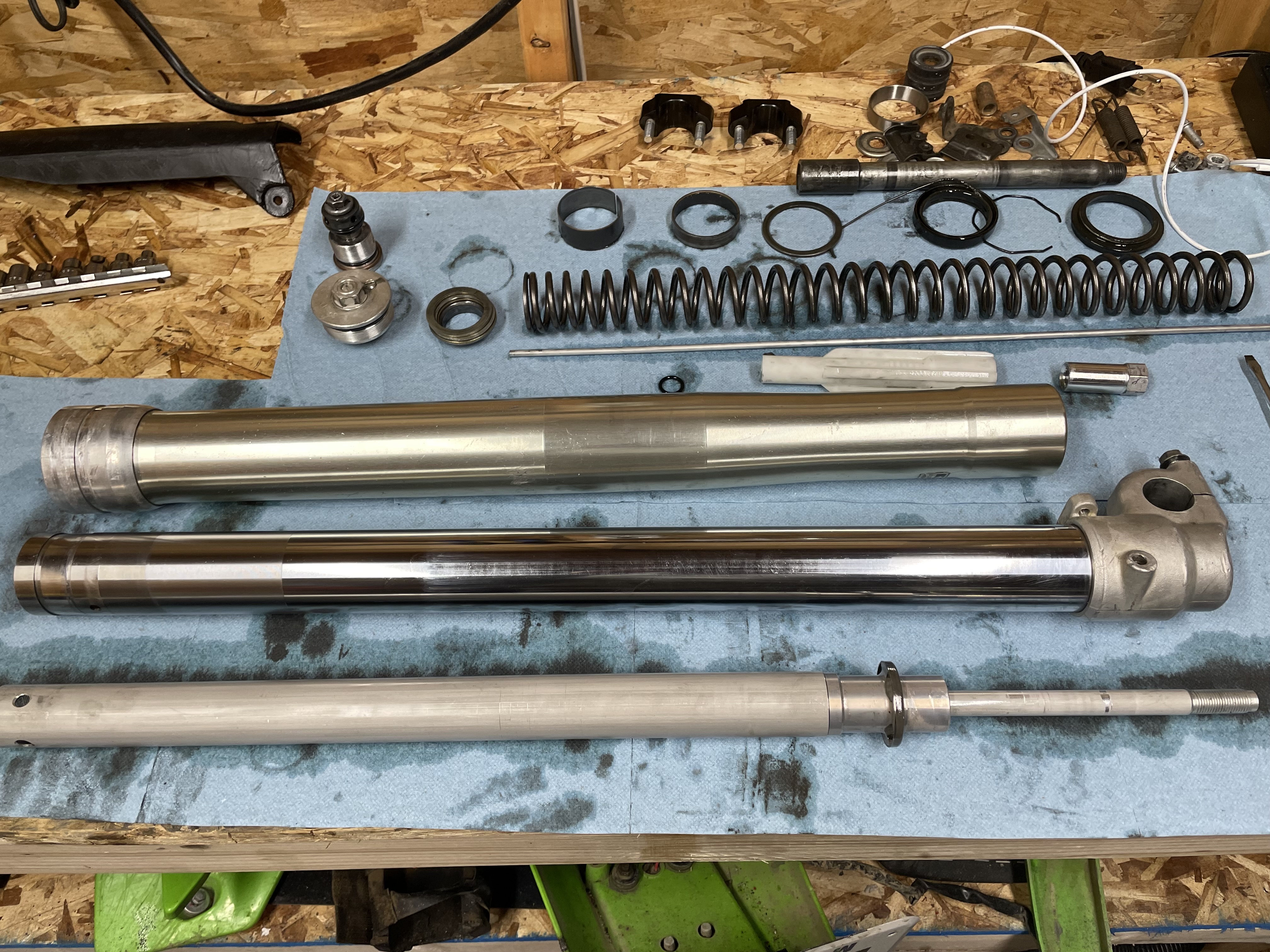

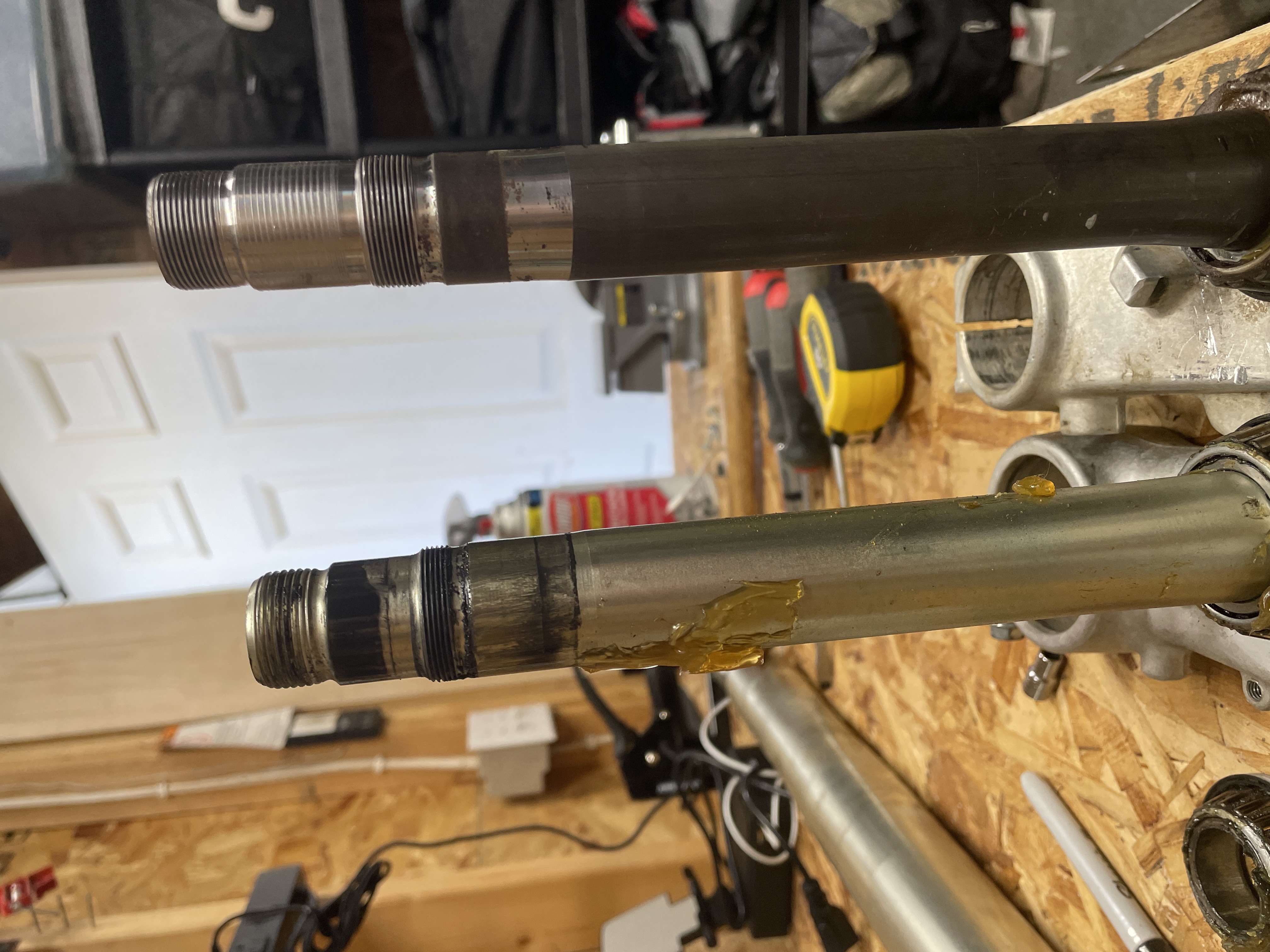

Finally got the new forks taken apart, cleaned up, and rebuilt today. They were NASTY inside. Much better now. I did find something interesting though. I don’t think these forks had been messed with in the past (perhaps never even rebuilt). I was expecting to find bladders inside the forks, but there were none. No evidence that they were there in the first place. I’m wondering if the forks I have are even KX forks to begin with? Bit of research and it seems that YZ forks of this era are not bladder forks. Perhaps they had been swapped in the past. Any input is helpful.

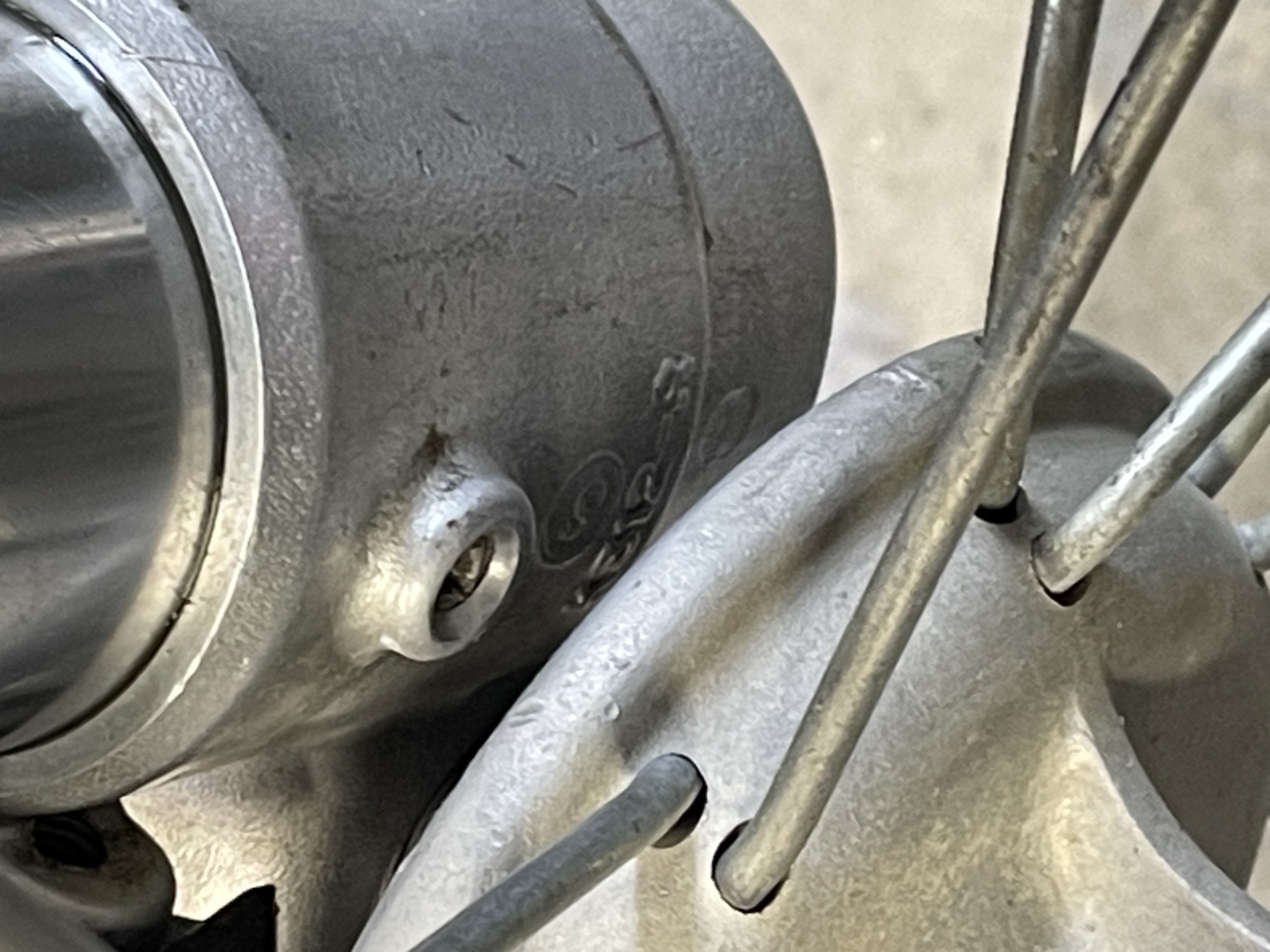

Posted: 01:39 am Apr 13 2025
Look on the fork lugs for stamping and report back, hopefully with pics. Thanks.

I've never seen bladders on the KX forks I've used, '96 KX125 KYB 46mm, '03 KX250 KYB 48mm, and '06 KX250F Showa 47mm.
Re: ‘00 KX250 Swap Items
Posted: 03:35 pm Apr 13 2025
by Bz1hx
SS109 wrote: 01:50 am Apr 13 2025 I've never seen bladders on the KX forks I've used, '96 KX125 KYB 46mm, '03 KX250 KYB 48mm, and '06 KX250F Showa 47mm.
Based on my research those years you used don’t have bladders. 99-02,04 are bladders forks. https://www.vitalmx.com/forums/Race-Sho ... ry,1247349

Yes, they are progressive springs. Wound tighter at the top vs bottom. The only stamping I can see is K312-R on the right fork. Difficult to see but that’s what it says.

I looked on eBay and saw a couple with the same digits. I would assume someone already took all that out. I think the 2000 did come with the progressively wound springs. They were not well liked.

I saw the same thing online. Must have been removed at some point. I’m going to do what I can to make these forks “woods friendly”. For now, I’m just going to ride them as-is and then start making changes, starting with the base valve.
