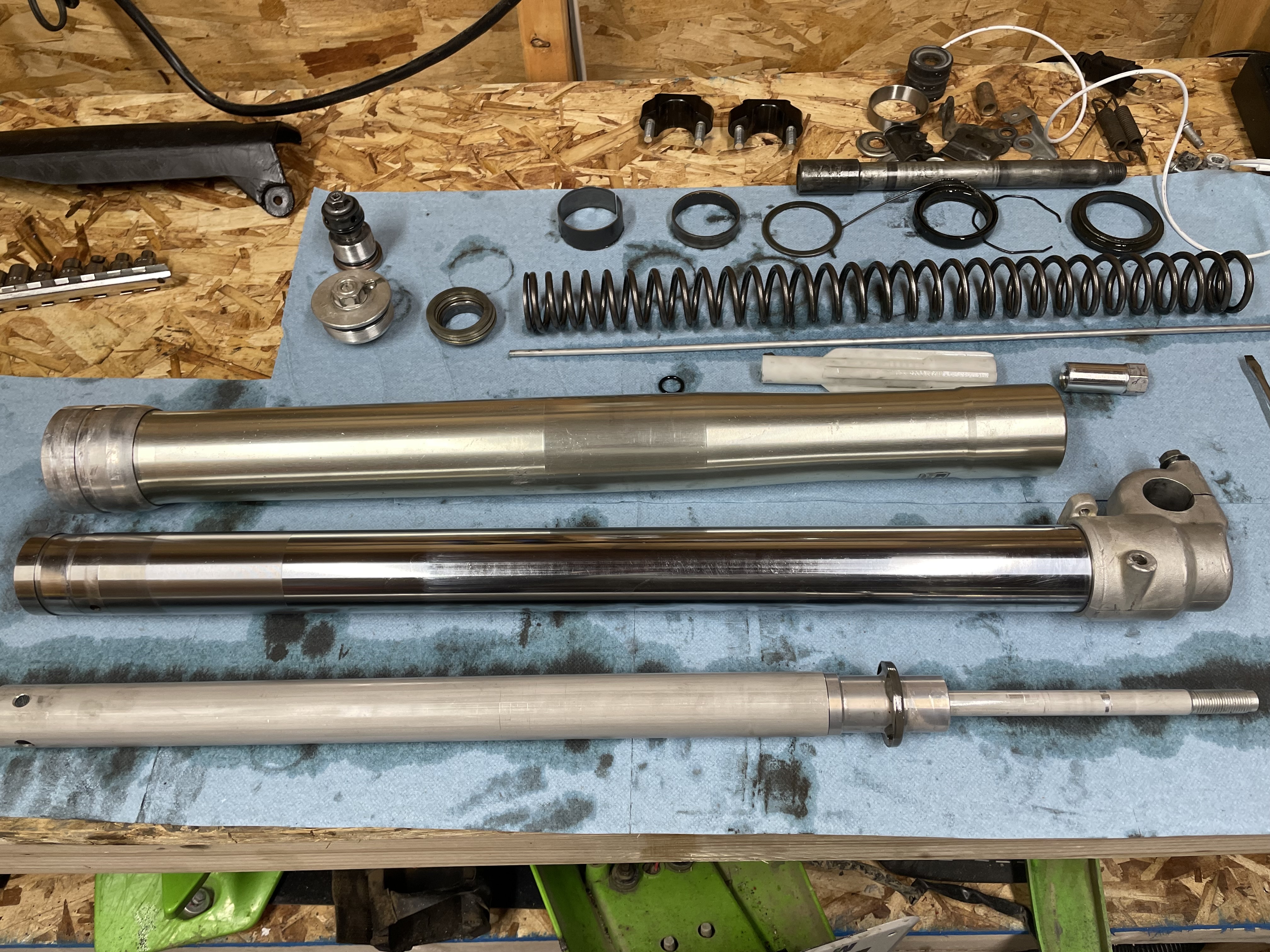

Finally got the new forks taken apart, cleaned up, and rebuilt today. They were NASTY inside. Much better now. I did find something interesting though. I don’t think these forks had been messed with in the past (perhaps never even rebuilt). I was expecting to find bladders inside the forks, but there were none. No evidence that they were there in the first place. I’m wondering if the forks I have are even KX forks to begin with? Bit of research and it seems that YZ forks of this era are not bladder forks. Perhaps they had been swapped in the past. Any input is helpful.

Re: ‘00 KX250 Swap Items
Look on the fork lugs for stamping and report back, hopefully with pics. Thanks.
EDIT ADD ON: Are the springs progressively wound?

I've never seen bladders on the KX forks I've used, '96 KX125 KYB 46mm, '03 KX250 KYB 48mm, and '06 KX250F Showa 47mm.

Based on my research those years you used don’t have bladders. 99-02,04 are bladders forks. https://www.vitalmx.com/forums/Race-Sho ... ry,1247349SS109 wrote: 01:50 am Apr 13 2025 I've never seen bladders on the KX forks I've used, '96 KX125 KYB 46mm, '03 KX250 KYB 48mm, and '06 KX250F Showa 47mm.

Yes, they are progressive springs. Wound tighter at the top vs bottom. The only stamping I can see is K312-R on the right fork. Difficult to see but that’s what it says.KDXGarage wrote: 01:39 am Apr 13 2025 Look on the fork lugs for stamping and report back, hopefully with pics. Thanks.

I looked on eBay and saw a couple with the same digits. I would assume someone already took all that out. I think the 2000 did come with the progressively wound springs. They were not well liked.

I saw the same thing online. Must have been removed at some point. I’m going to do what I can to make these forks “woods friendly”. For now, I’m just going to ride them as-is and then start making changes, starting with the base valve.KDXGarage wrote: 07:26 pm Apr 13 2025 I looked on eBay and saw a couple with the same digits. I would assume someone already took all that out. I think the 2000 did come with the progressively wound springs. They were not well liked.
