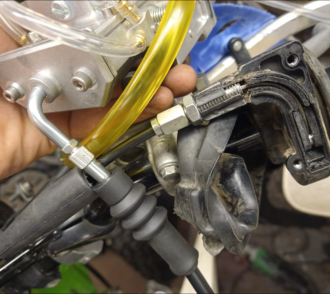

Here's a YZ125 owner's picture from ThumperTalk (test fit, there's a long return spring included thats not pictured):
On a KDX, shortest length 40° or 45° or up to 90° cable adjuster elbow is definitely almost mandatory as the tank sits so close to the carbs. That's how other members had designed cables for the older Lectron carbs in the earlier posts on this topic, custom cable with a 70° or 90° elbow.

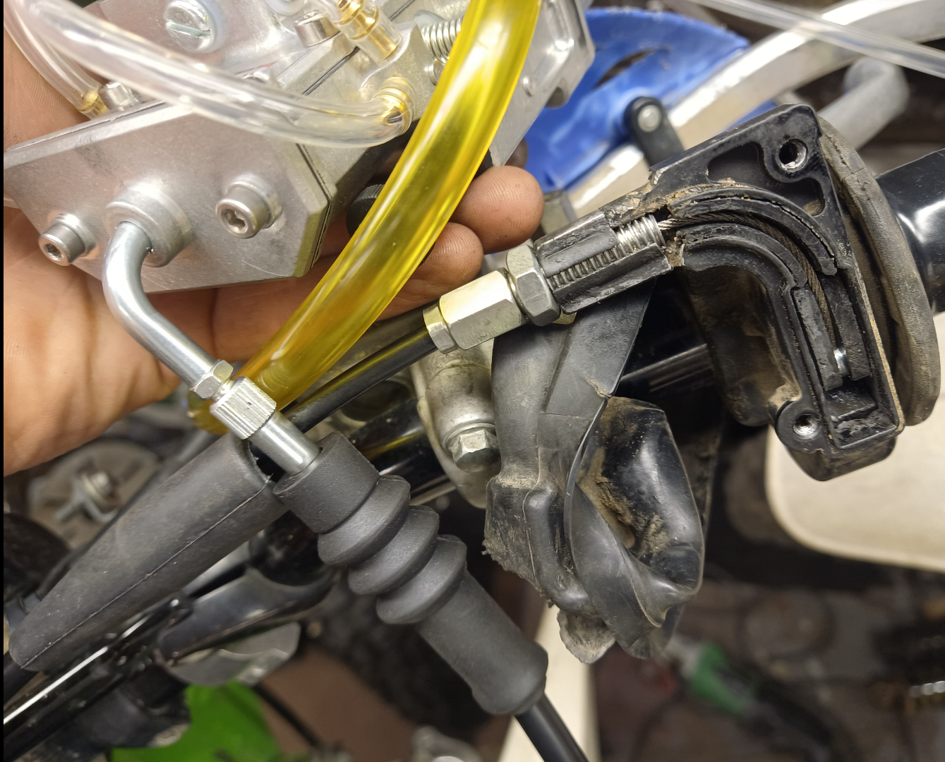

The Sudco 40° or 45° cable adjuster/guide hasn't arrived yet, but I put a brand new OEM Kawasaki '95-'06 KDX throttle cable into the Billetron Pro Series with the Malossi 90° cable guide threaded all the way in (with locknut still in place), & pieced together my broken OEM KDX throttle housing, and with the throttle housing end cable adjuster barrel also fully bottomed out into the throttle housing, I have *JUST ENOUGH* cable freeplay!
If I took off the locknut on the Malossi 90° short radius cable adjuster and bottomed the adjuster fully, I'd probably get enough freeplay to back out the throttle grip adjuster, which would be perfect. Although I didn't check this to see if the threads bottom out in the 90° elbow before that happens, that threaded adjuster end could be shortened up on a grinder and deburred if that were the case. Hopefully the Sudco 40° elbow adjuster comes in today or tomorrow and I can check to see if it has just a touch shorter length to it (I'm fairly certain it does).
Also note that new cables tend to stretch after a bit of use, so this might help as well with a bit wider margin.

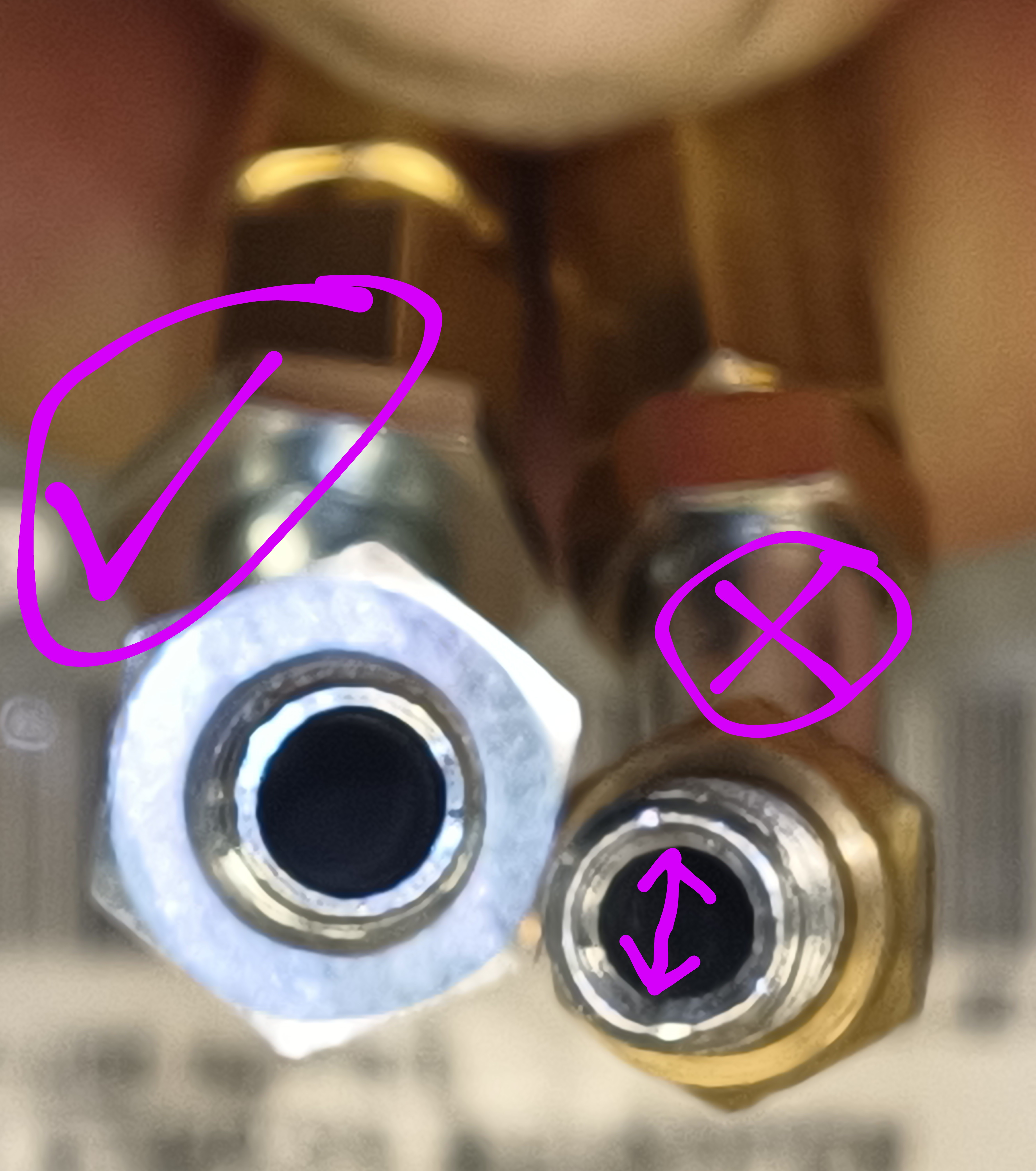

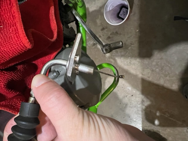

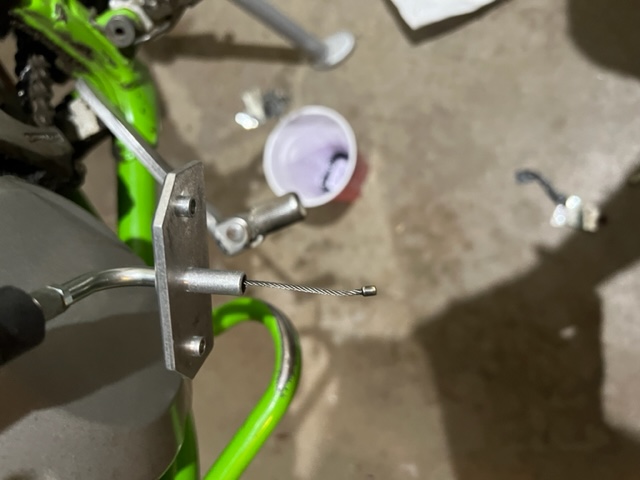

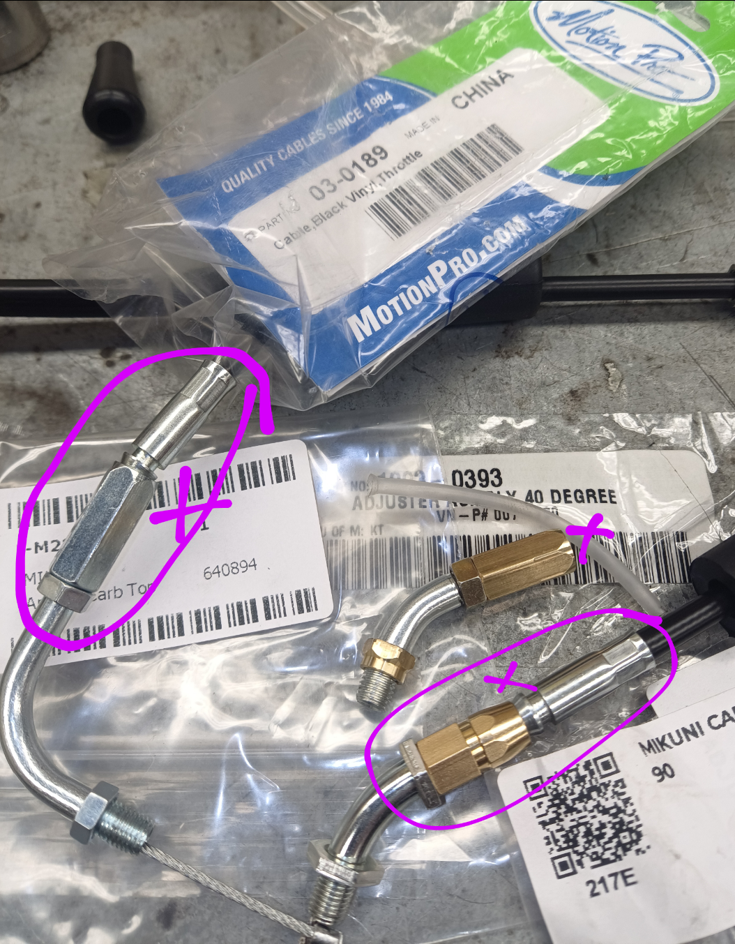

Well... I got the Sudco 40° elbow adjuster today, which looks nearly identical to the Niche Supply 40° cable adjuster elbow, but is of SUBSTANTIALLY higher quality immediately noticeable, and the inside diameter of the tubing is full diameter with no tubing seams or burrs that need reamed out on the ends. The Keihin cable actually fits through!!!
Well, then I made an unfortunate discovery... The OEM Kawasaki KX and KDX cables have a clip-in style interface into the top cap of the Keihin carburetors. I only tried the shorter of the cable guide adapter elbows, and since the Niche Supply 40° Keihin elbow wouldn't even fit a Keihin cable due to poor manufacturing quality, I only tried the Malossi short 90°... Which does in fact just barely work as far as stock KDX cable length with stock KDX throttle thankfully!
BUT... the other three that I bought don't work at all!
It's a simple modification, just drill out the end of the adjuster barrel on the Sudco 40° elbow guide slightly larger to fit, but I was really trying to find the simplest most straightforward bolt-on & off-the-shelf way to fit these so that everyone can easily do this upgrade... And was hoping to use OEM Kawasaki cables, KDX or worst case KX... Still easily doable, KDX cable + Malossi 90° cable adjuster elbow minus the lock nut & barrel bottomed out just makes it as far as cable stick-out length versus cable housing length, or perhaps the Sudco 40° elbow with end drilled out to fit, although with the long crimped on steel end on the Kawasaki cable housing, this still puts it tight to the tank...

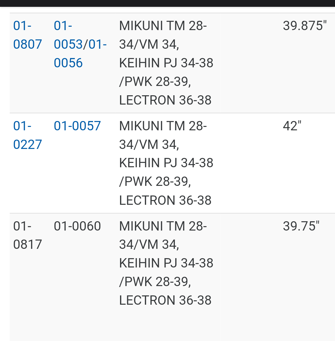

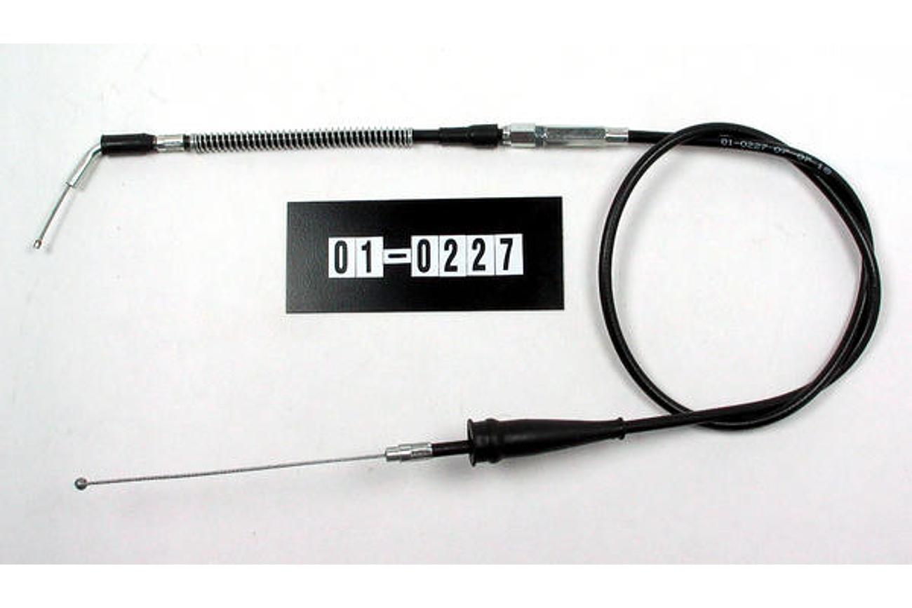

I happened to see that Motion Pro had Universal and Custom cable links in their menu... I was pleased browsing these universal cables' links for photos,
but then I came upon the chart that specifically showed 3 different length cables for Keihin, Mikuni, and LECTRON carbs!

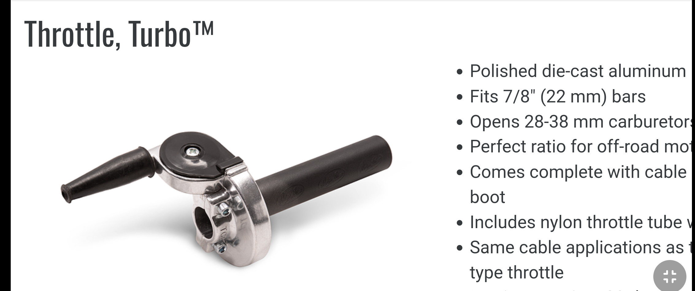

AND.... The cable already has a 65° or 70° elbow on the carb end!!! AND FOR $19.99 RETAIL PRICE!!! smh...
It's recommended to use their Turbo throttle with it (the extra cable length is specifically made to run the nicer pulley style throttles), although an OEM used KX 2-stroke throttle would also work I believe. Their throttles are VERY affordable, FYI, with the Turbo throttle retailing at $29.99... basically a remake of Gunnar Gasser & Whirpull throttles.

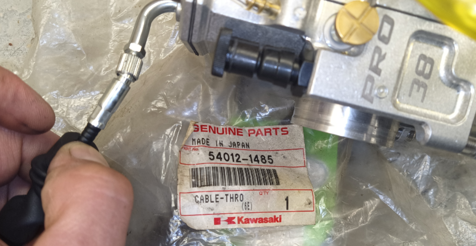

Now I'm really banging my head against the wall, again! I've been test fitting everything with a brand new 54012-1485 Kawasaki KDX OEM cable that I've been keeping in my crate of spares / premix oil / etc that I always take to the trails with me.
I then go and look at the OEM appearing cable on my stock 220, to see how well it makes the bend from the top of the PWK33....
WHAT THE $#@&!?!
There's a metal elbow on the thing!?! How'd I miss this?!?! I'm not sure if this is even OEM...???
I'll just go right out and blame too many late nights and too much to do... on both accounts, of missing this variation of the stock cable with a steel elbow, and also not noticing the Lectron Universal cable fitment on the Motion Pro site...
No clue what the origins of the currently installed elbow-end OEM-appearing cable are, I've tried searching eBay and the OEM Kawasaki parts fiches.... Zero clues anywhere...
So here it is, stock cable Kawasaki # 54012-1485 straight end + stock KDX throttle + Malossi short radius 90° cable adjuster elbow,
https://www.lucky2strokes.com/90-Degree ... ndy_90.htm
-or-
Motion Pro Universal Lectron cable
+ Motion Pro Turbo throttle (Gunnar Gasser / Whirpull reproduction)
-or- the fancier revision the Motion Pro Turbo SE throttle for double the price...
https://www.motionpro.com/product/01-0227
https://www.motionpro.com/product/01-0057
-or- $$
https://www.motionpro.com/product/01-2813
And don't forget that the Billetron carbs fit an H-Series KDX a lot better WITH the Moto Tassinari VForce3 or VForce4 reed cage assemblies or Boyesen RAD Valve intake/reed blocks! Big upgrades over stock... Boyesen wins it for me over quality construction (machined from a solid chunk of billet aluminum) although the VForce3/4 may perform marginally better, but are made from plastic... Most love 'em but others say especially in mountain riding where you may see drastic temperature changes and do hot engine taxing slow climbs up to high elevations where temps get quite cold, they have been known to crack from the drastic temperature swings and hot engines getting shocked with cold mountain air... My VForce3 has dine great for 3 years of 700ft - 5,000ft elevations though!

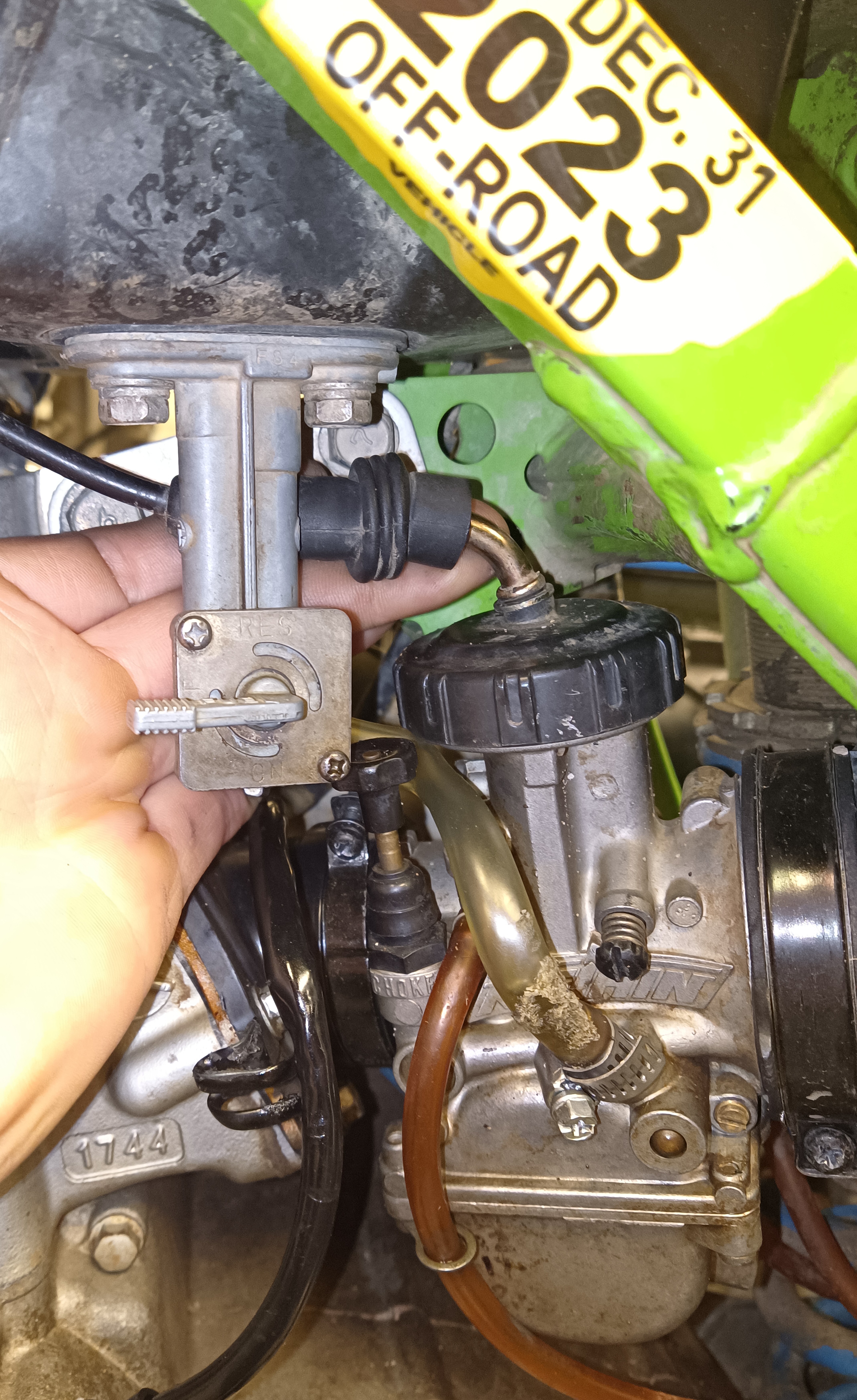

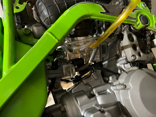

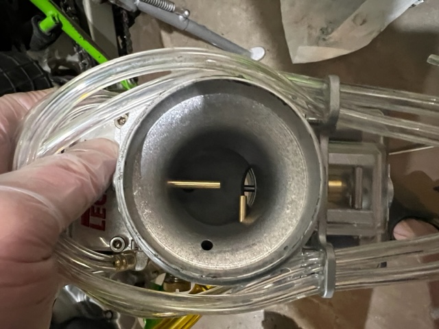

Thanks for the update chuck, I did get my billetron in the reed and intake boot today, seems to fit nicely. It does sit a little cockeyed but not to bad. I heard from someone else that their billetron for the KDX shipped with a 90* elbow so I reached out to Lectron to see if they will send me one for free. otherwise I might just spend the $50 and get a new cable and throttle from Motion pro.
For tank petcock I did get the lower one that you recommended, should work but it might get close to interfering with the throttle cable.

Got the 90* from Lectron, going to install tomorrow. Ill try and snap some photos as well as get some video of the install/running.
- Posts: 39
- Country: Us
- Location: Fargo
Re: new Lectron Billetron Pro Series fitment on KDX200 / KDX220
Here is the 90* from lectron with the stock KDX cable pretty much all the way out.
- IMG_2699.jpg (136.35 KiB) Viewed 31329 times
- Posts: 1167
What about your throttle tube side adjuster?
That's odd as it looks to be a different amount of cable than what I've got on my new OEM KDX cable
Video with brand new OEM KDX H-series cable and stock KDX throttle:
https://photos.app.goo.gl/2RXs3EBZekBGdEVY9
Kevbot, I could ship you a KX cable if all else fails, as long as you don't have terribly tall bars or risers.
- Posts: 39
- Country: Us
- Location: Fargo
I did bottom the cable out, I think think the 90* from lectron is longer than the one you are using because its close for the slide to bottom out.
Also the stock petcock seems to interfere with the choke, I have the yamaha one to replace it so will try that.
- choke.jpg (126.87 KiB) Viewed 31289 times
- throttle 1.jpg (117.9 KiB) Viewed 31289 times
- throttle 2.jpg (77.27 KiB) Viewed 31289 times
- throttle 3.jpg (120.33 KiB) Viewed 31289 times
