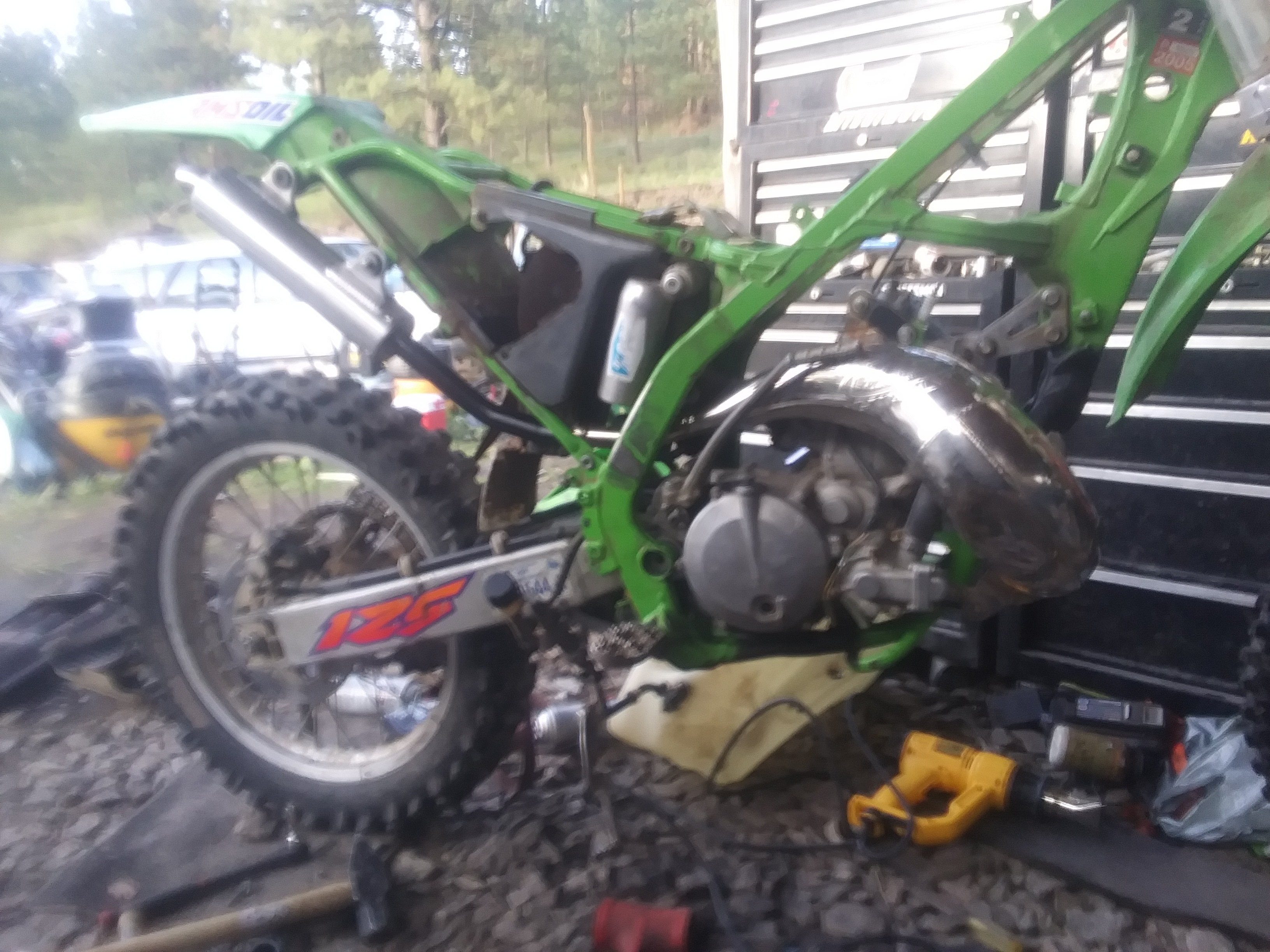

Re: A path less travelled 97 kx125
Other than upper pipe mount tab, got the exhaust sorted out. Also started on bending up the desert tank...loads of fun there...

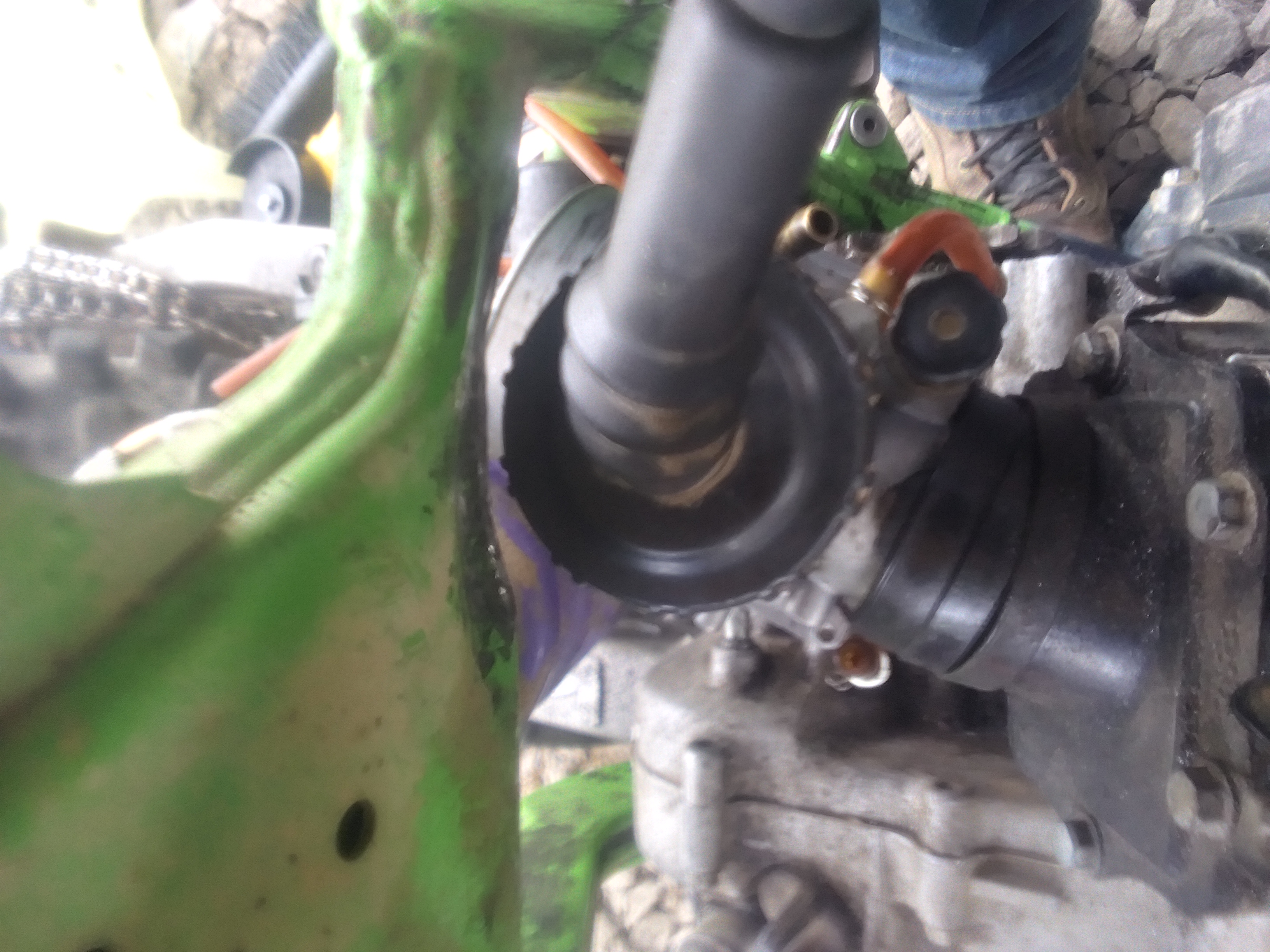

Started on the carb fitment. I removed the kx air boot, and cleaned the box up a bit. Everything's still pretty dirty from the desert...stuffed the carb, and kdx air boot in place. The pics will show what I was talking about before.
Befftester: Yes, the wiring, and radiators are going to be super easy. I'll have to check your build out again. It was in the back of my mind when looking at stuff, but couldn't remember who...Also, what about a 250 boot?
If you use the KDX boot you should be golden. Plenty of room on that to get the clamp on.

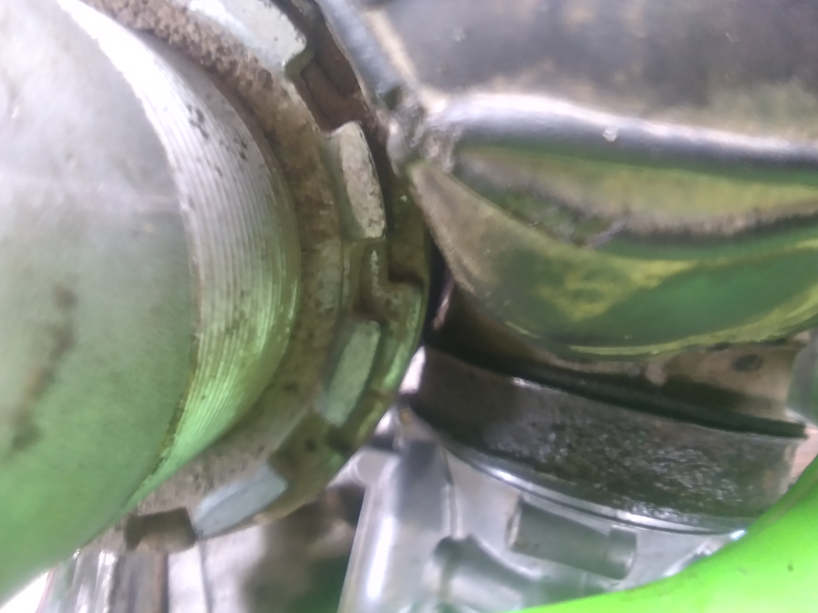

That's the kdx boot with full shock extension. Once I stepped on the peg, it was just fine...And yes, the carb is hitting the frame. Had something come in the mail though...

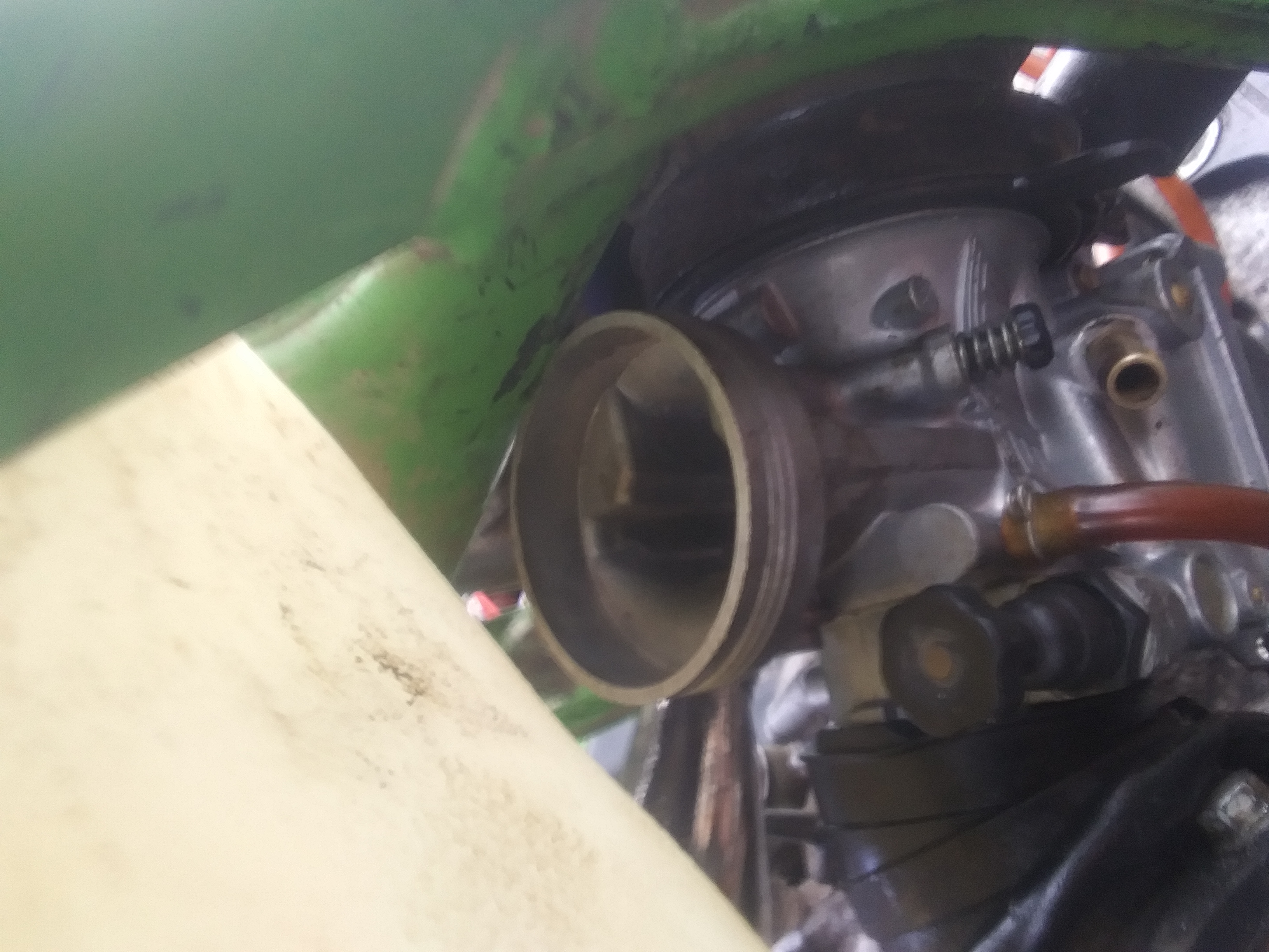

The carb now fits, with the cap. I just relief cut the frame, and shaped it with a hammer. Now I need to bend the tank a little, for the throttle cable. Almost done with all the welding, I think. Exhaust tab, carb spot, and possibly the upper coil mount, if I use the kdx coil.

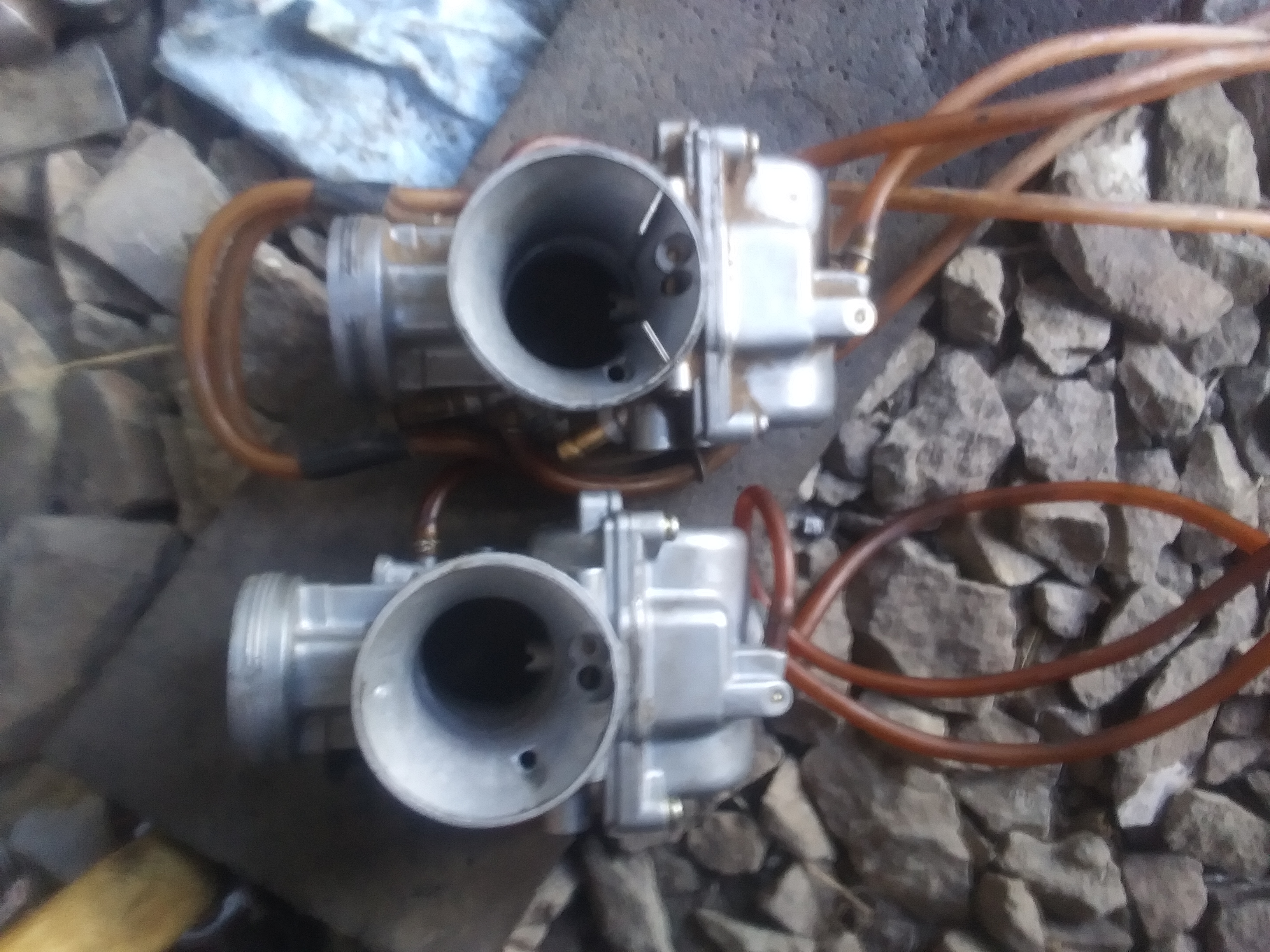

Here's a question: What carb should I run? Left is 00 kdx200, and right is 97 kx125. Both drop in place...not sure if one is better than the other.
# on side of the kx is G275 AKHM.
