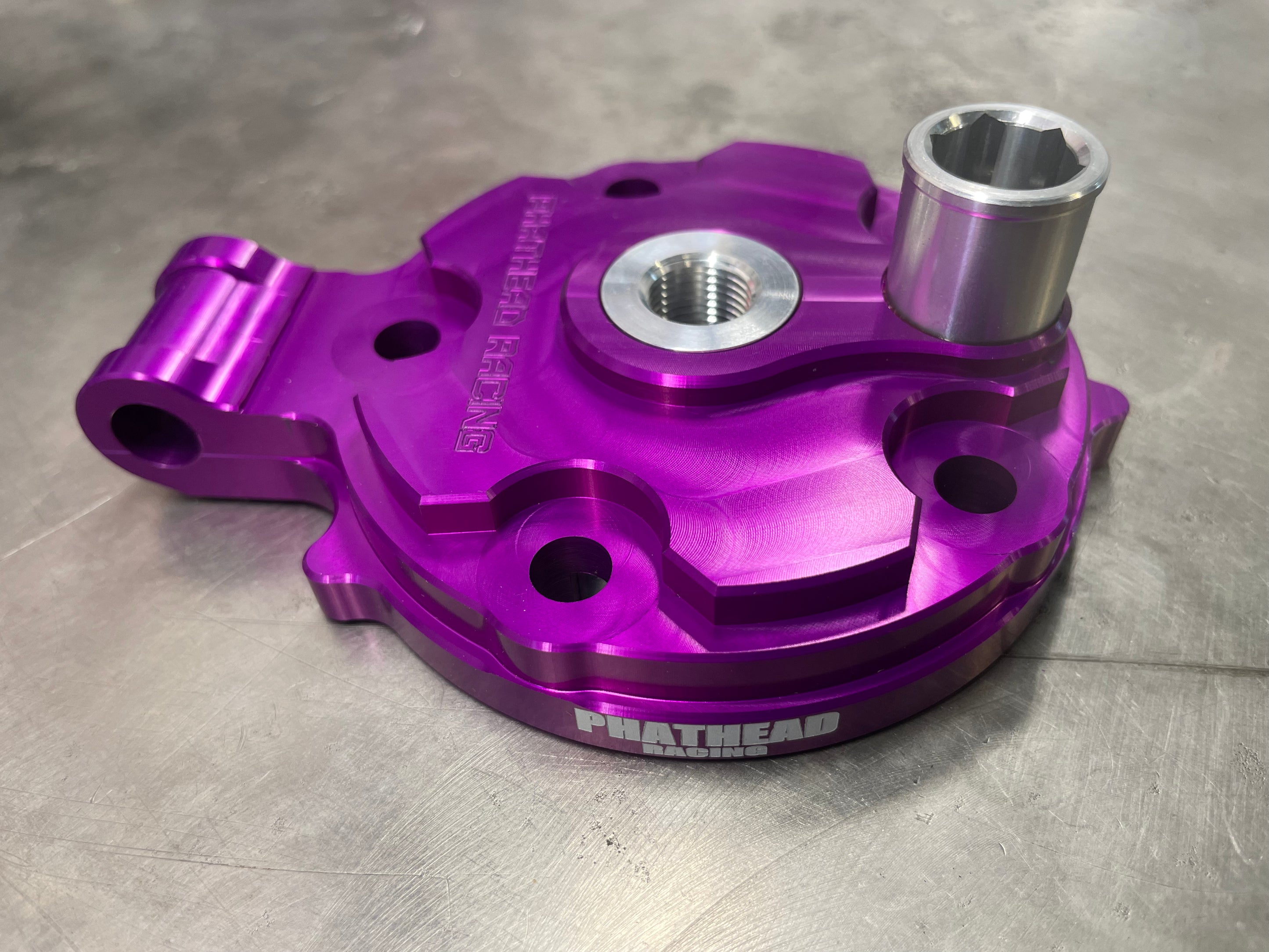

I just checked out '96-'98 vs 1999 vs 2000 vs 2001 KX125 cylinder heads, with some interesting findings, significantly different tunings each year.
The 1999 KX125L1 cylinder head looked like a KDX220SR, with a VERY WIDE squish band and small dome. The street legal KDX220SR was designed to run lower RPMs.
The 2000 KX125L2 cylinder head looks to have a squish band width similar to a KDX220R (medium to slightly wider, for a very strong mid-range and a decent bit of low torque),
The '97 ('96-'98?) KX125K4 had had a fairly wide squish band about the same size but perhaps just a bit wider than the 2000 model KX125L2, but not nearly as wide as the extra-wide '99 KX125L1. ***Update*** another one that I found that had the same casting number 1435 stamped into it, had a much wider squish band like the 99, but the first one that I looked at and initially commented on for the 97 came from a bike with a Tom Morgan Racing sticker on the fork, so I'm wondering if this head was swapped for a 2000 head on a 97 model bike perhaps, as a tuning tweak? 96-98 share the same head part number though, on the Kawasaki diagrams.
whereas the 2001 KX125L3 seems to have a much narrower squish band width similar to a KDX200, and a larger dome to have slightly lesser compression, both to focus on more peak high RPM power.
Very interesting findings
I was thinking I might just try and snatch up a 2000 cylinder and head if I find a good deal, and then I could run any model year 99-02 if the crankcases are same on 99, but now I'm seeing that there are a lot of options of mixing cylinders and heads, but the 96-98/99/00 heads would be the ones to run for low and mid-range power....
Some of the years would need more extensive cylinder base milling and cylinder porting work for woods torque, where the 2000 would need only a basic port clean up and boring to 134cc/56mm.
The 2001-2002 can run the same Wiseco piston as the 03 and up, and have the semi custom off-the-shelf Wiseco 144cc 58mm pistons available.
So really for my goals, modified 96-98/99/00 head bolted up to a 2001-2002 cylinder with whatever crankcases I'm running port matched to the cylinder I'm running, cylinder bored to 144cc, might be the best option, although requiring more cylinder base milling to get the port timing back down for low-mid torque... That extra 2mm bore to add 10cc extra definitely sounds appealing.... As do custom KDX144R swingarm graphics!

I was browsing a bit today and noticed that Phathead Racing happens to make a bunch of heads for the KX125's '98-'00, '01-'02, & '03-'08, with 4 different inserts available for each head generation, mostly differing in volume / compression / required fuel octane.
and... THEY COME IN PURPLE ANODIZED!!!!
(as well as a few other colors Gold, Black, Blue etc)
https://phatheadracing.com/search?q=KX125
They don't list anything but stock bore, but Luke @ Phathead / Luke's Racing said they can do any custom setup possible within reason, and said that the stud spacing is too close on a 144cc overbore on 94-02 KX125's to be able to use an o-ring'ed head like all theirs generally are, and you must use a stock type head gasket if doing a custom 144cc bore head insert.
In addition to their different dome volumes advertised, they can do different squish band widths and bore sizes upon request, but these aren't advertised due to many variables and needing to consult at greater length with them.
He said on the redesigned 2003-2008 KX125 engines, a 144cc overbore is able to be o-ring'ed as their stock bore heads are.
The sole 144cc KX125 +4.00mm piston available (Wiseco) only shows fitment for the '01-'02/'03-'08 port configurations anyways, but it sounds like a 134cc Wossner piston setup is the best option of going with a '98-'02.
I still haven't found a smokin' deal on a bike needing rebuilt yet, but I'll be watching... I've got plenty of projects to keep me busy for years, but this pipedream keeps near the forefront of my immediate interests. A '98 is probably my primary interest, the older stylings but newer crank and rod length, newer cylinder compatibility with 98-00 bolting on with appropriate power valves, and '01-'02 fitting with some transfer port matching and the same year power valves.
