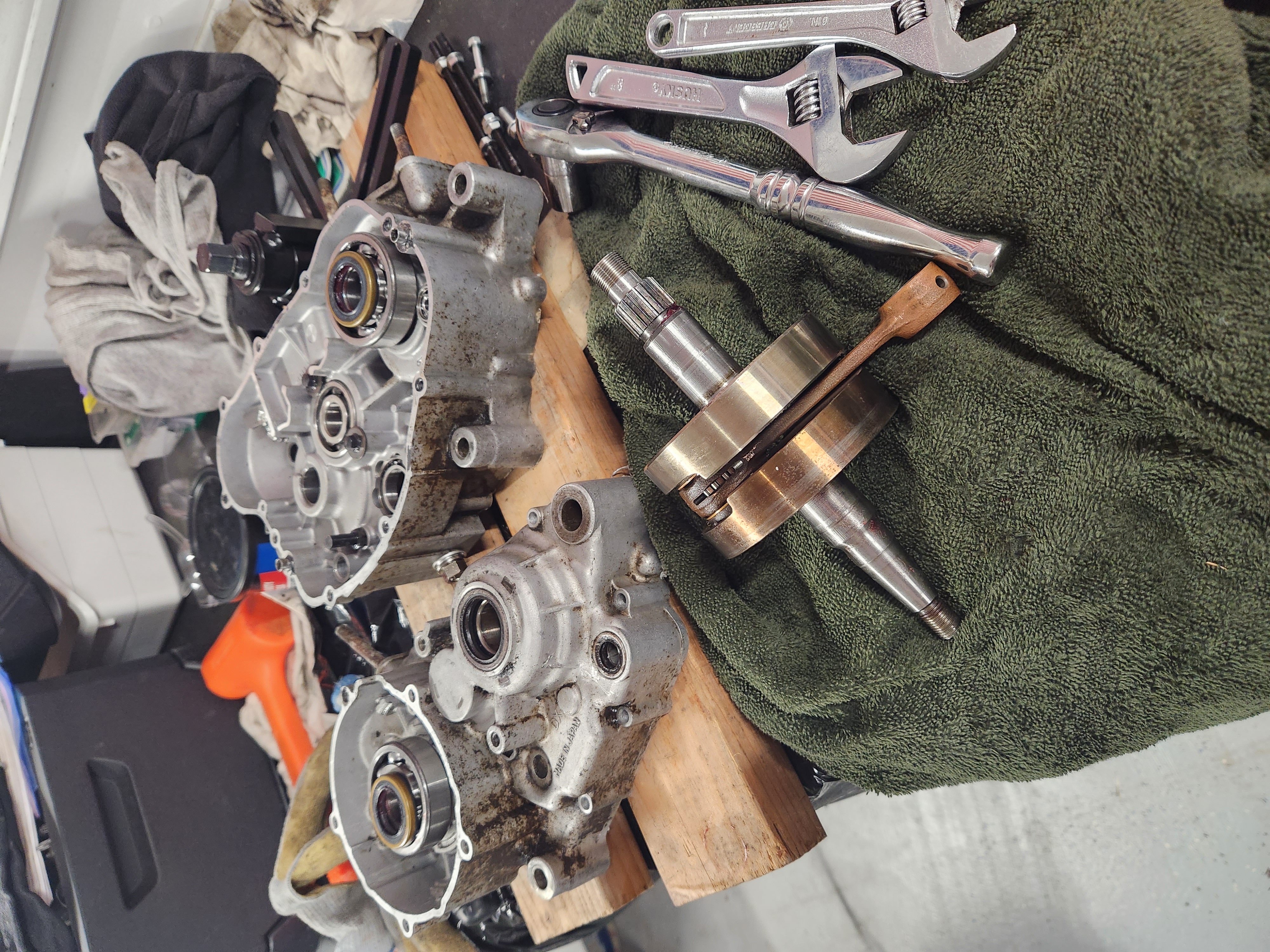

Damn seal lip folded over on me AGAIN. Just barely but I gotta get it perfect.
I greased the inner lip of seal and crank pretty heavily and still happened.
Not sure what to do at this point haha idk what I'm doing wrong
Crank is out. Going to try again soon.
Alright.....got crank in & that one seal/bearing is done & perfect.
Now we'll see bout the other seal when joining these cases! :rock:

Cases are back together and second seal looks excellent!
Hell yea!!!
Thanks everyone for the help!! I appreciate it very much.

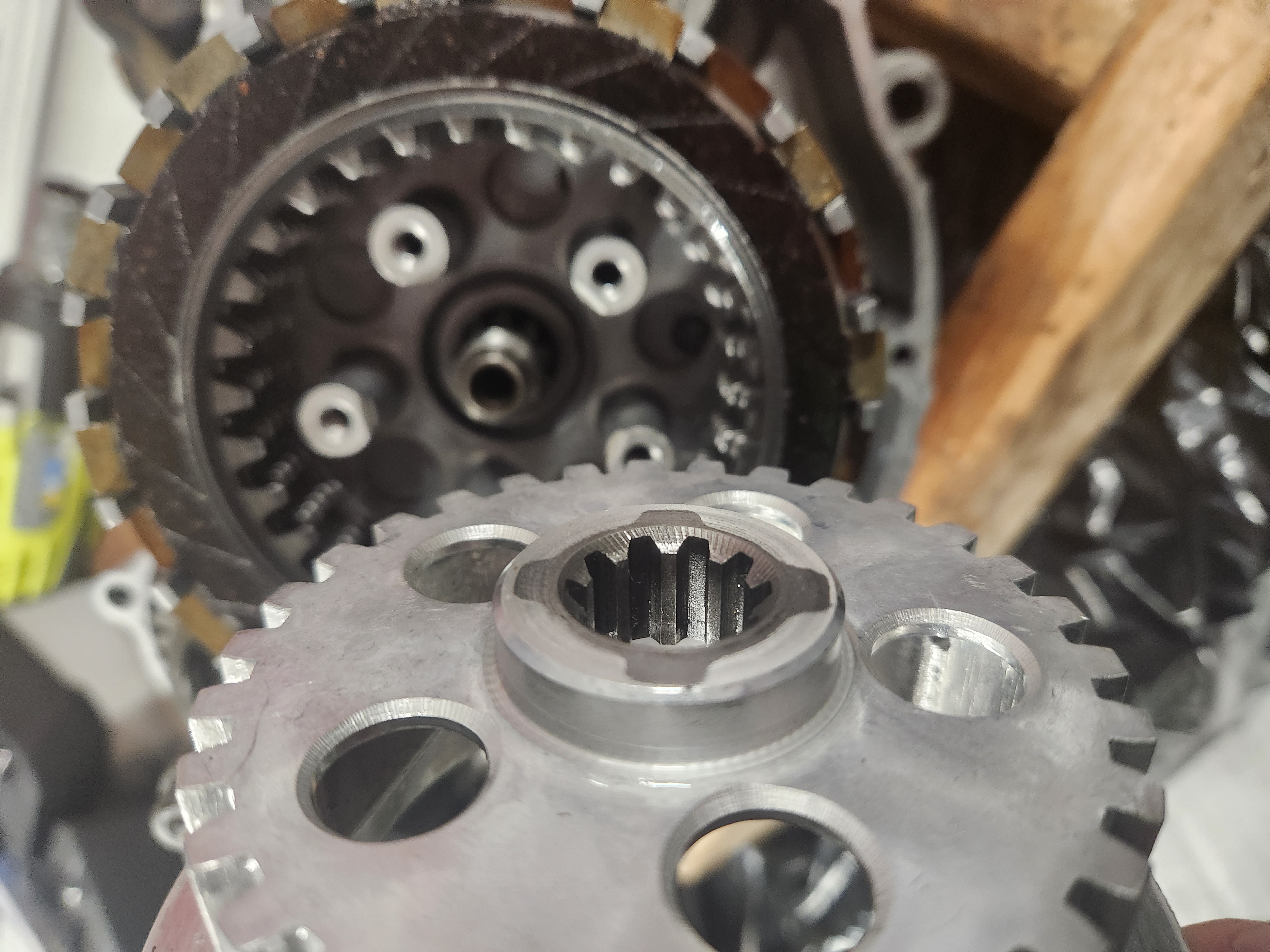

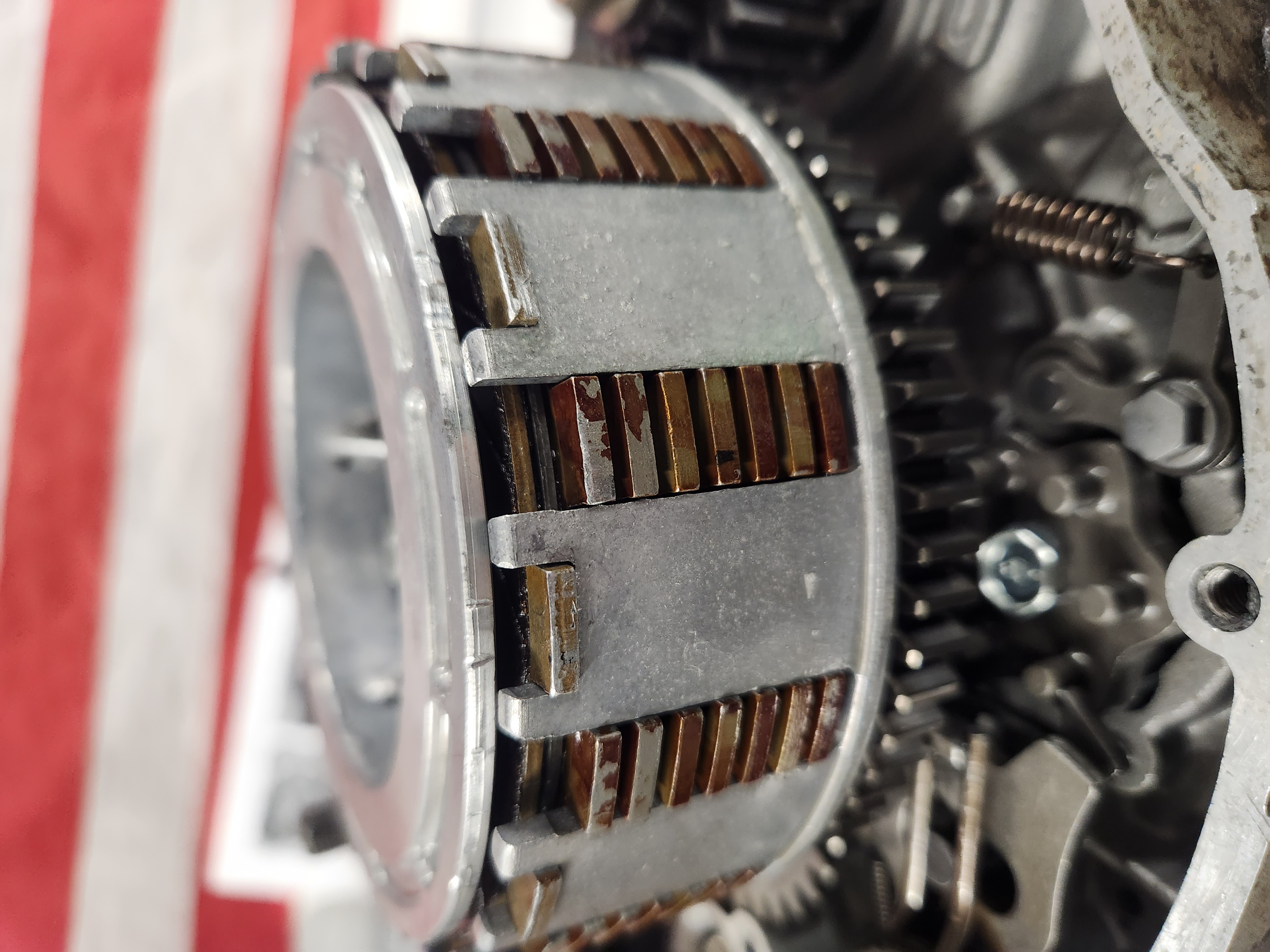

Clutch install question.....
Can't seem to get the pressure plate all the way down to the bottom. I don't remember having that gap up top when I took the clutch off....
Seems like it just needs to go down one more steel plate and get flush....?
What's going on here?

Try to assemble it like he does in the video. You’ll see at one point he talks about it not seating all the way down.
Posts: 1690
Re: Crank - help
Probably the last row of teeth on the inner basket isn’t lined up with the bottom metal plate. It can be tricky.

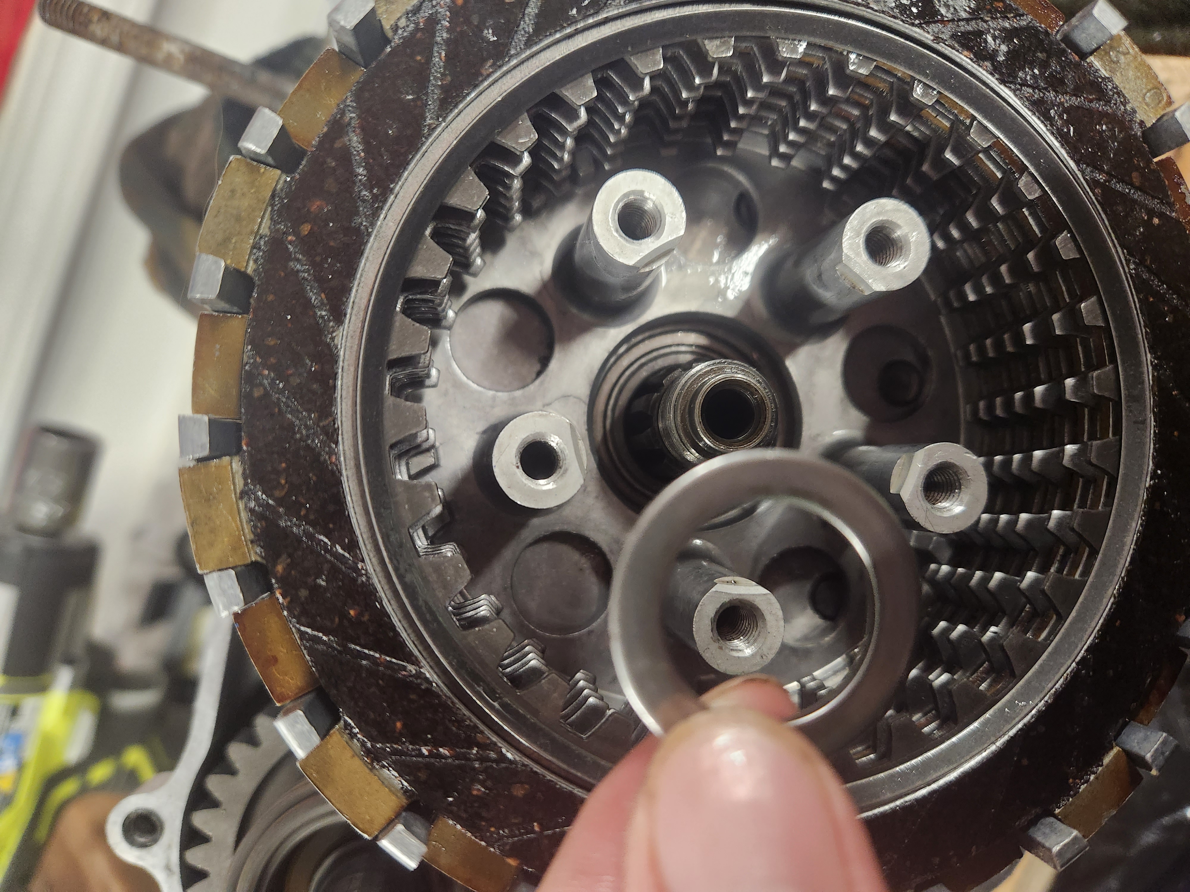

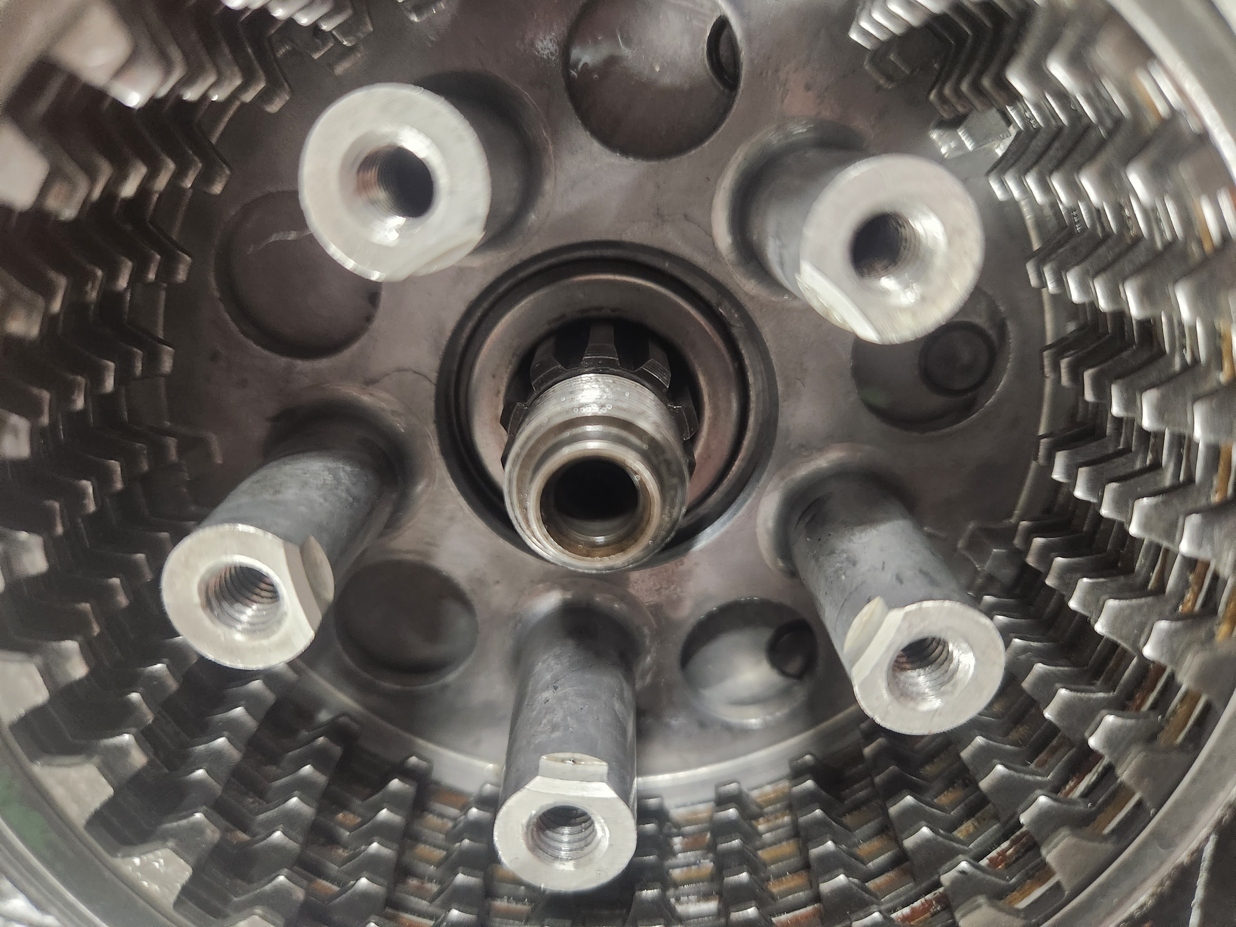

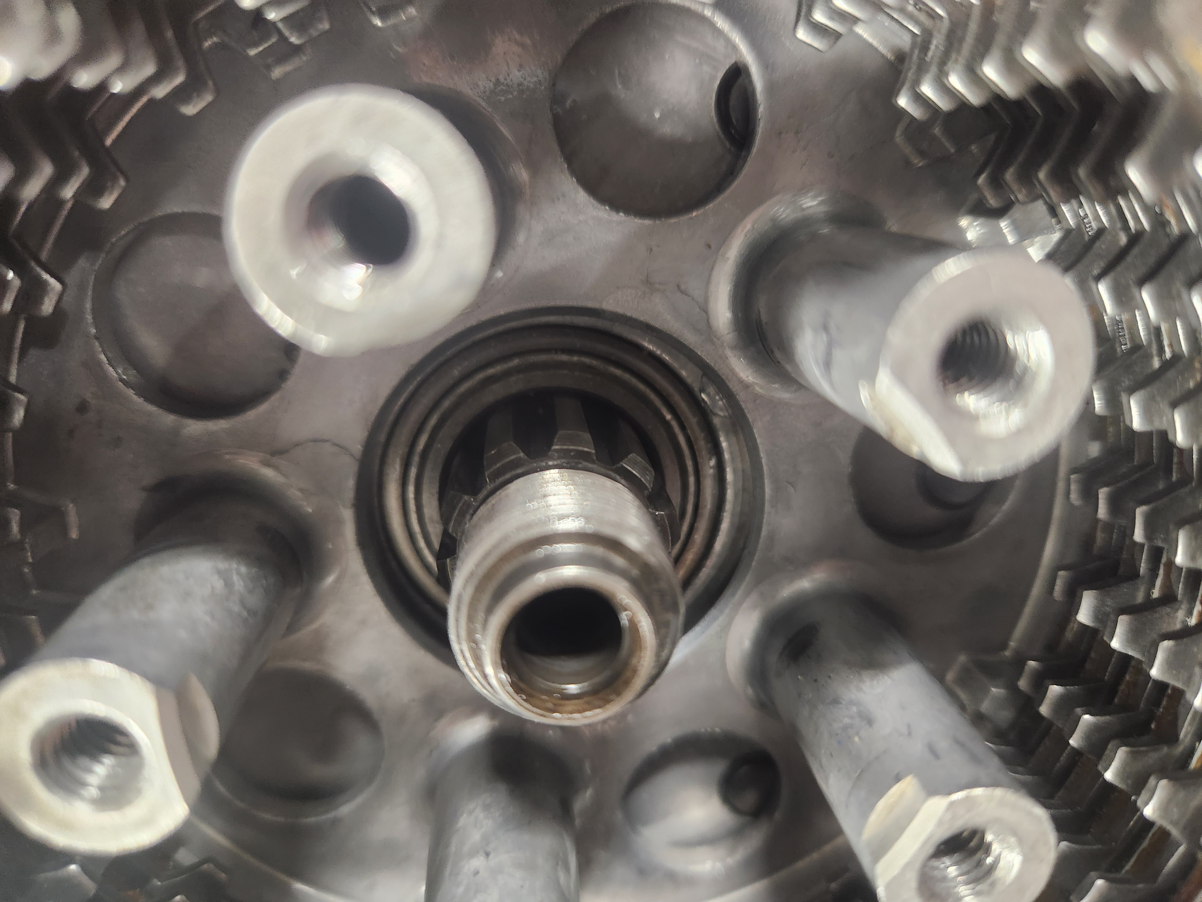

Tried following the method in that youtube video....unfortunately no success. If I do it that way, no gap up front but have a gap in the back towards engine.
Only way clutch pack is seating all the way down is without the inner washer pictured below. Not sure why. Got me stumped.
If I put the washer in there, it fills up most of that round area for the bottom of inner hub to drop in but I believe without that washer I'd just be bolting the two clutch hubs together....

Do you have the washer that goes behind the basket installed?
Posts: 1690
Re: Crank - help
SS109 wrote: 05:16 am Nov 08 2022 Do you have the washer that goes behind the basket installed?
This. Also, I can already see that the bottom plate isn’t lined up with the fingers of the rest of the metal plates. They all need to slot into the inner hub.

I'm with SlickNick, that last one isn't in line with the rest. A little off topic but what kind of basket and hub is that? Mine has only 4 springs
