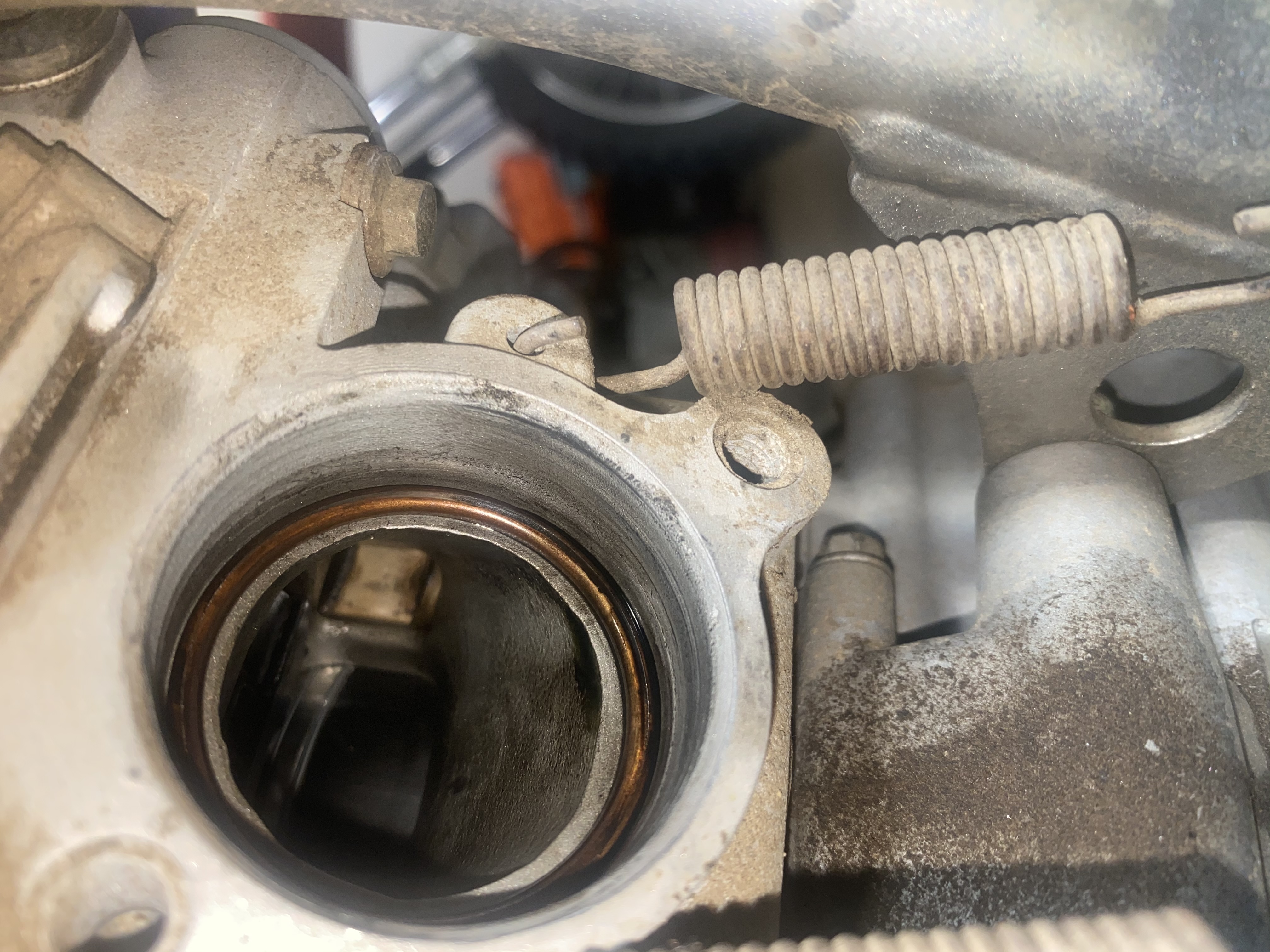

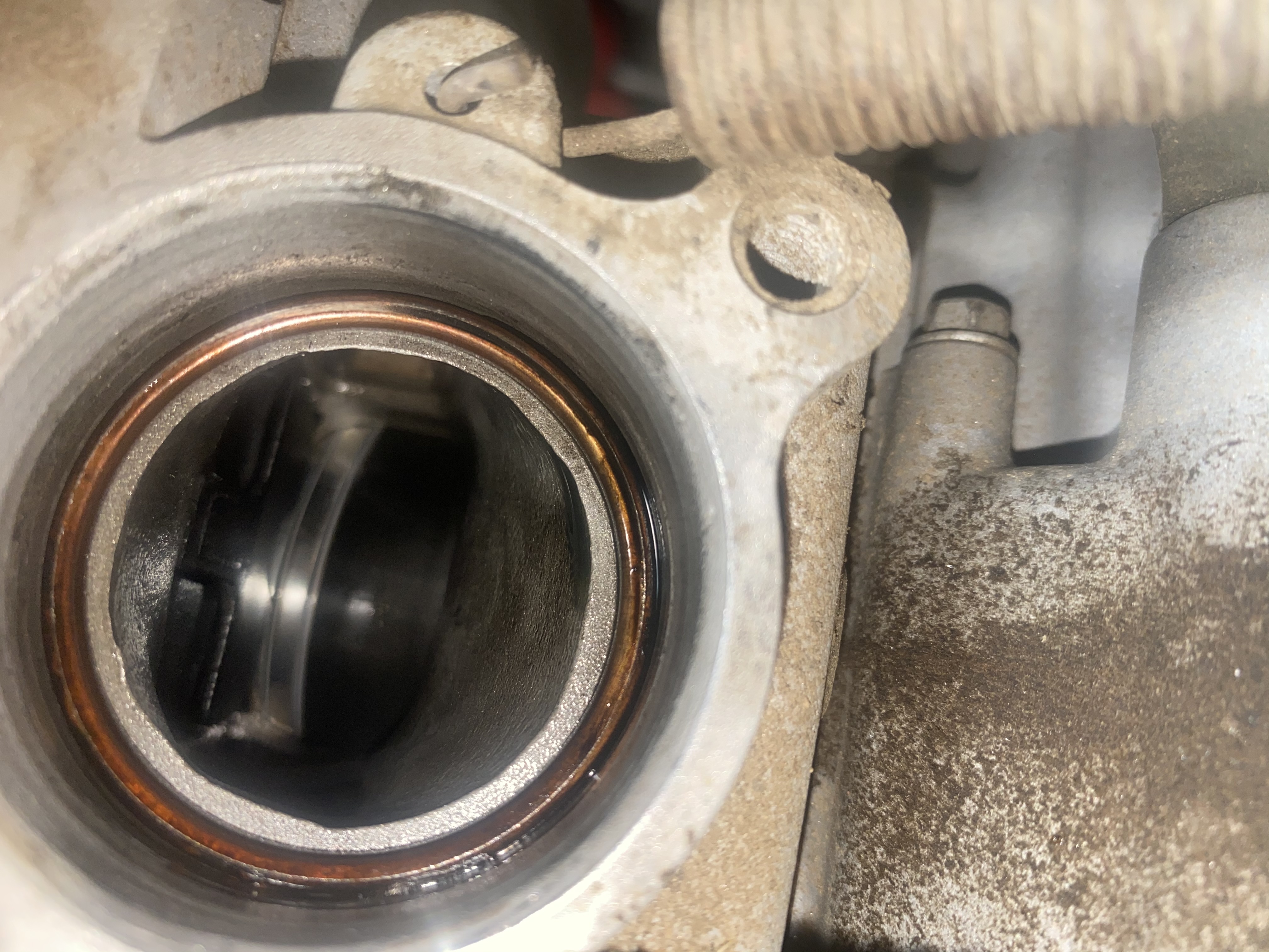

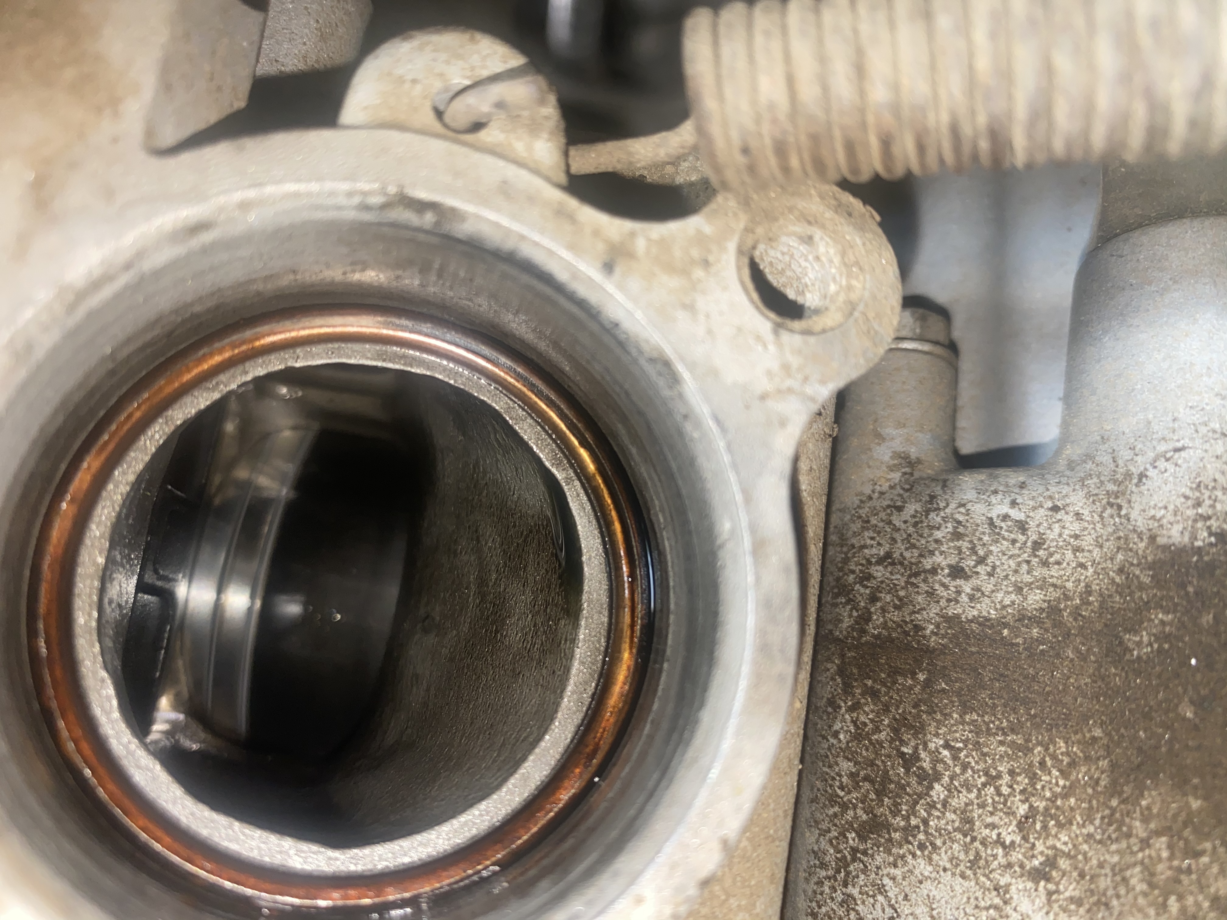

Here’s 3 pictures for each valve closed.. ThanksJZ05220r wrote: 07:25 am Jul 14 2022Ok good to know. How do I manually open the KIPS? ThanksSS109 wrote: 07:11 am Jul 14 2022You need to pull the pipe, look up inside the exhaust port, and manually operate the KIPS to make sure all three valves open up. If Fredette did the carb then I'm pretty sure it should be good but still worth checking the jet block gasket.JZ05220r wrote: 08:13 pm Jul 13 2022 I have check the inspection cap on the left side and revved the bike and the gear did rotate.
Oh, BTW, you'll never want to use an air compressor for doing a leakdown test. Normally 4psi is more than enough. You get much higher than that and you risk blowing out seals.

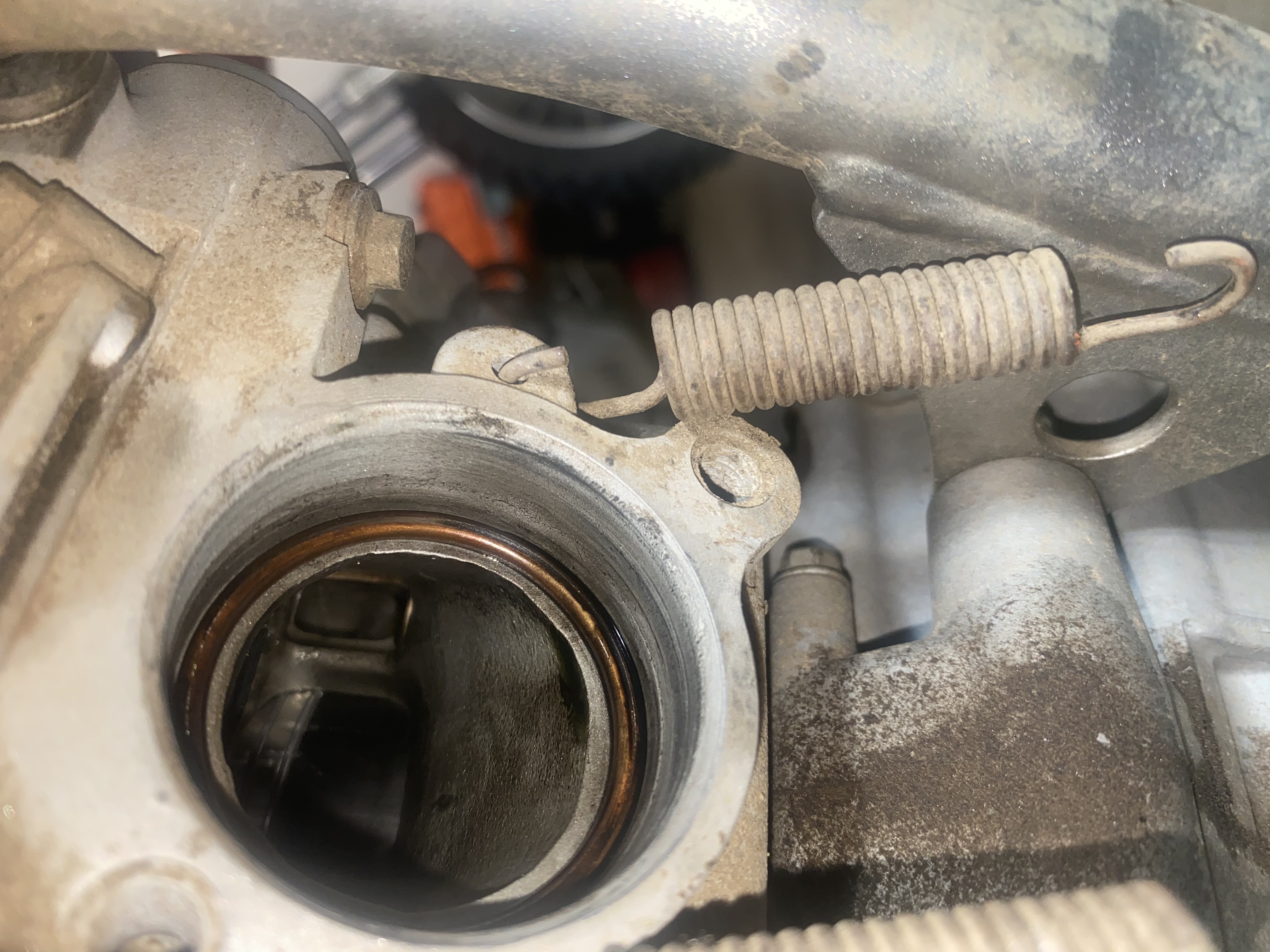

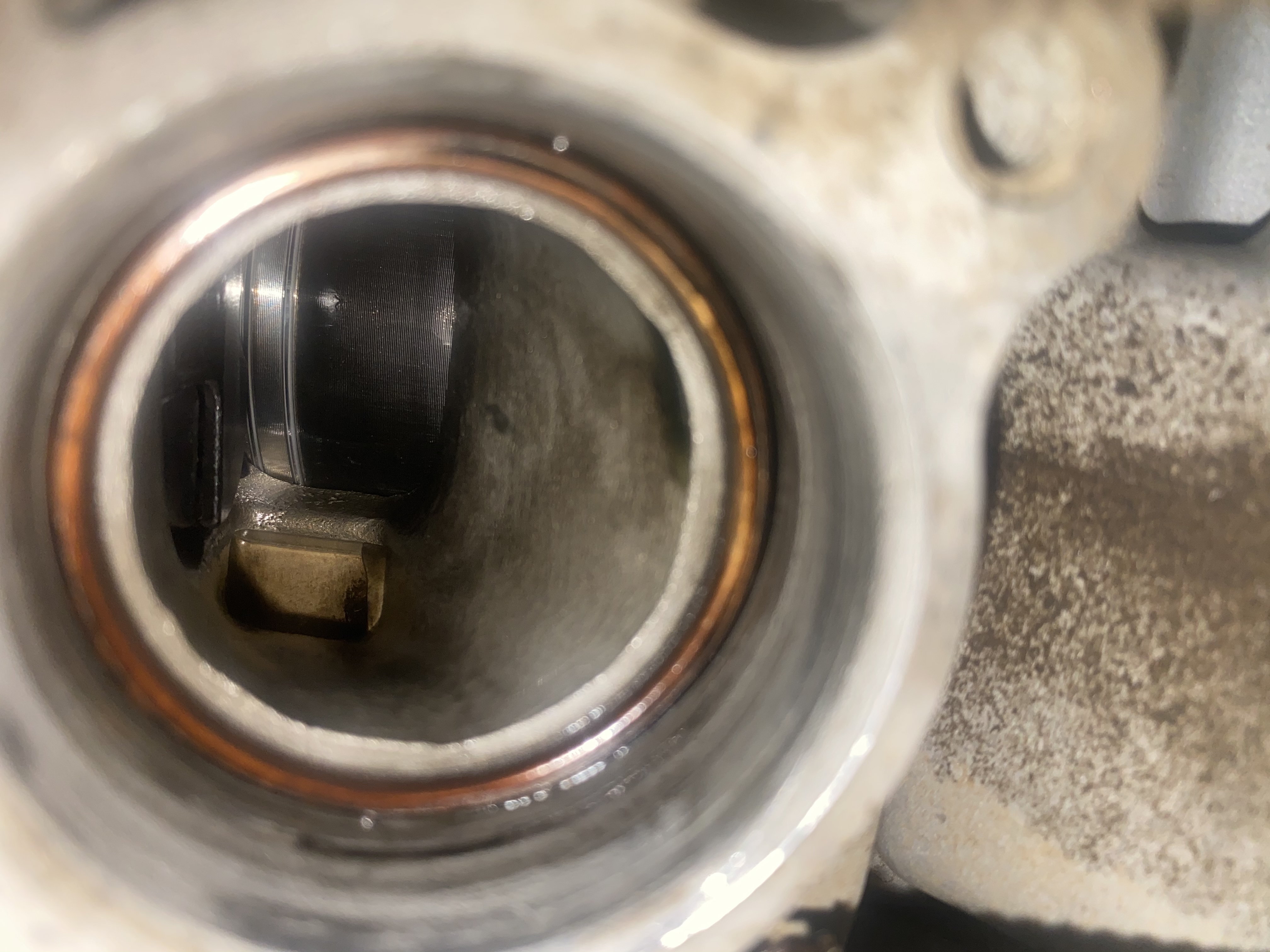

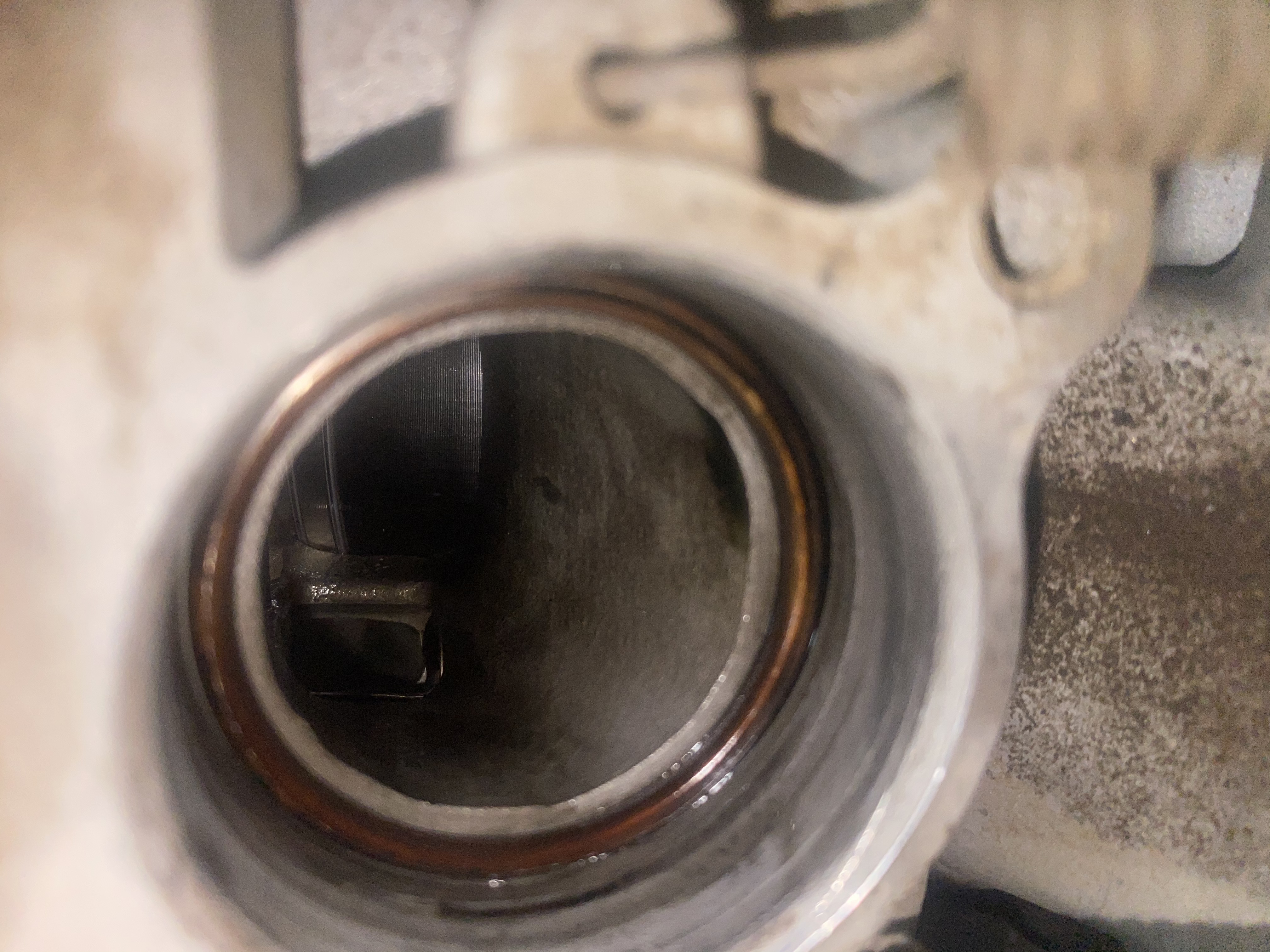

Heres 3 with them open while manually turning the actuator rod with a wrench. The actuator doesn’t return on its own at all unless I put a little pressure with a wrench to return it back.JZ05220r wrote: 07:25 am Jul 14 2022Ok good to know. How do I manually open the KIPS? ThanksSS109 wrote: 07:11 am Jul 14 2022You need to pull the pipe, look up inside the exhaust port, and manually operate the KIPS to make sure all three valves open up. If Fredette did the carb then I'm pretty sure it should be good but still worth checking the jet block gasket.JZ05220r wrote: 08:13 pm Jul 13 2022 I have check the inspection cap on the left side and revved the bike and the gear did rotate.

Ok, we've eliminated the KIPS. It looks like it is operating like it should. I would do a leakdown test next to make sure it's not an air leak in the bottom end. If you look up online you can make a cheap one yourself (If I remember correctly I think even a member here has dosumented how they made one) for about $20-30.
