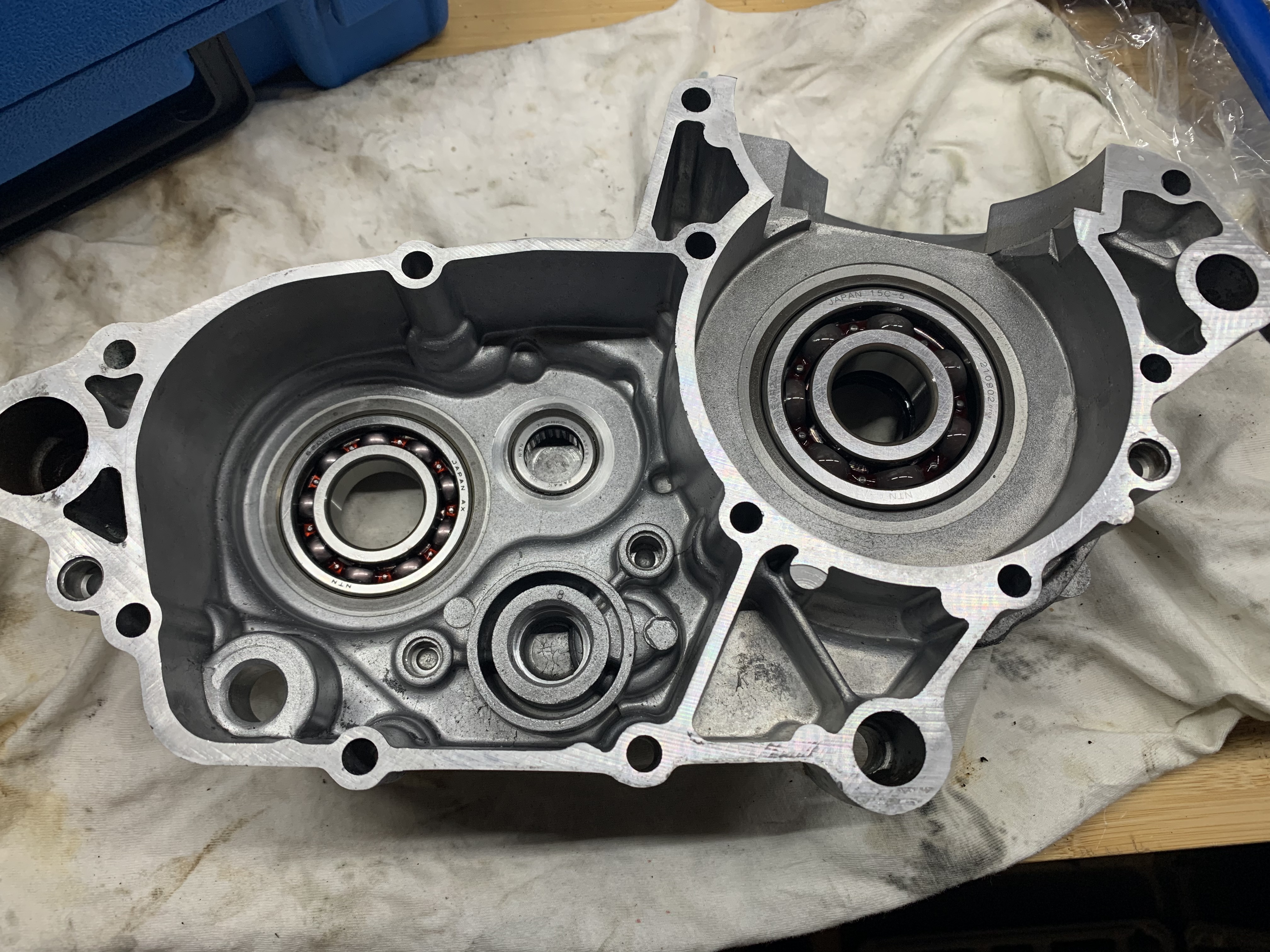

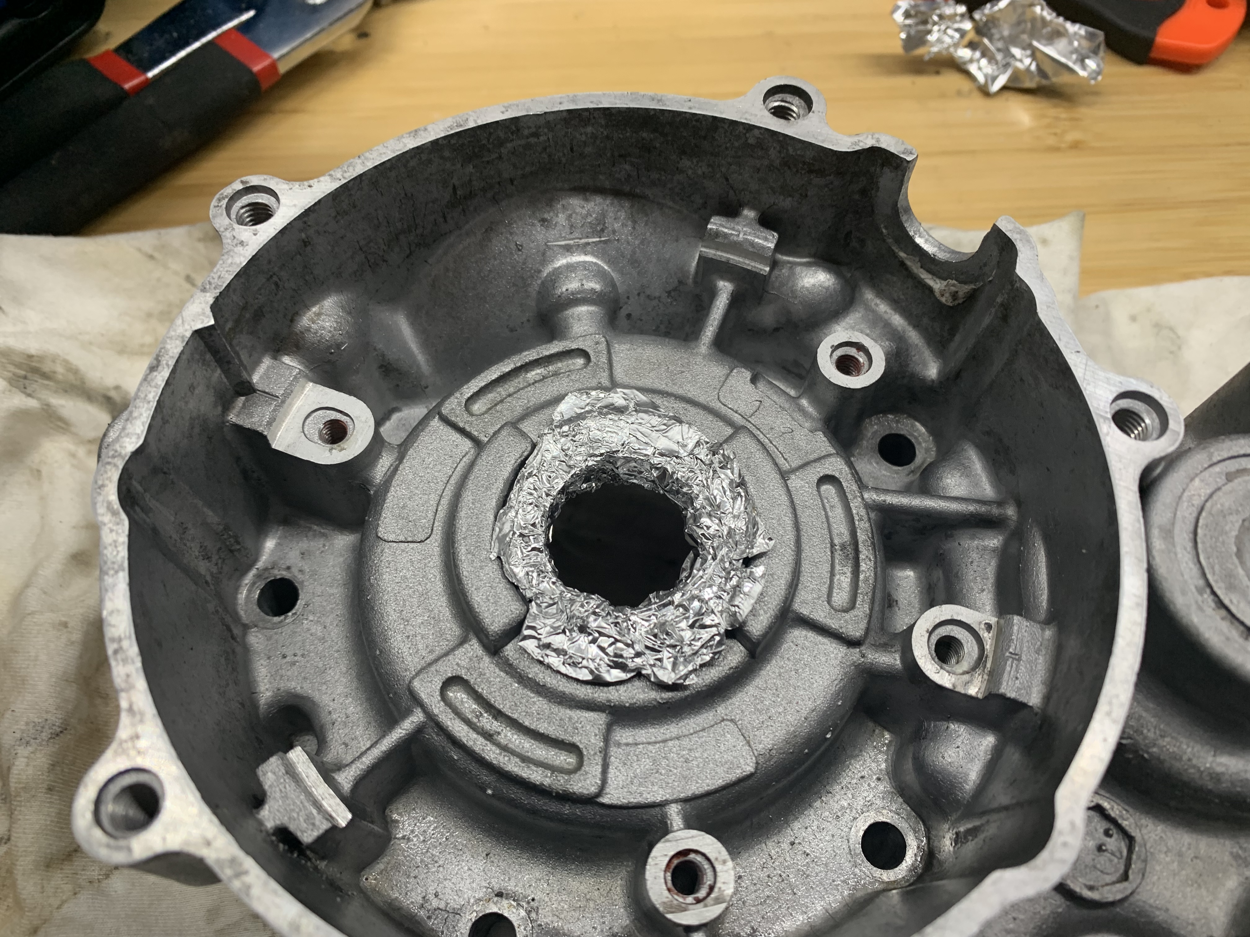

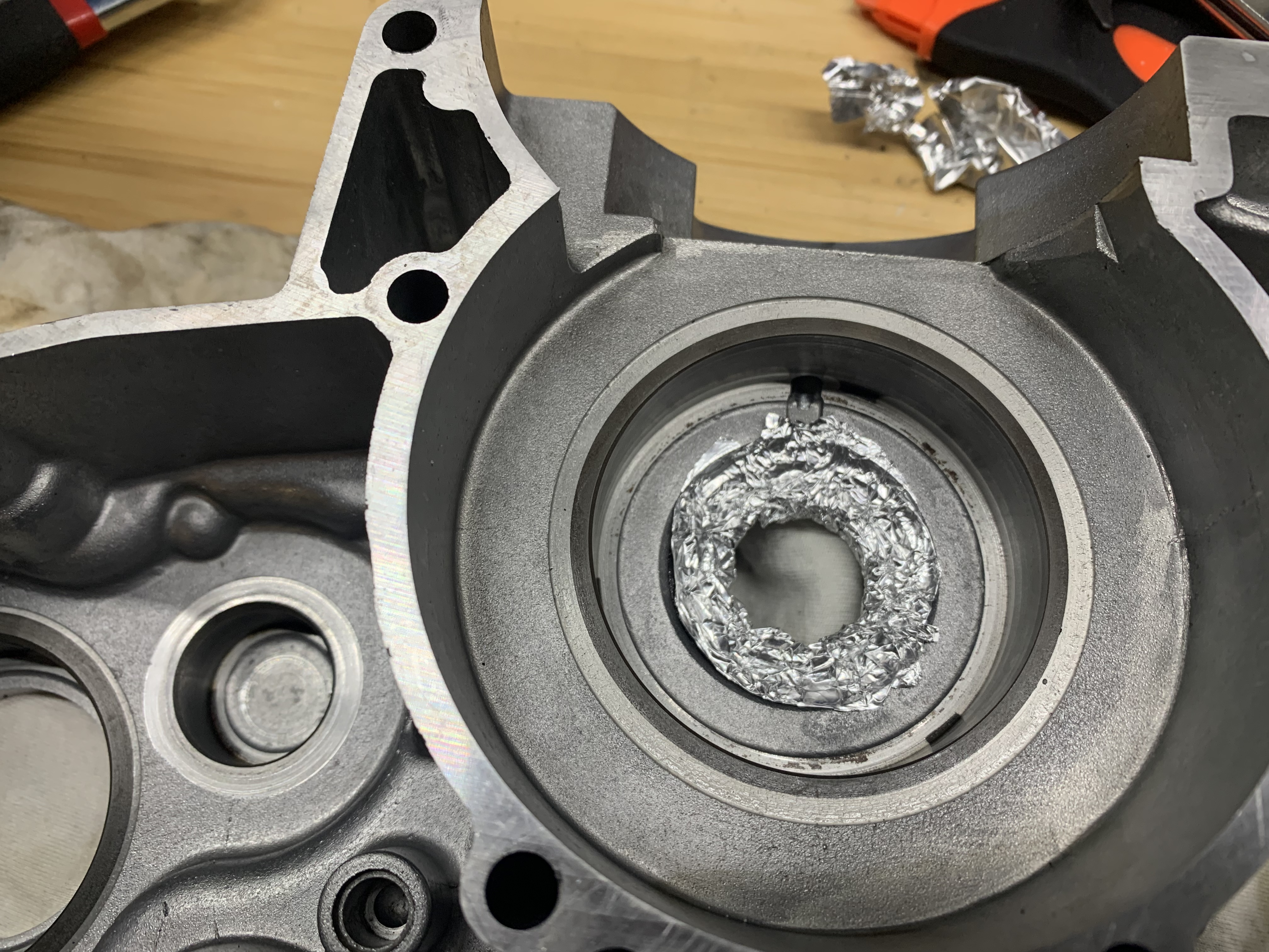

Hello all, it’s been a while. Parts are taking forever to arrive!
I guess another advantage in going third party is parts availability. I went all Kawasaki OEM for my rebuild.
I was able to insert the bearing in the left case half. It was very easy with the bearing in the freezer and the case half in the smoker (ok without smoke!) at 200 degrees. I did protect the crank seal from heat with aluminum foil but at these temp I don’t think you’d have to.
Now waiting for one bearing that is B/O for the other half. Suppose to arrive mid-May.

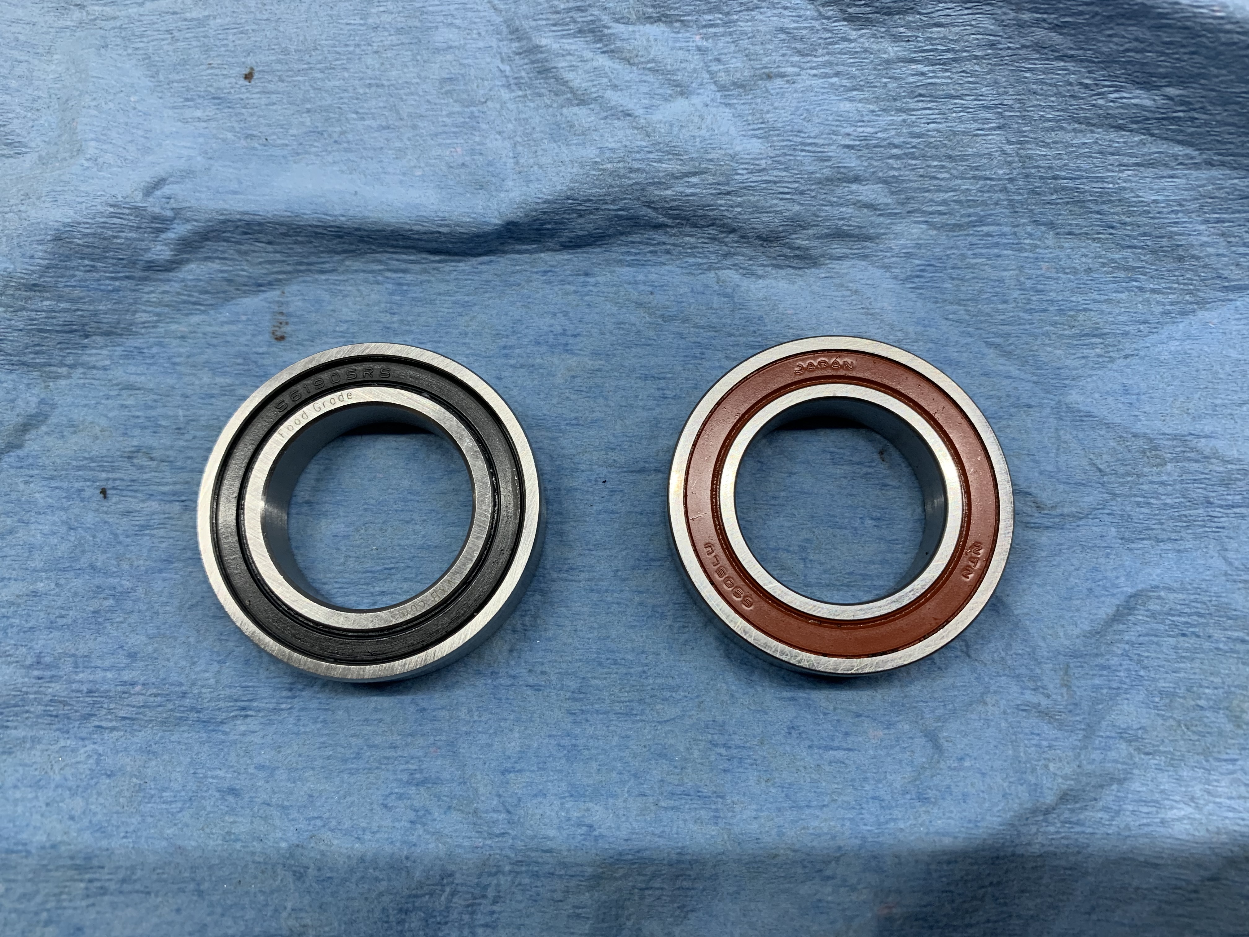

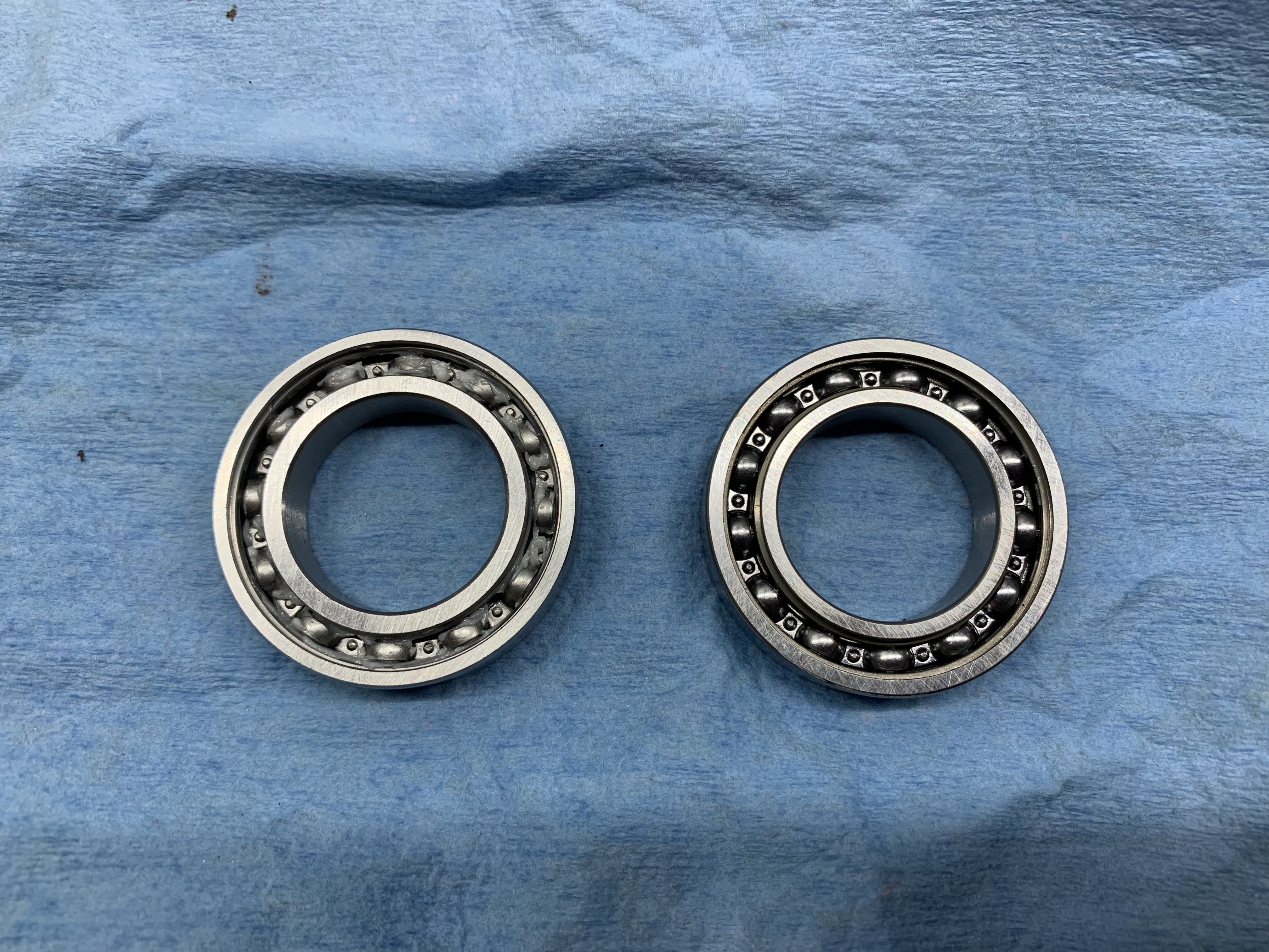

Ok guys. Tell me I am way too picky here!
I found an equivalent bearing (size wise). It is the shift drum bearing. Original is NTN 6905-LU. I found a FAG 61905-2RSR.
The replacement bearing arrives with seals on both sides when the original had only 1 seal. No worries, I removed the seal on one side. But the is a difference in the size ( so obviously qty) of the balls in the bearing. Original has 13 balls and the replacement has 12. That probably translate to the major difference I see in the spec of both bearings. Original has a limit speed of 16 000 RPM where the replacement has 9 800 RPM.
What would you do? Throw the replacement bearing in there and forget about it? Here are pictures of the 2. Original bearing on the right
- BFF5F656-F791-4915-A458-DAE7CAB08B52.jpeg (3.65 MiB) Viewed 5704 times
- C25F907F-FBBA-48B2-B616-718914C67E33.jpeg (3.79 MiB) Viewed 5704 times
- Posts: 6114
Re: Engine removal and tear down
Not even a question for me! I would buy a bearing that meets the OEM bearing specs or better.

Haha! And I’m possibly on other side. If it is reputable name brand x-ref (like all balls or similar) I’d probably just use it.
- Posts: 887
- Location: Florida
That bearing barely even moves every time you shift and then goes 1/2 way back to it’s starting point. It’s the one bearing in the bottom end I wouldn’t have a problem not going OEM. You’d have to be shifting like crazy to even get one RPM.
