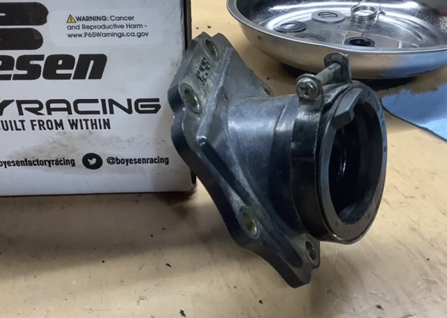

Here’s the stock reed boot that came off mine - it’s at least a half inch, probably closer to 3/4” narrower than the Boyesen on there now, no wonder the carb is so far back, but OH MAN SHE RIPS!

Slick_Nick, I appreciate your input a ton! The cable isn’t bound up, it’s operating perfectly. Initially I couldn’t understand how the top of my carb was tucked in so tight beneath the frame brace. It was going to be that way no matter which petcock I ran due to the wide Boyesen Radvalve setup Fredette upgraded me too. I didn’t realize before how much wider it was than stock. I don’t think my throttle cable was run outboard of the oem petcock when I got this bike so that has never been an issue to me. It’s set up now like I had it before. I have Shoe Goo on the throttle boot to insulate it from tearing again, I’ll keep an eye that.
