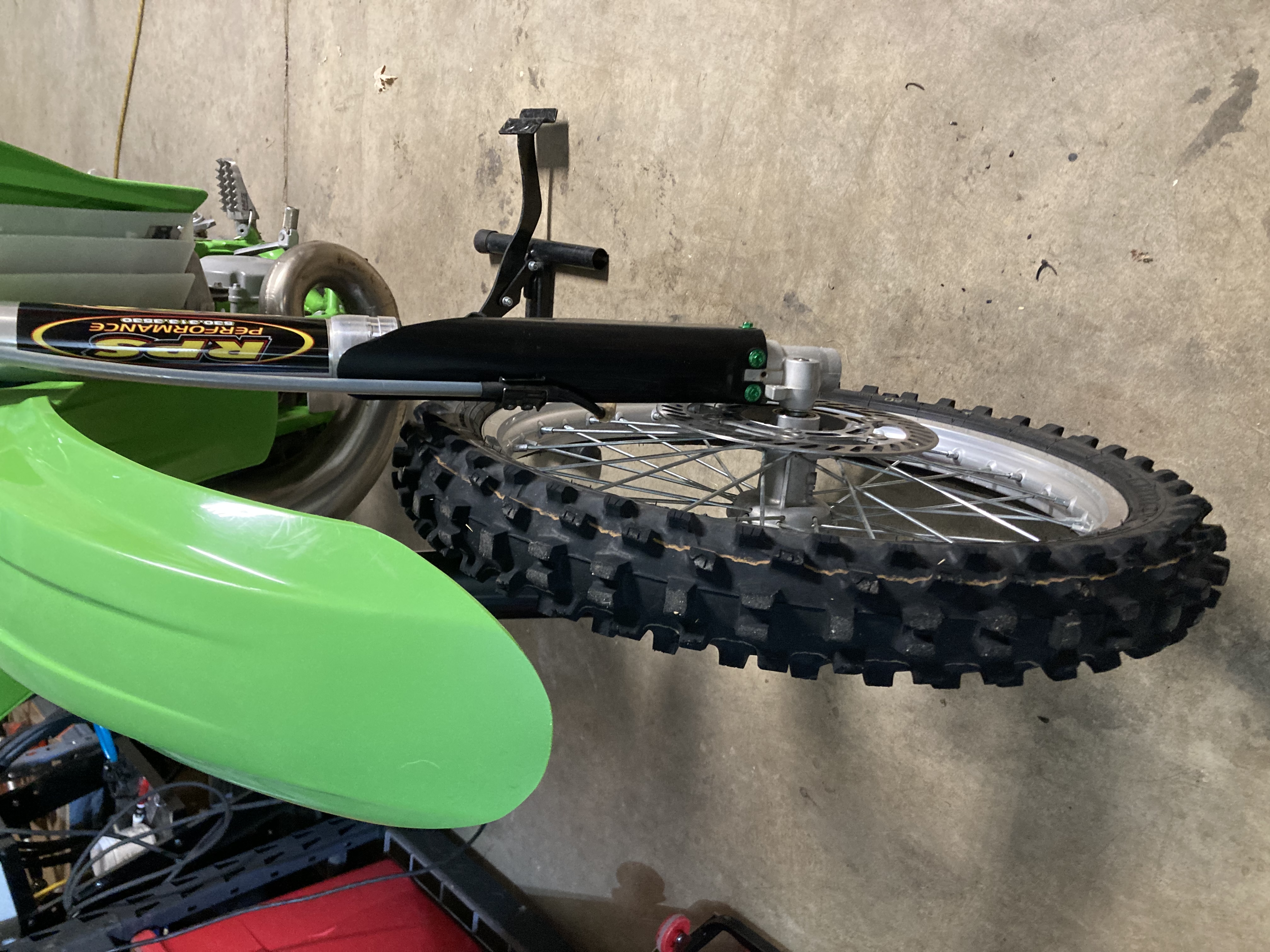

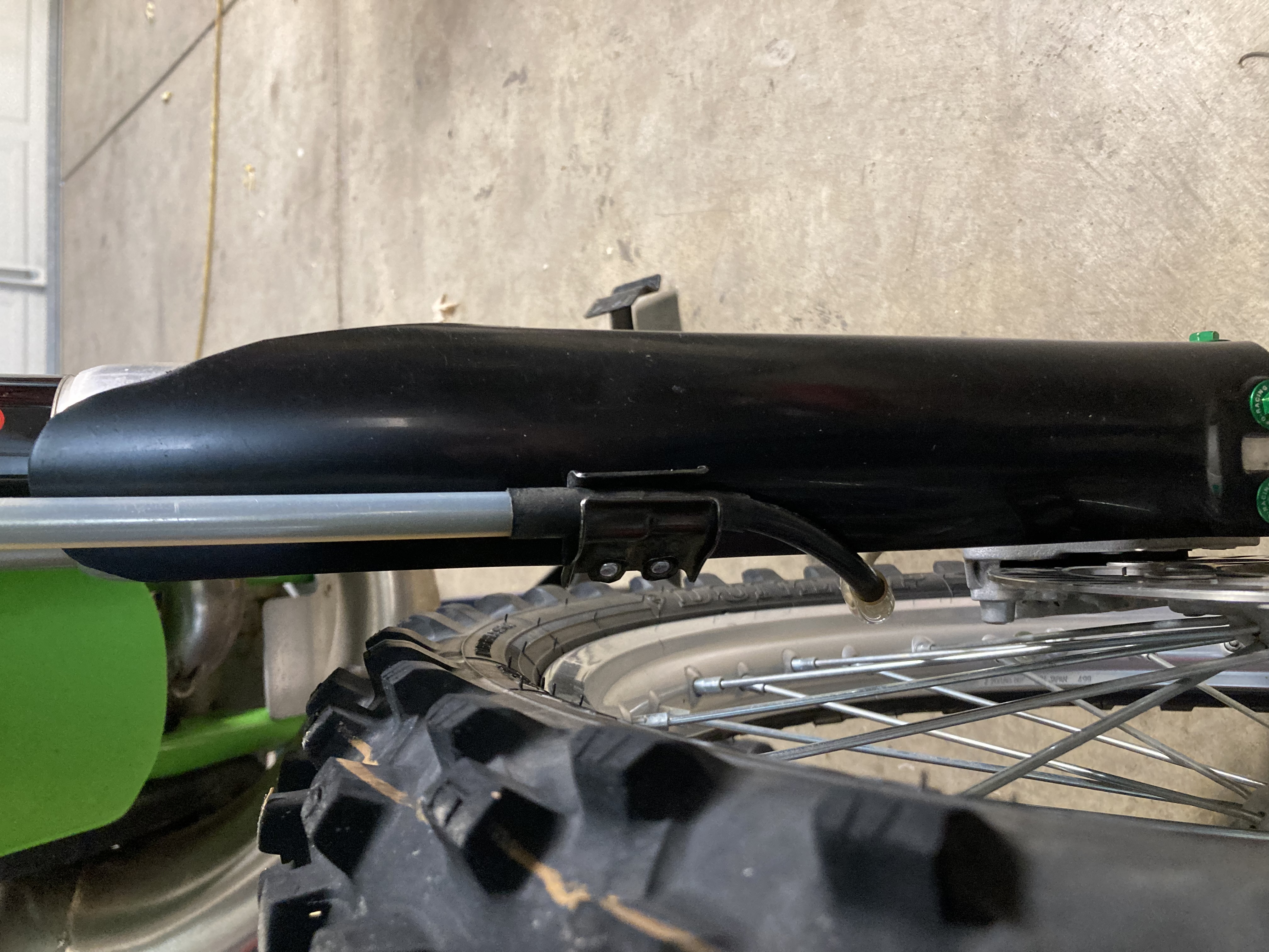

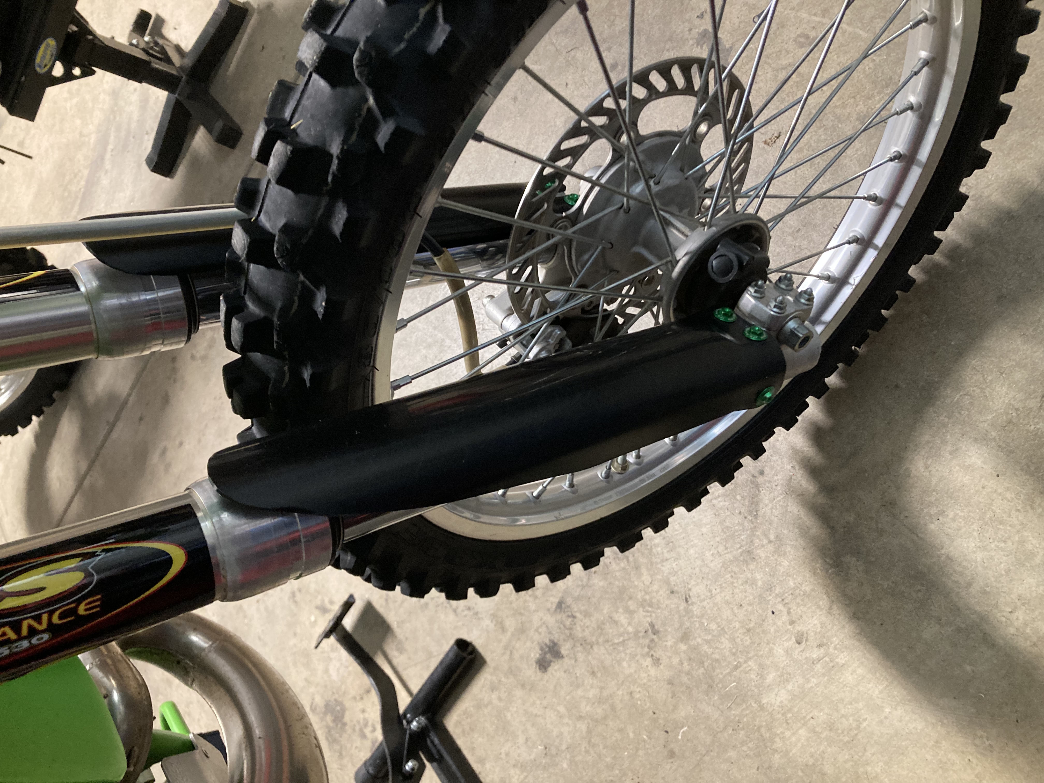

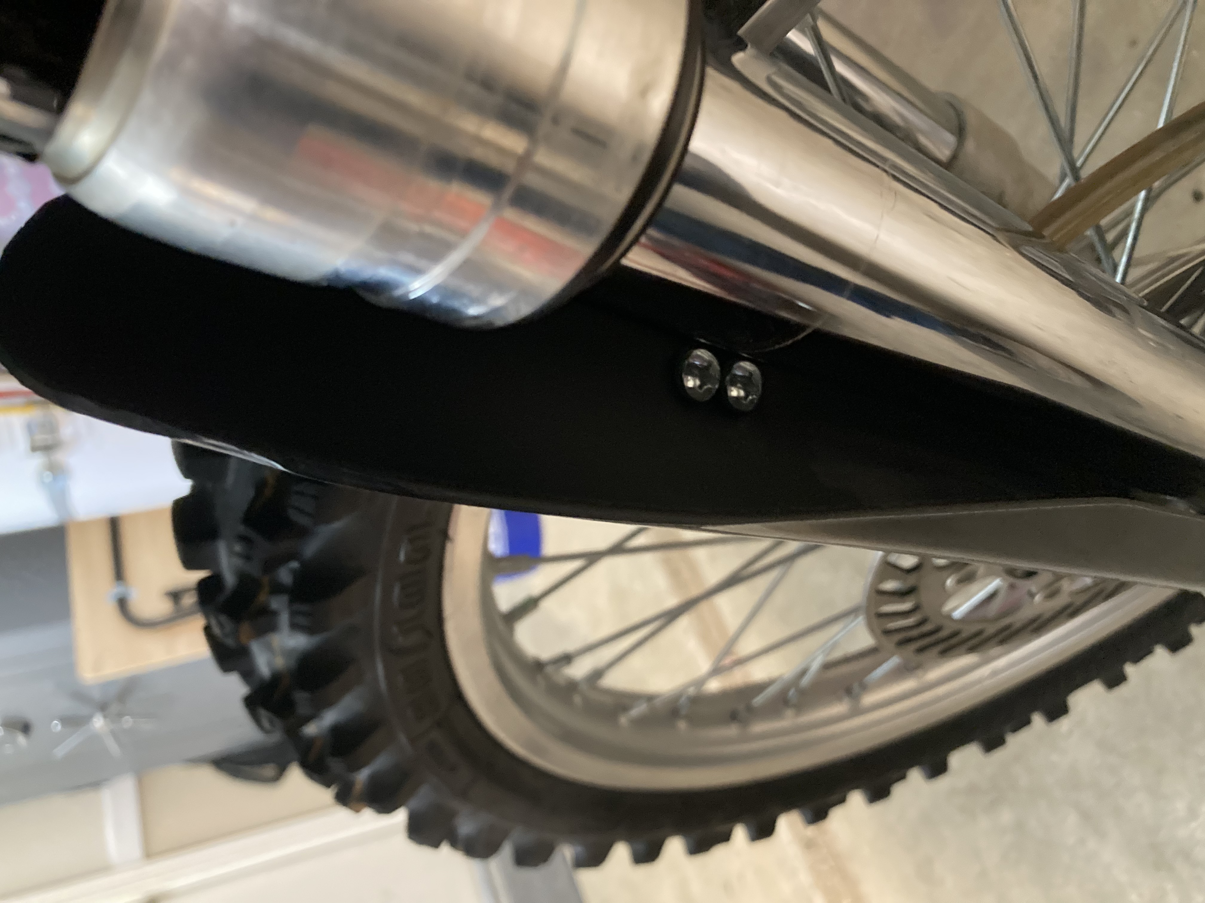

Hi I used 98 KLX 300 forks and clamps on my 2000 KDX 200 with racetech .42 springs and their valving. I used my kDX wheel and Caliper which was a direct bolt up.
I Love the setup. But HATED the KLX guards!
KLX fork guards are terrible so I ordered these black Acerbis for a 1994 KX. I run them with no keepers. I trimmed them a little and ground the stock KDX brake cable bracket smooth on the back. Drilled two holes in the fork guard and mounted it with two pan head 6 mm screws. Sturdy, clean and cheap!
Big difference in performance and looks

Those screws are going to destroy your fork tubes every time the forks compress. Try a set of newer fork guards from something that have a built in support for the brake line clamp.
- Posts: 14676
- Has thanked: 66 times
- Been thanked: 20 times
Re: 2003 KDX220R Fork Conversion Questions
Yep, without fork guard guides, it is going to get destroyed quickly.
