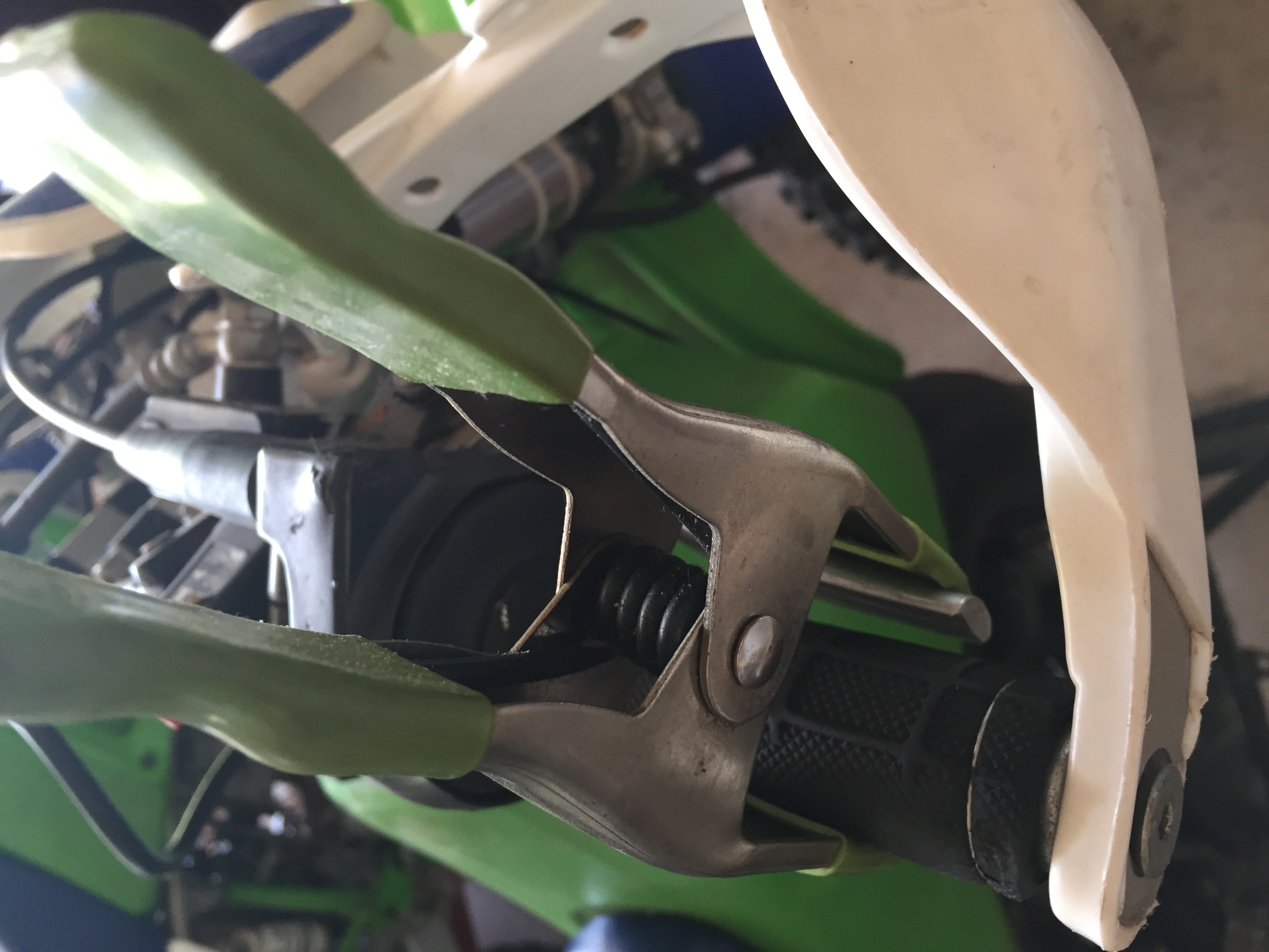

If you haven’t already it would be worth a shot to clamp the lever to the bar. Pump the lever and get it as firm as you can and then put a spring clamp on it and leave it overnight. With it clamped you can also beat on the hose with the screwdriver to try to dislodge the trapped air.

Guess what? It was hiding a broken lever just holding with a piece of copper tube hammered on it!!! Man!! I've been riding it like that for four years! I'm quite ashamed that I never checked it... So maybe all of this could be a wrongly shaped lever issue?
Could someone give me some advice on replacement levers? I kinda need one now. I loved the feeling of the short lever on my buddy's new KTM.
