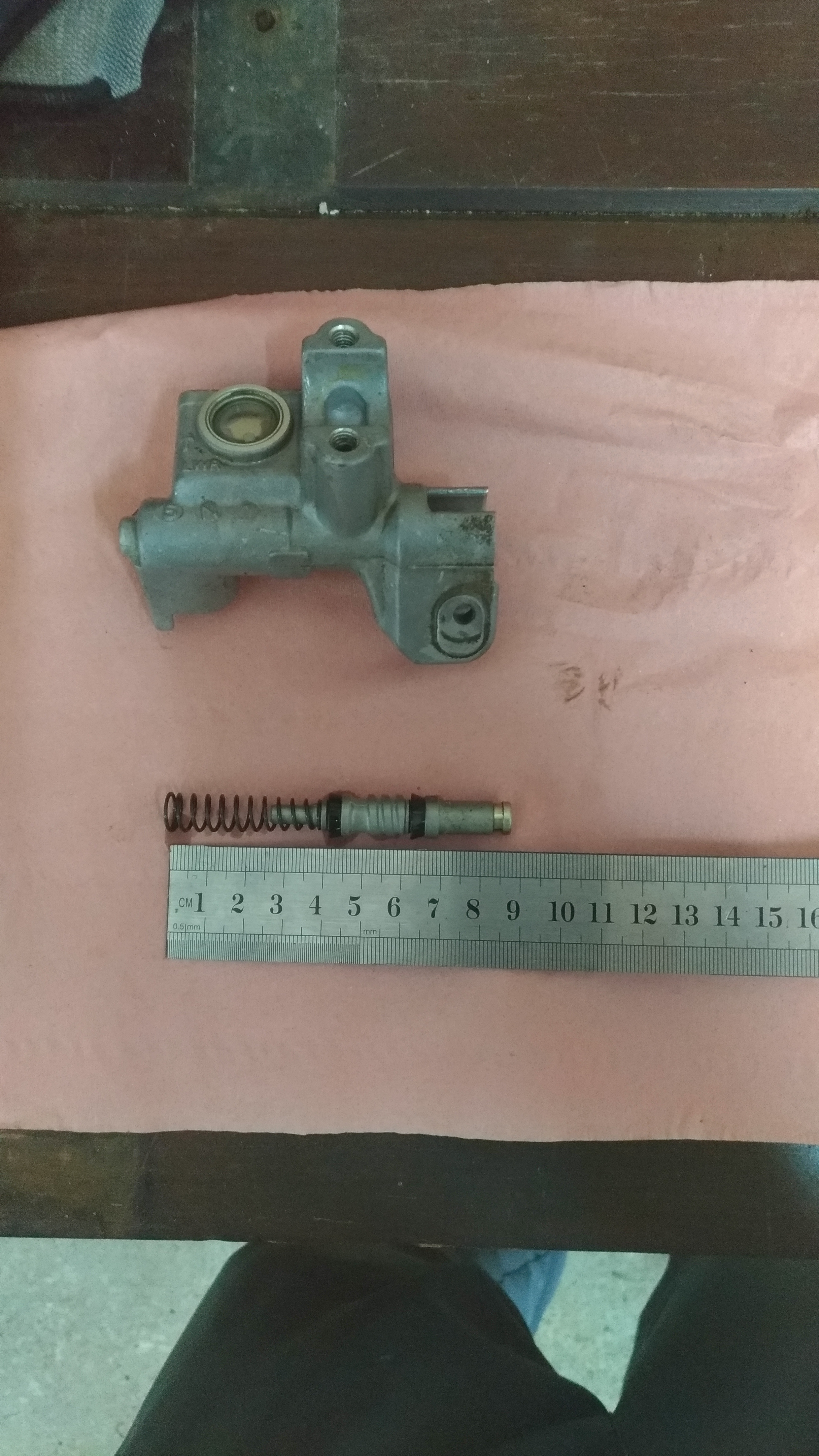

Tonight I disassembled the master again. Nothing found. Return hole not obstructed, seals seems to be correctly installed.
I tried swapping the master with the sport one but the banjo bolt threads don't match, and it's a double on the sports.
Tomorrow I'll try swapping with the wife's husqvarna master.
I'm starting to loose temper on that brake.

It appears to be assembled correctly. Is the bore pitted or corroded?
I would lube the bore and the cups with brake fluid and carefully reassemble it. You can bench bleed it a bit by putting some fluid into the reservoir. Work the plunger a bit until it shoots out of where the hose hooks up. You may have to hold your finger over the output to help it prime and create pressure. Then hook it up and do a vacuum bleed on it if you can. See if you get a different result.
If it still isn’t working, leave the cover on and the hose and lever but remove it from the bars and hold it up as high as the hose will allow. Pump the lever and take a screwdriver handle and tap on the brake hose from bottom to top and back down. Try the lever again. Repeat if needed. You’re trying to dislodge any air bubbles and get them to float up to the reservoir.
I hope that helps. If not there’s another idea you might try. Let us know.

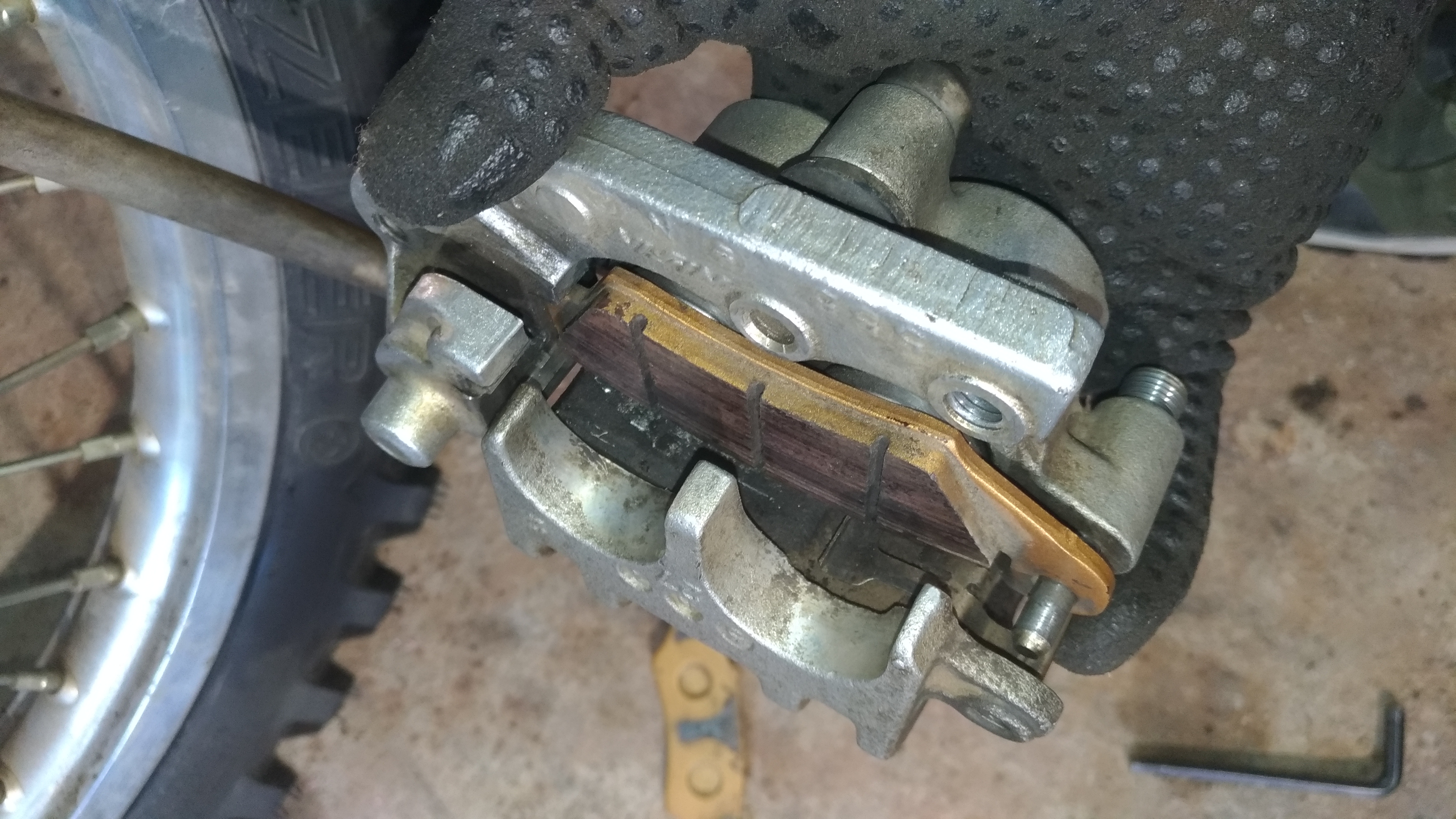

It would also be worthwhile to verify that your brake pads are seated properly in the caliper. I’ve had bikes come to my shop with the same symptoms you’re having. Spongy lever and no braking power. All fixed because the piston side pads weren’t seated properly.
Just a thought.
Just a thought.

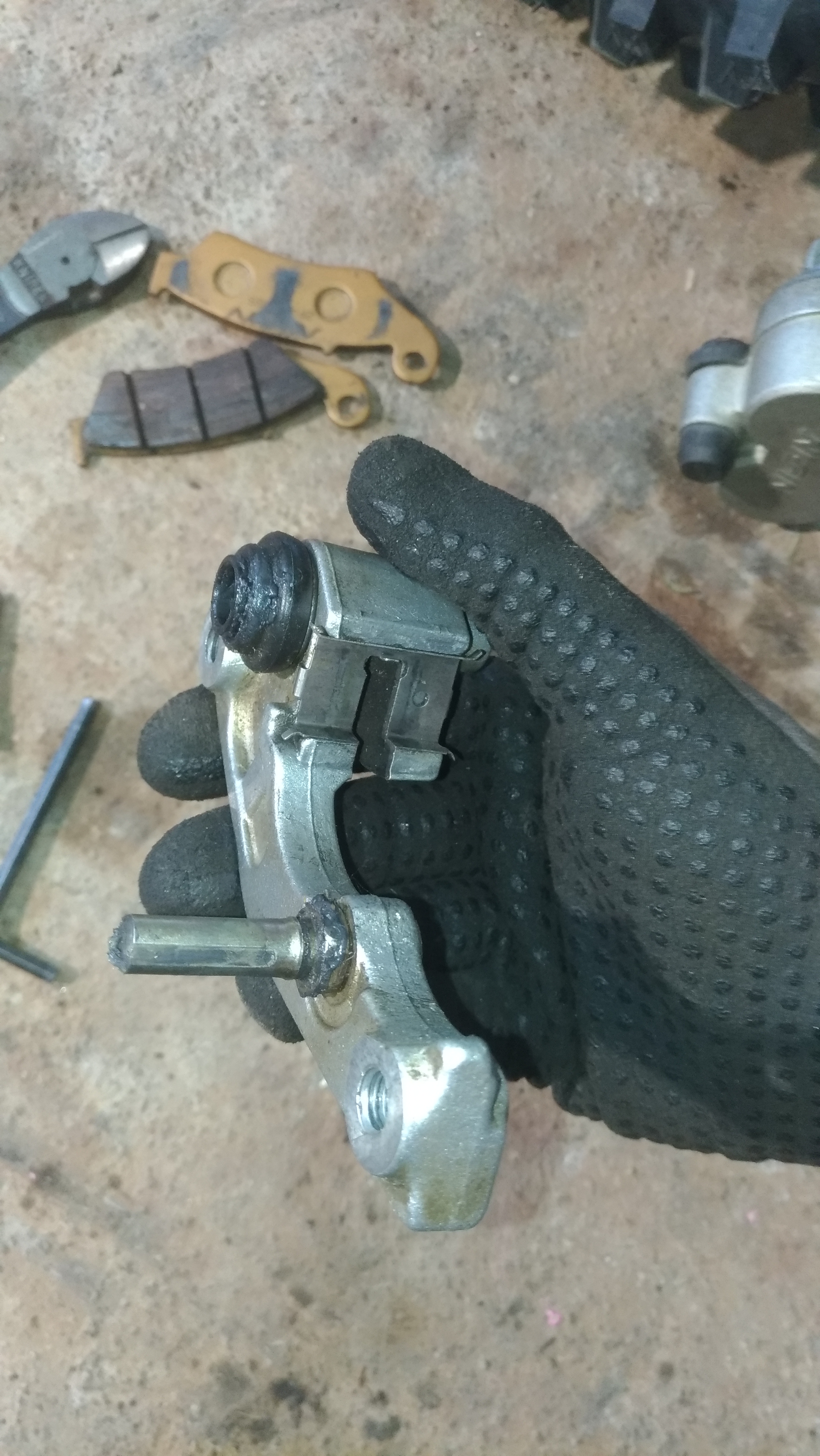

Goofaroo, I tried your technique but found no improvement. I removed the caliper and the master so I hung the system vertical, with the line straight.
I inspected the bore of the master before reassembly and found no defect.
I double checked the caliper and took some pics. It appears to me that the pads are correctly installed but I could be wrong. Pins are smooth, pad spring is doing its job.
It's crazy being in so much trouble on such a simple hydraulic system

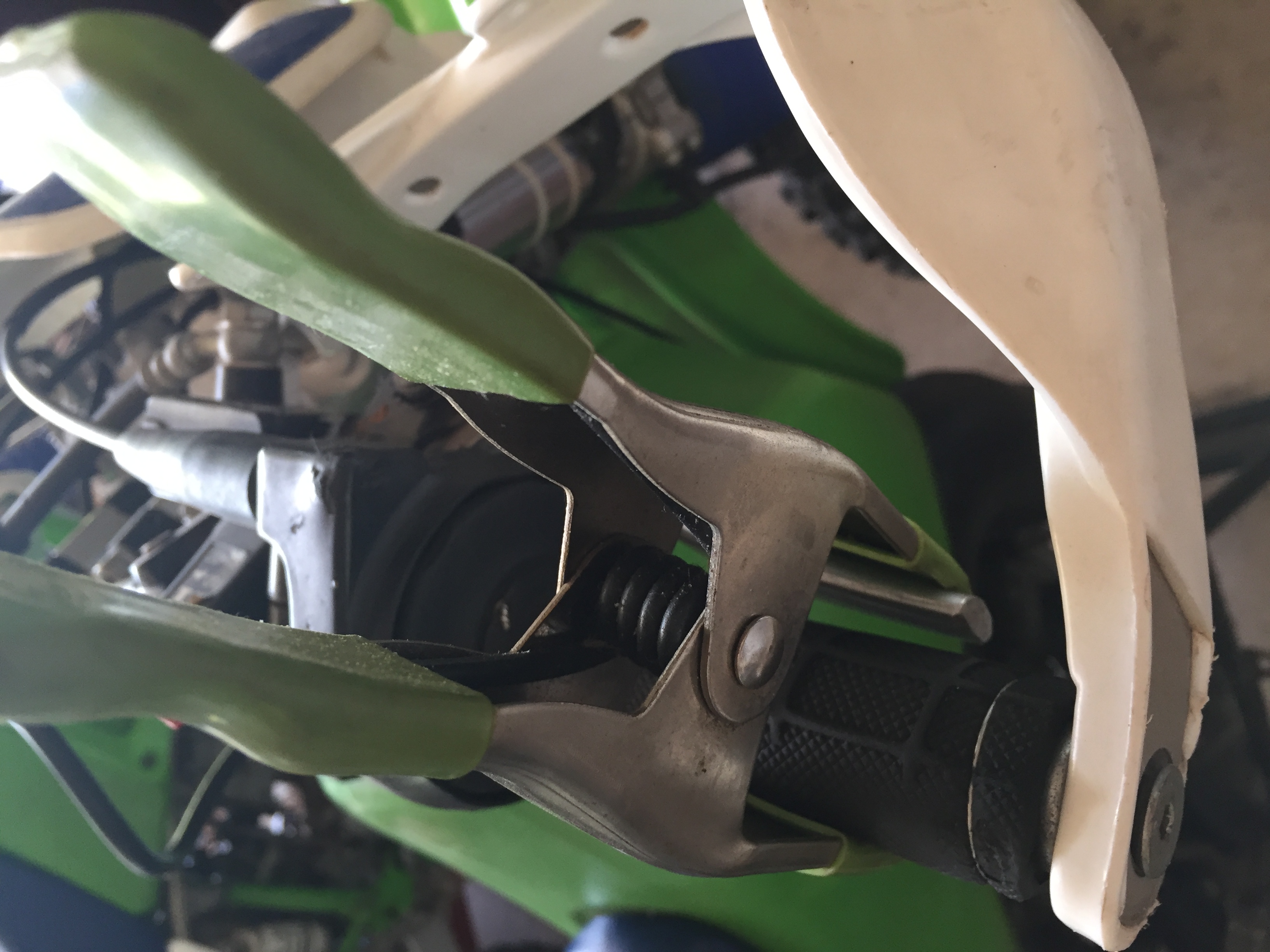

If you haven’t already it would be worth a shot to clamp the lever to the bar. Pump the lever and get it as firm as you can and then put a spring clamp on it and leave it overnight. With it clamped you can also beat on the hose with the screwdriver to try to dislodge the trapped air.
The solution is right in front of you but sometimes a simple job can turn into a three ring **** show.

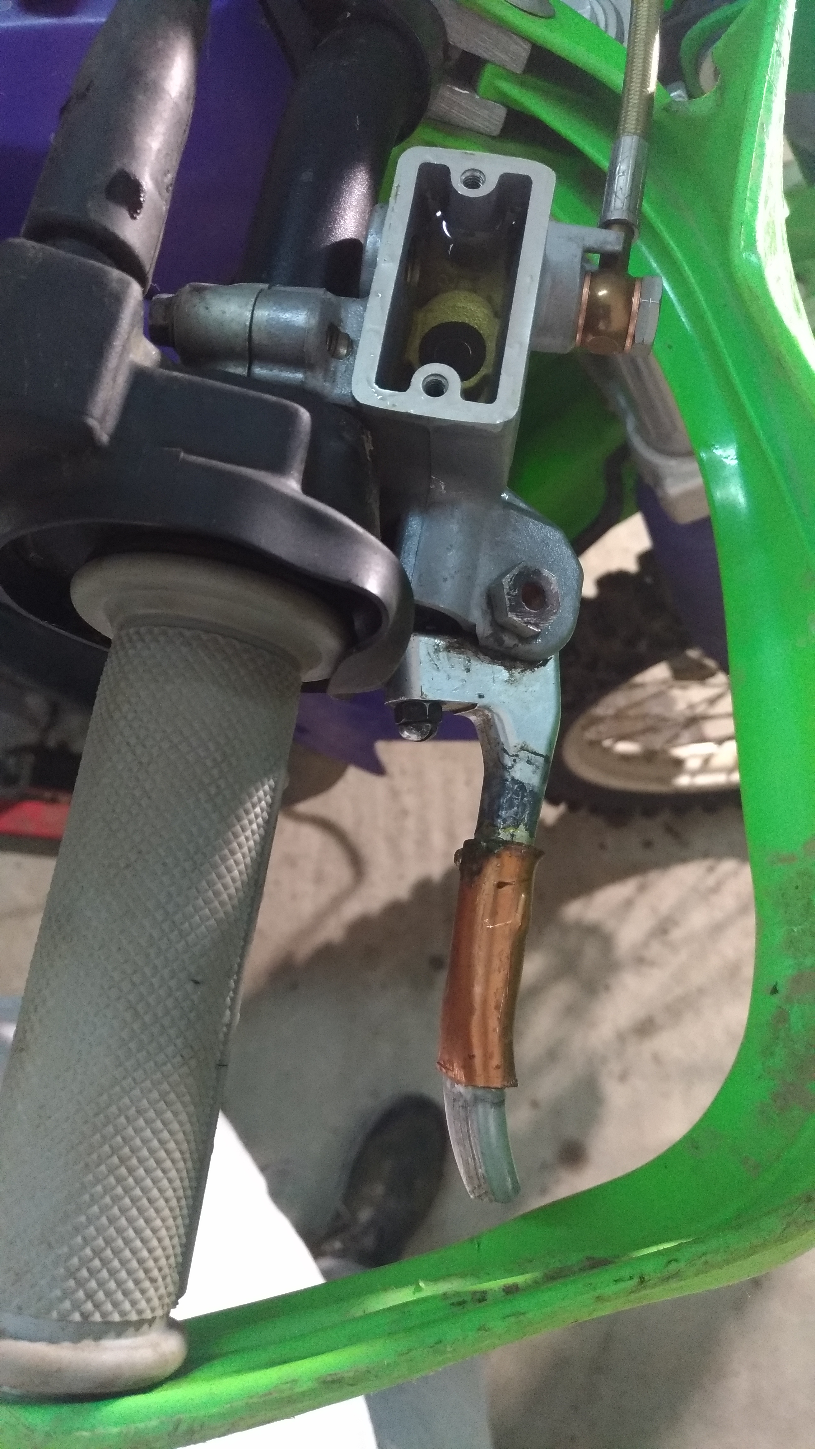

I then decided to remove the heat-shrinkable sleeve that was on the lever since I got the bike, as it is at least 3-4mm thick. Maybe that would help?
Guess what? It was hiding a broken lever just holding with a piece of copper tube hammered on it!!! Man!! I've been riding it like that for four years! I'm quite ashamed that I never checked it... So maybe all of this could be a wrongly shaped lever issue?
Could someone give me some advice on replacement levers? I kinda need one now. I loved the feeling of the short lever on my buddy's new KTM.

Still the same problem. Then I got angry. It feels like there's no air in the circuit and somehow I'm lacking range, as soon as the pressure builds up I'm crushing my fingers between the lever and the handle.
