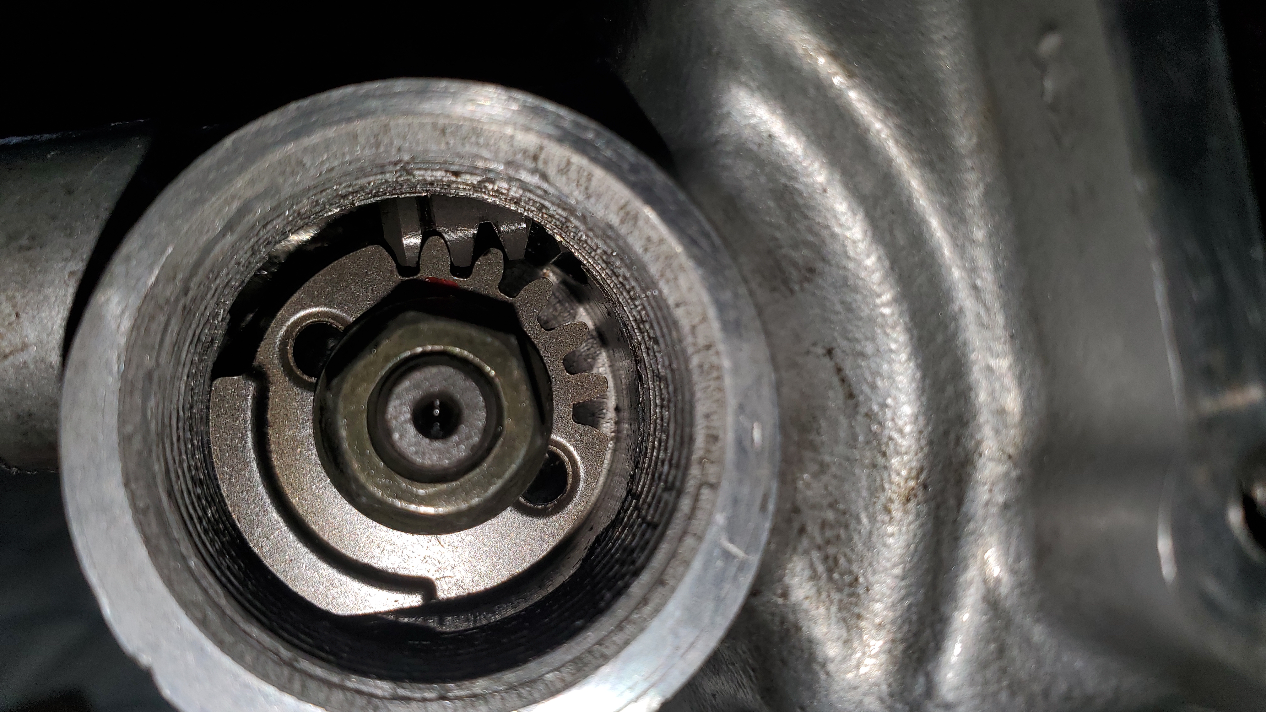

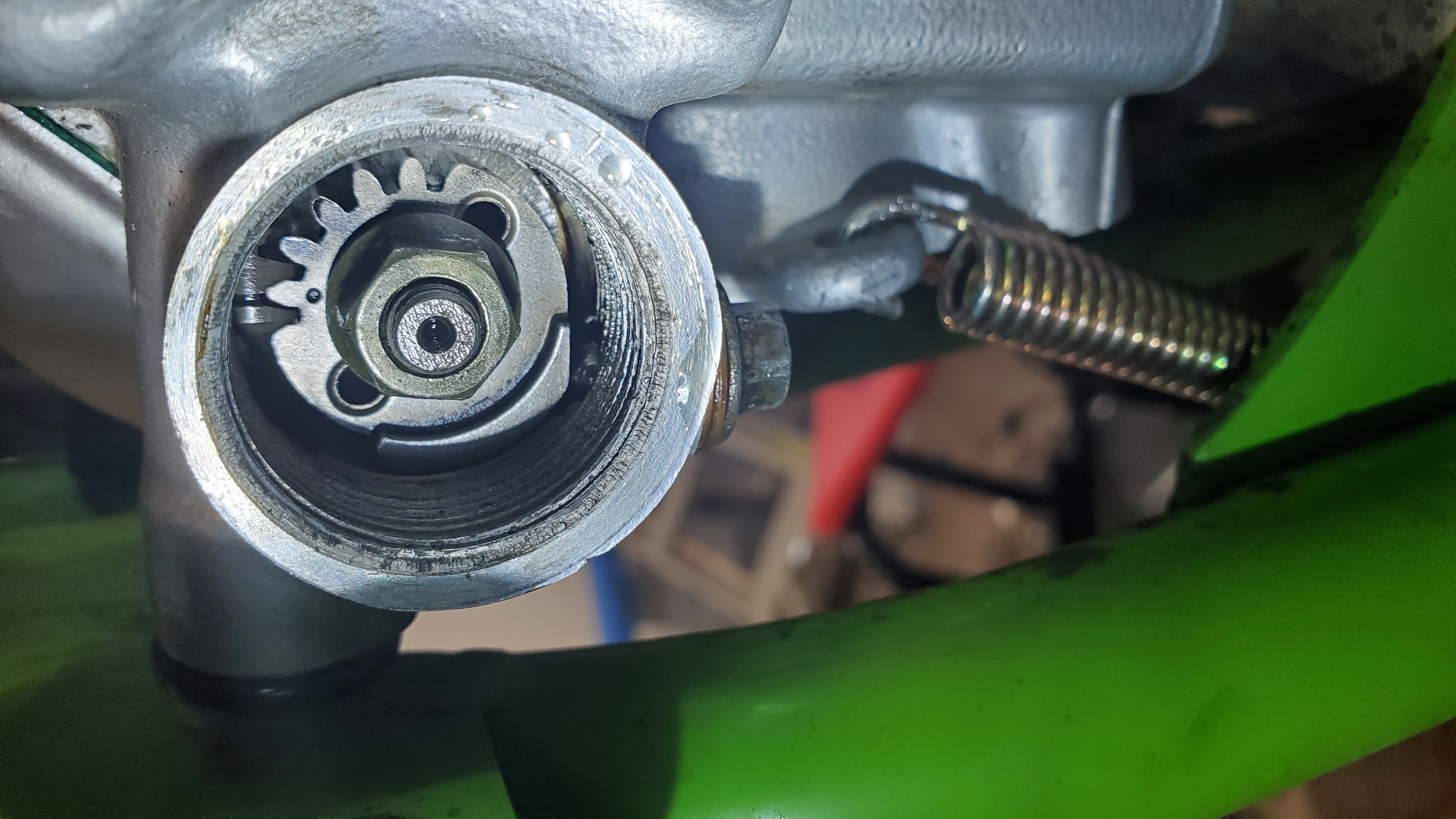

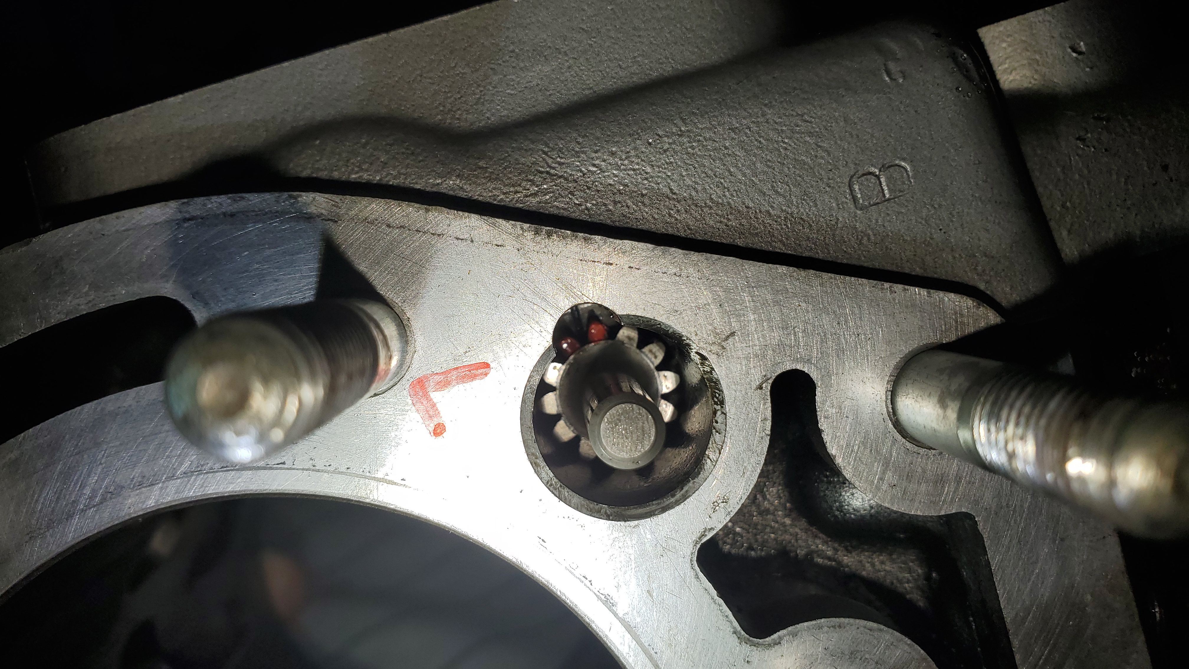

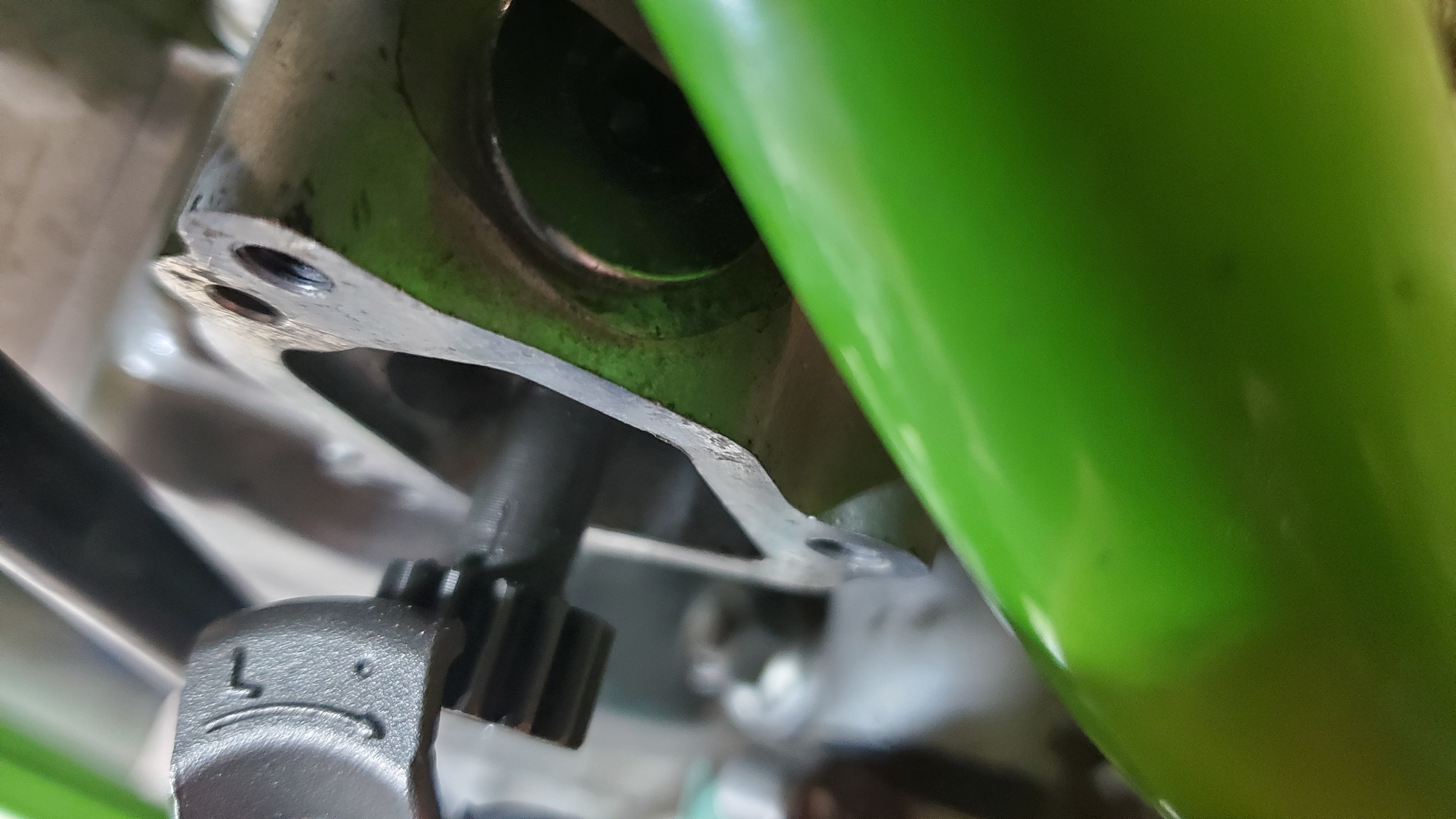

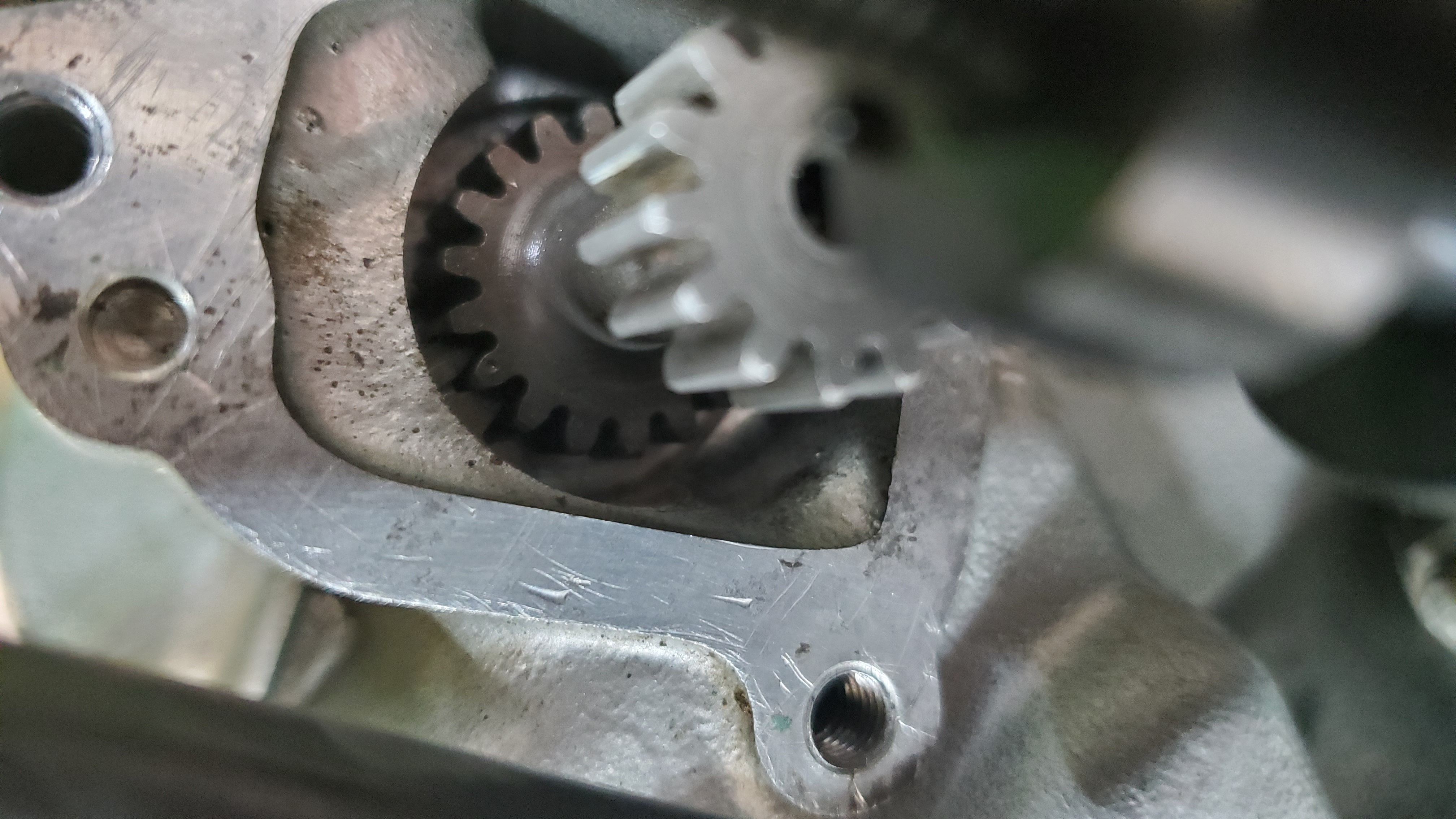

:hmm: Update. I disconnected the kips shaft and rode it with the valves open manually, then turned it the other way manually. Ran the same. No better, no worse. So is that ruling out a kips problem or confirming it?🤔 here are pics of the shaft timing, I believe they are correct.

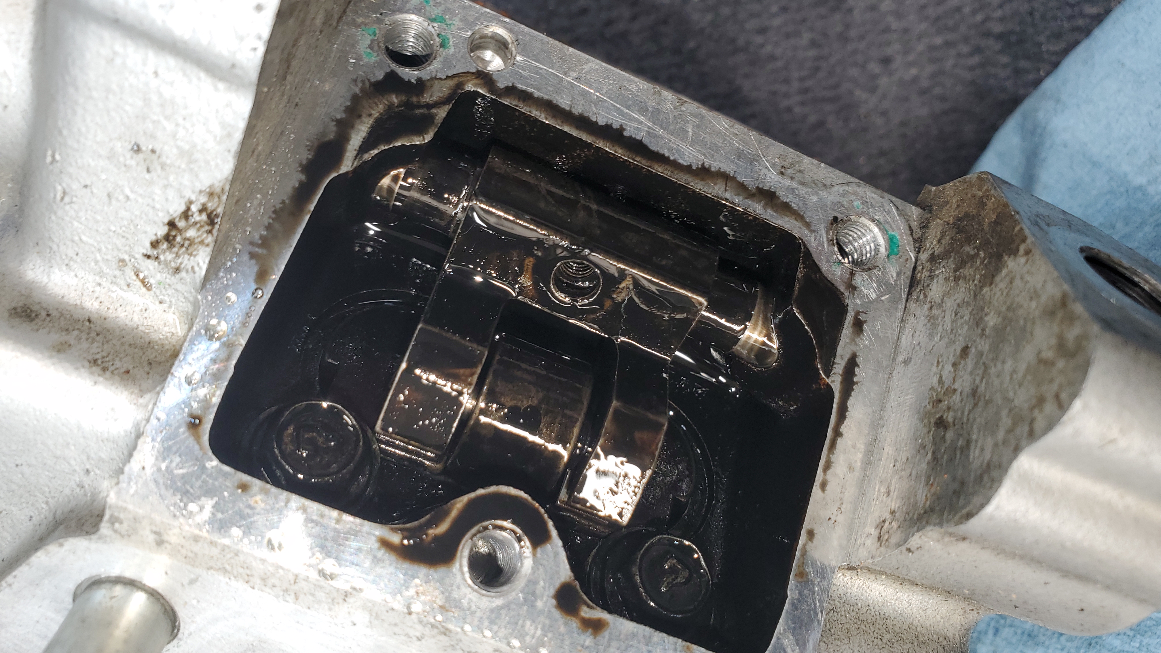

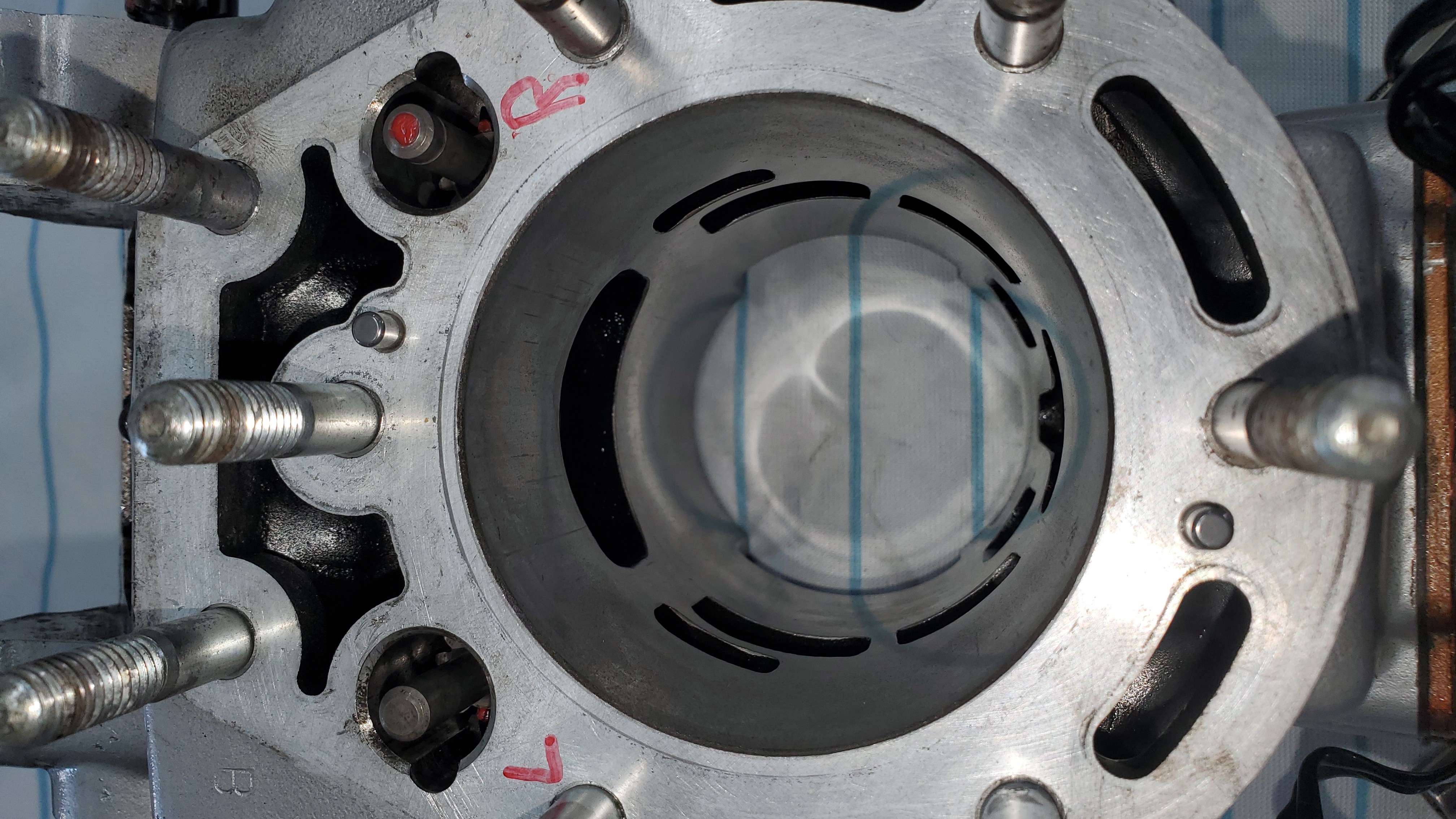

So I am an idiot, I had the left and right subvalves switched around. However, I believe they were installed correctly first time around because I thought it was wrong then. What about the main valve? It appears it can be installed either way 180 degrees. Which is the correct orientation? Also the valves are really oily. They were completely clean before install. This is with 20 minutes run time. Normal?
Kevin2502000
Posts: 37
Joined: 11:25 am Oct 18 2020
Country: Usa
Re: Pulling my hair out
Post by Kevin2502000 »
I guess it only does go in 1 way. I stripped one of the bolts that holds it in. Can I tap to the next size or should I do a helicopter? Crap.
Posts: 3540
Looks awfully oily for only 20 mins, what fuel/oil ratio are you running and when was the carb tuned last? A helicoil should work fine, at least I would go that route rather than drill and tap up a size just to keep the fasteners correct. If you had the subvalves in the wrong spots then it would explain your lack of top end.

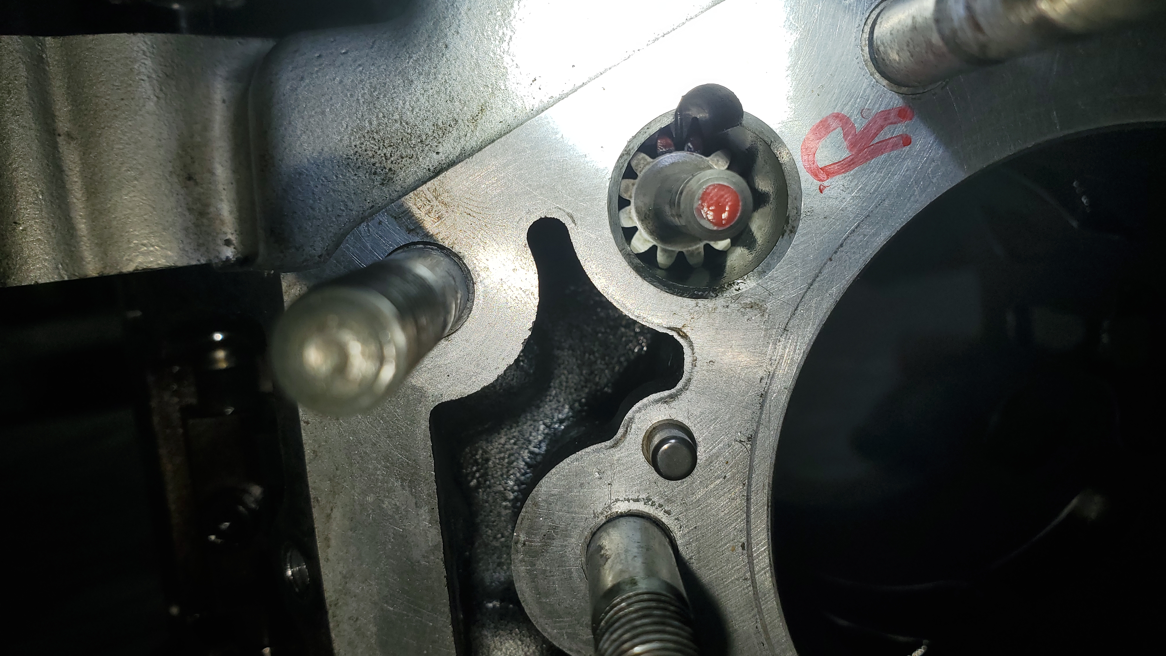

Ok I reassembled everything today. I took a marker and marked L and R to make sure I didn't screw that up again. Also hit the timing marks with nail polish to make it more visible. The subvalve with the red dot has the groove in it.. Can someone verify that this is correct?

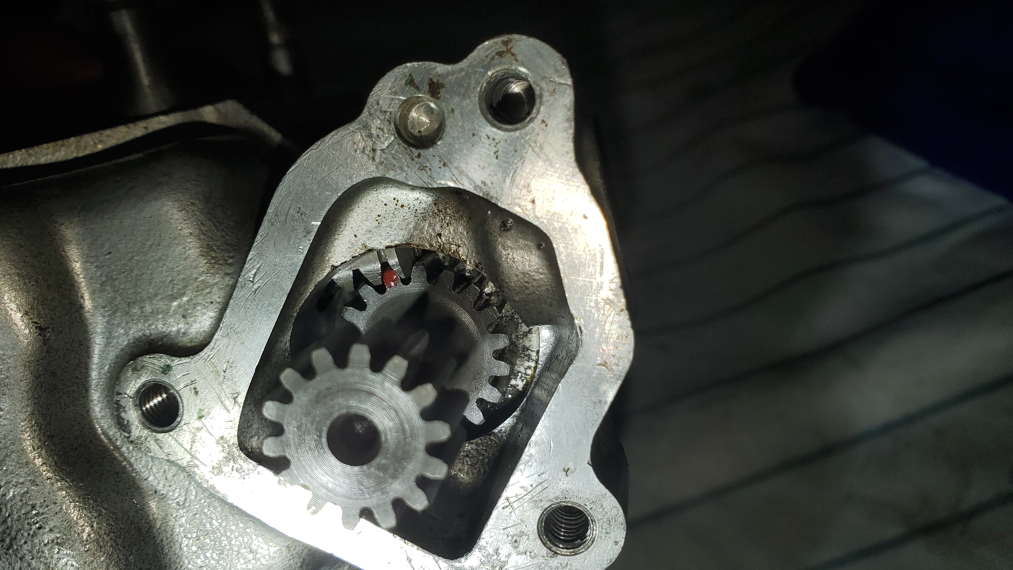

Another pic.
Last
Posts: 3540
All looks right from here. With it reassembled, take a peek in the exhaust port and watch the subvalves as you rotate the actuator to make sure they are in there correctly

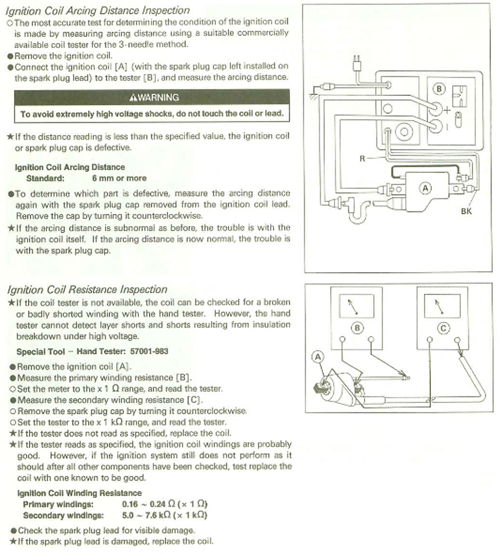

I'm a little confused about checking the ignition coil. Do you check the blue wire to the ground lug at the coil and what is that reading? The cap and high tension lead were within specs. Another thing I remembered, I had disconnected the voltage regulator while I was trying to install a rectifier but gave up. I had been riding it without that hooked up. I was under the impression that was strictly for the lighting part so shouldn't affect the ignition system. Can anyone confirm this? The plug also looks oily like it wasn't getting good detonation. Switched out plugs twice. It acts just like a bad spark plug which make me suspicious of the ignition system. Thanks for any ideas.
Posts: 6054
Had a similar problem once, turned out to be the plug wire itself so double check that it's in good shape and seated fully in to the coil. Here is the factory testing procedure. Get yourself a factory manual for future repairs and maintenance. It will save you a lot of time and headaches!
