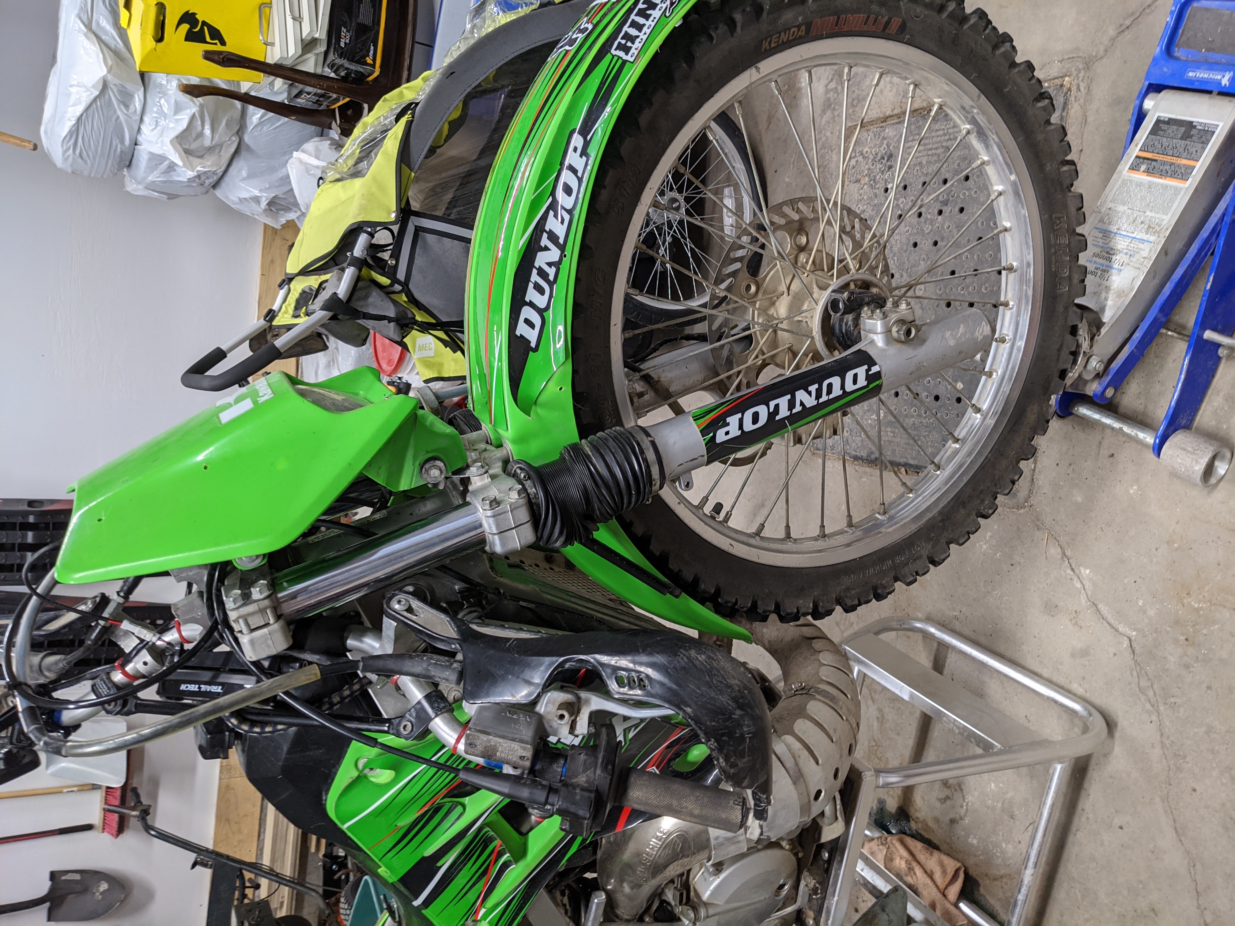

Just compressed fully the suspension with my jack and measured 7 inches from top is where the oil is, no spring. That would make the front forks pretty soft no?
- PXL_20201231_161548887.jpg (3.02 MiB) Viewed 3098 times
- PXL_20201231_161515308.jpg (3.48 MiB) Viewed 3098 times

Are the forks fully compressed or just jacked up as high as they would go?
- Posts: 32
- Joined: 08:43 am Aug 06 2019
Re: KDX220 handling
Jacked up as high as they go before lifting the bike. Look at the pics in my previous post.

They’re fully compressed in the picture. As I recall the useable range is listed as 85 to 100mm. 85 will be more firm due to the lower amount of air volume which compressed quicker.
But check the numbers for your specific bike.
Ideally you would pull the fork legs off the bike and hold them straight up to measure the level. You can also thoroughly drain them with them off if you’re changing the fluid. 5wt is most likely standard. You may prefer 7.5 or 10 but for now you just need to get it within the operating limits.
