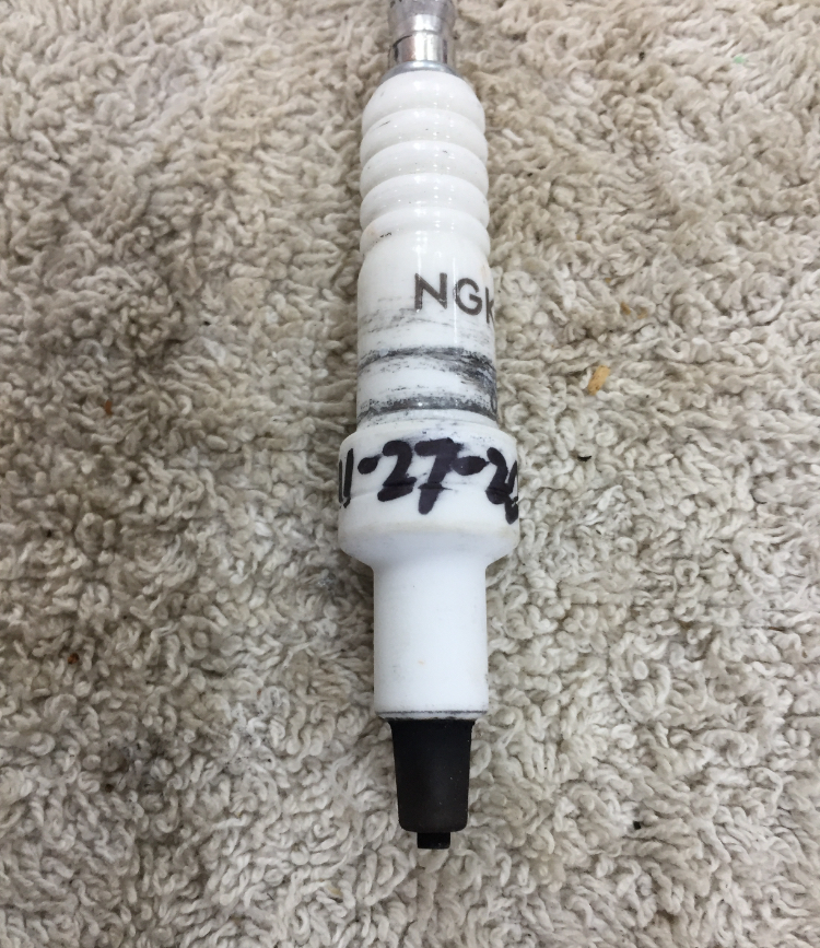

A couple months later and it looks like this, so I dropped 1 MJ size (148) I don’t think I’m close to lean yet.

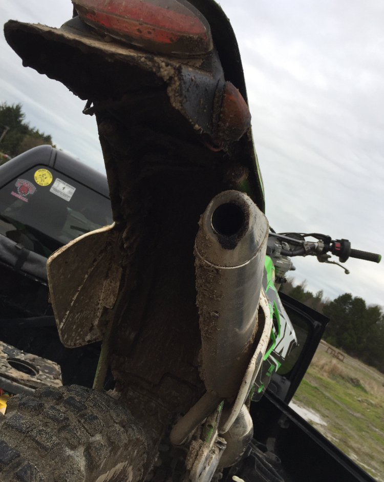

Can we live with this much spooge? This is first hard test with the 148MJ.
7 Motos at the MX track. Will have a look at the plug, one I buy another box of extras

Re: Extra Spooge - theory
Does look better!
