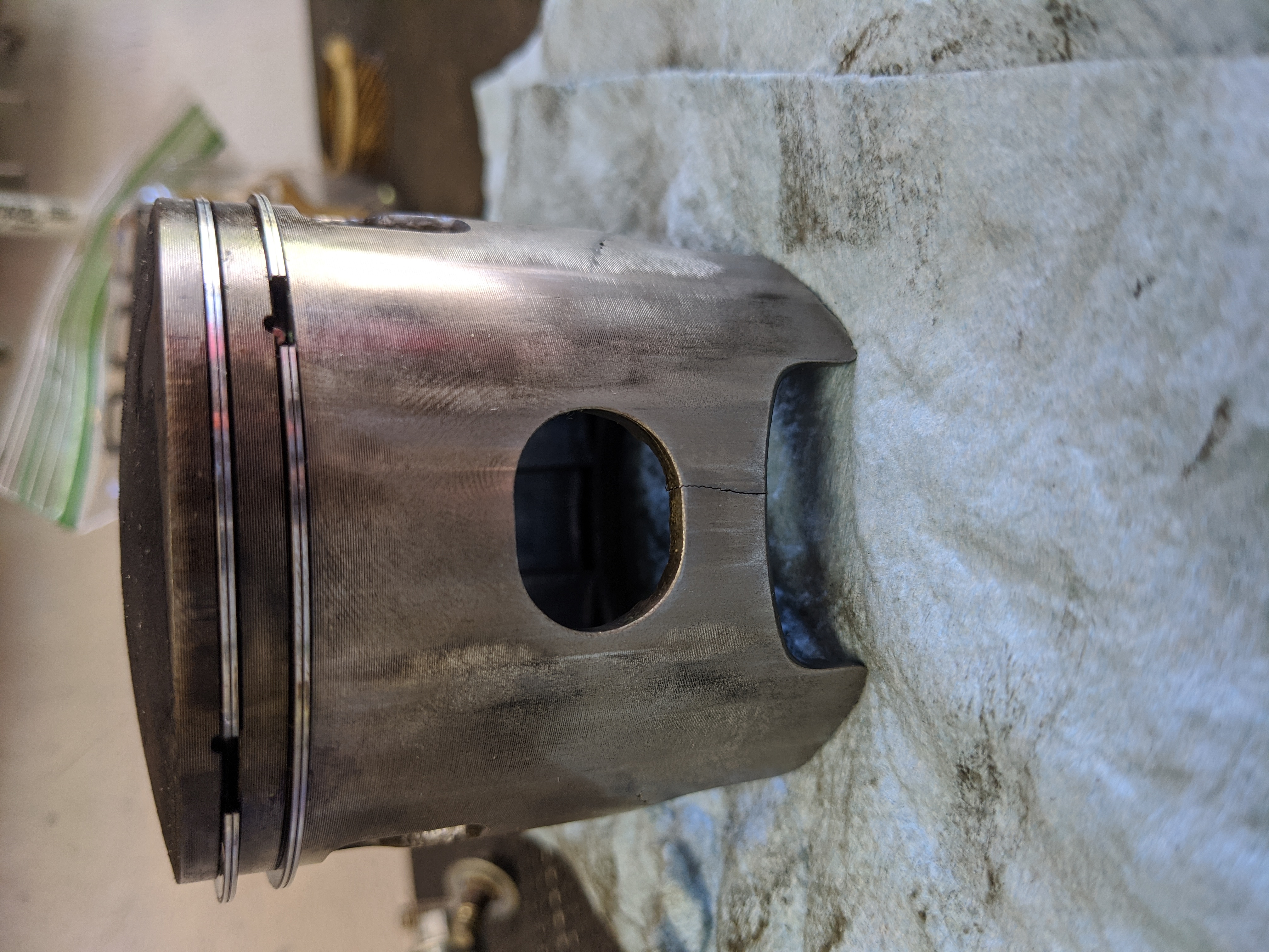

BTW, to any naysayers, the 220 piston that we pulled out was cracked in three places and one top end Rev from disaster.
Put me in the...replace the stock 220 piston ASAP crowd. I told my buddy about it before opening it up, and definitely got some justification. It was trashed, which made me think that was why it was running rough. Amazingly enough, the cylinder was clean. No gouges, nothing.

Here is the piston that came out of it
- IMG_20200822_115624.jpg (3.63 MiB) Viewed 4882 times
- IMG_20200822_115636.jpg (3.67 MiB) Viewed 4882 times

That's what a grenade looks like just after the pin is pulled lol

Close only counts in horseshoes, hand grenades, and 220 pistons. ;)

INCOMING!!!bufftester wrote: 09:30 pm Sep 09 2020 That's what a grenade looks like just after the pin is pulled lol
You were 1-2 kicks from the last kick for that piston.
