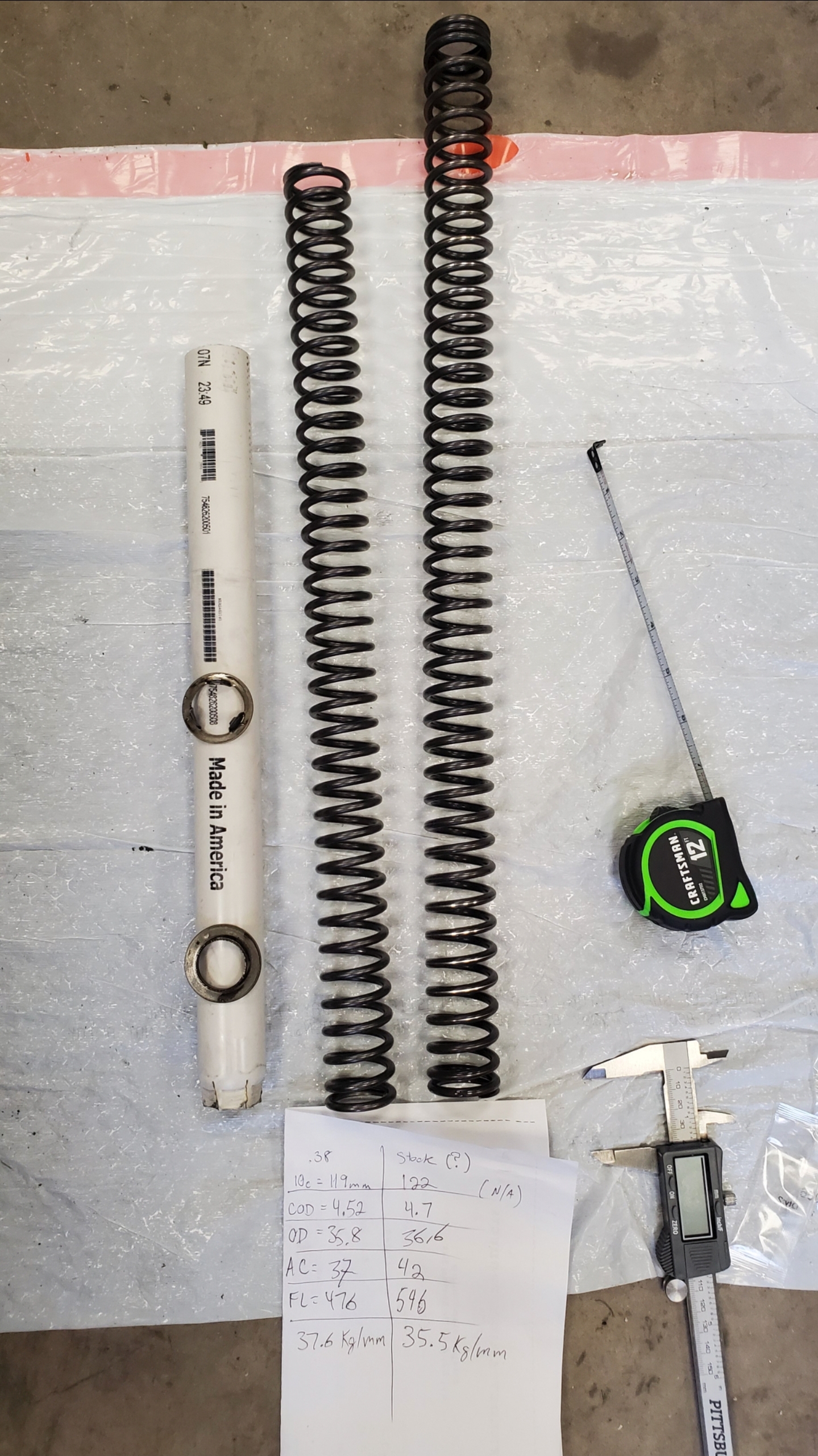

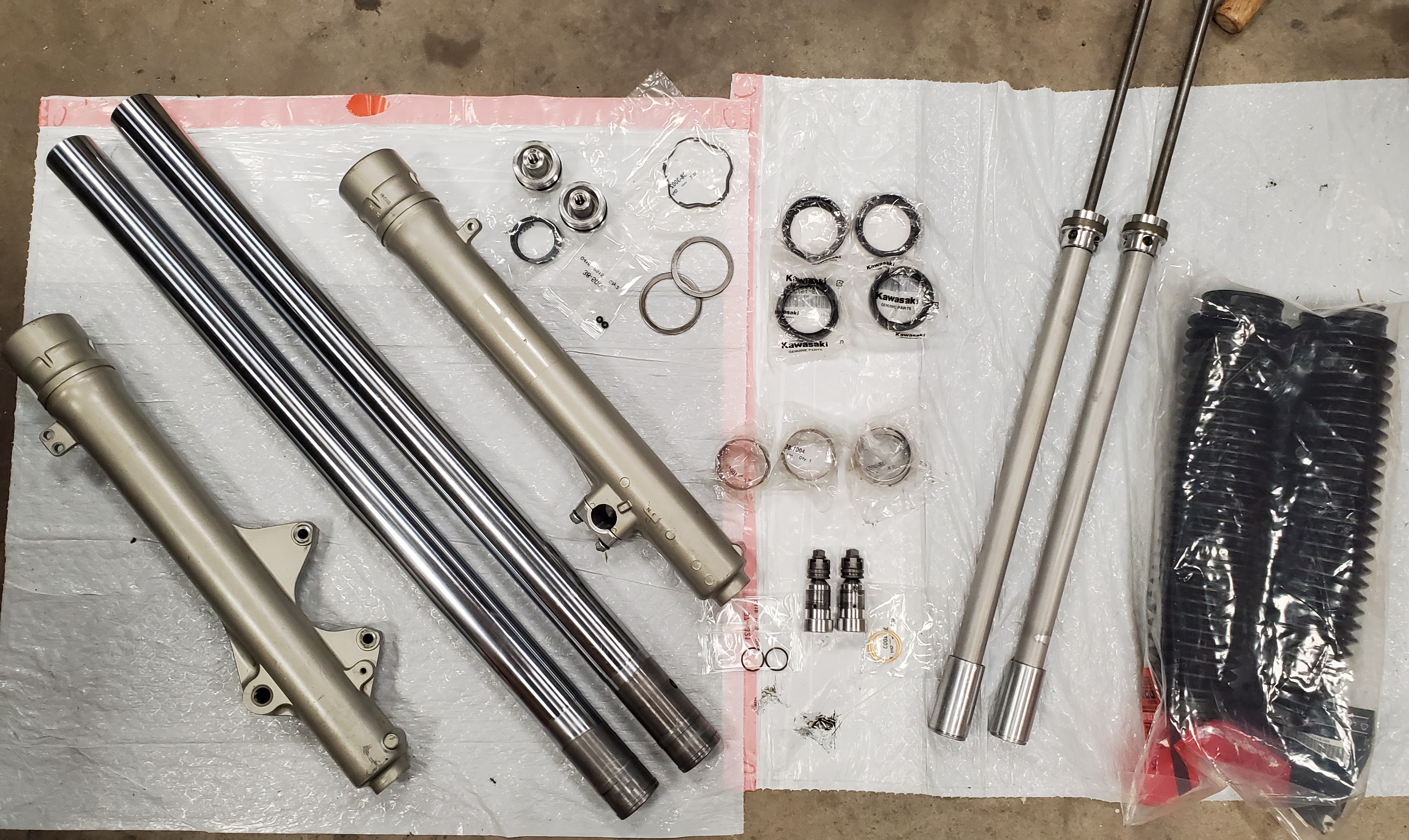

FRP spring on left, whatever was in it on right.
Looks like I will need spacers.... After some research, 1" sch40 pvc works well it seems... so I happen to have that. Should I cut it to the delta value (~70mm) or maybe a bit more then reduce to get 5-10mm of preload? My other bike (beta 200rr) has 6mm of fork spring preload and seems good... im not an expert here if anyone can tell haha
At least the math checks out - FRP comes out to 37.6 Kg/mm vs the current springs at 35.5 Kg/mm. Phew!
After the springs were investigated I proceeded to start the reassembly process... Progress!

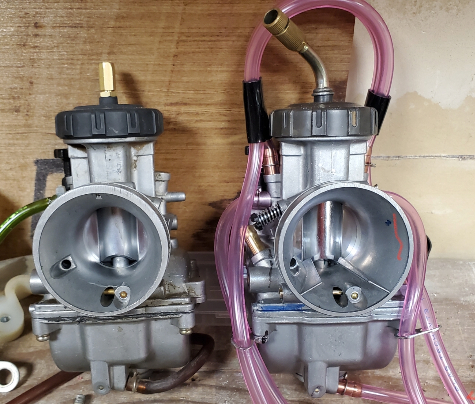

I'm thinking of starting with 150m/42p jets and needle (DEK comes standard on this airstriker) on 2nd clip from top. I have the 35mm airstriker carb and typically ride between 6k and 11k feet so im thinking while those jets would be on the lean side at sea level (from what I've read) they may be perfect for my elevations? I also have the FMF woods pipe, vforce3 reeds and turbinecore spark arrestor for reference.
Jetting critique is much appreciated!

Re: Farm Vehicle → Mountain Goat
The springs on the right are not stock.
A few mm of preload would be good. PVC pipe makes a good spacer.

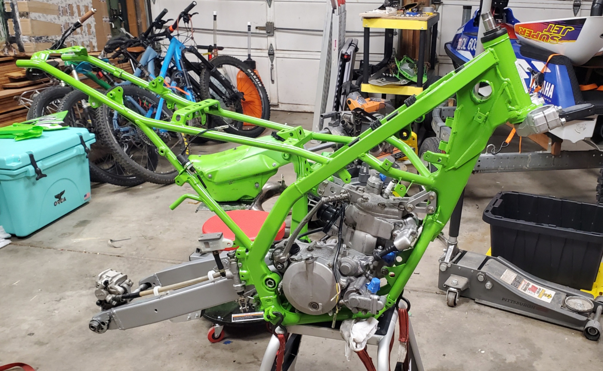

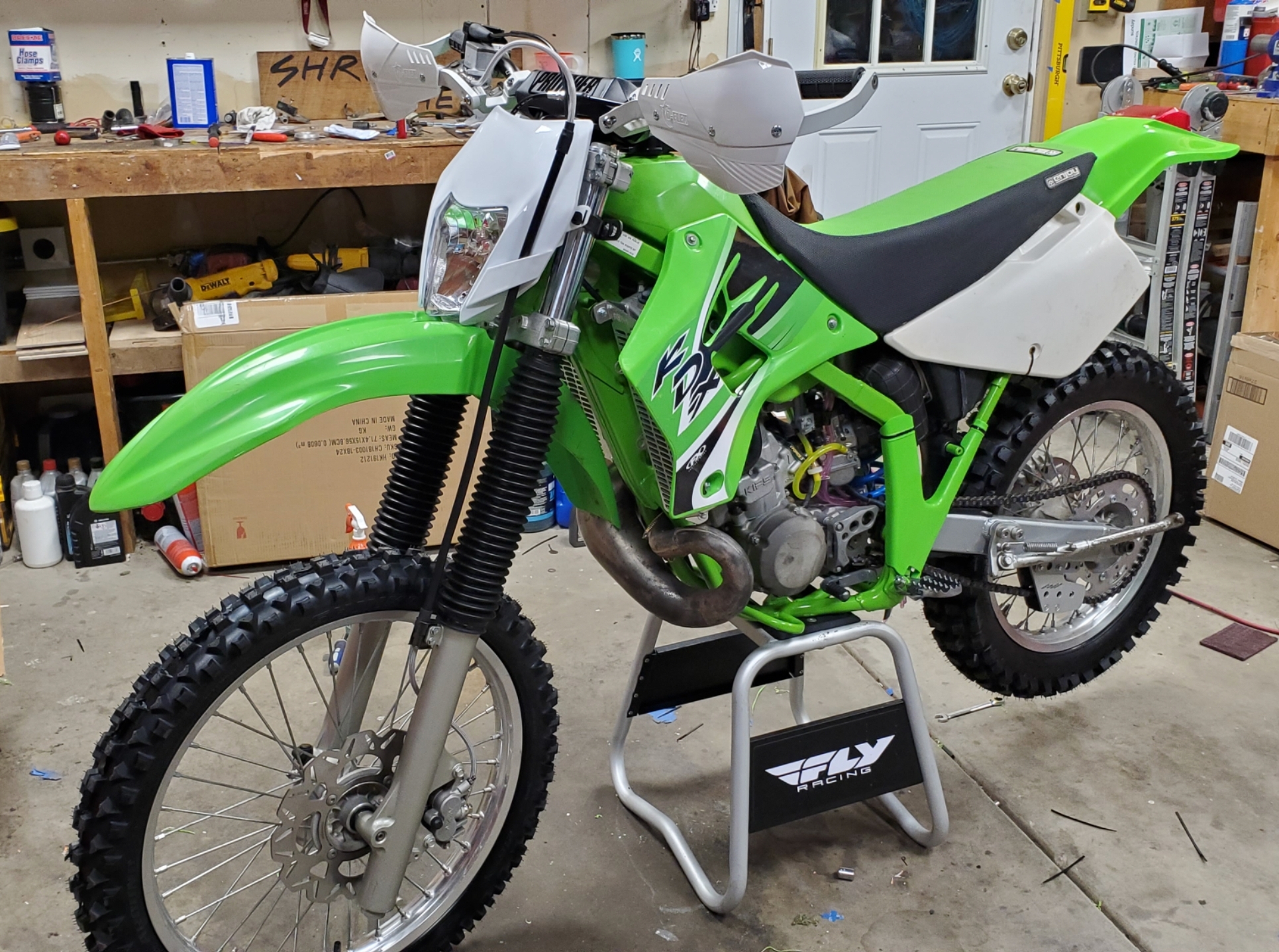

It's lookin more like a dirtbike now!

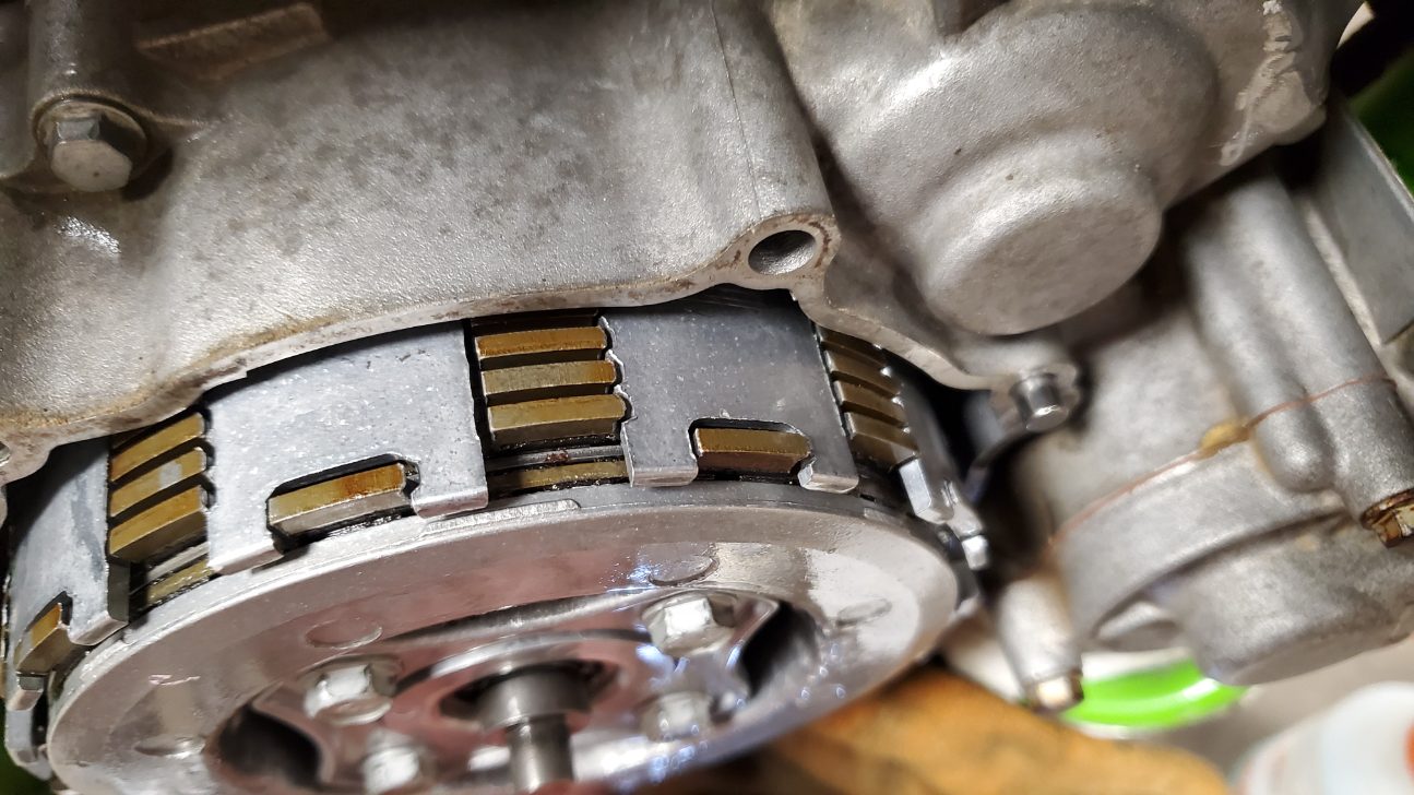

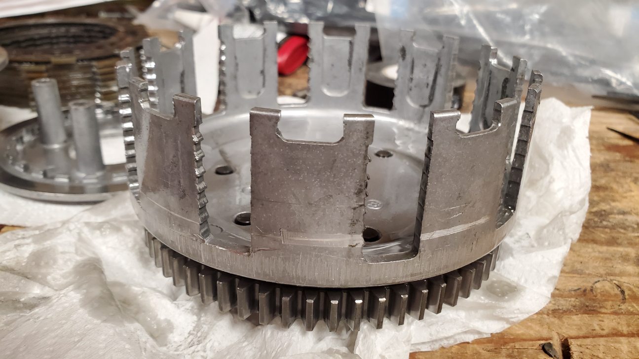

And now the clutch... I guess you could call the basket grooved? </S>
The clutch friction plates have matching grooves in them as well - just as deep.

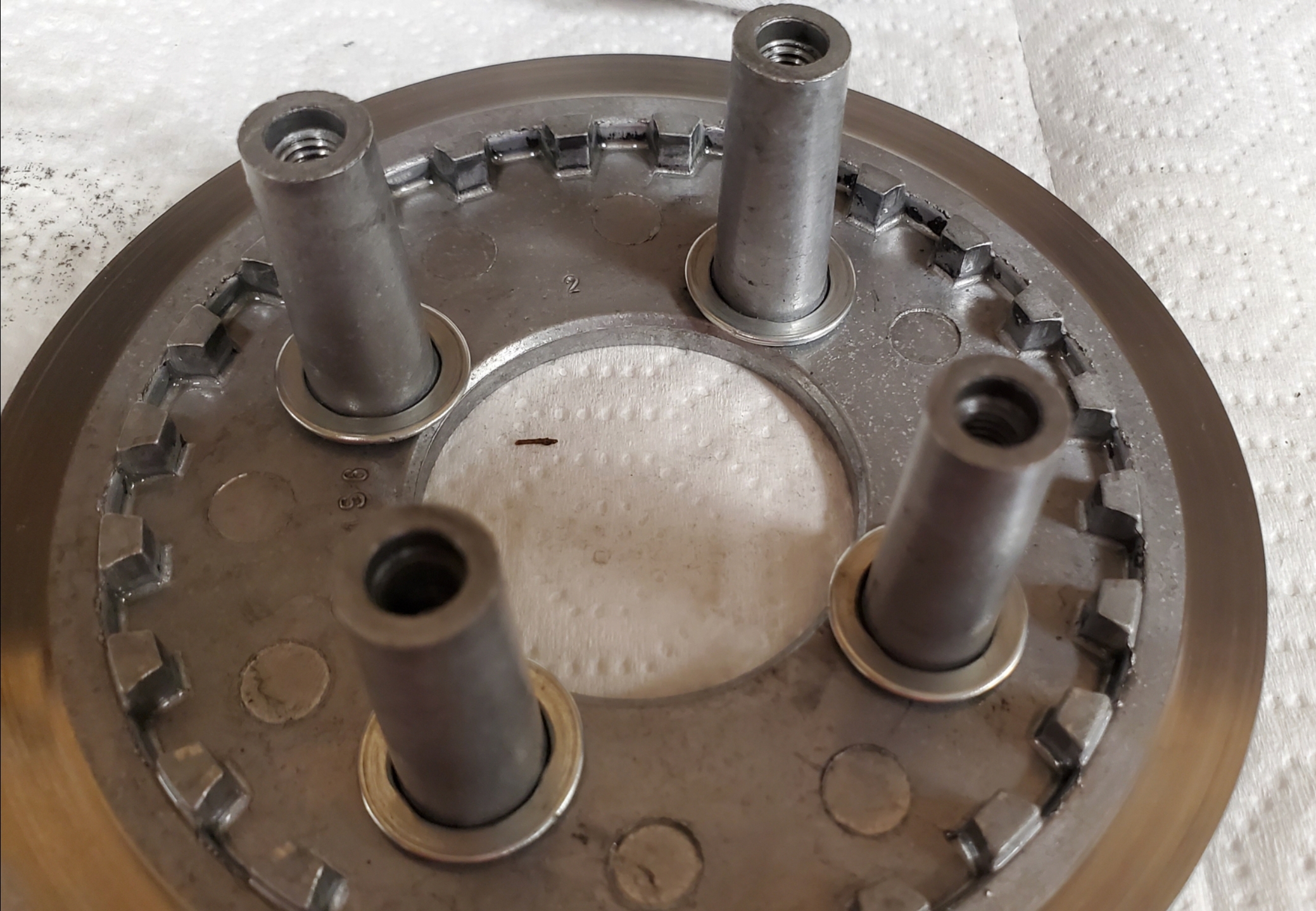

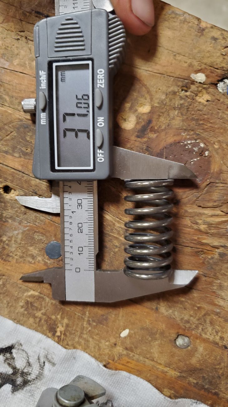

And the springs were also compressed under spec...
kdx clutch spring.jpg (155.77 KiB) Viewed 10536 times
So my question to the gurus on here - would this scenario cause the clutch to not engage as solid-ly as it should? The bike sounded like it was running great - reving clean and up pretty high... but the engine sound to rear wheel traction feeling that I know oh so well with my Beta 200RR 2T just was not there - not even in the slightest. It felt like I was on a snowmobile with a slipping belt...
The engine oil has a silver glimmer to it - but it's non-metallic (tested with a magnet wand, did not change motion of the fluid like you would expect like a 'ferrofluid'). I suspect this is aluminum being worn off from something?
I've never replaced a clutch on a dirt bike - and never fallen victim to a slipping clutch for that matter - call me lucky or just not one to own a bike long enough to deal with it.

"So my question to the gurus on here - would this scenario cause the clutch to not engage as solid-ly as it should?"
A tisket, a tasket,
you're gonna need a new cltch basket
and plates and springs
Someone got their money's worth out of the clutch along the line.

Yea the search is on now... In reading other motorcycle forums about the downstream effects of a heavily notched clutch basket - it does seem that it can cause power delivery to be robbed because the plates "can't slide together smoothly" per say... So I'm hoping at this point that the bike will be delivering power as expected to the ground after I get this situation sorted.
Someone got their money's worth out of this whole bike... it's been a journey to get to this point and all the "WHY DID YOU DO THAT SO JANKY" discoveries along the way... I guess I'm a better bike mechanic than I give myself credit for haha.

Yes, sir! This man gets it. (posted after reading "can't slide together smoothly")
This man has also used "JANKY". That is a very descriptive and accurate way of putting it. I can see the previous owners half-assing it in my mind right now. :-)
http://www.wiseco.com/ProductDetail.asp ... ppID=43331
I suggest you check into the Wiseco basket. I think a few people here have bought one in the past. Read up on drilling out the rivets and such. Unless I am wrong, no aftermarket basket comes with the gear already mounted, one just re-uses his own gear.

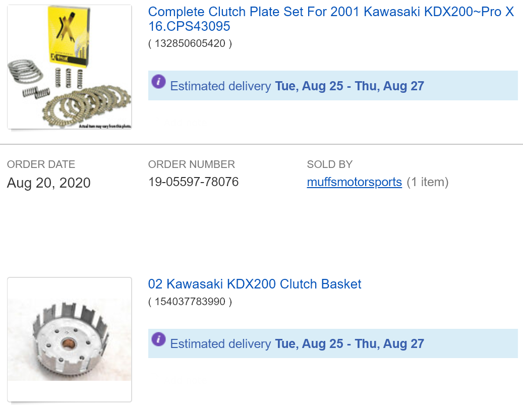

Ordered a very lightly used (compared to my saw blade basket) OEM basket and a pro-x kit. I couldn't find any bad reviews on the pro-x kit like those that have ordered the EBC kit and found the springs to be wonky.

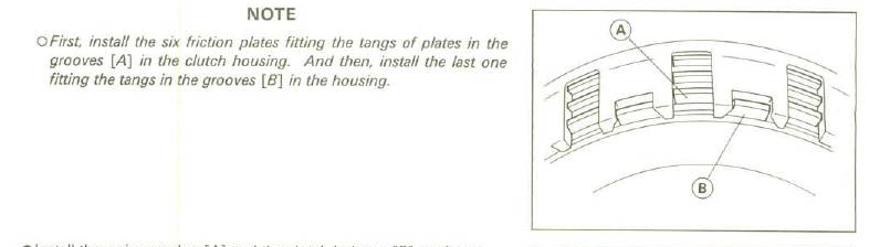

Someone also pointed out on the KDX facebook group that the first friction clutch plate on my post above is not inline with the rest of the clutch plates - should it be? It's placed off-clock in the extra groove...

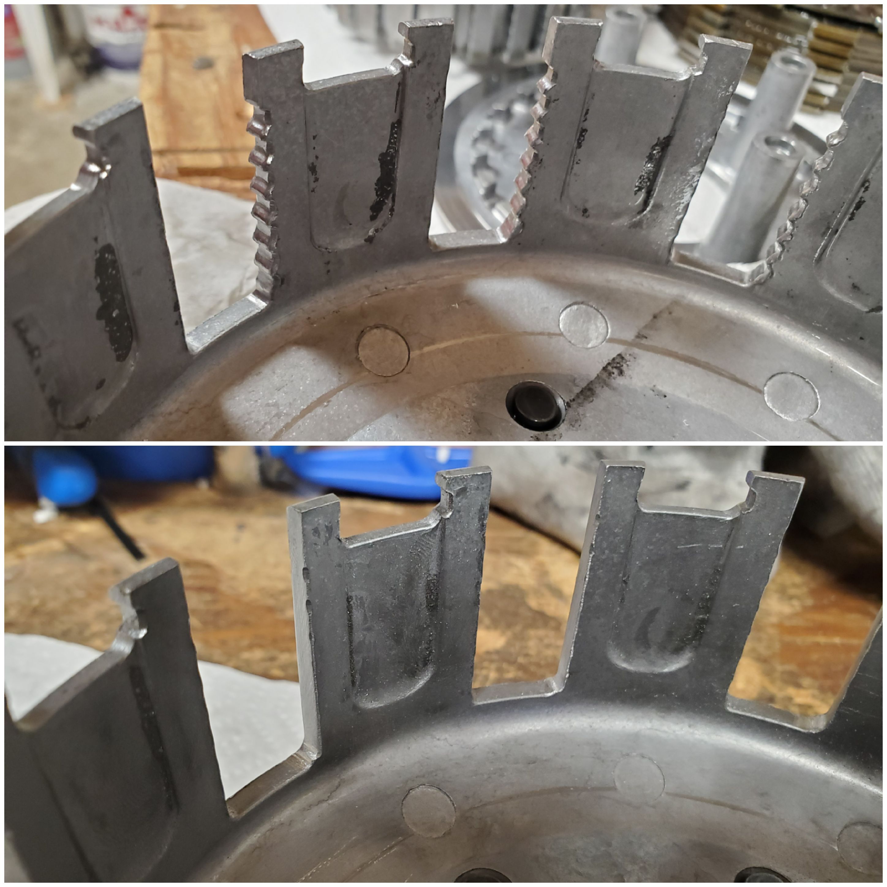

That is probably the worst looking basket I've seen, definitely going to require replaement

So I just checked the guide online as well as my Clymers manual... seams that the last plate is supposed to be offset. That is certainly weird - seems like every other clutch I've ever seen does not do this - I wonder why Kawasaki chose this method specifically for the H-series KDX?
kdx clutch install guide.png (97.49 KiB) Viewed 10494 times
Would it hurt if I didn't do that temporarily for a ride this weekend so I can put all friction plates (flipped as well) into the basket and keep it in one central groove? I guess I'll try and see what happens... getting a new basket next week anyways haha.

File the heck out of it if you have another one coming.

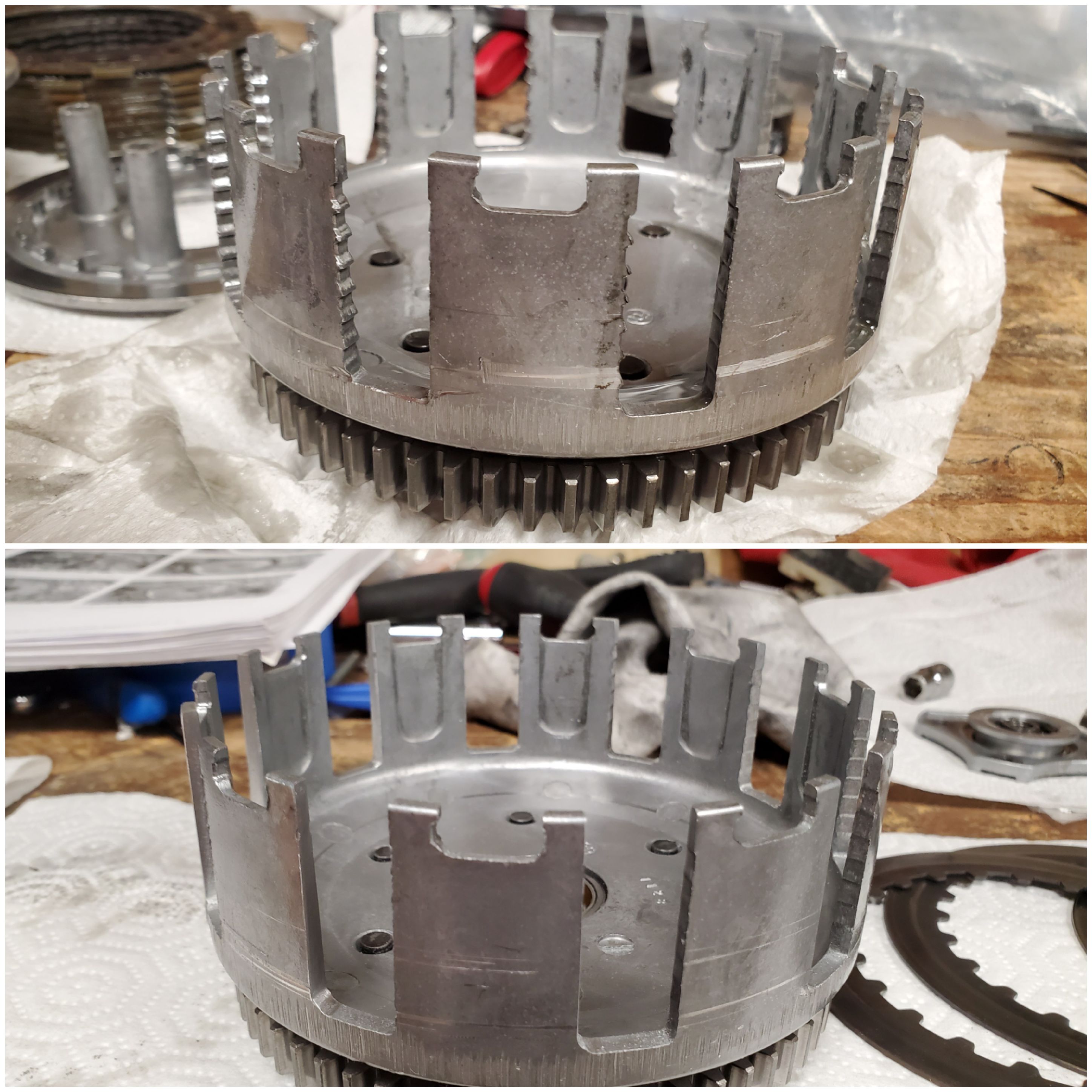

Well I filed the heck outta it! Have a ride lined up this weekend that is too good to wait for my replacement parts next week so I figured I'd do my best old skewl clutch basket salvage job. All in all I opened up the slots from what appeared to be a factory width of 14mm to a nearly groove free width of 15mm - so 1 extra mm for the plates to bang around in. Groovy!
The basket pre-filing is on top in each image.
I put it all back together and flipped the friction plates so their flatter side would ride the newly flattened basket edge. The plates are intentionally all inline. Why would kawasaki have wanted the last plate to be staggered? If anyone knows of a valid reason I'll go back to that method with the new basket and plates...
And to top it off I used 4 used spark plug washers to preload the springs since they were about .5mm under spec. The washers weren't placed where they are in the picture during assembly - that was just for fitment check.
I put ATF F in the tranny after all said and done. Hoping the detergents that it may have in it do a little cleaning before the new basket and plates are installed, then I'll probably switch back to normal oil.
The spark plug was showing a little on the lean side so I raised the needle one clip as well.
